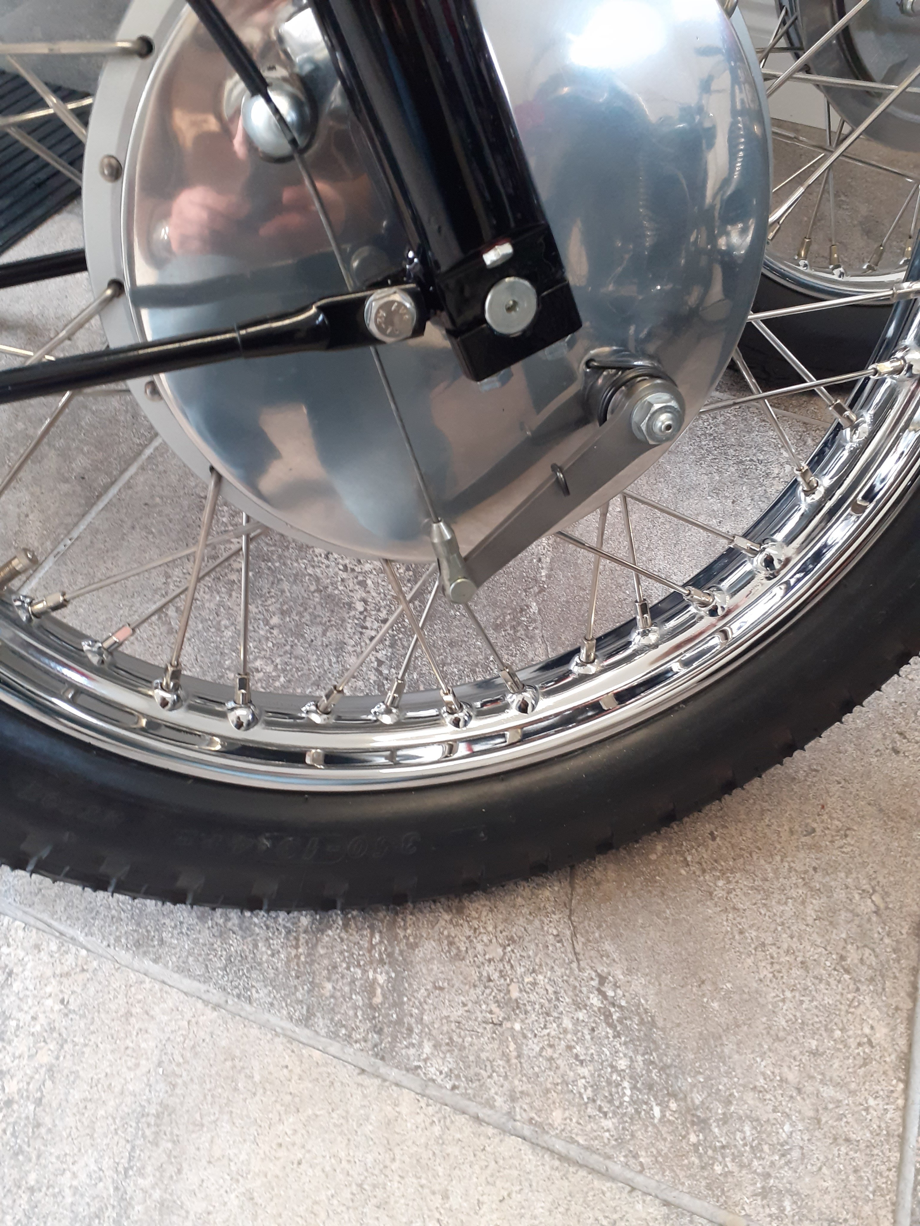

    Not wanting to fit a non original TLS to my 66 i talked my mate Fatman into cutting me a 1" longer lever with an offset drive square to keep cable adjustment, works a treat :)

  4. Don the Don
    2,949
    Unless you know your stuff it would be difficult to tell its not original, more torque applied for same pressure I presume
  5. darkman
    7,657
    Lol, yes we ripped off Triumphs design big time as one does.

    California - USA
    Question : How much does it change the travel on the lever ? ...J.D.
  8. darkman
    7,657
    Not ridden the bike much as its so new and cable brakes have a lot of lever movement as normal but i can say it's got way more feel now and brakes are far sharper.
