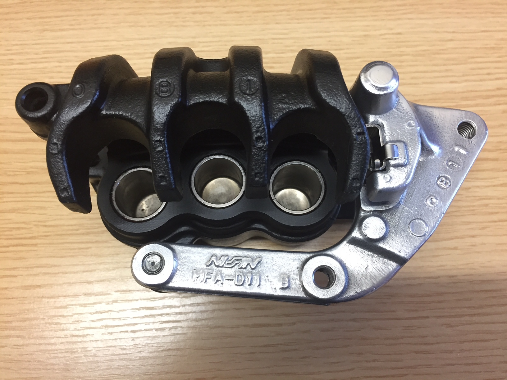

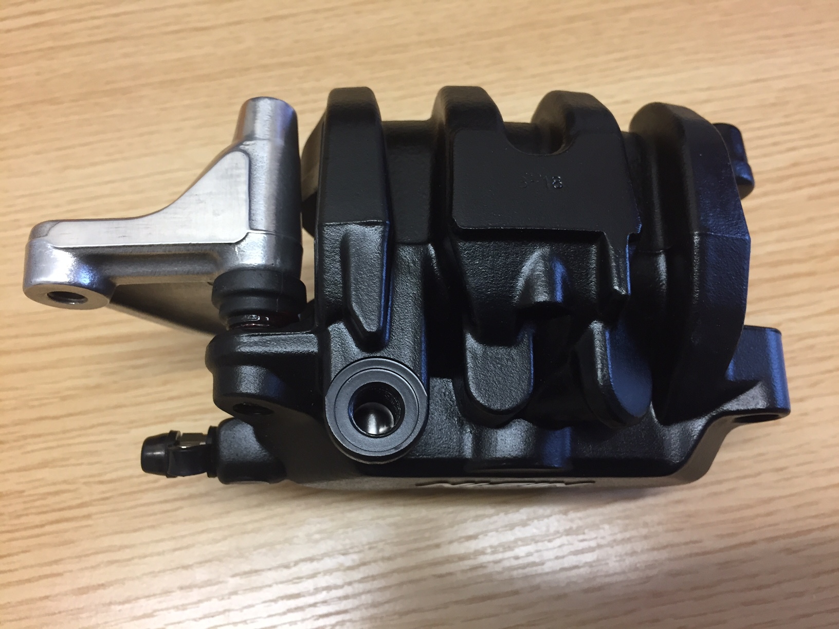

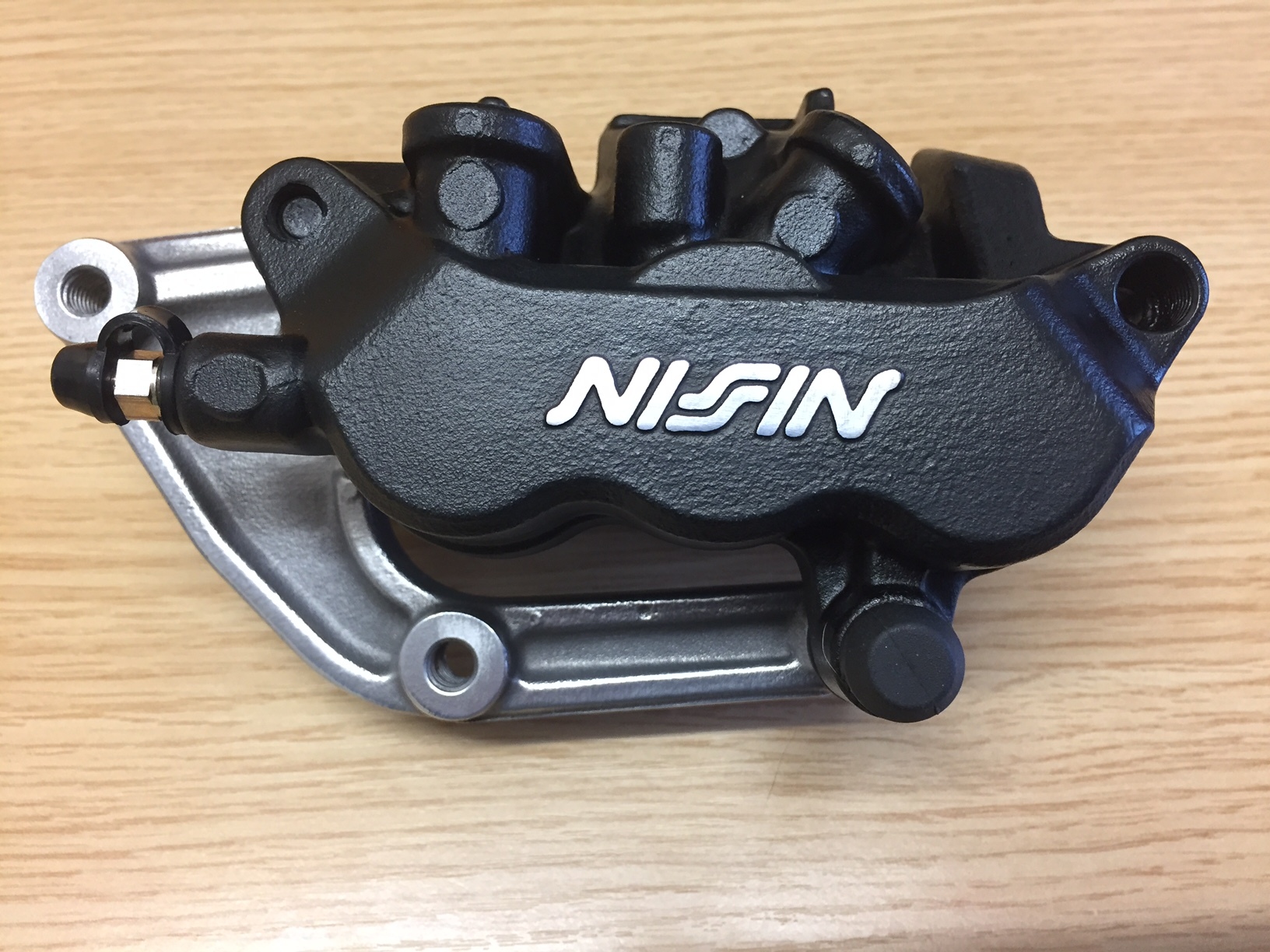

    152
    I've just finished refurbing the Caliper, stripped, cleaned, repainted, fitted all new seals and rubber boots.
    New Pads should arrive later today.
    A very satisfying task.
    Ride safe.

    TriBriBon Well-Known Member
    Jun 23, 2017
    152
    Why thank you kind sir.
    TBH, Dilli it's the result of being retired, bored and to much time on your hands.
    It could be a nice little earner if you could pick up a regular supply of doner calipers at sensible prices.

    One point of interest if you go down the eBay route, make sure the Caliper comes with it's carrier as the Bonneville one won't accept the uprated Caliper.
