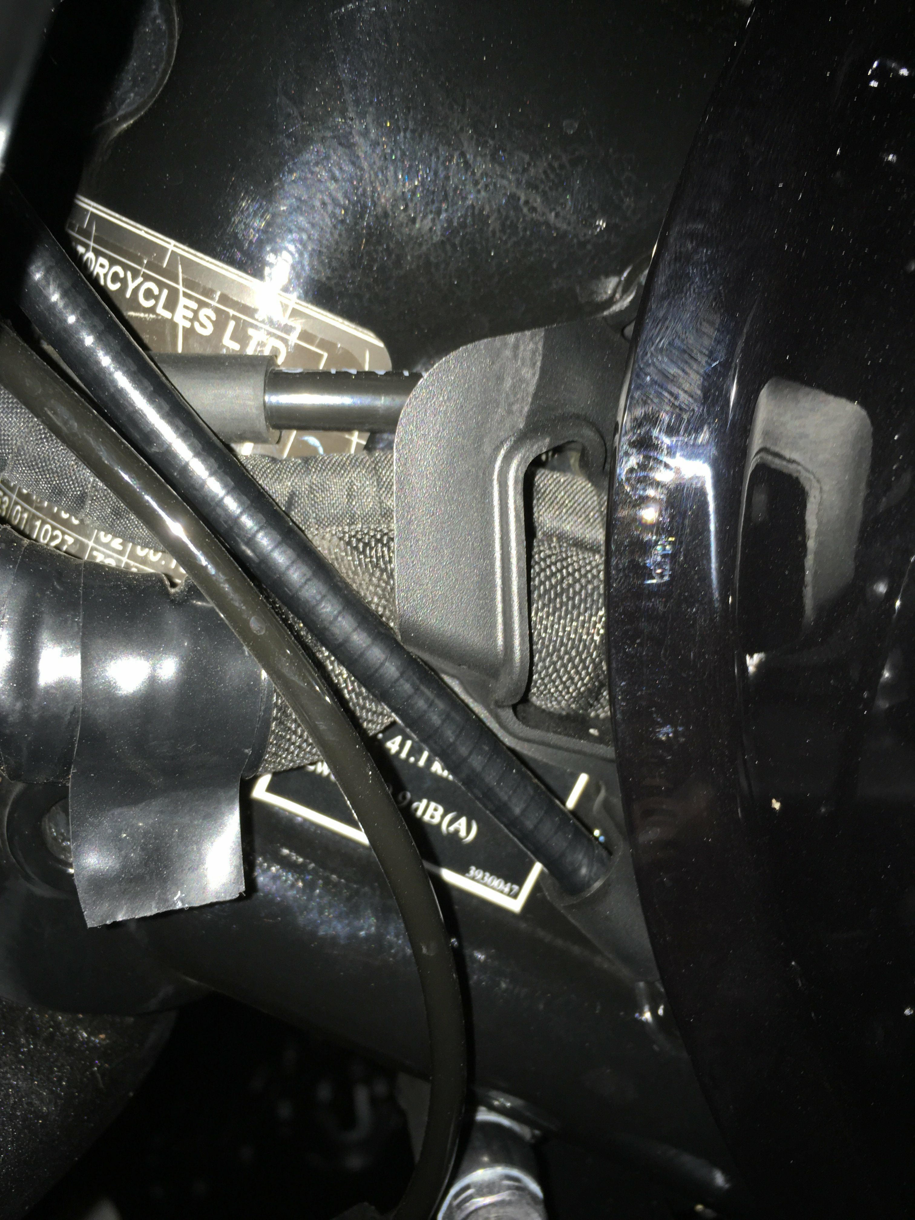

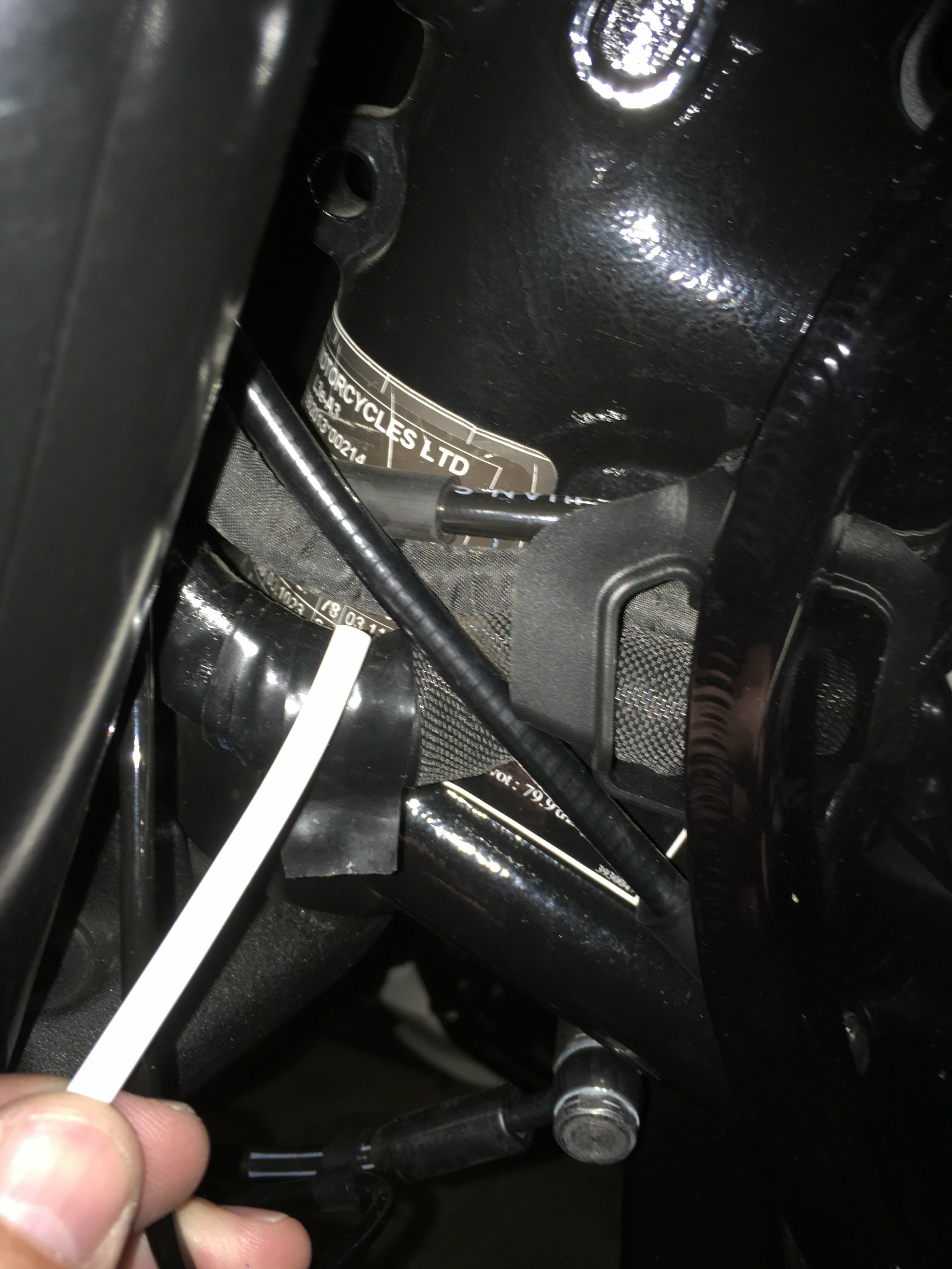

    I ended up waiting for mine this past Saturday, pity they didn’t tell me over the phone that it would take less than 30 minutes to fix then I would not have asked someone to follow me all the way there as I arranged to leave it there for the week and would have needed a lift home :triumph:. It’s is only a plastic trim bracket mounted between the frame and the tank on the left where the clutch cable is running next to the loom. It still seems pretty tight to me (see where I am pointing at with the White cable) The clutch cable is tight as hell against the loom right there and my opinion is that it’s not a proper fix, I guess time will tell.

    I'll have to look at mine again as it's not like that.
    Further look on big screen shows it clearer and im sure mine is the same now.

    A word to the wise regarding the new "fix" tidy recall. I'd say it's worse than before. It's not a real fix as the cable is still tightly seated against my wiring harness on a '18 T120. I went ahead and removed the cable from the tidy which got it off the main wiring harness. You'd think they'd have a better fix.

    I get that is the intended job, however the cable was still rubbing with the new recall tidy
