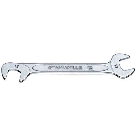

    You need a cranked spanner

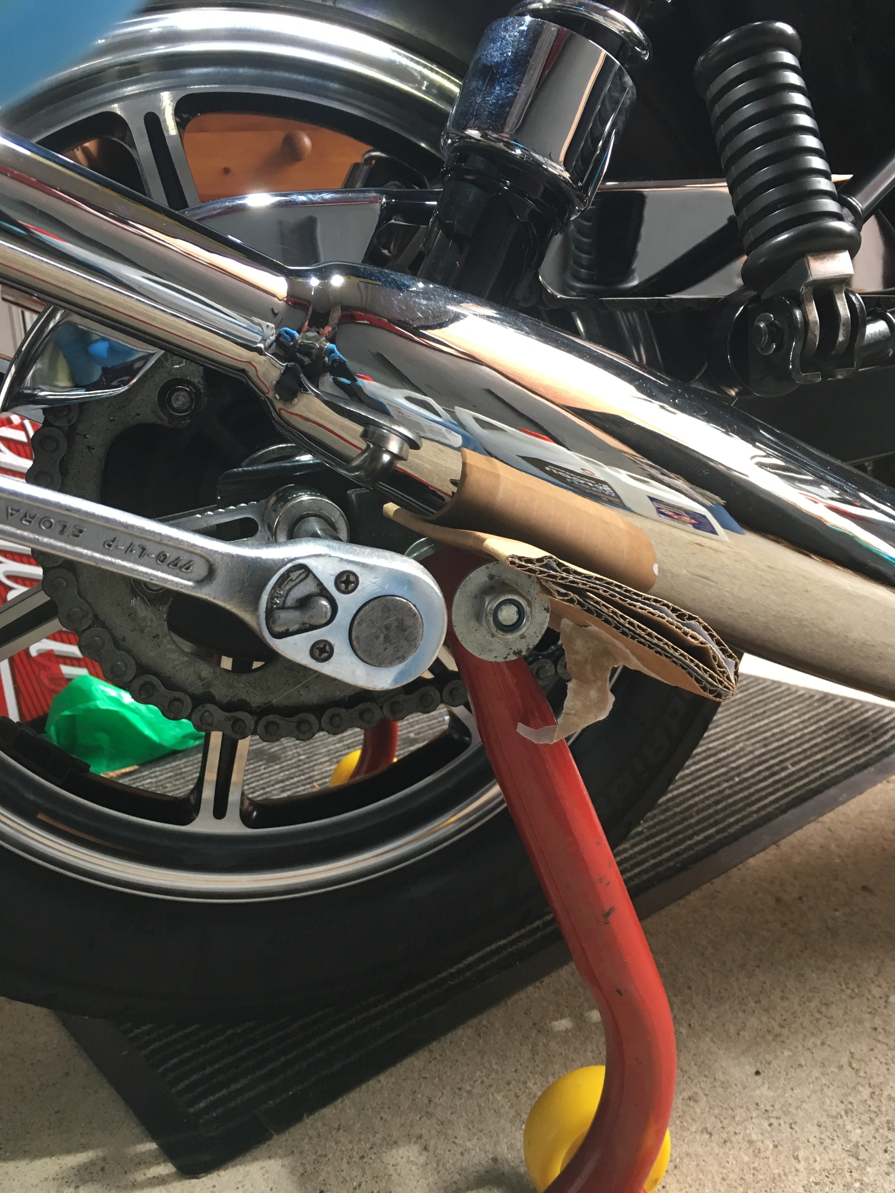

    When I got my 03 Bonnie it had a new chain fitted, 08 had nearly new chain too, adjusters seemed a long way back, but it did allow me to fit 19t front sprockets on both with still plenty of rear adjustment room, so not all bad, i'd bet that was just co-incidence and not by design though!
    I used a A.F 15/16 x 1" open ended Britool spanner for the nut, better fit than all my metric ones for some reason.
    To take the back wheel out I did need to take off both silencers though, PITA, but then I found I'd 'lost' my tube of heat resistant silicone sealant, so used ordinary silicone and it worked as well as 'heat resistant' and used it on both bikes.

    With the correct tools chain adjustment can be done in a few minutes. OK so it took me about 5, I stopped halfway through to gulp down a luke warm cup of Earl Grey.
    It’s not the silencers which are the problem, it’s getting hold of the right tools in the first place so you don’t have to remove them. I modified a set of old ring spanner’s.
