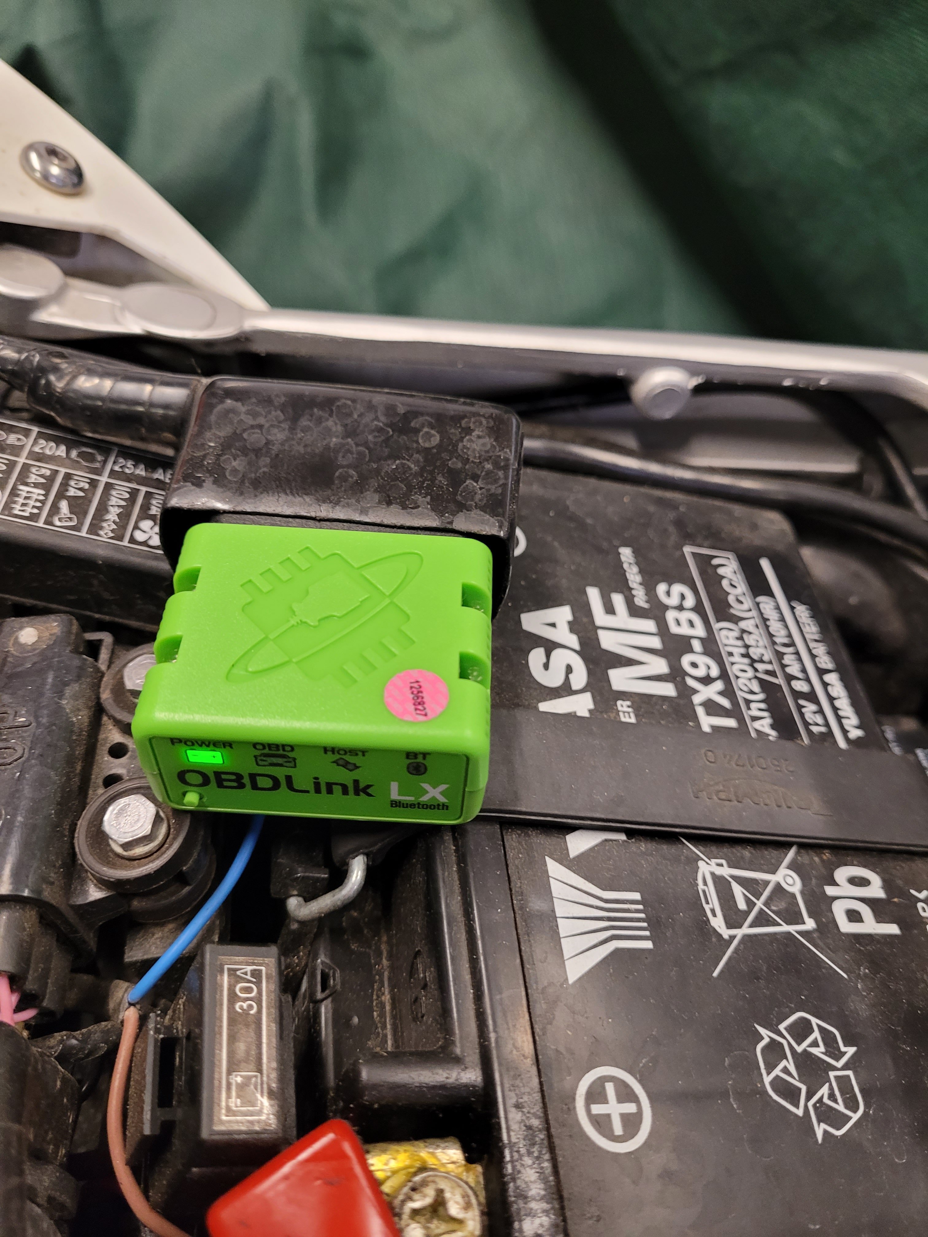

    For a code reader you could try one of these below.
    I switched my 765 on with the tank removed and it put the EML on. This soon sorted it.
    Readers with leads are ok with earlier bikes but don't work on later stuff as it has to be by Bluetooth.
    Can someone confirm the reverse isnt so meaning you can use Bluetooth on older models?
    On later stuff you also need to balance throttle bodies by electronic readings hence why I bought it initially.
