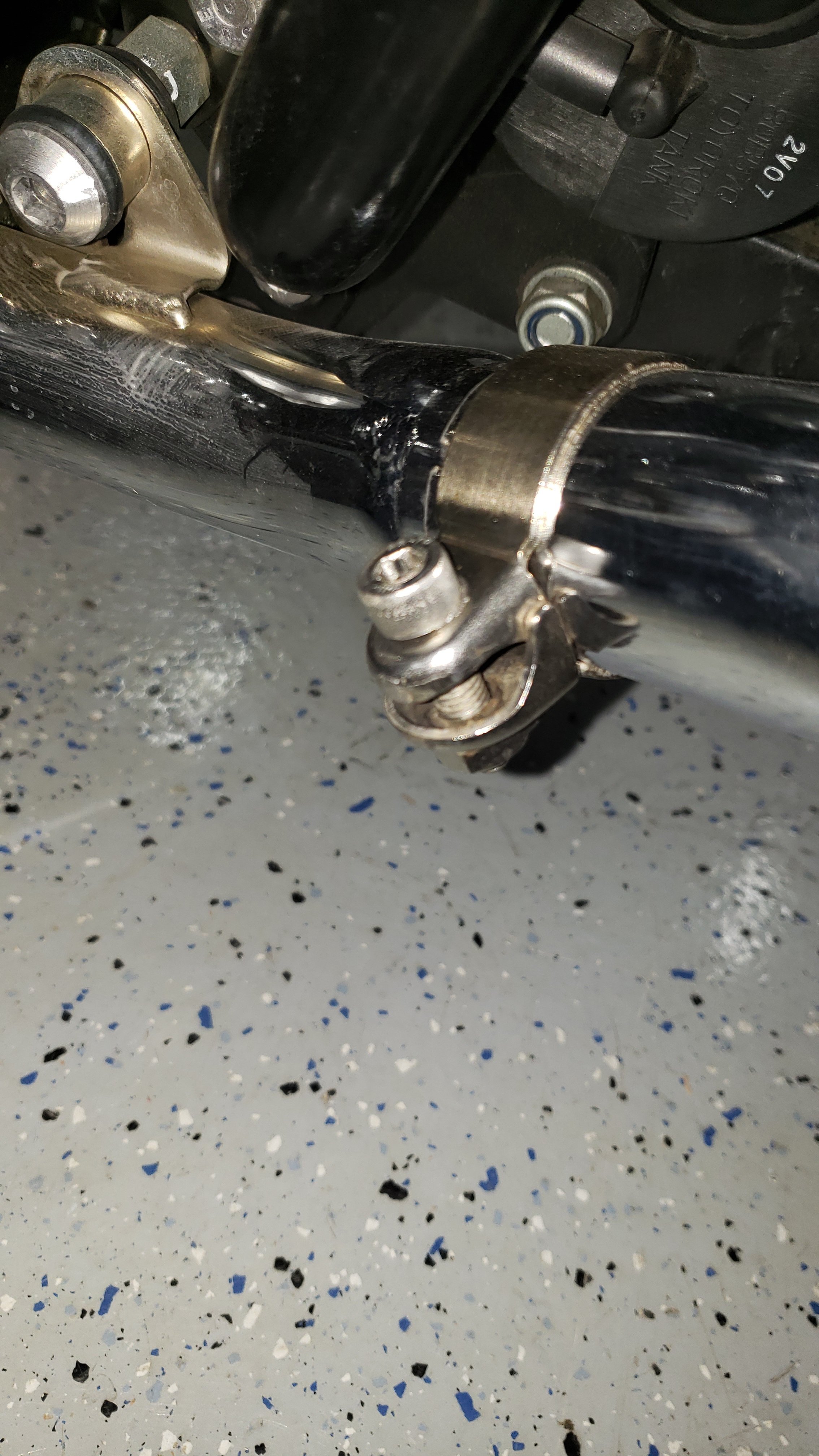

    I don't know much about motorcycle so I don't understand all the suggestions. Take a look at the Gap in connecting the exhaust pipe. I tried to reduce the space but I'm unable to do so based on where the rear foot peg is. I've tighten the clamp but there still some play in the pipe. I don't want to over tightened and crimp the pipe. 20190825_110104.jpg

    Has it already been over tightened? It looks like the bolt head might have pulled through the exhaust clamp.

    just remove the silencer and put a light smear of silicone sealant around the edge that connects to the header pipe.
    I find silicone is much better than gun gum as it does not harden and crack

    Sorry that was a picture without the bolt on.

    Yes, the bolt was obviously missing but the clamp looks damaged!!

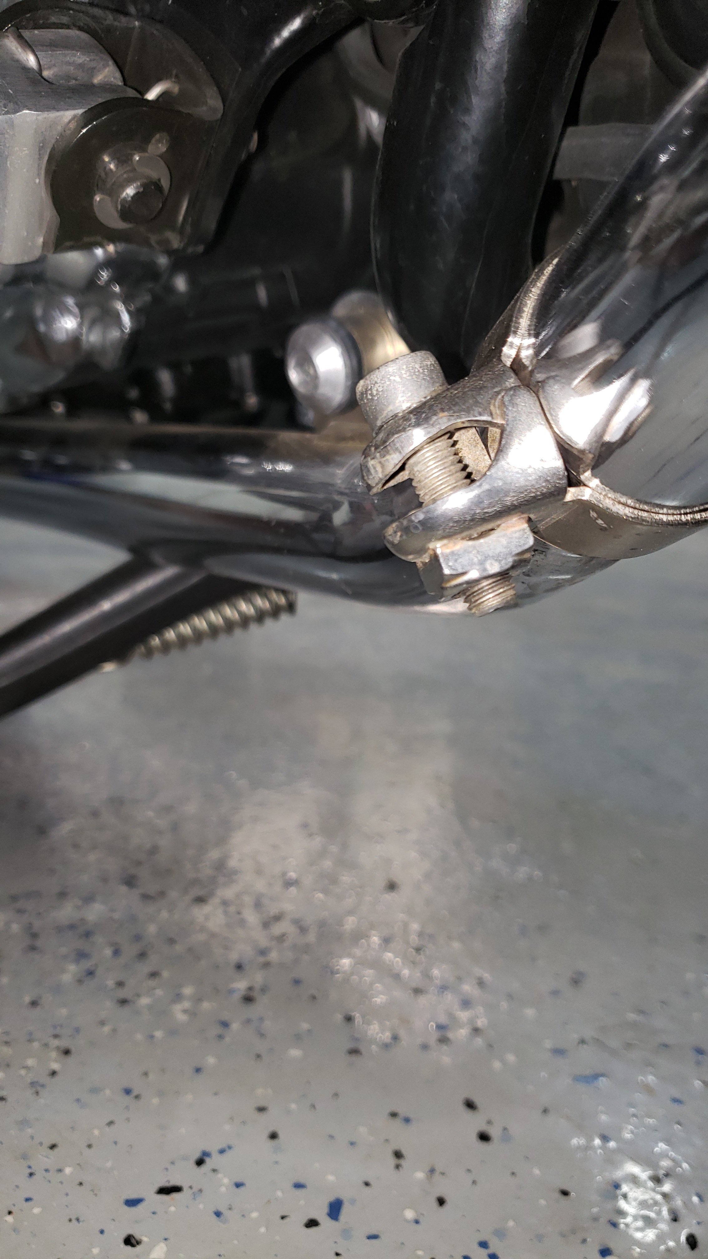

    Here are two better pictures.

    Same thing happened to me , can anybody point me as to where I can get new bracket etc Ta
