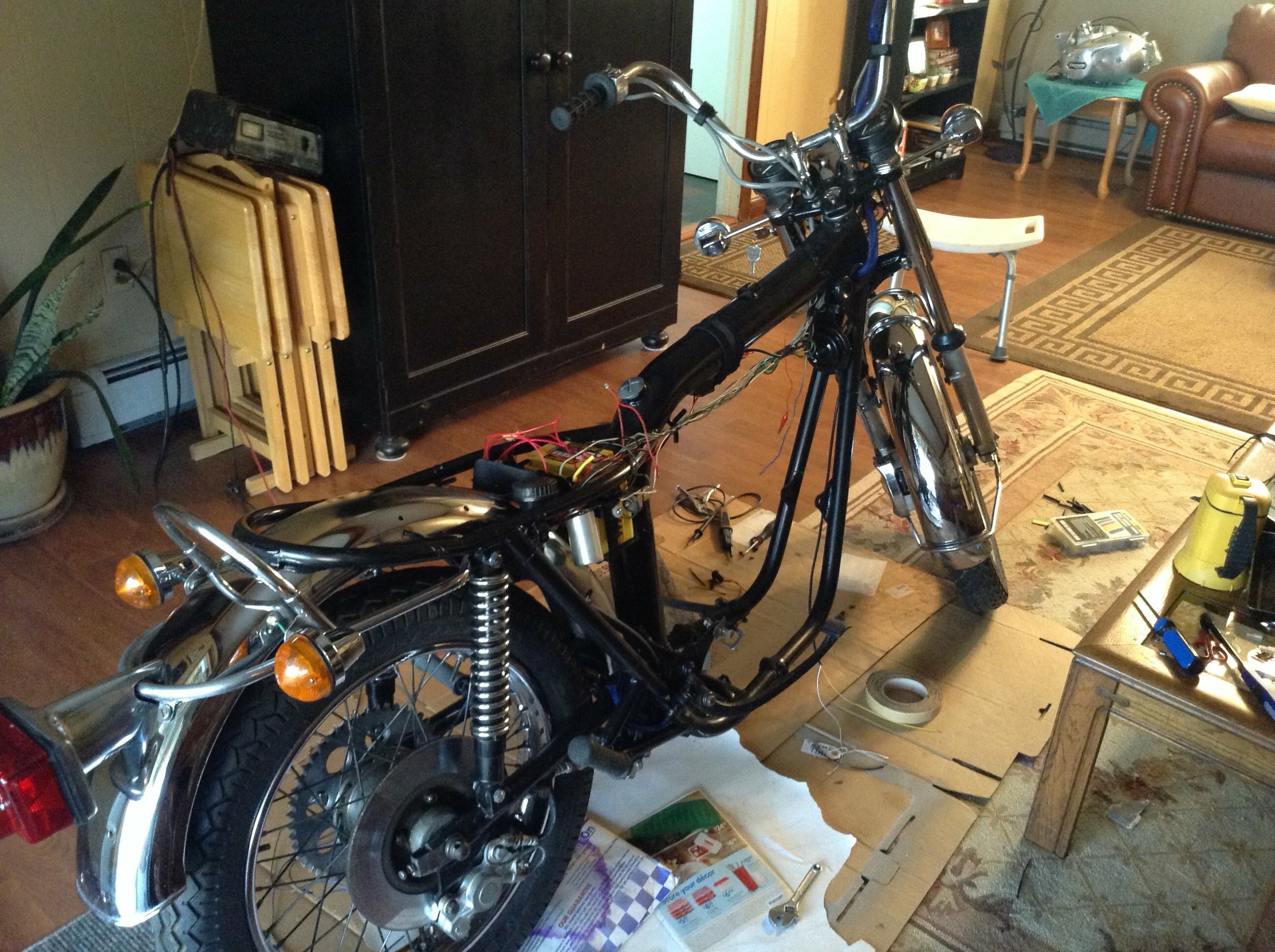

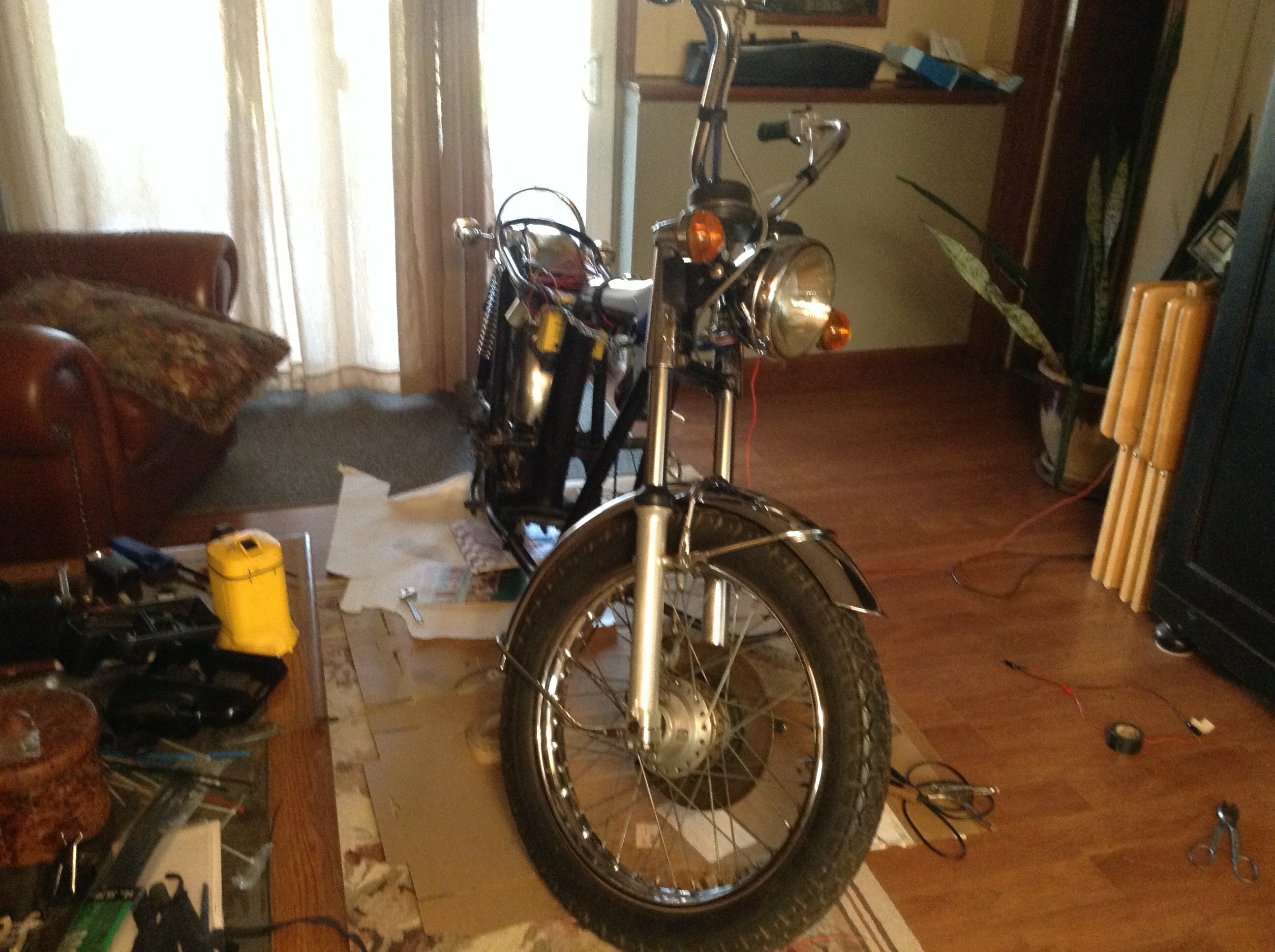

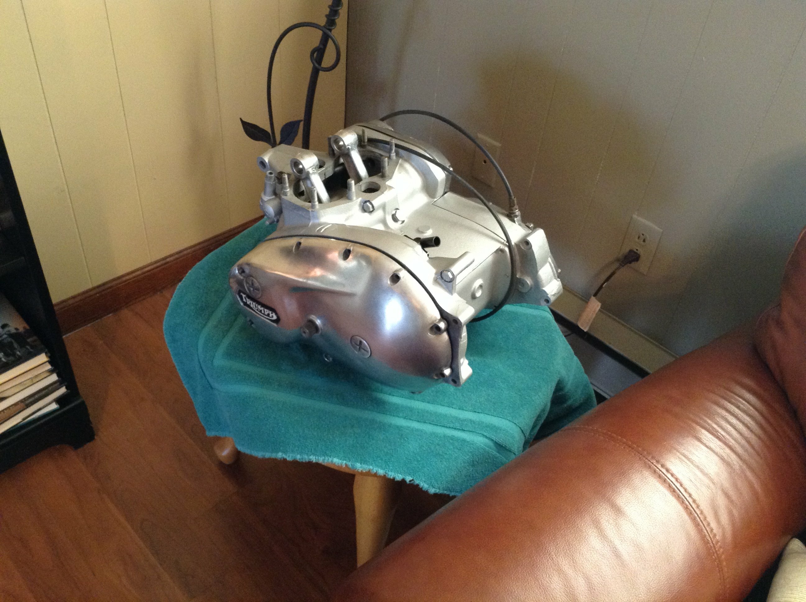

    Hey Wessa, just finished wiring the bike. Have no experience with electrical wiring so it was an interesting journey. I panicked a little when I realized it was positive ground, but one step at a time, and some help from darkman I got more comfortable with a wiring diagram and with a lot of trial and error I got through it and everything seems to be working. Still have to wire the engine. The bottom is all assembled but the. Jugs are being machined .20 over and haven't got them back yet. It's been a lot of fun and has kept me buisy this winter. Thanks for the interest. Dennis

    Wow it is coming along beautifully, I bet you cannot wait to get it all back together. I would love to be able to do something like that, but I'm afraid it is well beyond my capabilities.

    Hi Dennis your doing a great job there mate the pictures are fab it takes me back to last winter doing my 120.
    Still a bit of head scratching for you mate will you ride her when she is finished ?.
