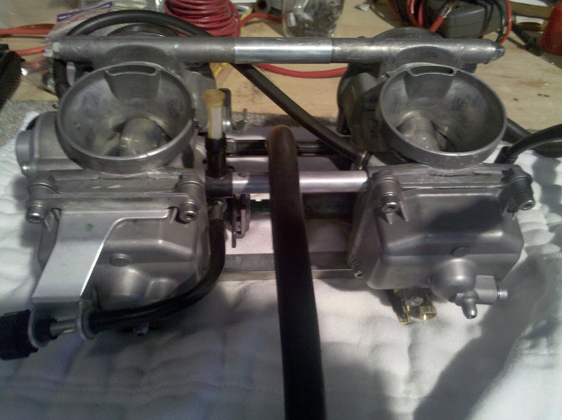

    Thanks guys. Great help. Is the filter the small white plastic rod in the photo?

    I had similar issues on my 2005 T100 that turned out to be a failing coil. In the diagnostic process I discovered a teaspoon of fine brown rust 'sand' in each float bowl and a partially clogged inline filter. If you have not had them off, you might find it a worthwhile late spring clean along with a tank flush.

    Yup the small white rod. And my ignition coil only sputtered below 3,000 rpm which threw me for a while.
