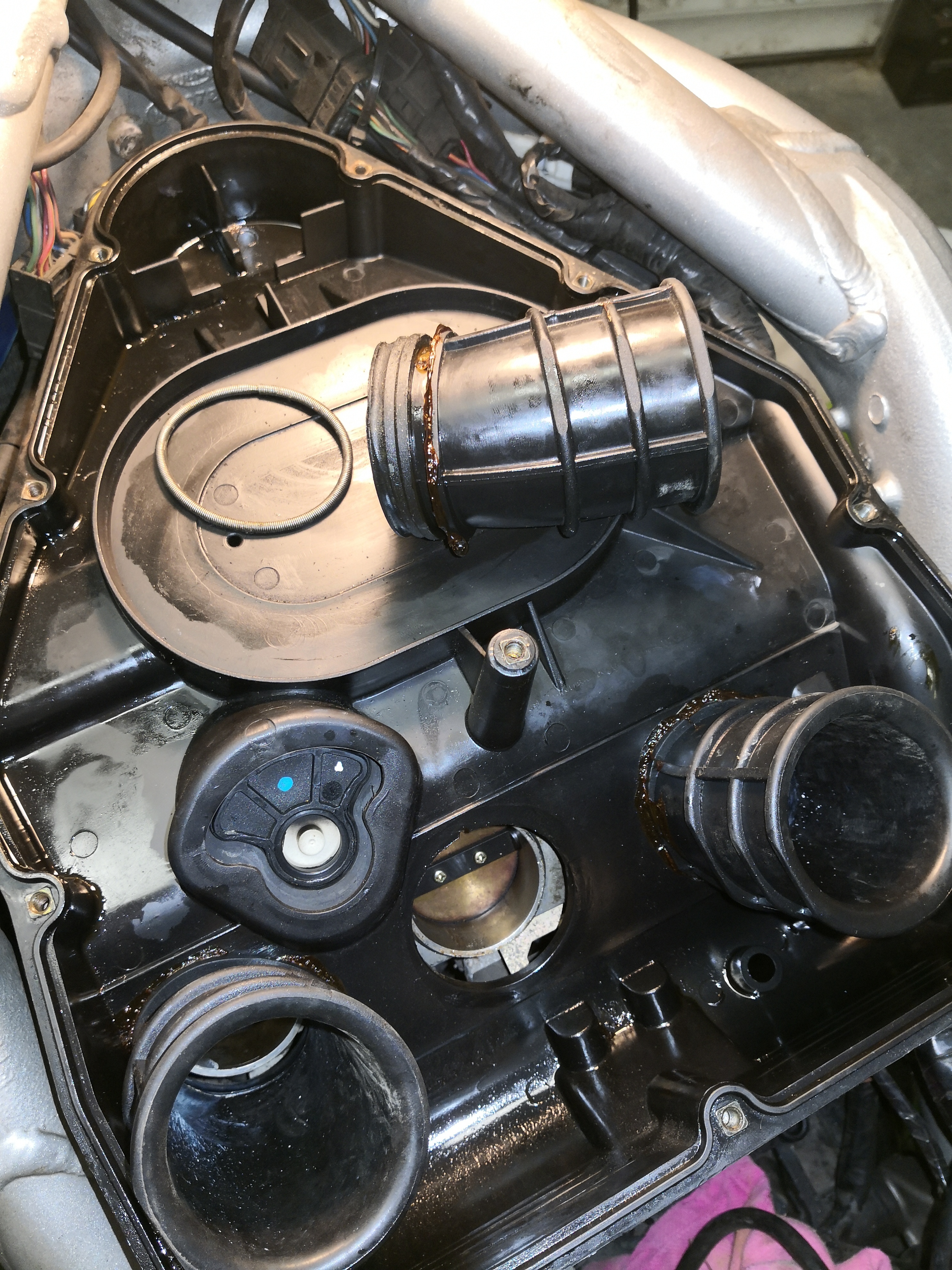

    Yes it is number 29, the Oring which will seal the transition tube to the engine intake which in turn is held to the throttle body with the expandable clamp.
    To check for leaks here just squirt a little carb cleaner (only a little) around each tube in turn while the engine is running and see if the revs change. If they do then there’s a leak.

    Interestingly (debatable, I know... depends on your pov ;)), but I think these O rings look pretty sound from what I can see with the throttle body currently in situ, the rubbers still feel flexible with no immediately visible deterioration...however...the rubber 'trumpets' going down from the airbox onto the body did have a misaligned connection with the rim of the boot snagged and not entirely over the centre air inlet (is that the hole that has the butterfly in it that the throttle opens?)... And the bottom rim of that trumpet has thick white brown oily sludge around it..
    Next ache...is removing the throttle body (or "dislodge" as Mr Haynes calls it), so I can finally replace the throttle cable... requiring another bloomin gasket when I replace the body... Any advice on THIS activity...? Am I headed for disaster, or is it just screws and nuts...?

    You may well have uncovered the problem Daniel.
    If the rubber boot wasn’t seated properly it could have been introducing an air leak.

    You do realise I am building up to a question of "how the 'freck' do you get these boots on and sealed when its all 'under' the airbox"...any tips...?
  10. freck
    freck Elite Member
    May 4, 2017
    1,721
    Preston, Lancs, UK
    I would suggest that the bottom part of the airbox should be able to be removed. You can then fit the rubber boot back into it properly (looks to me like it should fit into the airbox hole) and then fit the bottom part back while wiggling the boots back onto the top of the throttle bodies.
