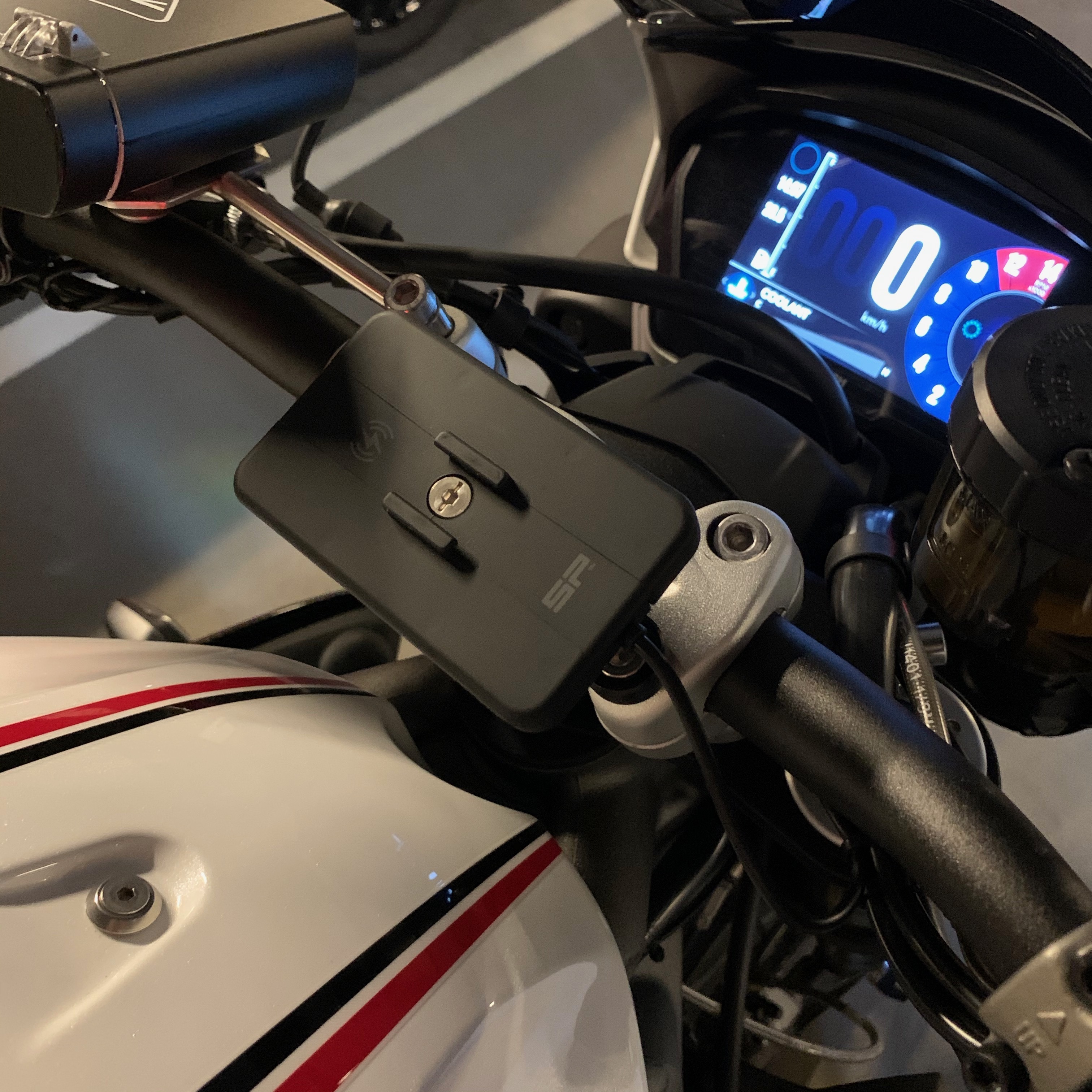

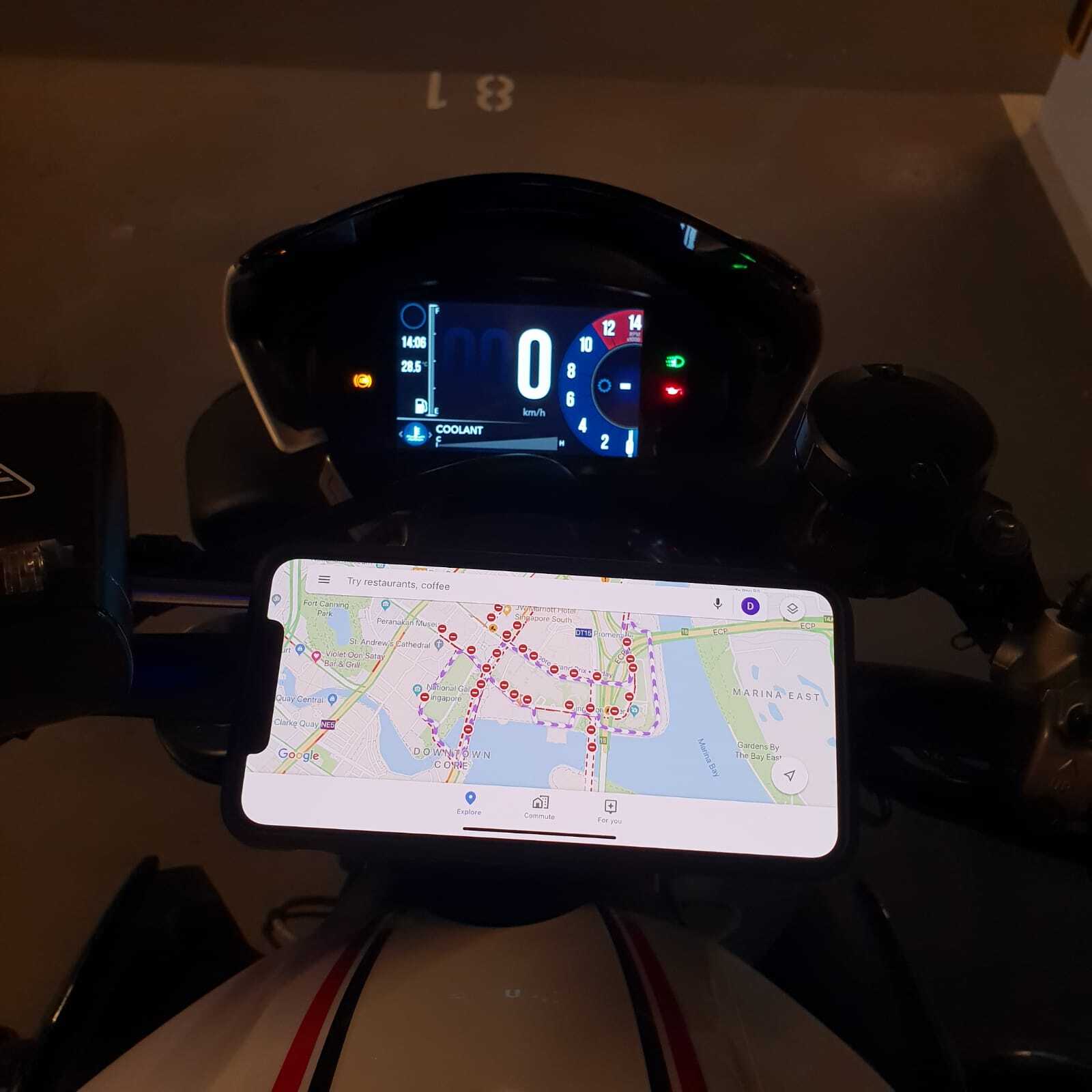

    Hi Stuart. Lockdown in Singapore means I shouldn't be messing with my bike in the communal basement - but I will try to explain.
    I have the 'Bar Clamp' mount - pic below. When I first got my Speed Triple, my first thought was to reuse my existing QuadLock mount (that attached to the bar).
    However, I quickly realised that there isn't a section of 'flat' bar anywhere. As the bar comes out the clamp is almost immediately bends, and it then only really offers a suitable mounting spot near the grip - not what I wanted.
    Consequently I decided to buy the SP Connect Bar Clamp mount - but other manufactures offer similar set ups. I removed the lower right clamp bolt, and attached the mount with one of the longer bolts supplied in the kit.
    The reason you can't see the mount is because I have the wireless charger pad fitted - but you could obviously put the phone straight onto the mount without the charger. In my picture, you can just see the edge of the mount below the cable.
    If you wanted the exact same setup, you would need the following from SP Connect....
    Bar clamp mount (pic below)
    Wireless charging pad
    Cable
    Case for your phone
    I ran the cable to the socket under the seat and took switched power from there.
    There is now a 'Bar Clamp Pro Mount' with more adjustment, but this wasn't available when I ordered mine, so I have the plane old 'Bar Clamp Mount'
    Let me know if this all makes sense. If not I will pull the charger off and take a picture when no one is around!
    Cheers.

    Yeah I get it Dave. I got the Moto Bundle, but like you say, the bars aren't flat anywhere you want them to be. You only realise this once you have tried it. I've contacted SP and am awaiting a reply, hopefully I can swap it.
    thanks for the info, most appreciated,
    Stuart
