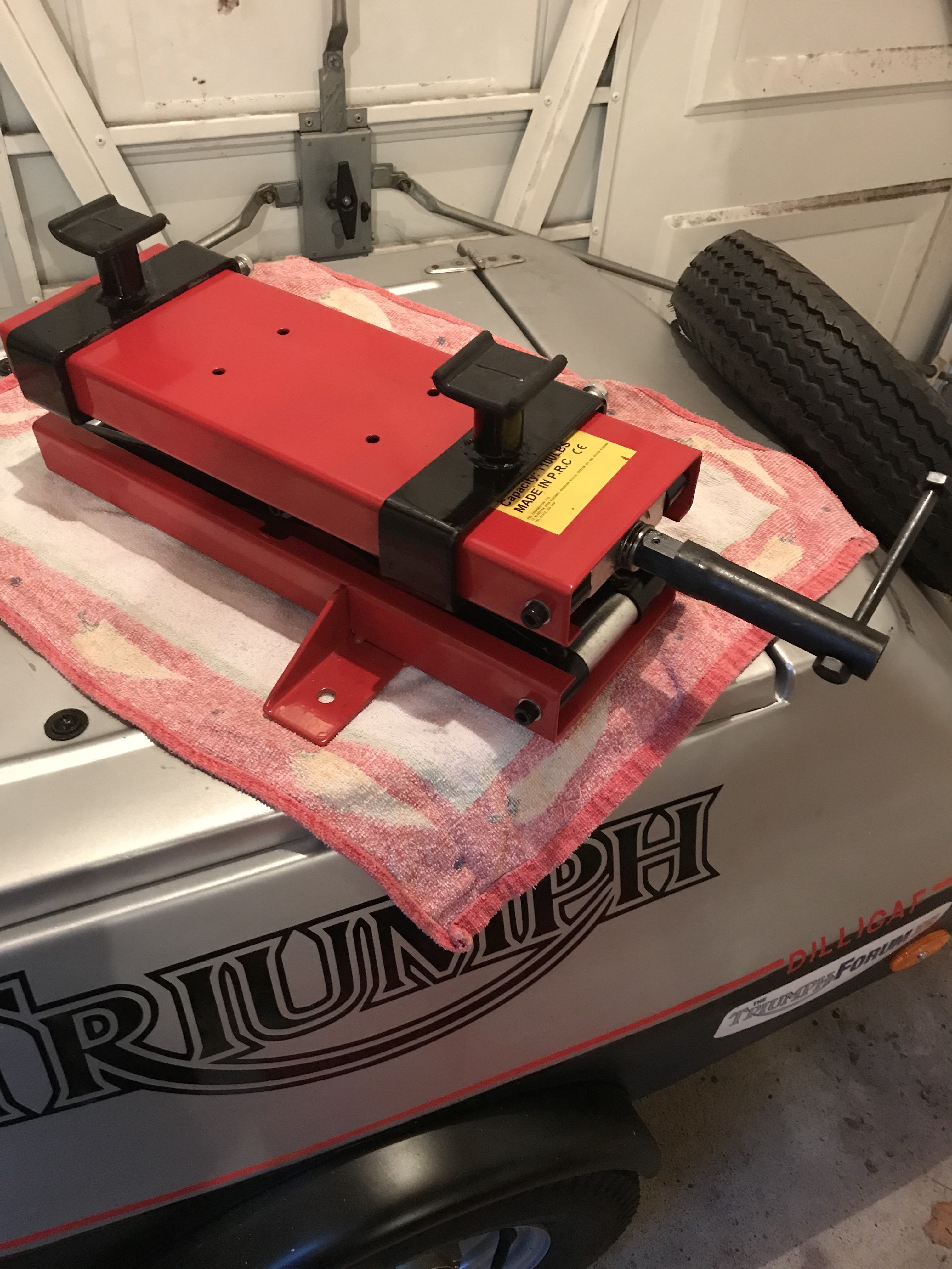

    Got this delivered today :grinning:
    It’ll bolt to the front of my bike table and when I push NUDGER into it it’ll hold him upright for me :grinning: 12F483AC-DEA9-46DD-8296-6C93678F85A7.jpeg once this is done I can measure and look for a suitable lift to fit underneath the frame (its very low):confused:
    Then with the use of straps I can lift the front or the back end for wheel cleaning and other maintenance stuff :p

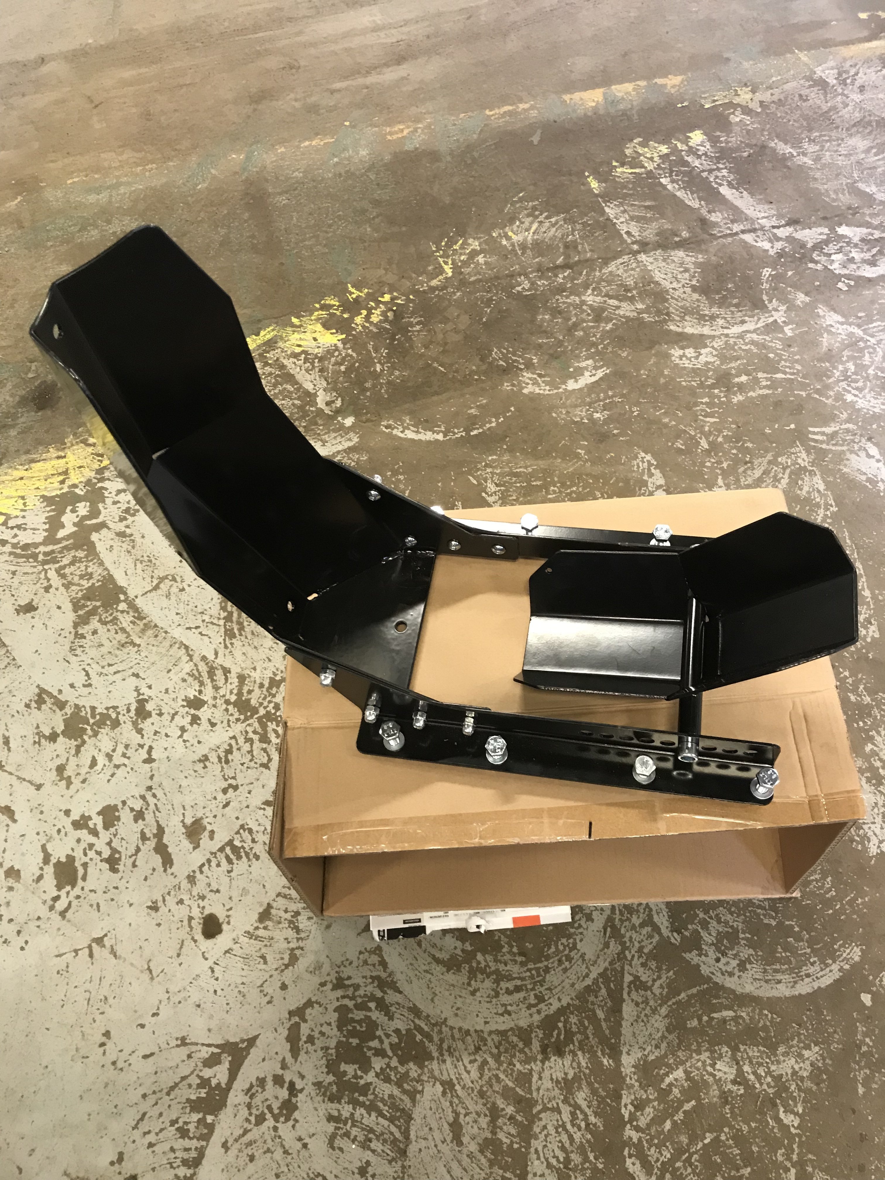

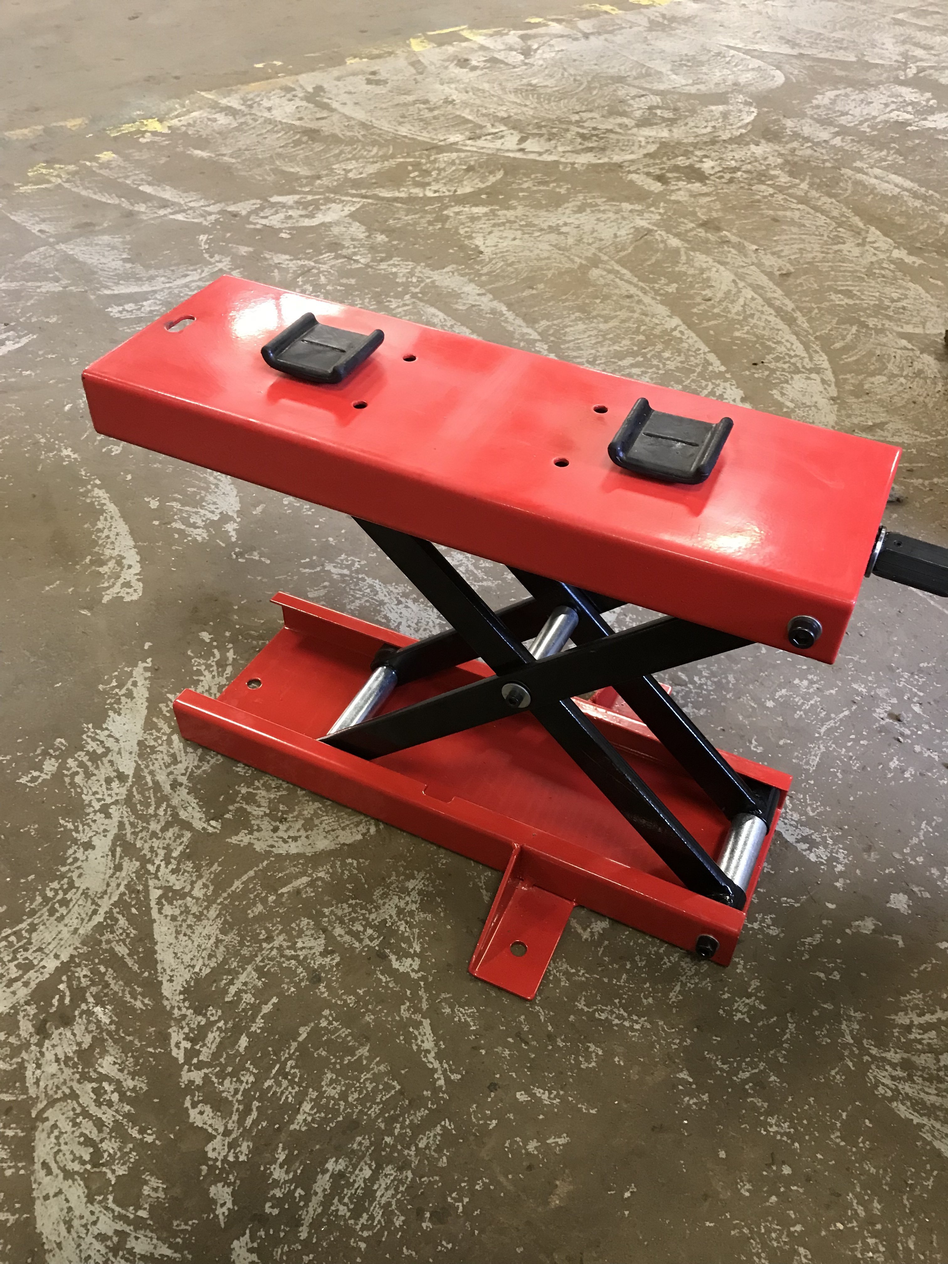

    This arrived today :)
    :( Won’t fit under the bike :sob:
    It’s ok though because I knew it wouldn’t and I have a cunning plan :p
    Been in the garage tonight and done some measurements
    The sliding clamps are getting put to one side and the cups are getting some of the threaded part cut off :eek:
    Gonna use a hole cutting tool and put two holes in the top plate in line with NUDGERS frame rails....hence the measurements :p AA0A087D-D9F8-4318-902C-B597BFB0AD27.jpeg was tempted by the Oxford stand as suggested by @Beerman but by using this and some straps to my table lift I will be able to use it to lift the front end as well as the back end :grinning:
    That’s the plan anyway :confused:

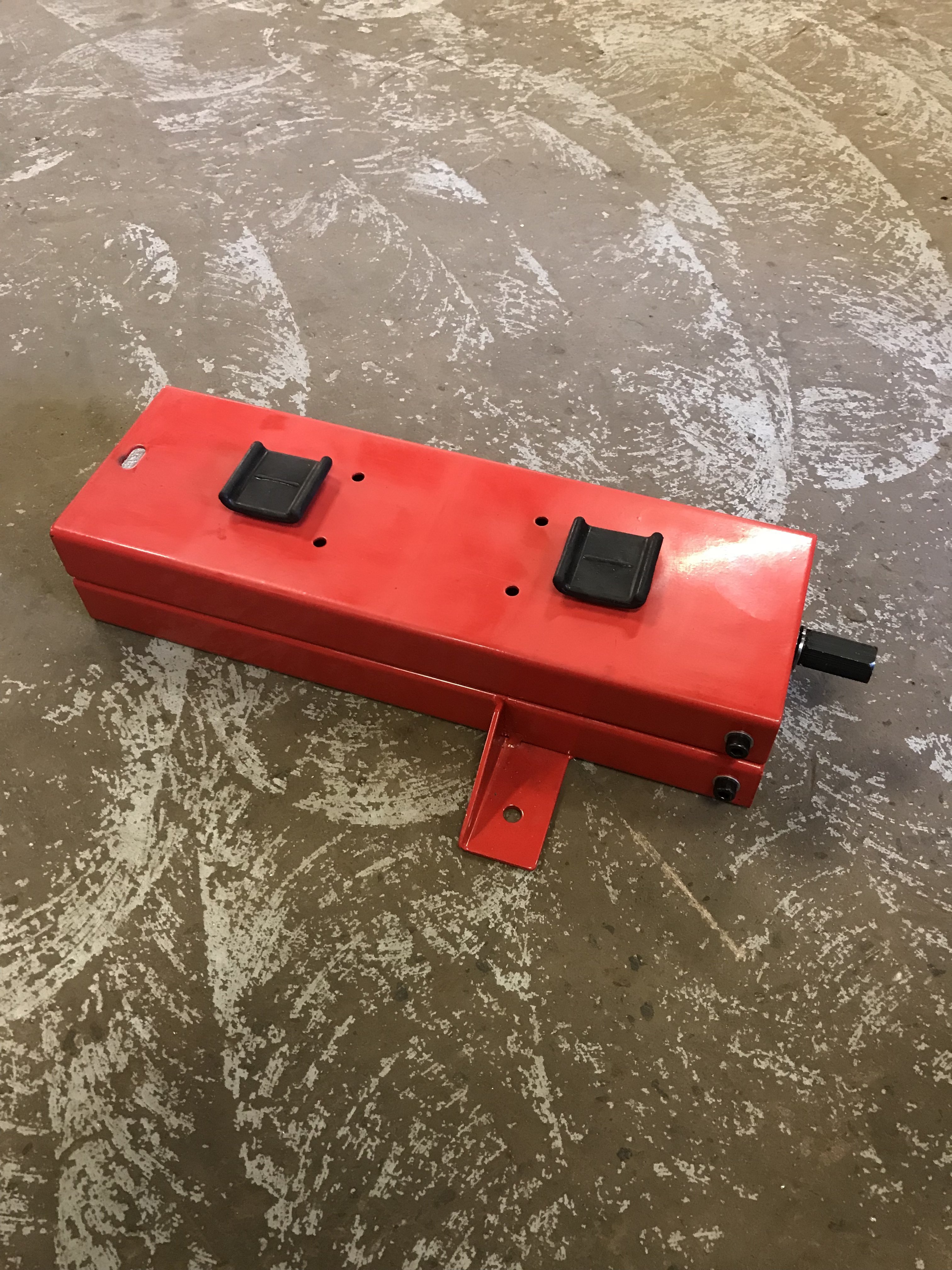

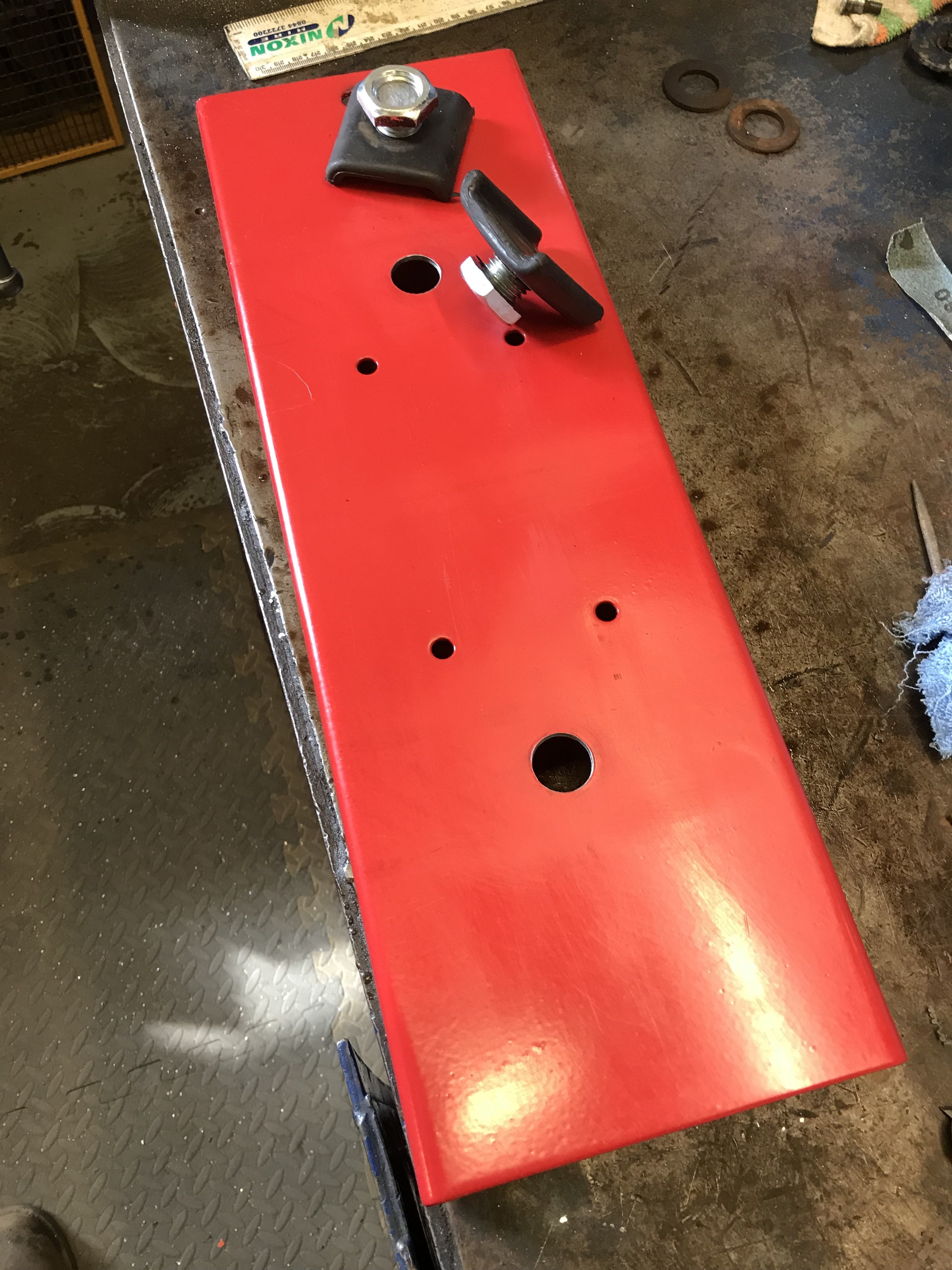

  14. dilligaf
    :) Holes cut and cup threads cut to size :)
    Had to cut a nut in half to hold the cups in place :)
    Job done :p E6D3A0FE-DB4E-4A07-8B18-47FFC0E89579.jpeg how high do ya wanna go :eek: 0AC67959-016E-4C1C-B5B6-067B1E4FA8CB.jpeg now it’ll fit underneath NUDGERS fat belly :cool: BC5788E3-3D70-460E-9B38-AFBD1A83F081.jpeg

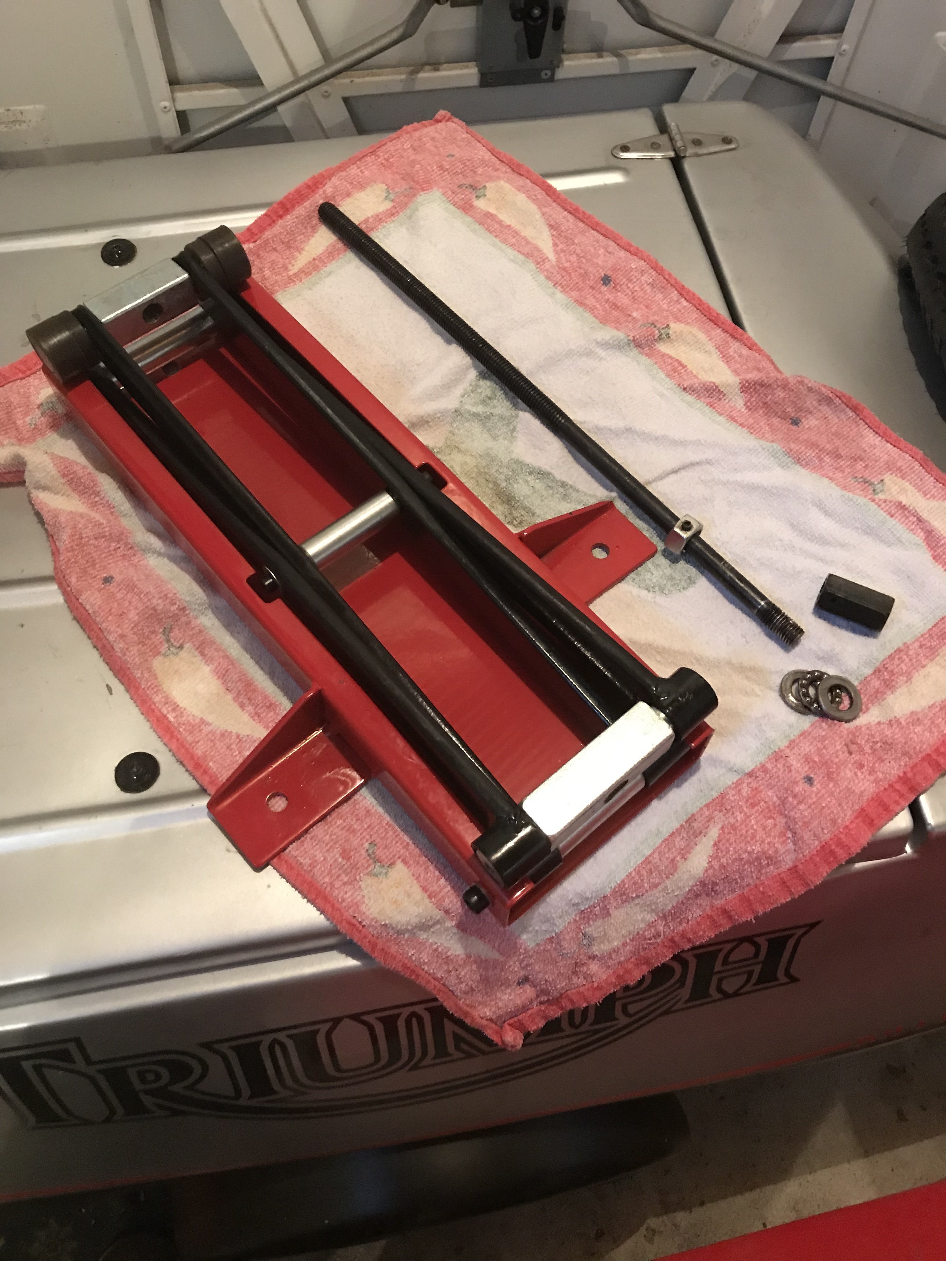

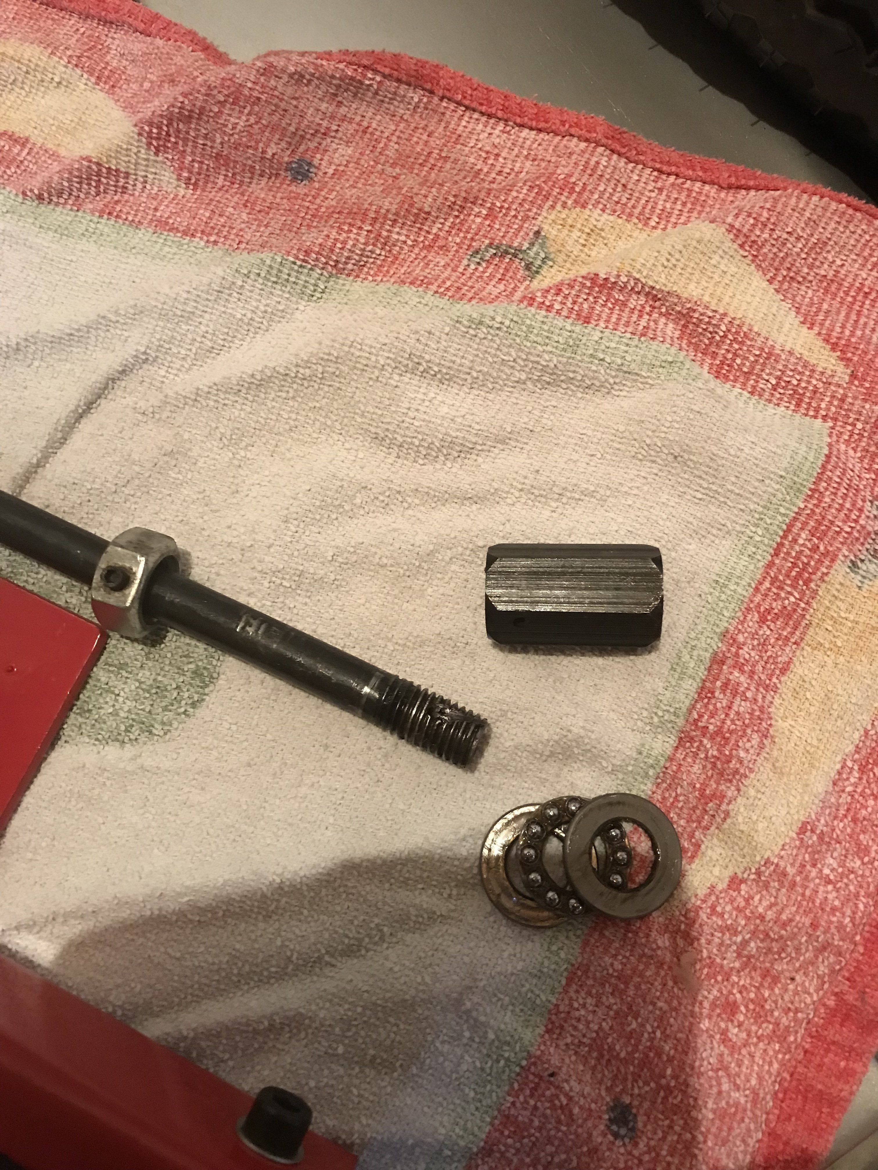

  18. dilligaf
    :mad: DO NOT GET ONE OF THESE :mad:
    Feckin thing COLLAPSED :eek: before it even got the back wheel off the table :mad:
    Feckin cheap Chinese shit :mad:
    :mad:BE WARNED ITS CRAP :mad: 62CA8621-592D-44FB-B3C0-BD73CE99686F.jpeg 37DCE73E-292B-4DD6-B48C-118A5AFC7CD2.jpeg
