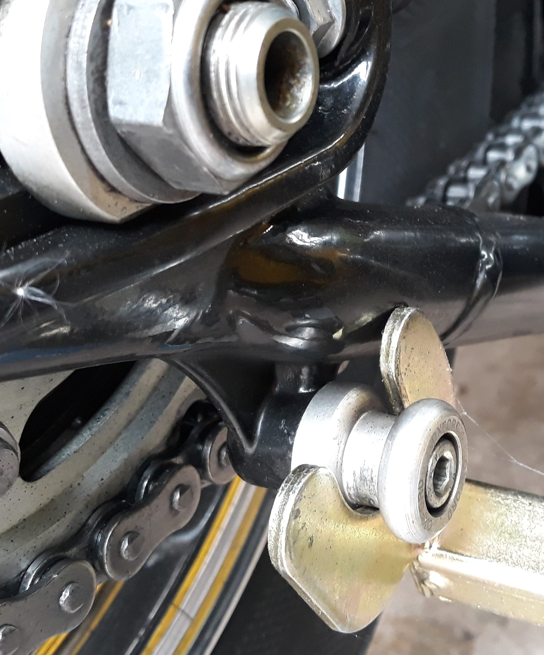

    Bought this one and it seems OK, only problem is I can't lift the back end to get it on the stand, the wheels just don't seem to want to move it over the pivot point.
    Where have you attached to Bobbins, I have used the 2 lower points but noticed there is another hole higher up.

  9. Beerman
    Beerman Guest
    I will put a picture up tomorrow - it's on the lower holes, and I haven't had any difficulty.

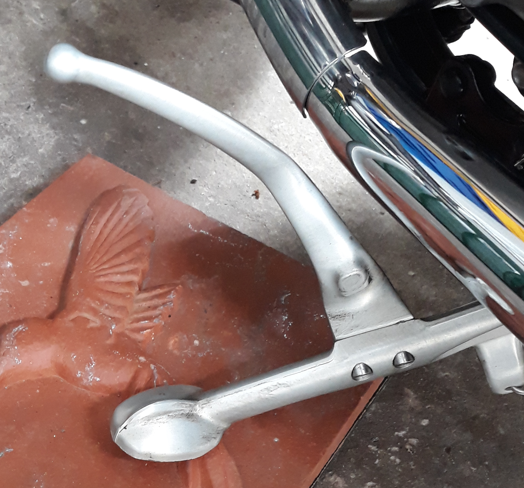

    My technique:
    1. Turn bars to LEFT
    2. Put tile or similar under side stand (pic1) - bike leans SLIGHTLY to left
    3. Left hand on seat bars, right hand push stand down. If bike falls (not happened to me - yet!) the bike will fall on to the side stand.
    4. Reverse - bike 'falls' onto side stand.
    You might want to place a plaster where the bobbin may - just - touch the frame, though mine is not marked.
    Hope that is clear!

  13. Beerman
    Beerman Guest
    It probably goes a bit wider than I have it set in the photo.
