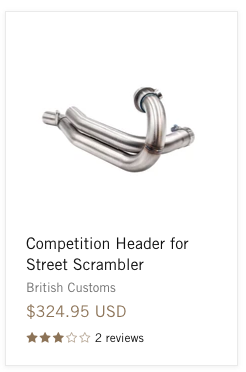

    Free Spirits seem to dominate with the H pipe, pricey as are all Free Spirits parts, but well made. There is a UK site (Squaredeals.co.uk) who sell Westlake which is most likely some Chinese products for £150, given your in Portland Oregon may cost as much to ship. You may find it easier/cheaper to buy the Vance & Hines pipe which deletes the cat.
    British Customs do a decent one
