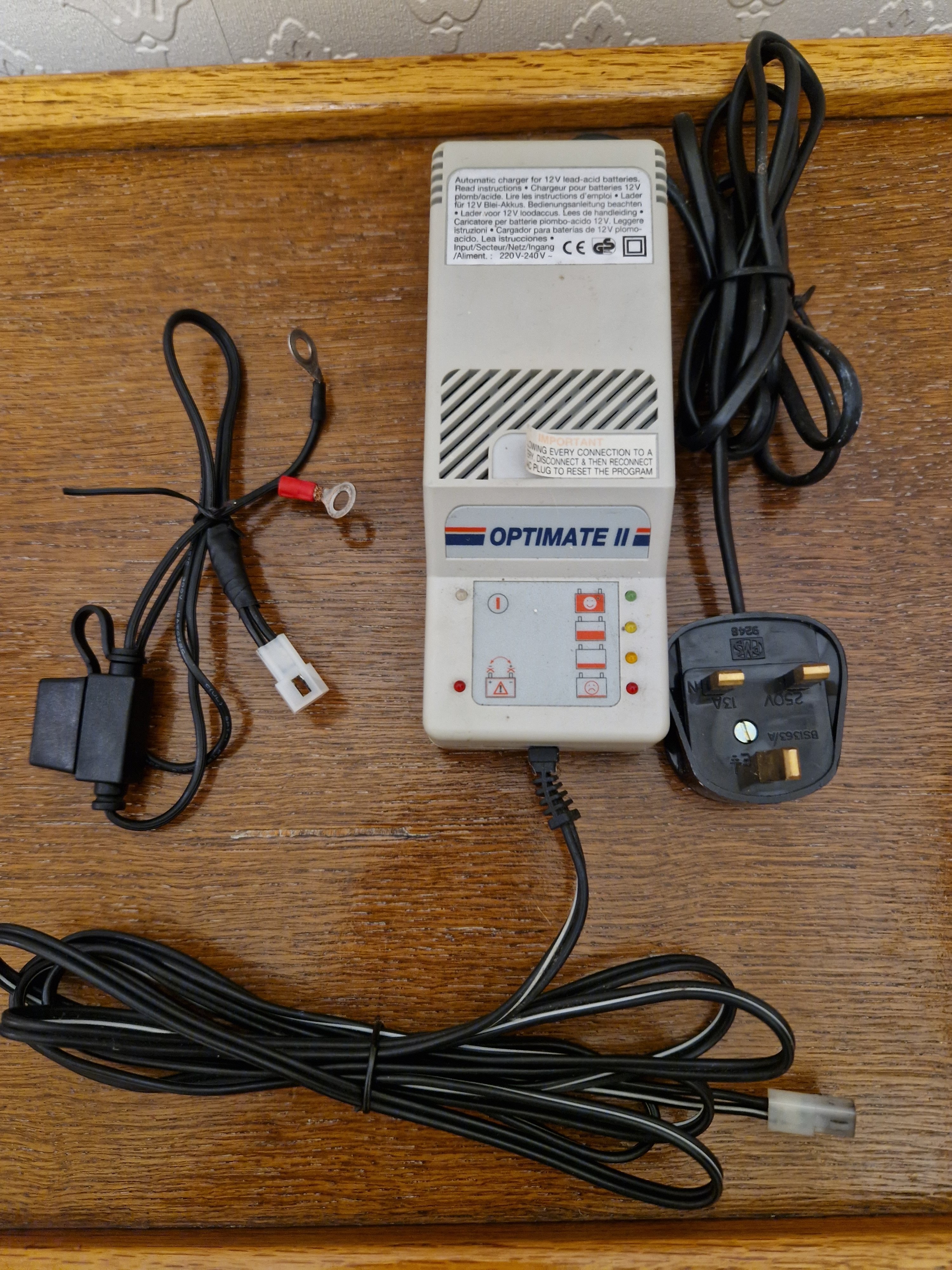

    In the UK we call them Battery Optomizers. Quite inexpensive and you don’t need to disconnect or remove the battery. You simply fit a cable with a connector to your battery and then plug it in whilst in your garage. I used to plug mine in every time it was in the garage and it kept my battery in top condition.

    The 850 Sport has a security system on board that is a constant drain on the battery. I have a quick connector on my battery and ALWAYS park it on the charger.

    Yes I have the Triumph battery optimiser (I think its made by Optimate) and keep it plugged in all the time its in the garage, because you only need a small drop in voltage to prevent engine start. You get a quick connect cable with it so just fit it to the battery terminal then tuck the connector away under the seat for example and then just plug it straight in, no disconnection required.

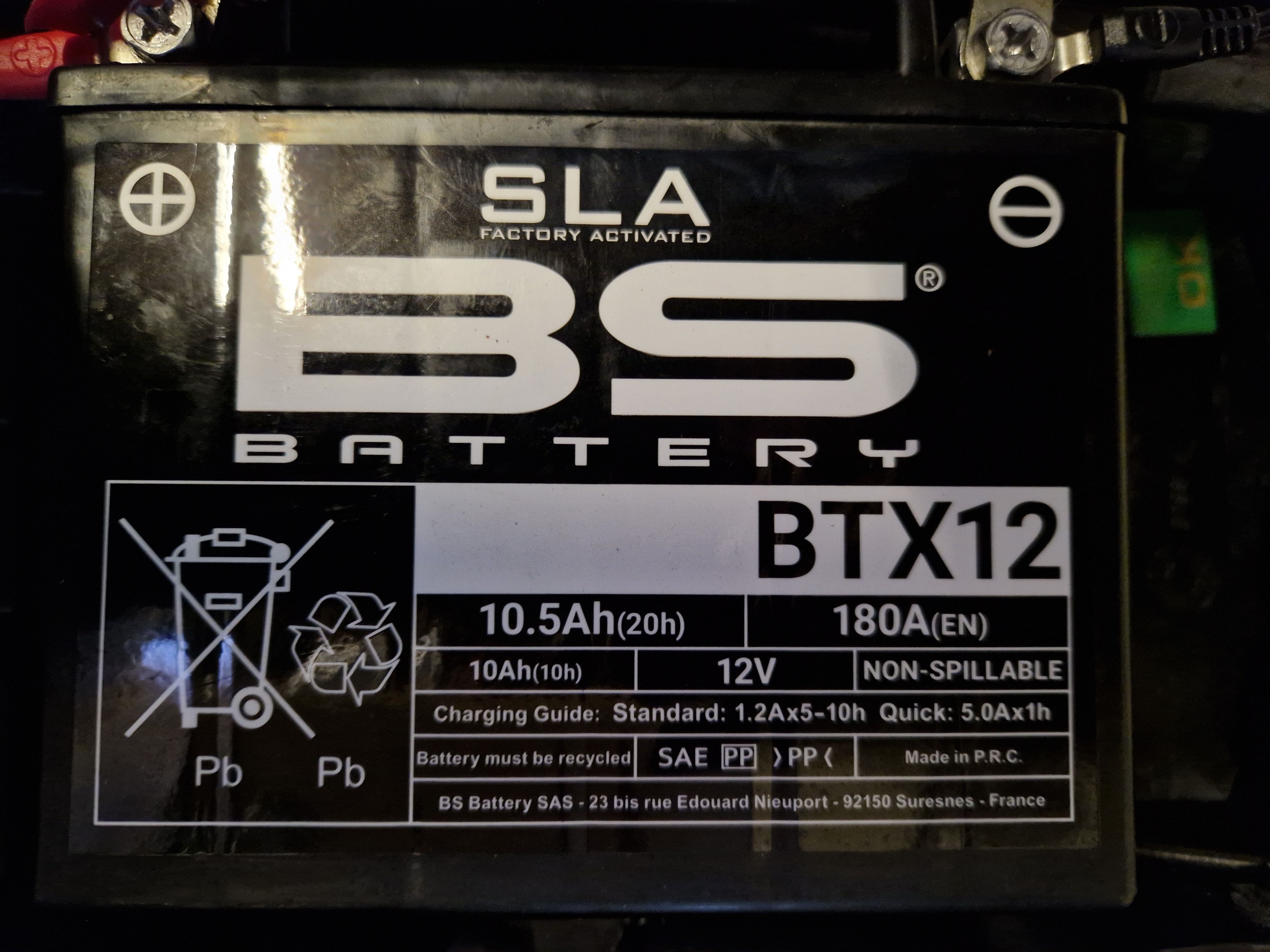

    Hi Rick..
    Th battery details are usually written on th batt. Mine is SLA. Standard lead acid.
