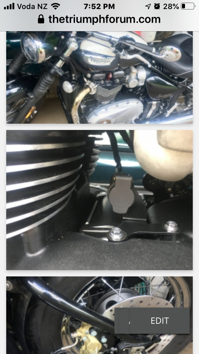

    We attached a battery tender directly to my Son’s Speedmaster. GL
  6. 45Brit2017
    45Brit2017 Well-Known Member
    May 30, 2017
    146
    I’ve fitted a tender cable to my T100. I bought a cable on eBay, fitted one end to the bike with the trailing end tucked into the saddlebag.
