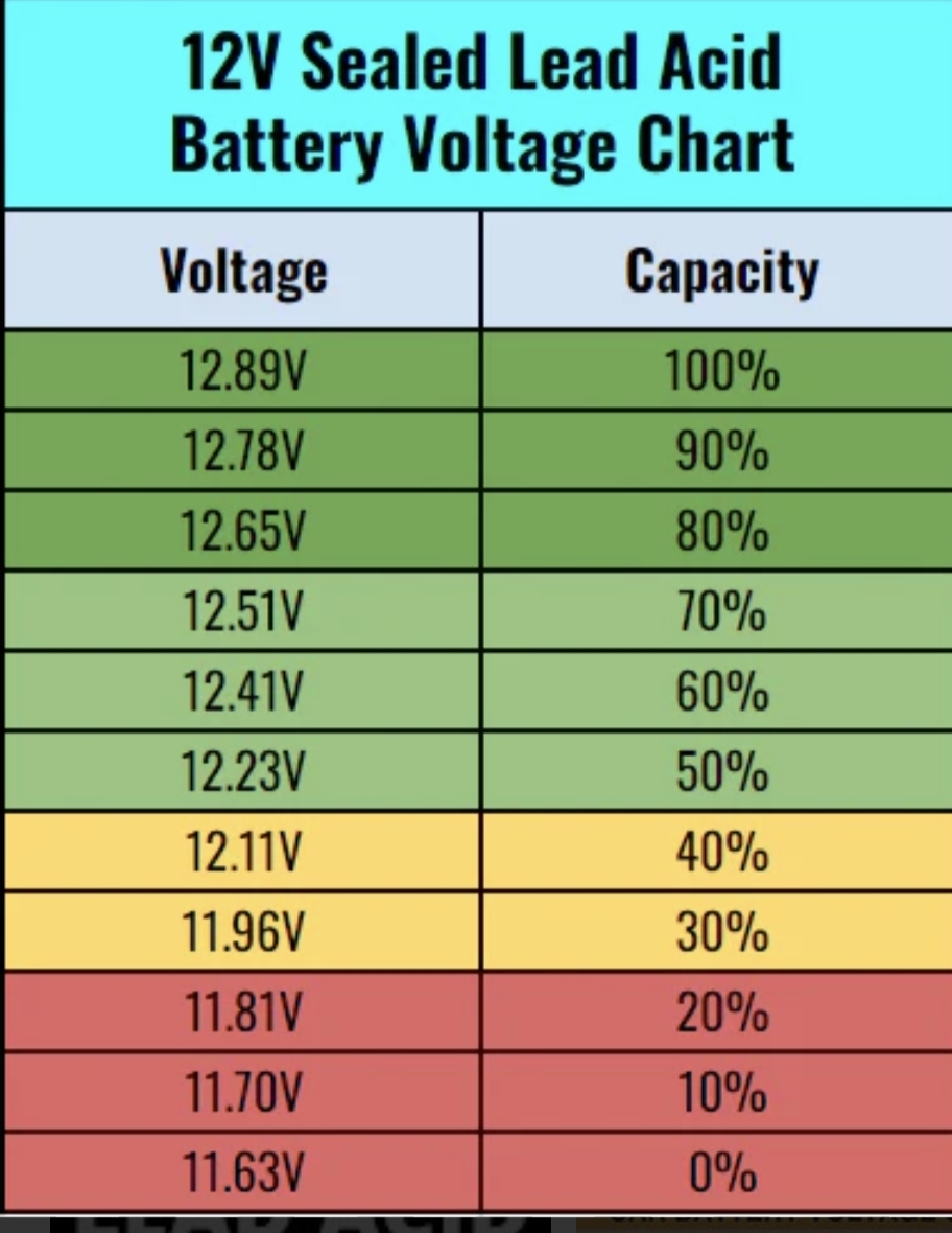

    I agree with the above, check the battery voltage, if it below 12v the battery has less than 30% of the original healthy capacity.
    My Speed Twin 1200, Goldwing and car all live on Optimate battery charger/maintainer. It saves time, money and trouble in the end. Screenshot_20250428_175002_Samsung Internet.jpg
