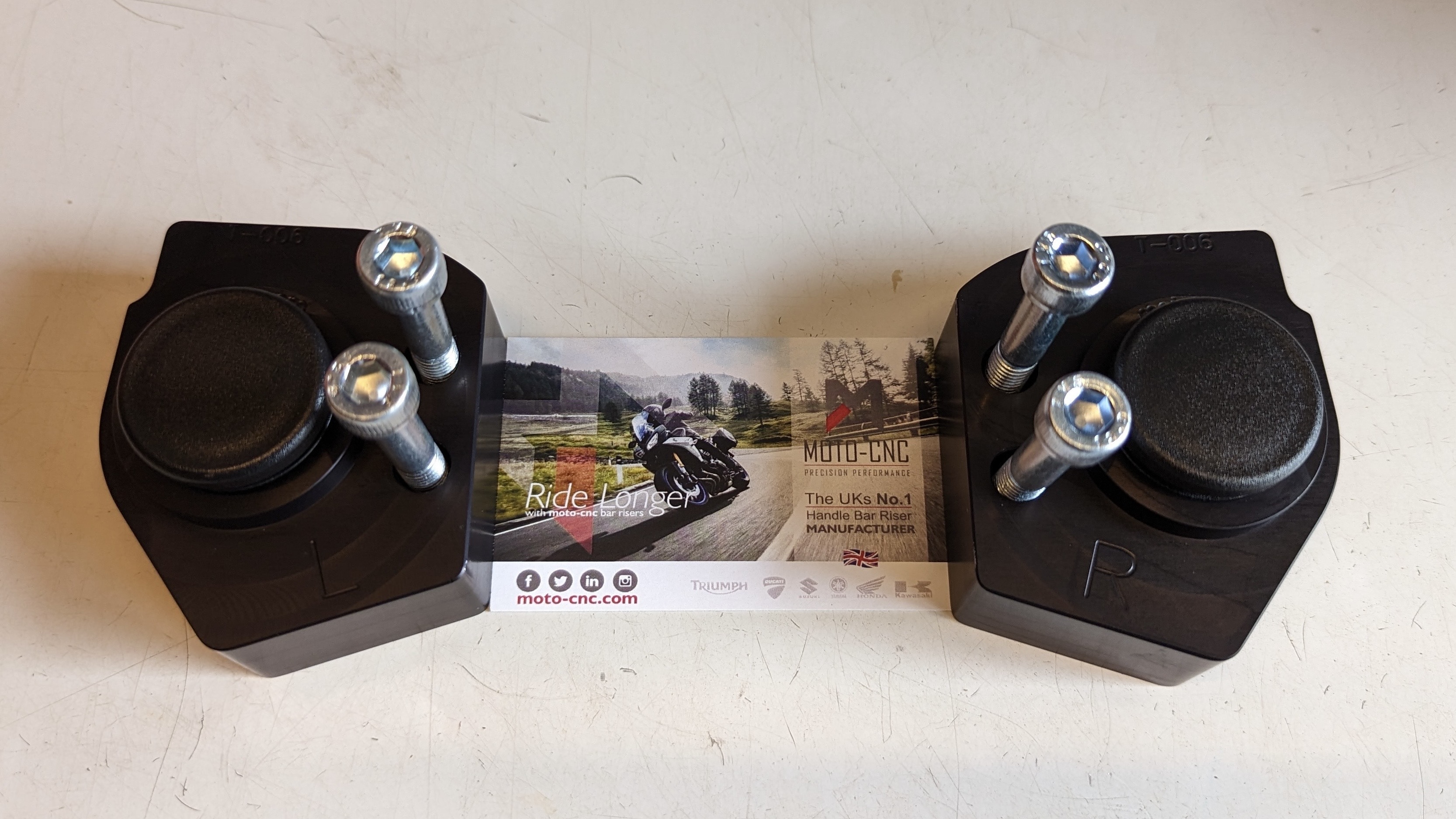

    I went for MOTO-CNC in the end based on availability.
    I fitted them in 10 minutes and will wait for some better weather to try them out. Observation wise, they are well made but for me the plastic caps don’t fit (no big deal) and the l/h switch gear nudges the fairing on opposite lock so I will need to do some adjusting.

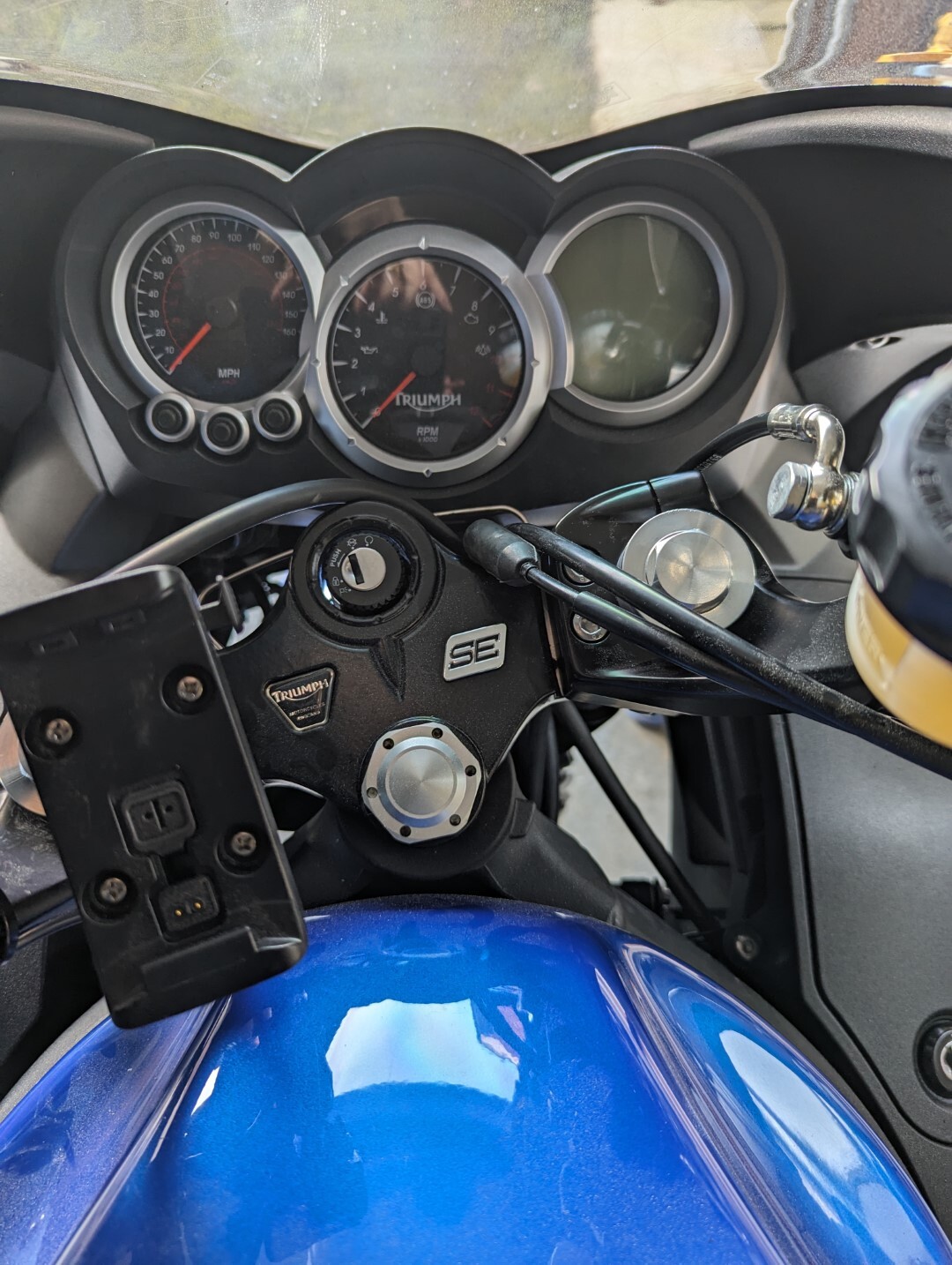

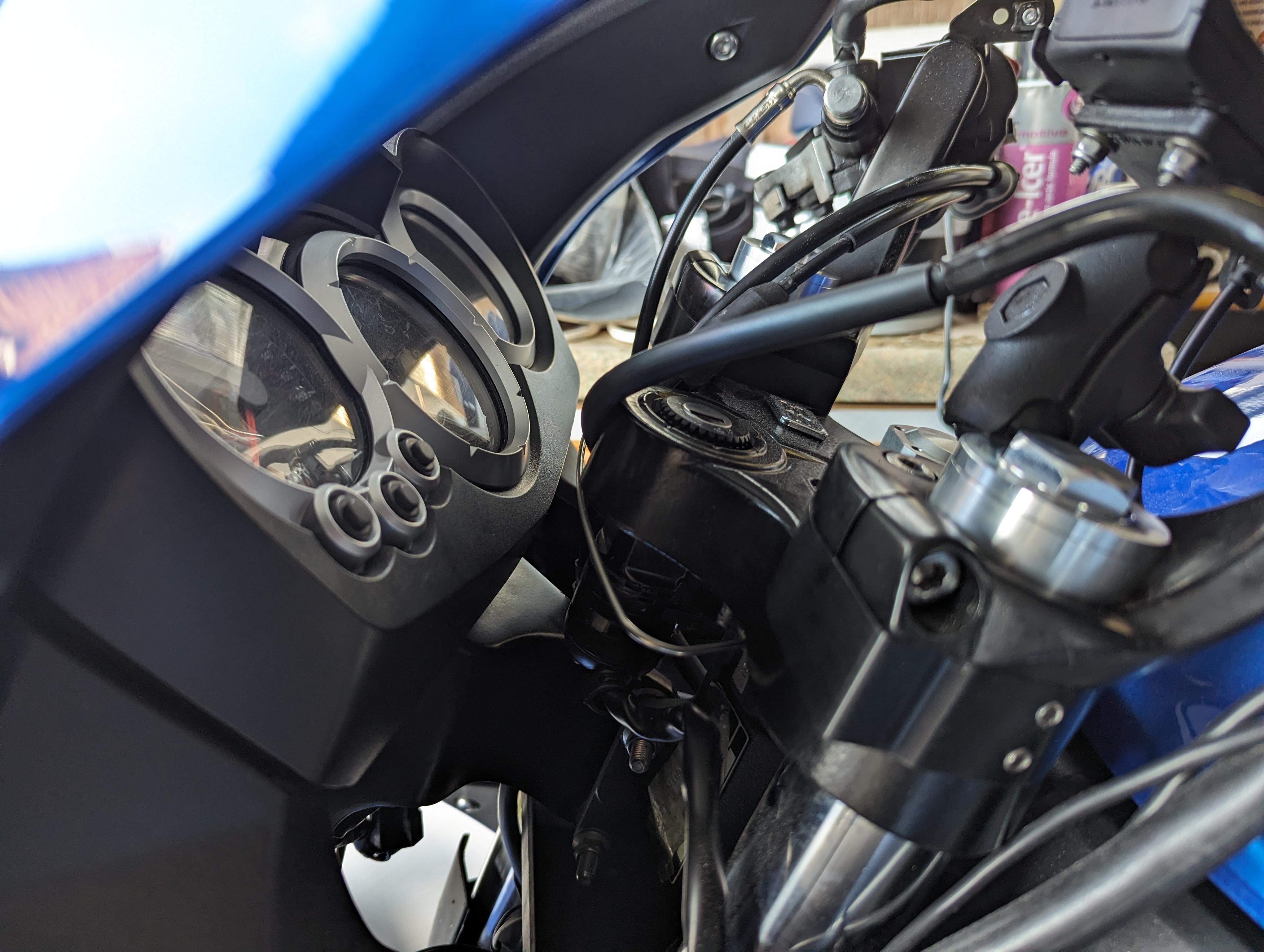

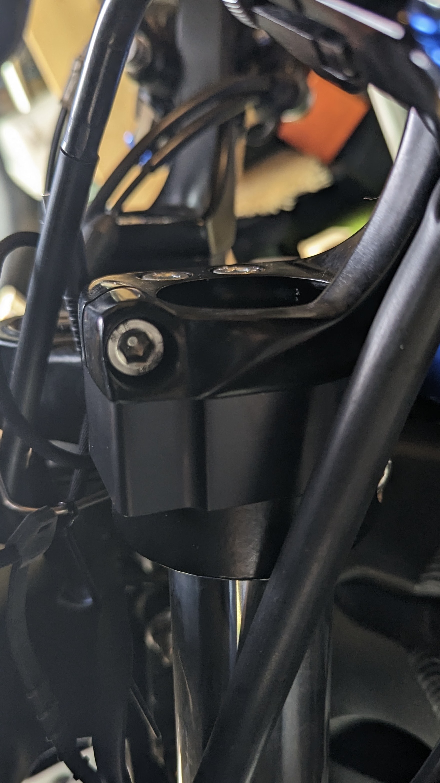

    Ended up buying a pair from another company on EBay at half of the Moto-CNC price. That company shares its business address with a known quality CNC specialist, so I'm happy. Look decent quality and have a machined filler over the pre-load adjusters instead of the poorly-fitting black plastic plug.
    Just need to find a way to reduce the tension in the clutch cable.
    Any best practice suggestions from those who have already done this mod?
    Thanks
    Pete

    For the clutch cable, you can order a new one with some extra length from Venhill https://www.venhill.co.uk/
    It will cost you around 40£ and as I'm using one since a couple of months, the quality is very good.

    I rerouted the clutch cable over the center of the handlebars, and it works well. There's a bit of an encroachment when I insert the key, but it is momentary. PS. I love the color of your bike! Sadly, I ended up with two gray ones (Sprint GT and Trophy SE, which is "Lunar Blue", aka light gray).

    Thanks for the suggestions.
    Had a go at rerouting behind the ignition switch. Seems to be free enough.
    I did look at rotating the switch cluster a tad to avoid the clash with the daring, but the heated grip cable pretty well fixed that in place, so I'll live with that. Now an excuse to check clutch adjustment is OK having disconnected the cable, since it's not raining! PXL_20231215_104603854.jpg
