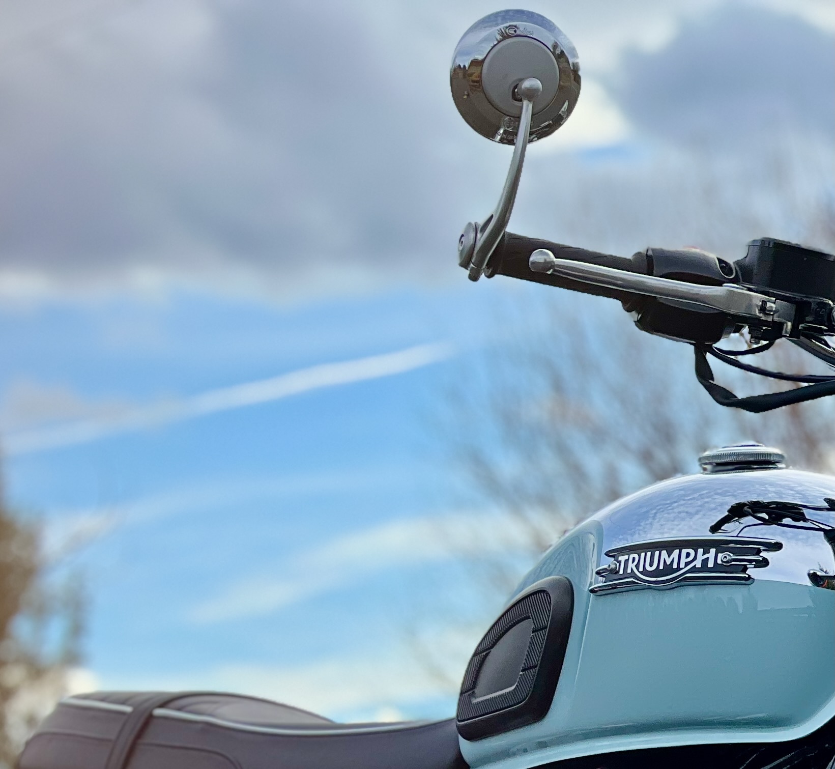

    I really like the bar end mirrors on the Speed 400, rock steady, good view and to me they look special! ;)

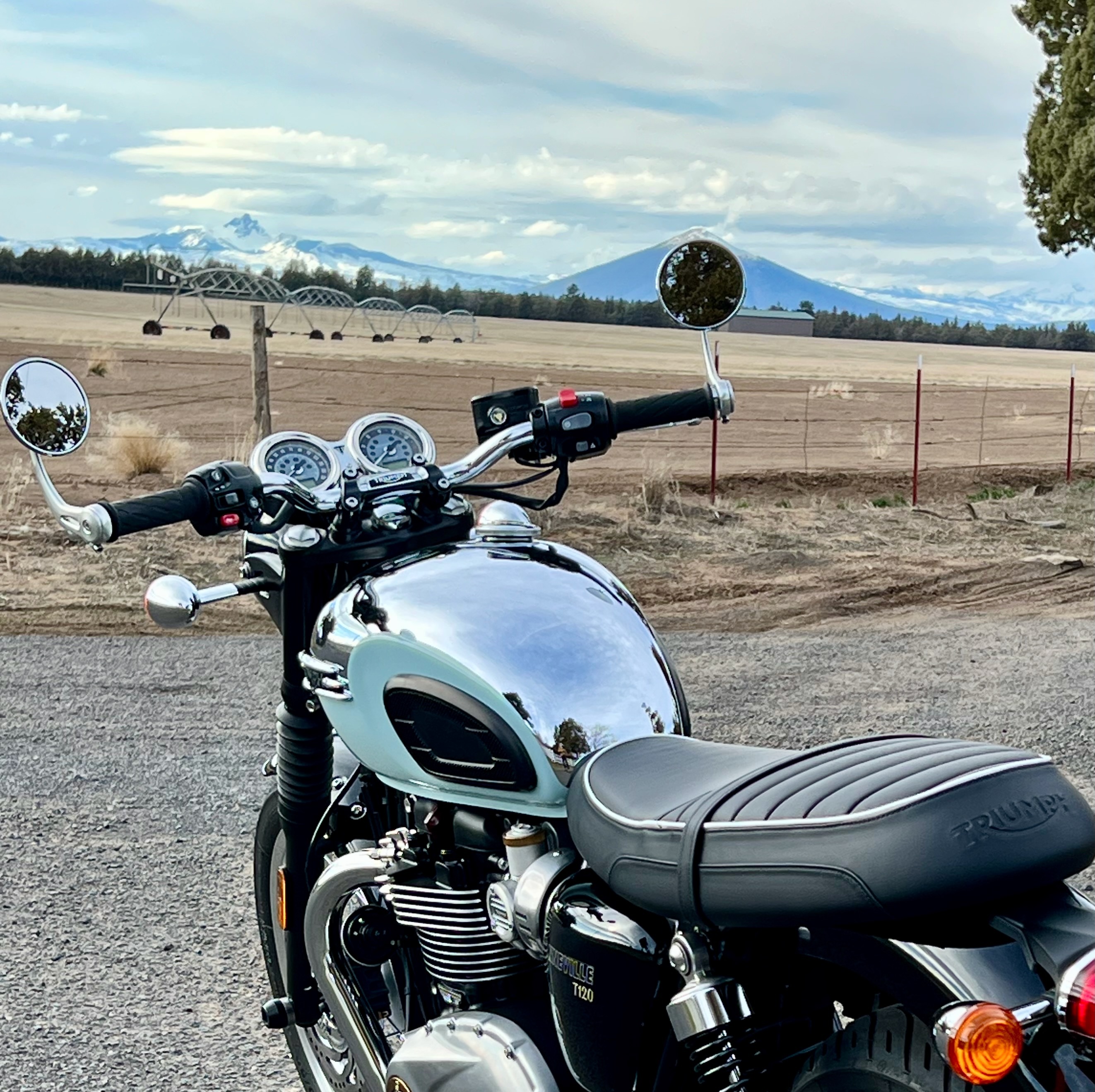

    The Triumph bar end mirrors are excellent for looks but especially for the rear view they provide. I know, not exactly the same as the standard mirrors, but these are superior for vision IMHO.

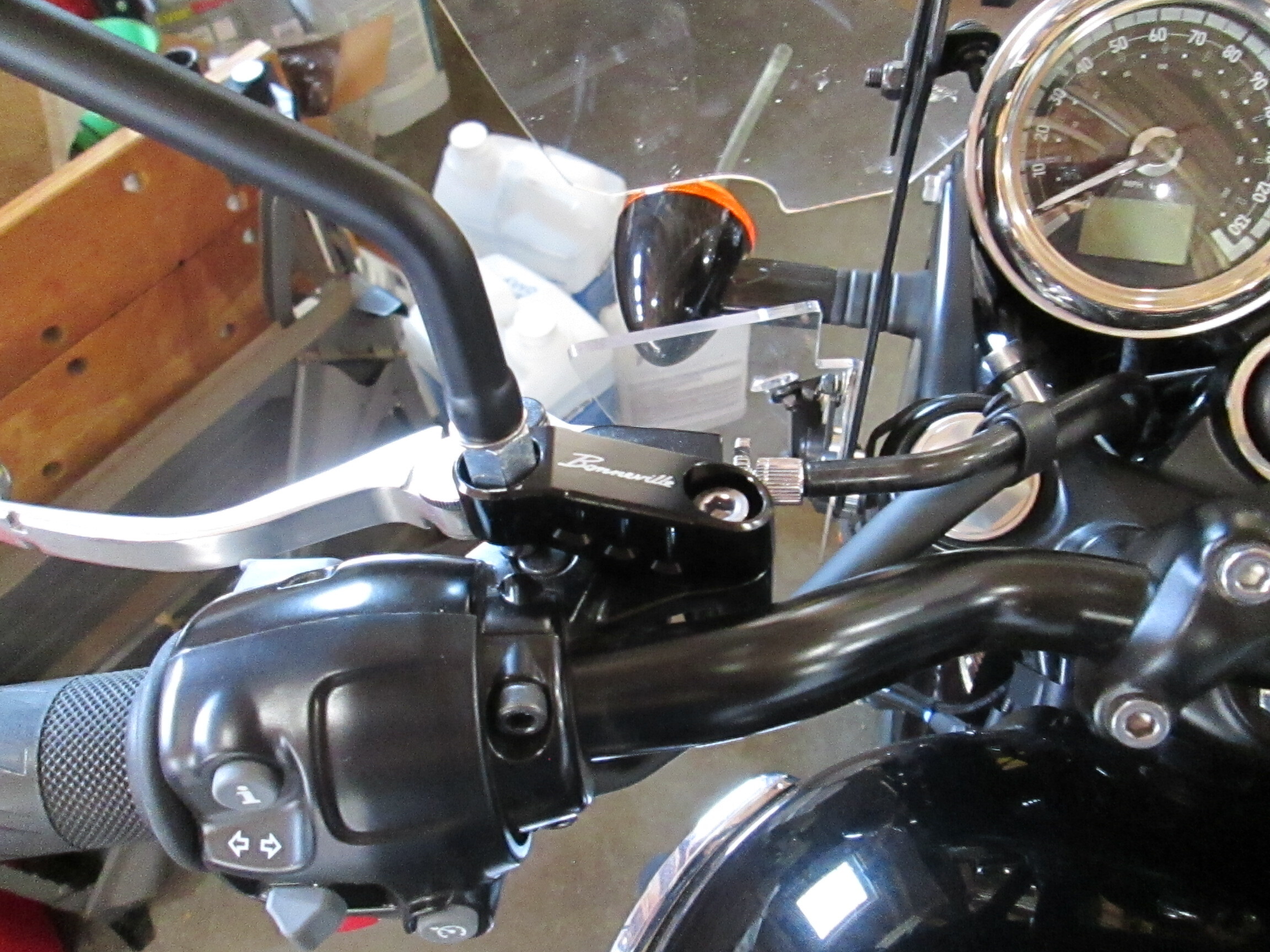

    OK guys, for my 2023 Bonneville Black T120 mickey mouse stock mirrors, on Amazon I found and installed some excellent black mirror extenders:
    https://www.amazon.com/dp/B0F644QW1D?ref=ppx_yo2ov_dt_b_fed_asin_title&th=1
    The supplied extenders and mounting hardware are top notch. Engraved with the 'Bonneville' logo. Took a bit of time to arrive; product ordered on Friday from China and arrived at New York Customs on Monday; then finally delivered on Friday.
    They extend the mirrors 1 3/4 inches outward and, with included risers, raised them 2 inches from their original mounts. The view now is excellent on the right and left.
    However, there were some installation hitches due to my stock mirrors being female threaded up into the mirror arm ends. The supplied installation instructions did not apply but there were enough bolts and adapters to make it work.
    I had to trip to the hardware store to pick up two 8mm lock nuts and flat washers. The inboard ends of the extenders are not threaded (a good thing); but, the outboard ends were threaded - I had to drill those threads out to make installation of risers and mirrors easier. Surprise, three of the supplied risers are reverse threaded and 3 are not - no worries, only needed one reverse threaded one and one normal one to make fastening work.
    I used the stock Triumph mirror allen bolts with 8mm lock nuts to secure the inboard ends of the black extenders to the brake/clutch handles; used supplied allen screws and risers to mount the mirrors to the outboard ends of the extenders. Happy Camper.

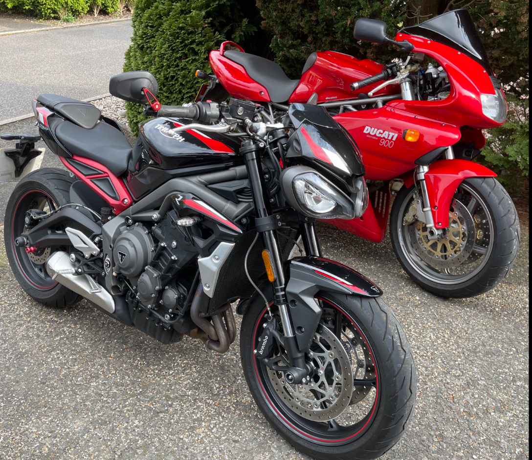

    I fancied bar end mirrors on my Striple and found a pair of cheapo ones one EBay at just over a tenner so thought they were worth a punt.
    I really liked the arms as the colour matched the bike but didn’t like the mirrors as the were tinted and weren’t a true 1 to 1 reflection so I swapped them for the OE mirrors as the thread was the same. Final result I’m really pleased with and no vibration at all irrespective of road speed or revs.
    I now use the OE left hand mirror stalk to mount my X4 360° camera

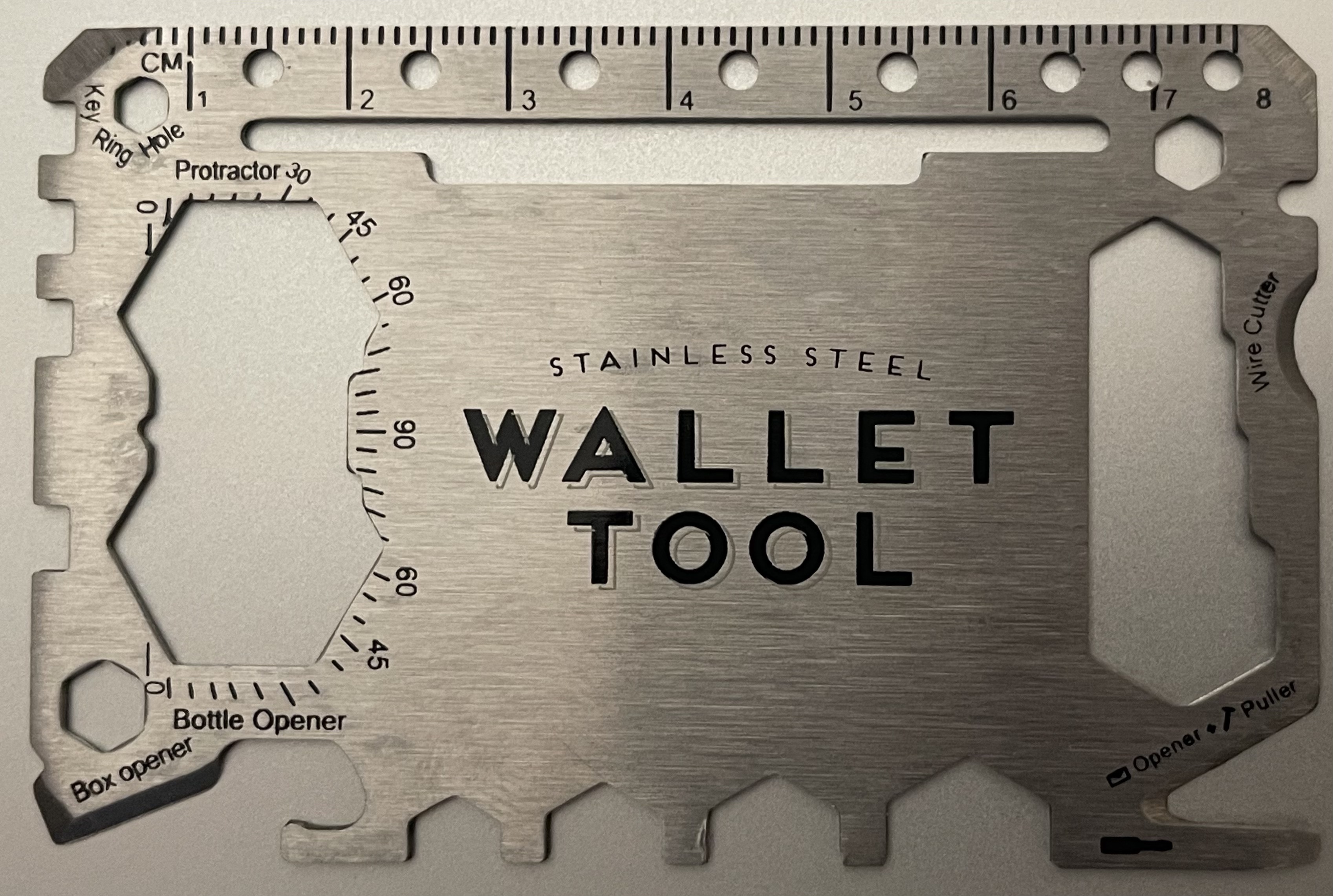

    And just in case anyone is wondering what a wallet spanner card is, here you go. Credit card size, says it’s stainless steel but it sticks to the magnet in my iPad so probably only just.
