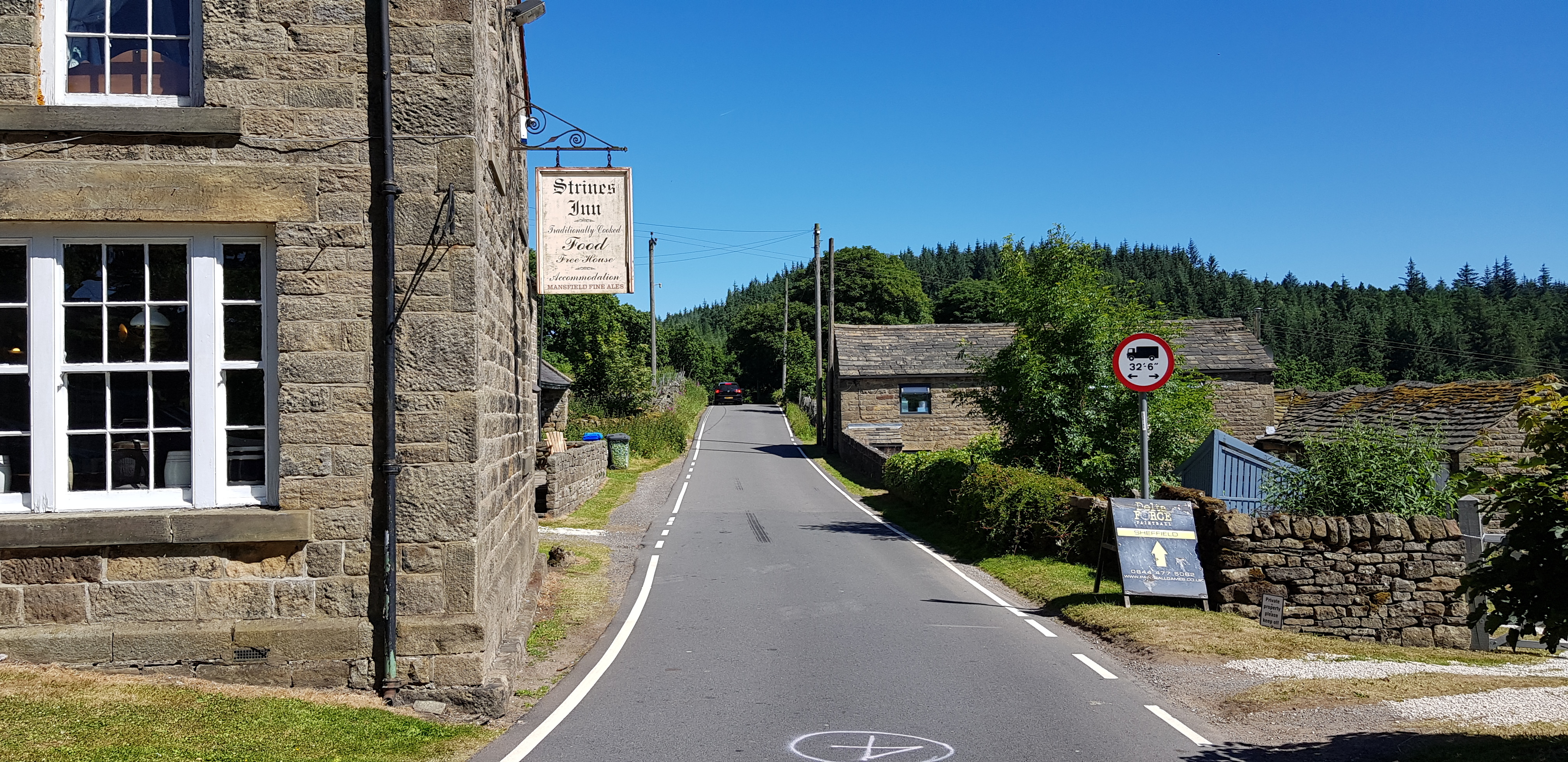

    It's like a new toy each time you get another 1000 revs, great fun. Have a look on Google earth at the route woodhead pass from Glossop, then before you get to Sheffield on the right there is a brilliant road to Strines I think that's how it's spelt, great pub there for a cuppa on route then that joins the snake pass, in this weather its brilliant, we are going Wednesday night to do it all again

    The Strines road was resurfaced a couple of years ago for the Yorkshire stage of the tour de France, you wouldn't want to have ridden it before then, surface was crap, really bumpy, 45mph would have you bouncing out of the seat! Now it's good for a bit more than that in the right places. Trouble is, now the surface is better it's attracted loads of MAMIL's, or as dilli calls them "TWATS" :cool:

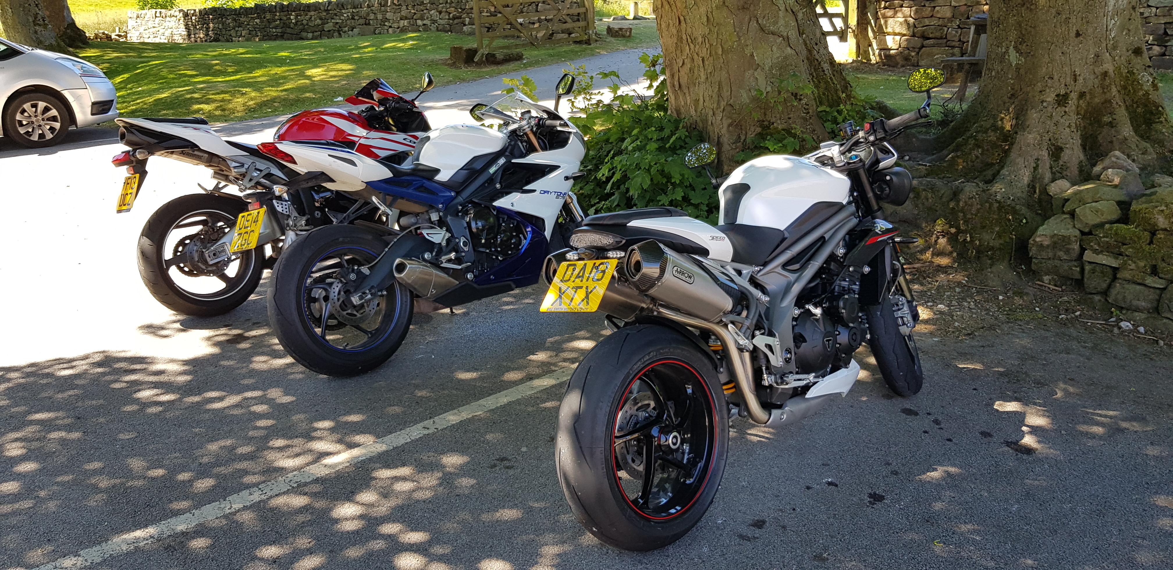

    Its was bad but your right it's so smooth now, some seriously tight turns but a great cut through.

    Depends on your destination but I sometimes turn right half way over and head towards Bolsterstone coming out in Deepcar. That's also nicely surfaced.

    I will maybe have a look on Wednesday, 3 of us are going a daytona and a 600rr to keep me company
