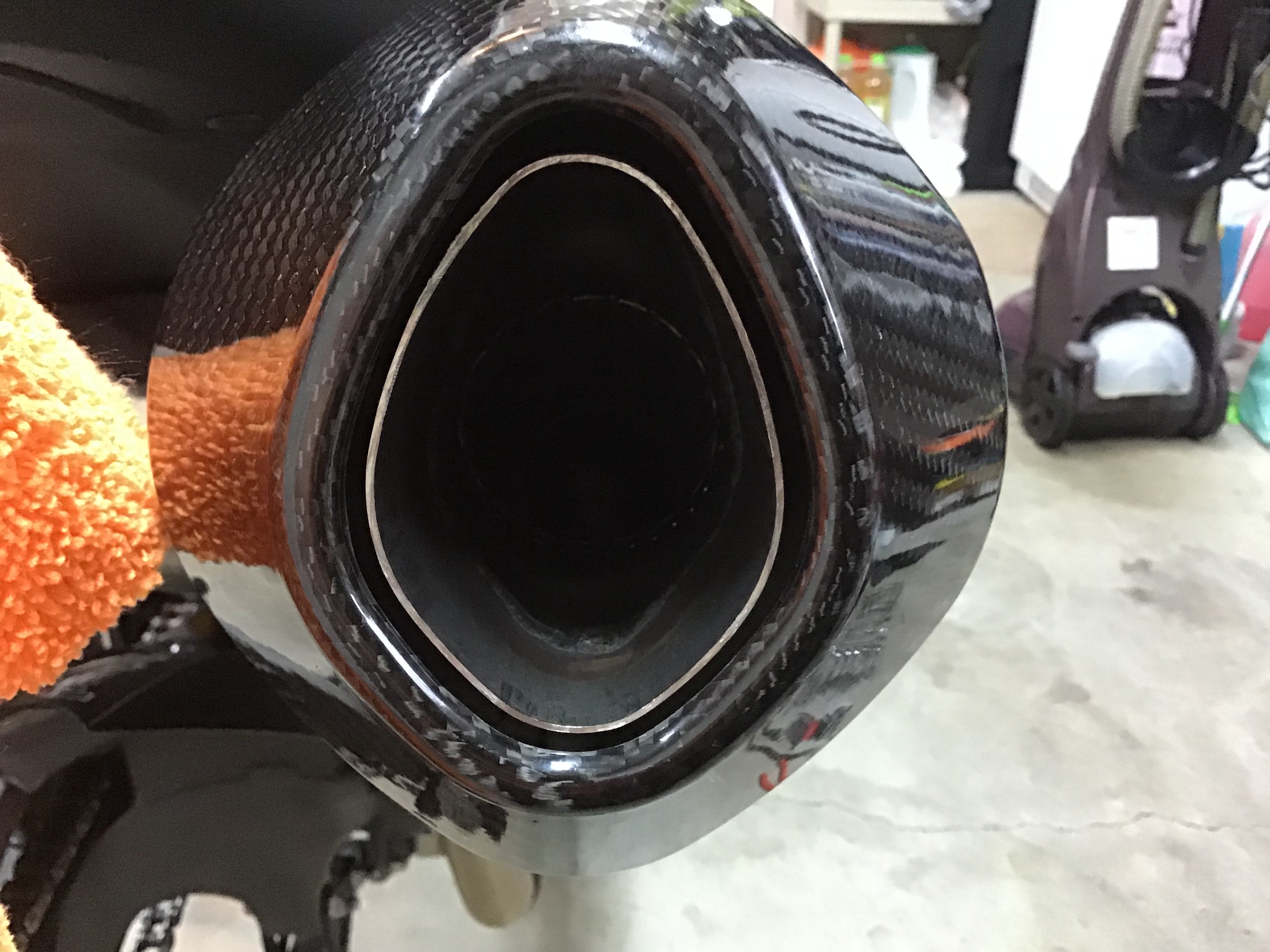

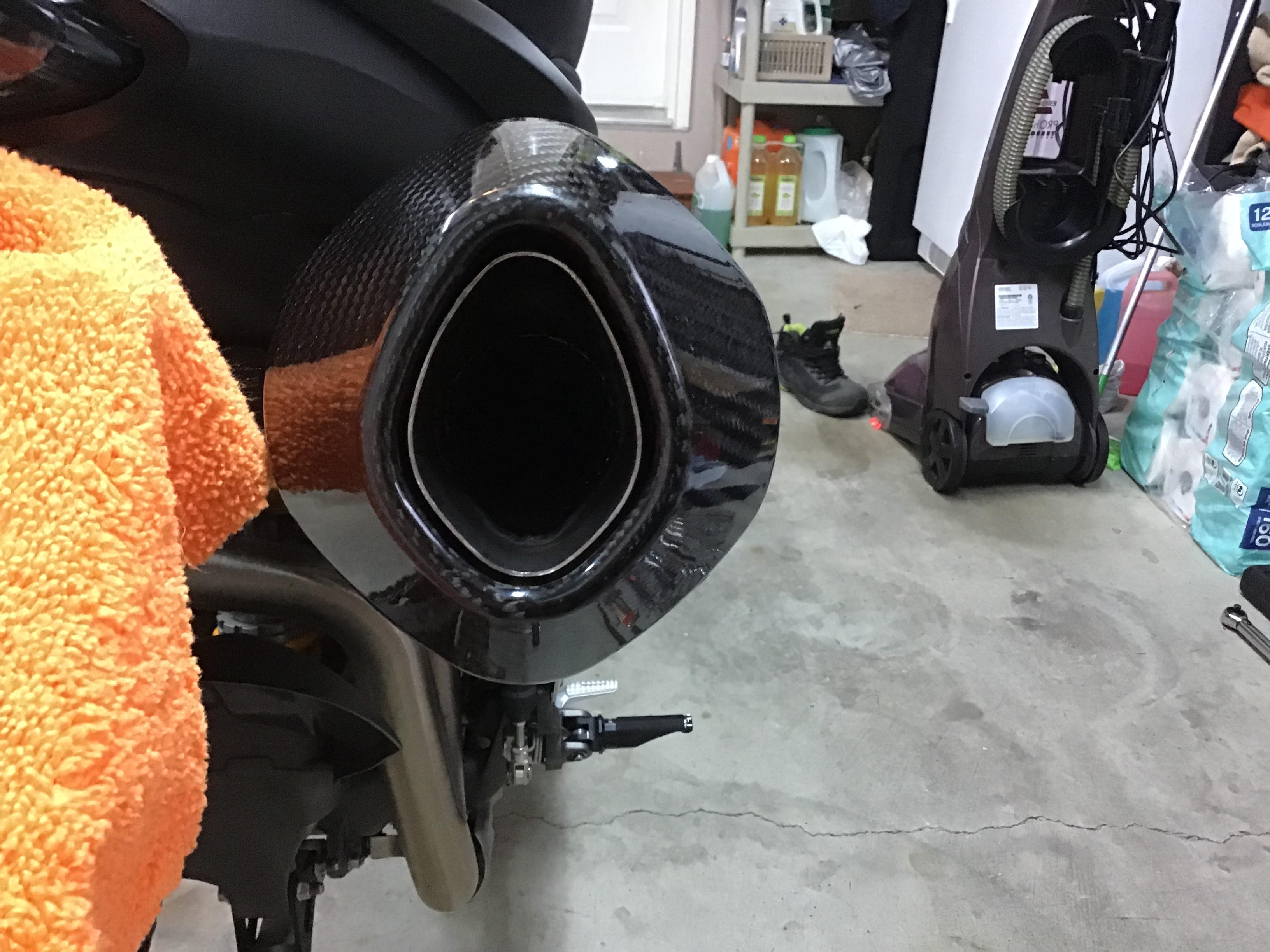

    I have a Canadian Speedy RS 2019. Bought new, so no mods by a previous owner. Have been researching baffle removal since April 2020. Read all the forums, watched all the videos and contacted, both Triumph America and Triumph UK to ENSURE that this would not harm the bike. Was assured by both that it was fine.
    Finally decided to remove the baffles yesterday. Two "problems";
    First, the carbon end caps would not come off. Drilled the copper rivets out and heated the end caps. Twisted, pulled, "pried" and had two of us try to maniplute the caps off... no go.
    So, decided to do the "dremel removal" process. I've read that owners have had to grind, anywhere from 1 to 5 millimeters before the end weld "split".
    I started grinding, evenly, around the weld... one, two, three millimeters...
    Eventually, (and unfortunately) I decided to grind one section down, until I found the split and then would know how far I needed to go and even the rest of the end out. The split never happened.
    I called the dealer and asked for help with information as to why this was happening and he informed me that my db killers were NOT removable.
    "How can this be??!!" I've SEEN it done on youtube, on my year, my model, my exhaust. I've seen pictures on forums and read detailed descriptions. I've had confirmation from, both, Triumph America and Triumph UK, so European vs North American shouldn't matter. Besides, I've seen it done on Canadian bikes on THIS forum.
    So, I have one untouched can and one "mangled" can.
    I can't remove the end cap to use a bench grinder to evenly flatten out the uneven surfaces and I don't want to go any further with the dremel on this can and then attempt to cut the other can to match.
    I've contacted the dealer and talked to the foreman and he said that the db killers are not removable, so this would not be warrantied as I attempted modification without Triumph instruction. BUT, I kinda feel like I WAS instructed by Triumph themselves, as an engineering specialist responded to my e-mails about the removal of the db killers.
    Long story, longer... I have all the e-mails from Triumph UK and America and have send them, along with detailed infromation and several videos, showing the baffles successfully being removed on the same bike and he is going to see if Triumph will replace the left side as a "good will" gesture. I have a Daytona and Street Triple too, so I have contributed to the cause:)
    If I can remove the carbon caps, I can at least grind down both sides evenly, with a bench or angle grinder, if Triumph does not want to "help me out". I can understand their position. I'm going to look into whether the end caps are available, seperately, and if removing the carbon ends up destroying them, I can replace them. The ONE left side replacement is $800.
    ANY help with suggestions to remove the caps would be greatly appreciated. Just know that I've read all the posts and tried everything, so I'm not that optimistic.
    Anyone else had a 2019 with that the end weld DID NOT separate, no matter how far it was ground??
