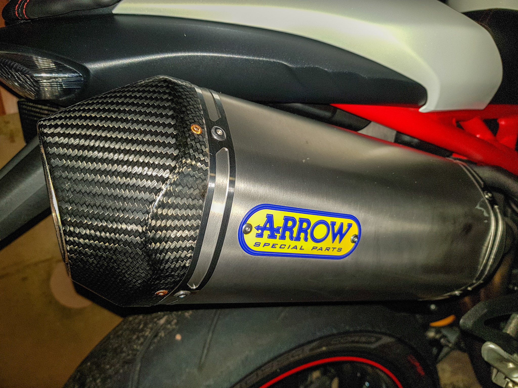

    Hi team.
    Bike is about to arrive & bits n pieces have been purchased to add.
    Next step will be to remove the silly disc from the mufflers.
    My question is, for those who have done the baffle removal, what size are the black pop rivets in the end cap?
    For some reason I can't seem to find them anywhere here, so I'm thinking I'll get them organised before I tackle the baffle removal. (yep, pretty sure that will follow the disc removal) ;)
    Cheers in advance.

    Here you go..
    https://rover.ebay.com/rover/0/0/0?mpre=https://www.ebay.co.uk/ulk/itm/113203810720
    1/8 or 3.2mm X 8mm are the ones I used.
    Hope it helps..

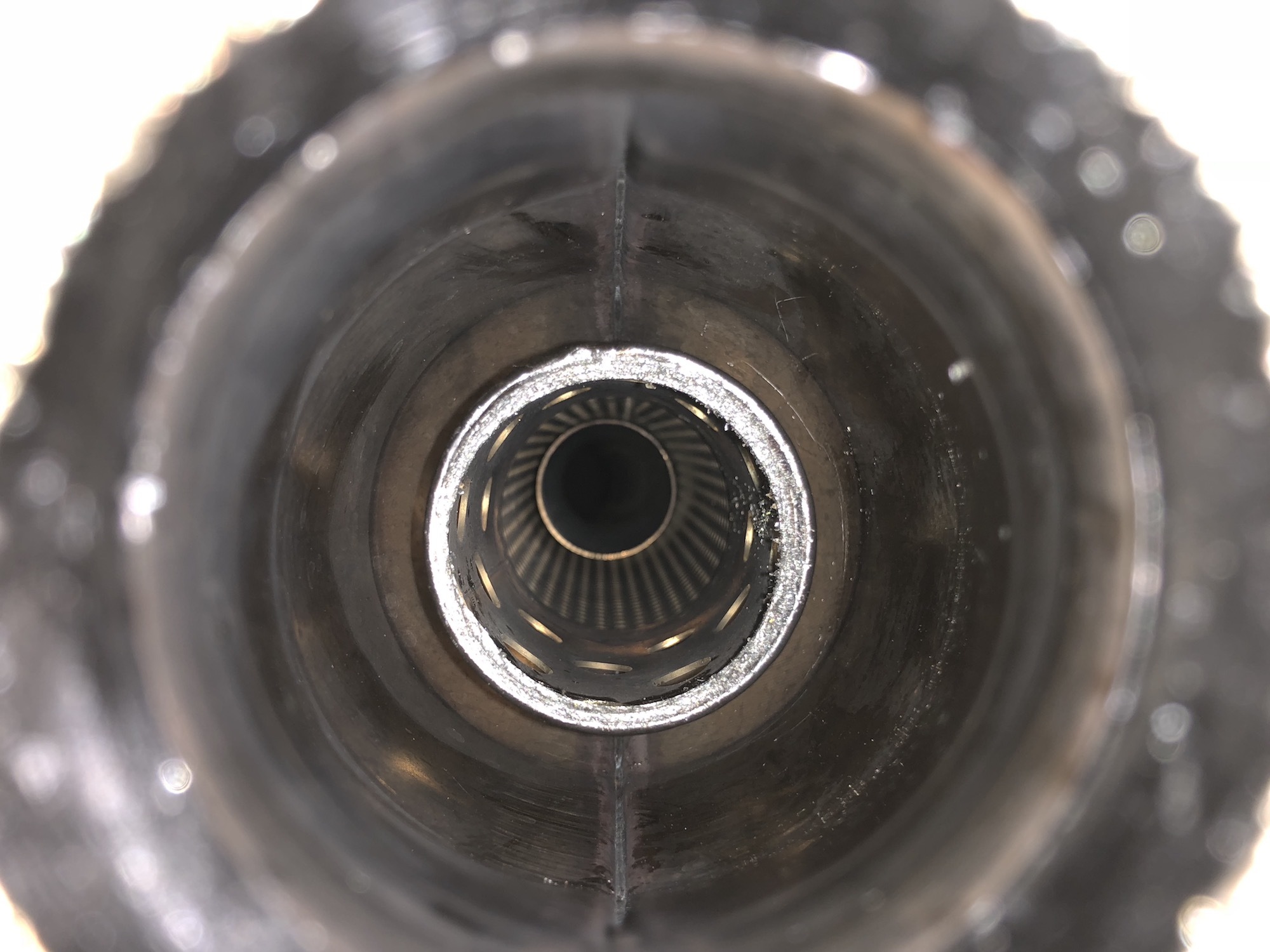

  11. Johnboy
    Johnboy New Member
    Dec 1, 2018
    2
    southampton
    Hi I removed my baffle from the low boy, First remove the can, then drill out the pop rivets holding the carbon end cap on, you will then notice the baffle has a bead of weld around it, this needs to be ground down about 3mm to remove the weld bead, i used a belt sander to keep it flat, then put a bit of broom handle up the inlet of the can a tap out the baffle, when it is out, clean the weld end up with a file, refit the carbon cap with pop rivets refit can and enjoy the sound

    Evening folks, I'm thinking about removing the baffles on my 2016 R.
    I was just about to buy some black rivets in preparation for the job and noticed that mine is fitted with copper coloured rivets? Is that the norm?

    214
    hampshire
    Mine were copper on mine got replacements from Spalding Fastners on eBay

  16. GOT
    GOT Member
    Nov 21, 2018
    48
    36
    Torquay Australia
    Use black ones mate, those make you look at a rivet instead the great cans & carbon fibre. Also in the pics they just look like rusty rivets.
    Just my opinion of course :)

  17. GOT
    GOT Member
    Nov 21, 2018
    48
    36
    Torquay Australia
    Just in case anyone is wondering why taking out the dreaded disc in the mufflers doesn't make a huge sound difference, it's because there are plenty of other holes in the tubing in that first chamber of the mufflers.
    Sure that disc doesn't help matters as the gases would run straight into it, but they would then flow around the chamber escaping through the other holes in the tubing.
    That's why removing the baffles makes a much bigger difference, as the gases aren't 'trapped' in the muffler & have to flow back down the muffler to make their way out the long tube.
    Don't get me wrong, I still removed that disc!

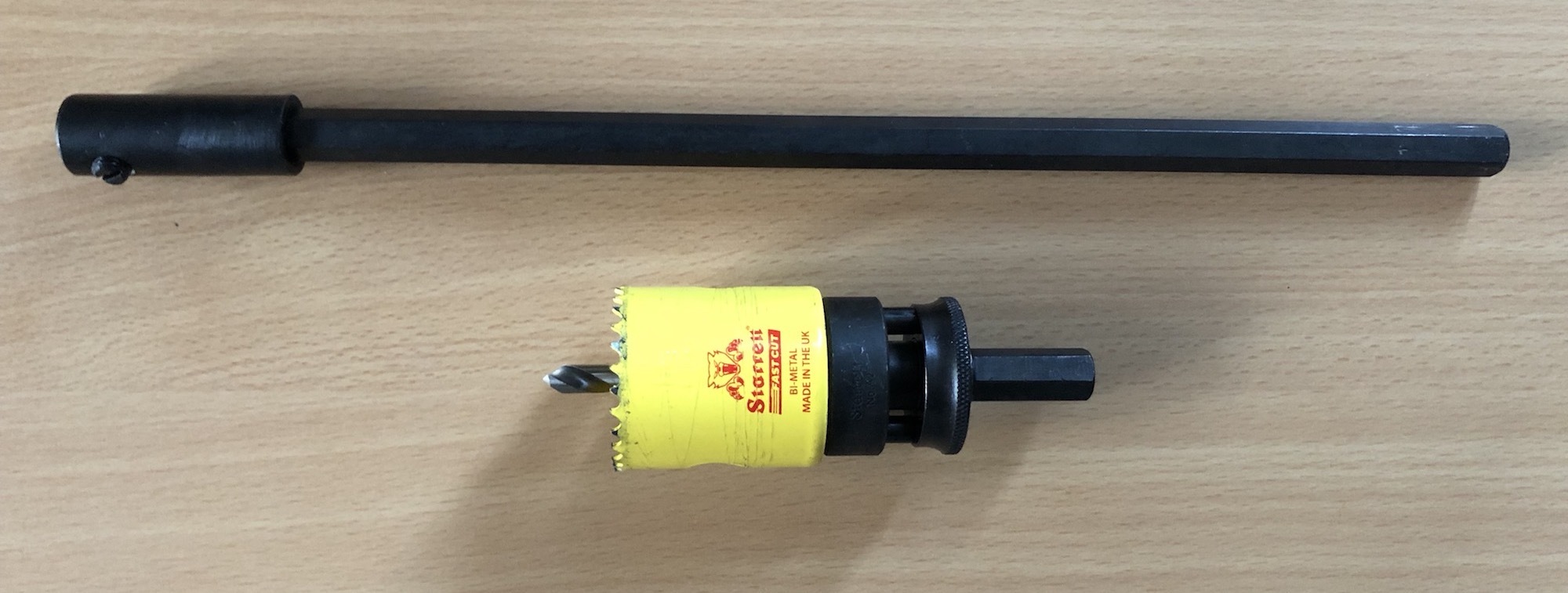

  19. MrTriple
    MrTriple One Cylinder Short
    Jan 23, 2017
    908
    937
    Epping Forest
    Glad you found it helpful :)
    Plenty of people appear to have used the hole cutter method with no issue, and I think the 41mm version (rather than the larger 43mm) cuts more easily and cleanly, because it sits just inside the rim of the baffle tube.
    Take it slowly and steadily and those discs will be history ;)
