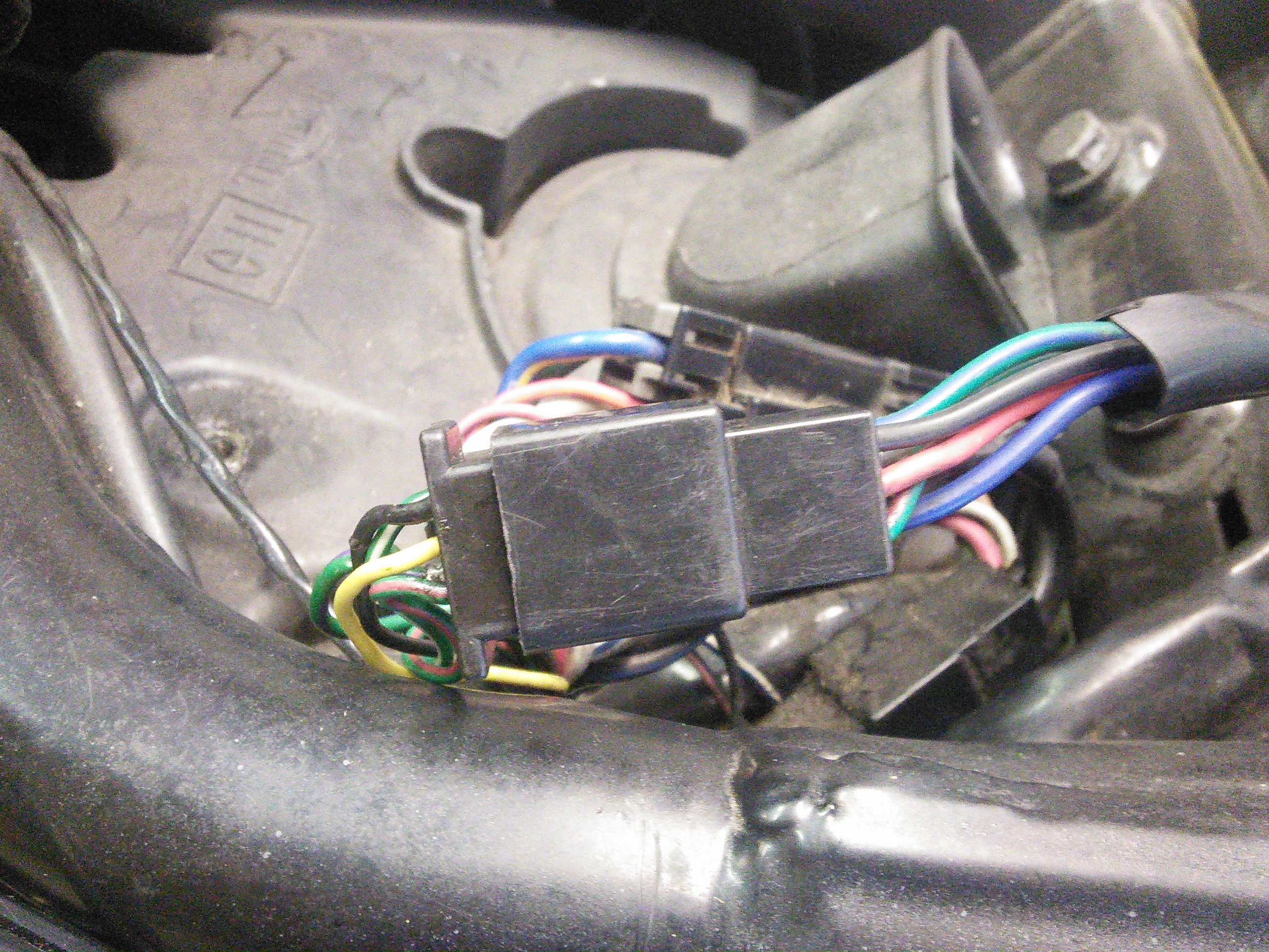

    It's a bit of a basket to say it was working in this position now not,if I put multimeter onto the snap connector block under seat I get continuity to all three wires and stop light works will find small child and put into front.

    Only the parking small light and rear main element not working, think it's either the snap connection or back light bulb holder.

    Plugged together I get continuity to all three wires unplugged only the black and blue mmm
