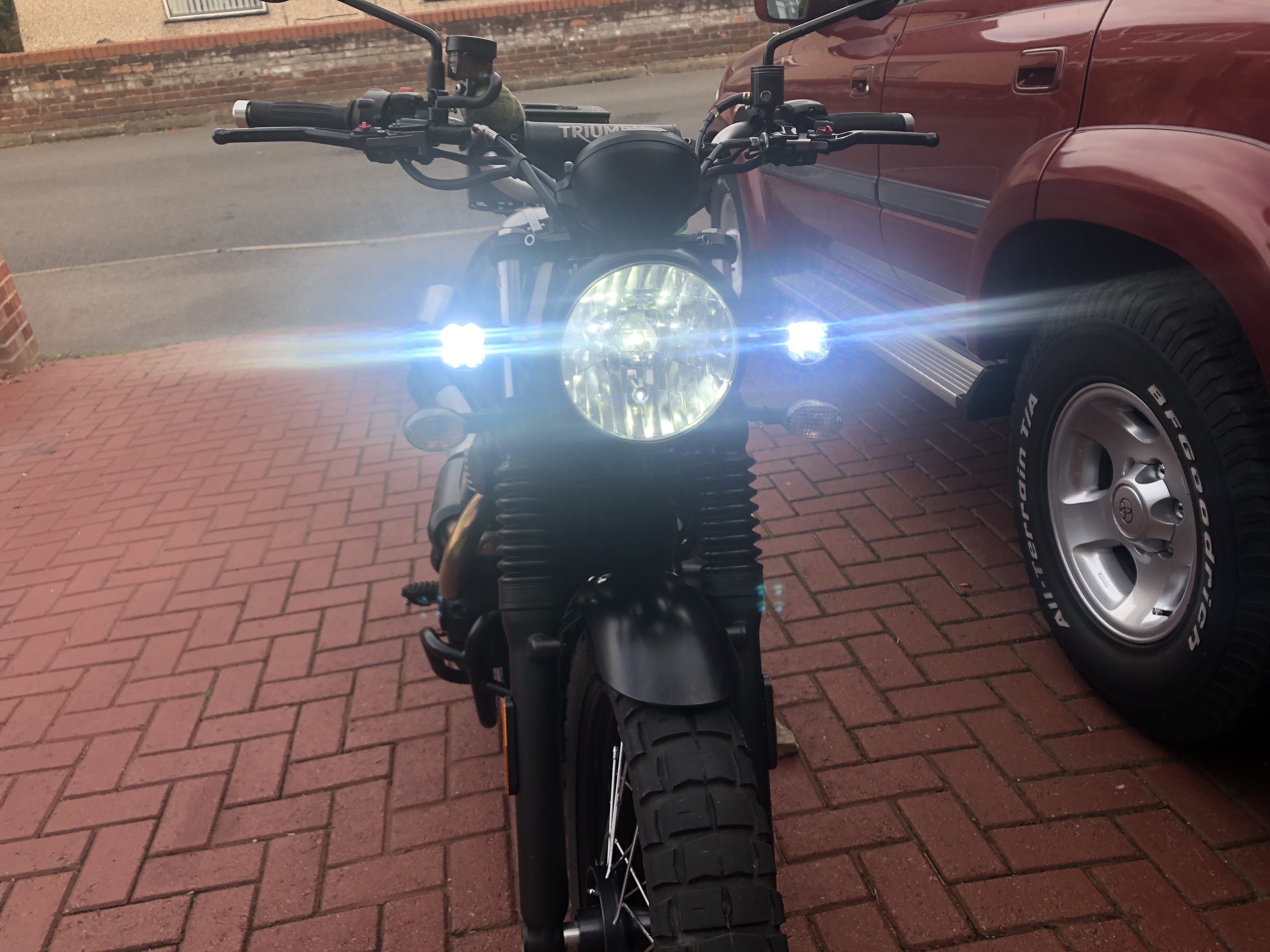

    Loads to choose from on ebay as you've discovered no doubt. I don't have a 765 but I see it's a naked bike so I'd fit them to or around the bottom fork clamp near the headlight. I fitted a pair of these.....https://www.ebay.co.uk/itm/27559760...D1FZTpokOGMMd6w9u1yvoS710=|tkp:Bk9SR_601tTVYg....to my SS and also replaced the OEM halogen H4 bulb with a LED. The difference is, erm.......night and dayo_O
    One of the lamps has took a hit from something and has a cracked lens so I've got my eye on a pair of these....
    https://www.ebay.co.uk/itm/31458956...xa+awBSBL0v2SbBX9nUImH3cA=|tkp:Bk9SR4j0ltTVYg

    Just fitted these after one of the old ones suffered a cracked lens. Tried them in the garage and they're actually a bit brighter. I feel a night time excursion/shakedown test coming on.:)
