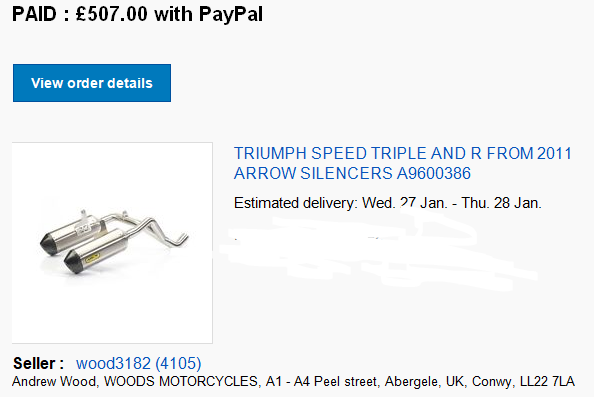

    No, was a different part number......
    But I'm cynical as to whether pre/post Euro4 bikes actually need different silencers?
    Possibly just different markings for change in noise regs?

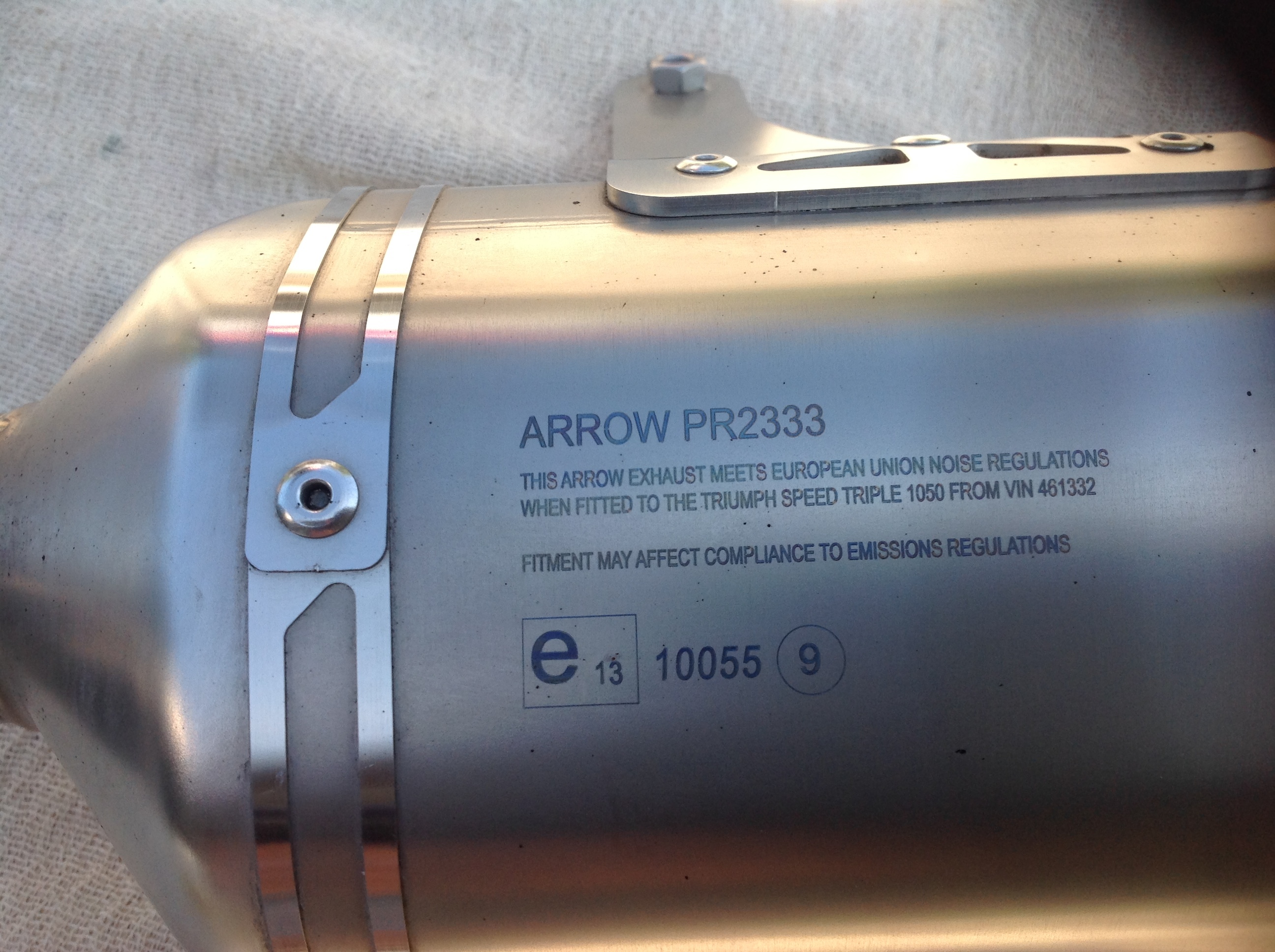

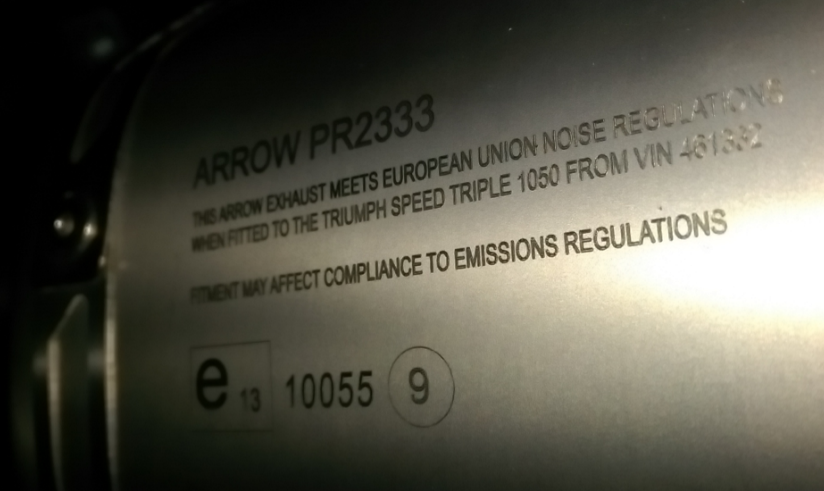

    Markings on the can, for what it's worth.

    I dont think there are any Euro Markings on the ones I have, just USA compliance notes. Its somewhat strange as nothing on the Triumph site states that they are not road legal. When I pick the bike up tomorrow I will post some pics.

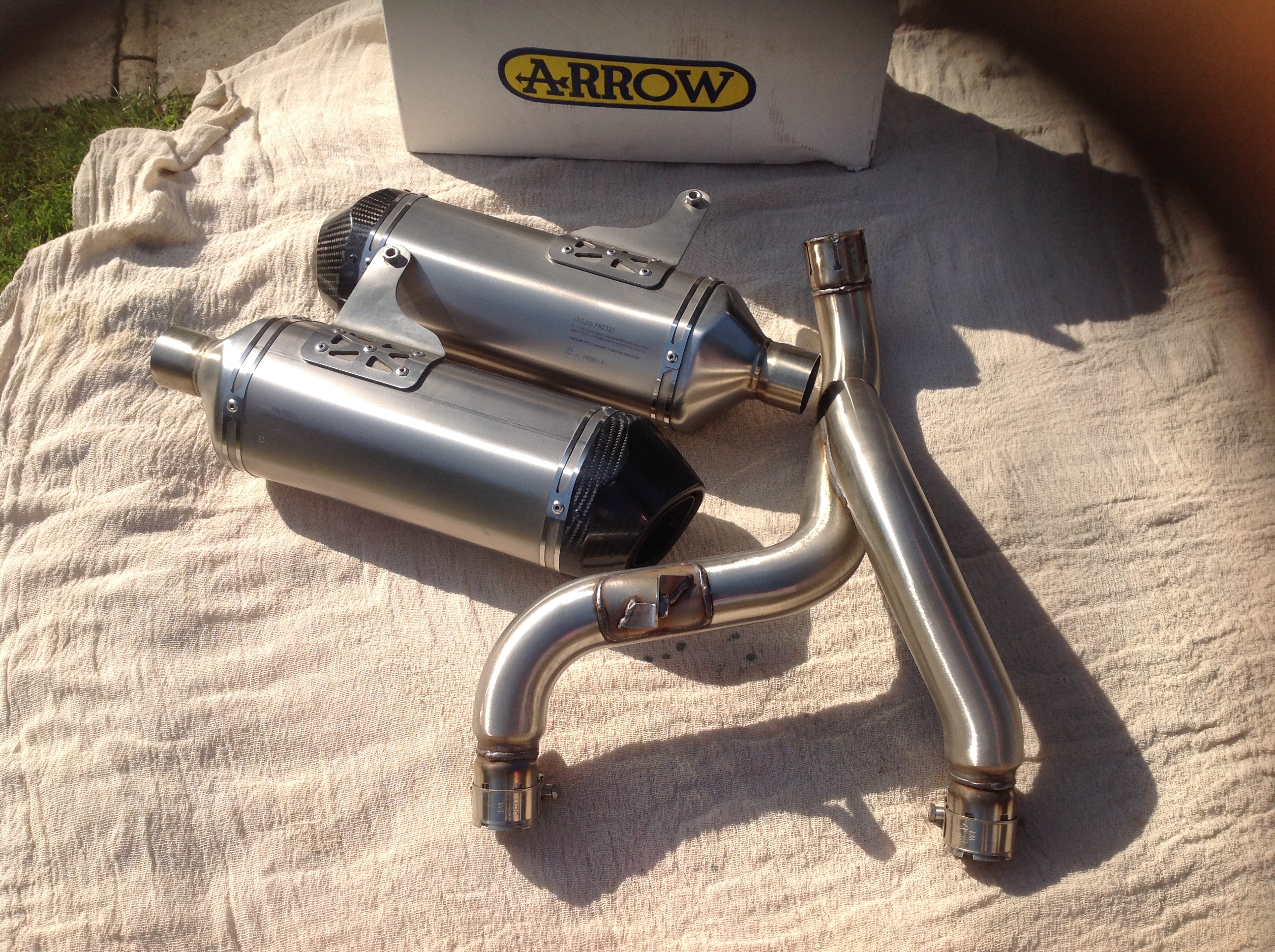

    Hi all, I am told the older arrows cans and link pipe fit the 2016 on models by my local triumph dealer. The pic attached is of my 2015 model arrows cans which I considered moving on to my new 2016 model speedy, but decided to go low boy instead. By the way, these are for sale on gumtree, perfect order, and only £275 as I want a like minded rider to enjoy these great exhausts.

    Interesting....
    Identical markings on can, but you have a different link pipe to mine, pipes just slide inside cans on mine - very good fit - no clamps.
    (Original link pipe had clamps to OE cans but covered by trim plate)

    look in great condition are they straight fit on 2011 speedy,I'm seriously tempted if they will fit my 2011 speedy

    As Col C says the older pipes had clamps and a compression style fit whereas the newer ones are a slip on with design with no means of tightening them.
    I am not sure if the older version will fit current model as part number is different.

    Not quite, ....as posted above the Arrows that I've fitted the part number ends in 386.

    From the photos Batfink posted I assume there must be yet more versions (older?) that uses clamps, which are not shown in the fitting instructions.
    There was a major update (2011 I think) when the Speed changed from round to "Edna" lights with significant body/chassis changes too, maybe these are from around that period?

    and you seem right the version with clamps seem to be for the round light model although they seem to fit batfinks later model,what difference if any i don't know bur fit they do.

    Presumably they dropped the clamps for cosmetic reasons. Main and sub-frame are significantly different in the 2010-2011 update, so I expected the mounting point for the cans to be different.....but sounds like not so.
