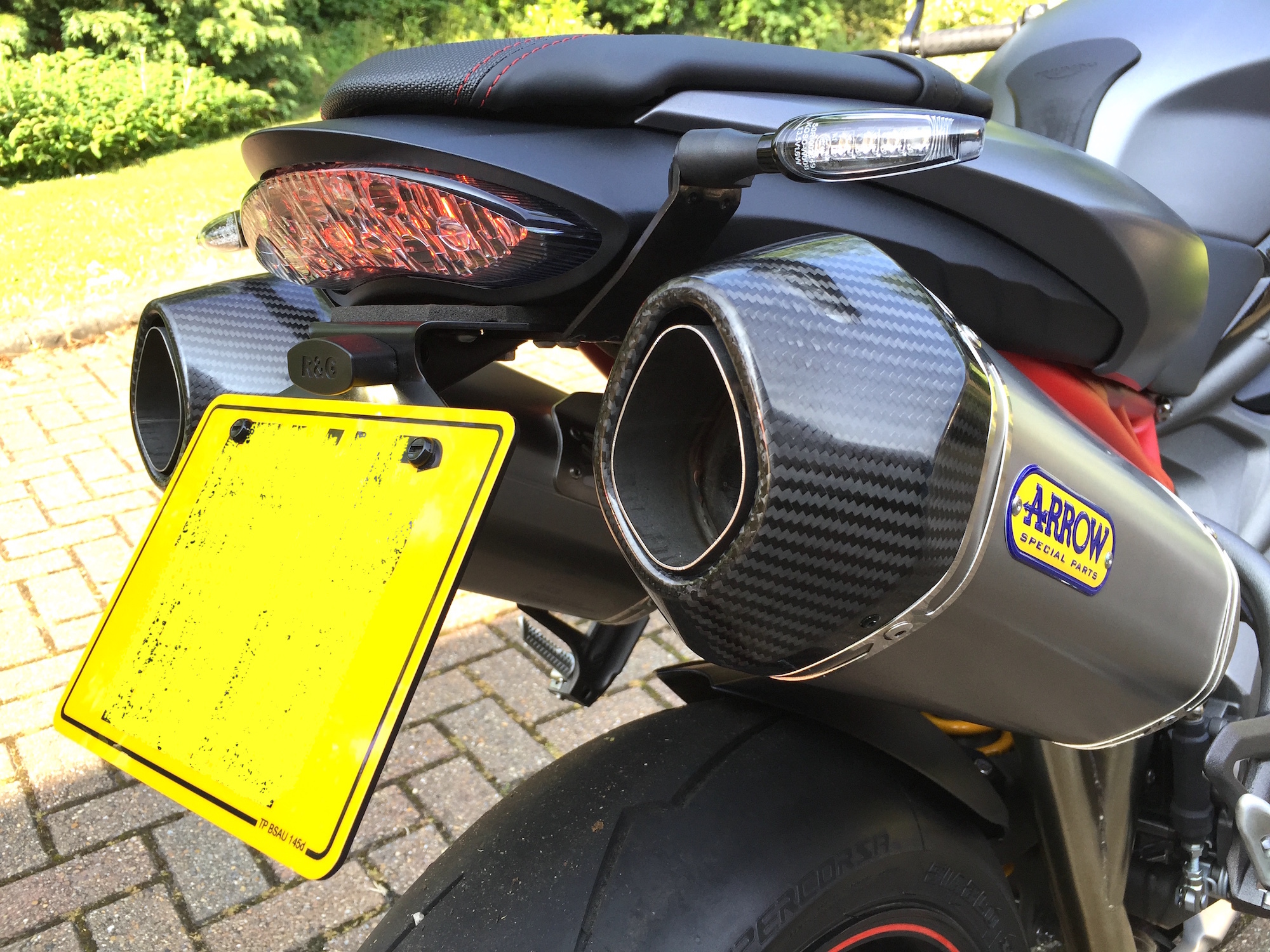

    The R&G tail tidy will fit - but you have to swap out the indicator bracket for this one - https://www.rg-racing.com/browsebike/Triumph/Speed_Triple_R/2016/IAS0003BK/

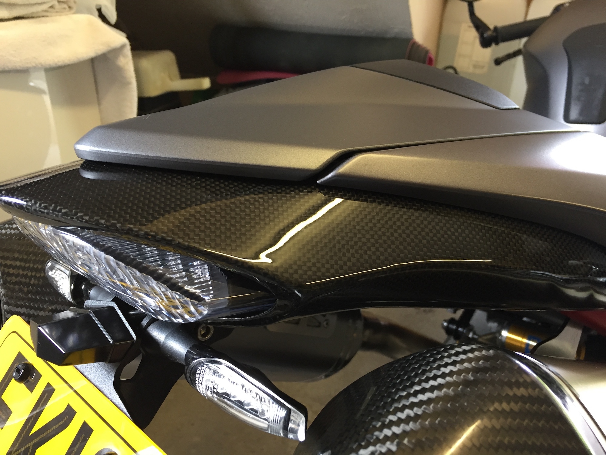

    It doesn't look that great to be honest, and after buying the bracket, I ditched the whole tail tidy and fitted the Evotech version instead (which in my opinion, is much (much) nicer).
    R&G with high bracket

    Evotech

    I dont like the look of that at all I didn't fit the r&g is it easy to swap from the r&g to the evotech

    I didn't think you'd like it - and I didn't put up with it for long.
    The Evotech is excellent quality and feels precision made compared to the bendy R&G. Line everything up and the Evotech just pops into place.
    My top tip is to make sure that you don't pinch the indicator and numberplate light wires as you do up the bracket, otherwise you're in danger of shearing them as it tightens up against the sub-frame. You may have to fit a new numberplate wire connector (depending on whether the existing one on your loom has been cut off) but that's included in the kit and you can use crimp-on bullet connectors.

    Late to the party - looking for a tail tidy (2017 Speed R). As a dreary old man my concern with the Evotech is that the indicators are rather close together and somewhat hidden. The R&G does separate the lights and push them up where they're clearly visible to the idiot behind you - indicators are not a styling accessory, they have a function...could also point out that a rear reflector is a UK MoT requirement as far as I'm aware. Insurance might be invalid if the bike doesn't comply..? Just saying...

    I'm not sure what Richard Neale is disagreeing with in my earlier post, but having replaced an R&G, the Evotech is in another league - from both a quality and fitting perspective. I really like the way they channel they wires between the two halves and it all fits together and aligns perfectly.
    Form over function maybe, but the LED indicators are nice and bright and possibly outweigh any concerns you have about them being too close together. There's nothing dreary about considering your safety :)
