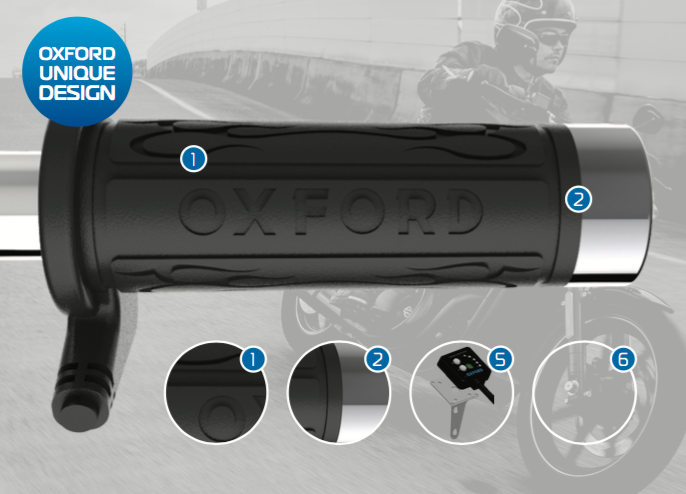

    The diameter is too large to fit in the heated grip tube. The 2013 T100 bar ends are only 10g which makes me wonder if they are decorative. I could probably find 10g of something to stick in the handlebar end on the bolt that goes into the bar-end. it just has to fit in the grip.

    Hi the bar end mirrors are not decorative, they help prevent mirror and minor vibration, they also assist slow manoeuvre's, Oxford grips are designed to allow trimming on the ends that allow the fitment of the OEM bar end weights, and prevent the throttle sticking between the heated grip and bar end weight. Oxford do many designs of heated grips that cater for Sports Bikes, Cruisers, Adventure bikes etc, choosing the correct type for your machine is essential.

    Trimming the oxford grips allowed me to use the original bare-end weight. Thanks!
