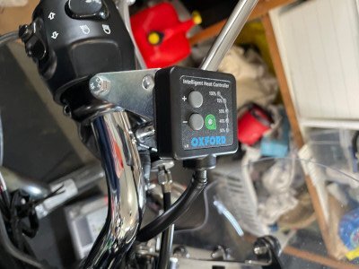

    The Heaterz Premium - Cruiser Heated Grips fit on the T100 1" bars. Delboy has a video on installing on a similar bike.
    I ran into two challenges:
    1. I put too much glue on the right grip. Somehow some glue managed to get on the inside of the throttle tube where it doesn't belong. Fortunately just a little and I was able to remove the grip. It took a lot extra wrenching and scrubbing off the glue on the inside of the throttle tube with acetone so that the throttle tube would spin smoothly on the handlebar.
    2. Not yet solved. The bar-end weights will not fit inside the grips. There is a hollow space for them but the Triumph bar-end weights are too wide to fit. Not sure if these are required for safe operation of the bike. There is room under the cap (2 in the image) to insert some sort of weight, just not the stock triumph weight.
    You can see i mounted the control with a single 35mm long 6mm metric bold (which didn't come with the kit) using both spacers supplied with the kit. It is mounted sideways at it fit that way. I used some threadlocker on this bolt as it seemed like a good idea.
