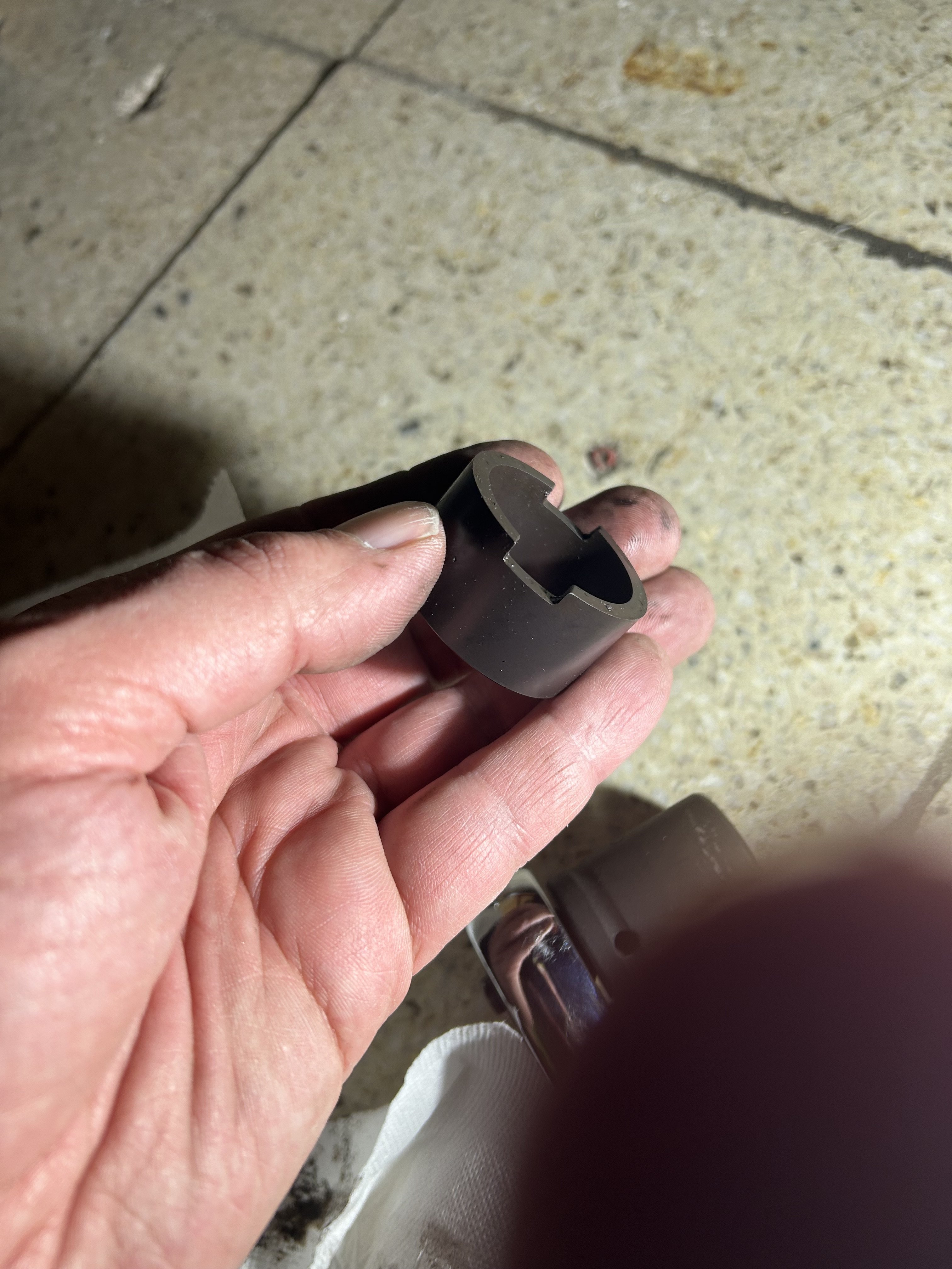

  18. craven2k3
    craven2k3 New Member
    Feb 16, 2020
    14
    Blackpool
    Hi All,
    Thanks for all the collective input. The value of these forums is great particularly for older bikes.
    So the issue didn’t crop up and been using it as much as I can. Not used since Sunday which was a leisure run out for a good few hours and was fine on every start.
    Today, removed from trickle charge and wheeled out the garage and set off and no Speedo readout.
    Switched off the engine at petrol station and fired up again after fuelling and still no joy.
    Where it was safe I switched the bike off whilst rolling, turned the ignition on Speedo instantly reads correctly. Start the engine and again it fails to read.
    Rode to work 20 mins.
    Left bike in the car park. fired it up to head home and Speedo worked fine!
    So I’ve taken the front wheel out and the sender all looks good albeit it grease and lubricant on it.
    So I dont believe the sender is broken or damaged but still stumped. ☹️

  20. craven2k3
    Feb 16, 2020
    14
    Blackpool
    cheers feckless. Wheel is out and tracing cabling to further diagnose.
