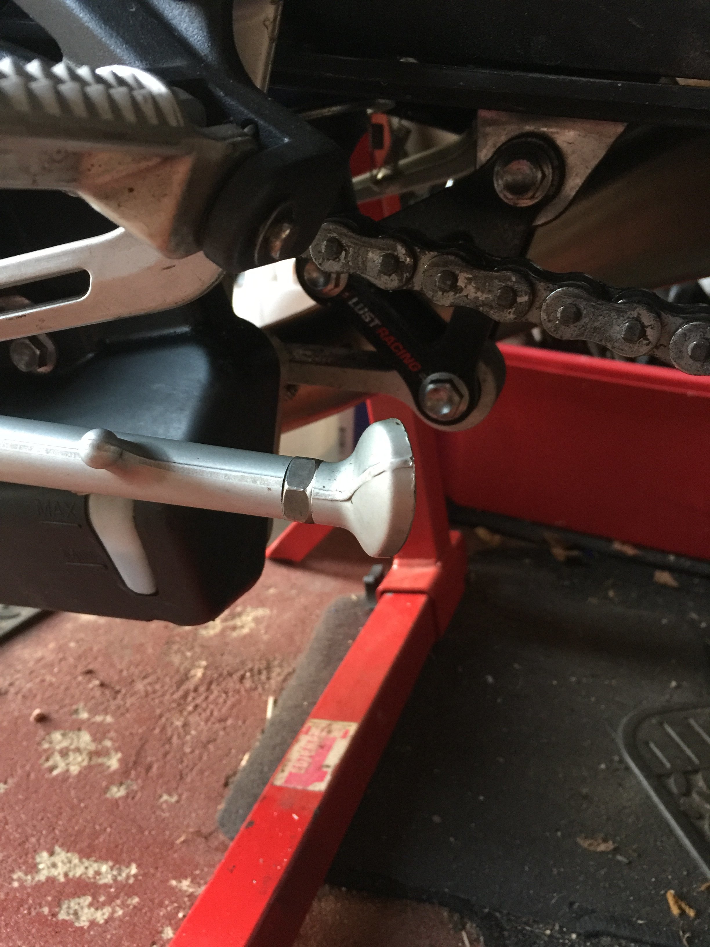

    Hello mate was the stock side stand ok , I had heard you’d need to change it thanks

    I lowered mine when I had the Lust Racing lowering kit on. I cut the end off, cut about 25mm out and threaded a 10mm stud into both parts, locked it off with a nut.

    i didn't bother as it was fine but i like days solution!
