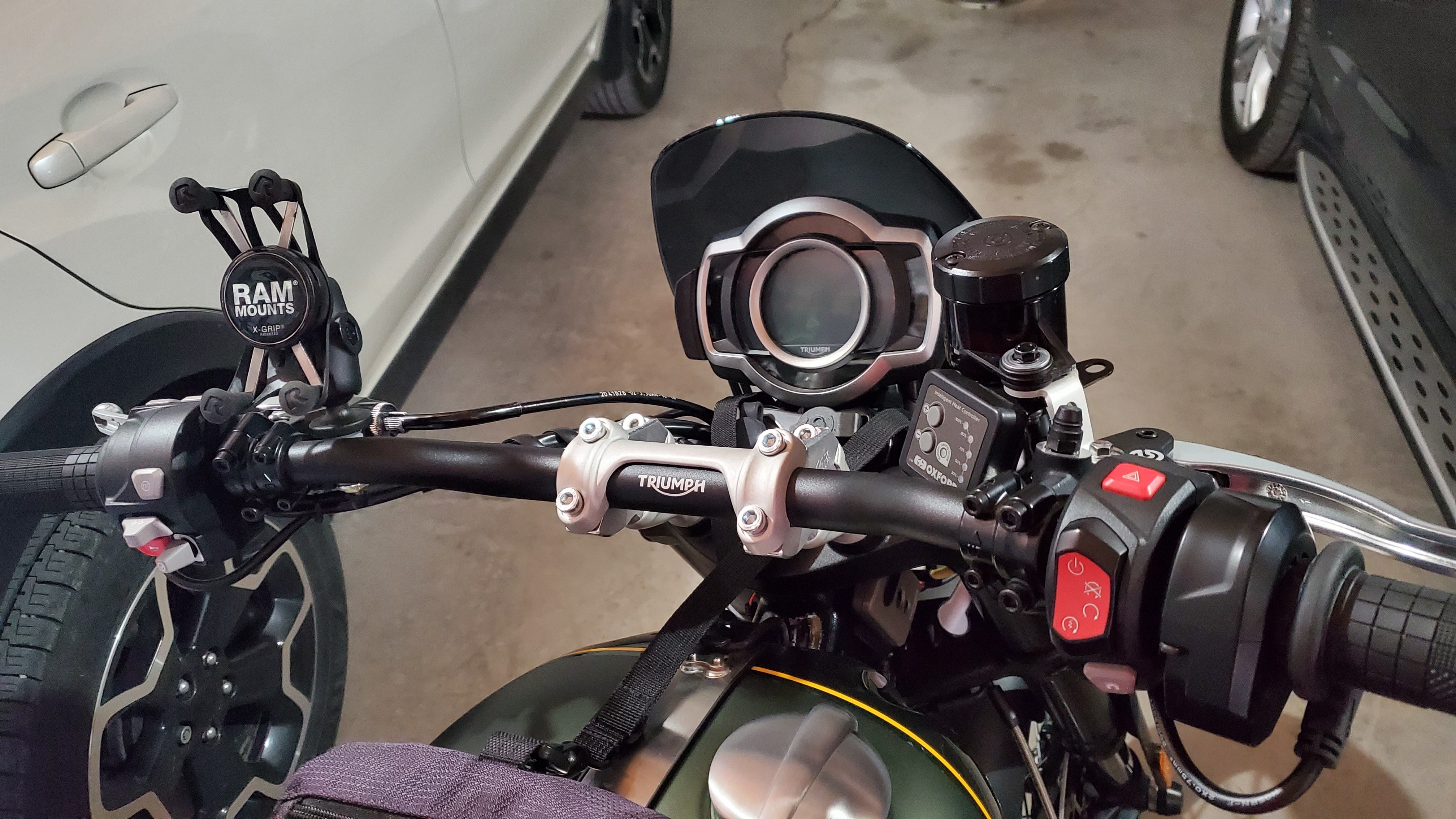

    Sorry to post in my own thread before getting a reply, but I thought I should clarify.
    My primary concern is aesthetic. see how the top clamp on the scrambler in this picture spans between the sides. I imagine any riser that is not a full bar across is going to look pretty silly unless I can move that top clamp up on top of the riser with my bars.

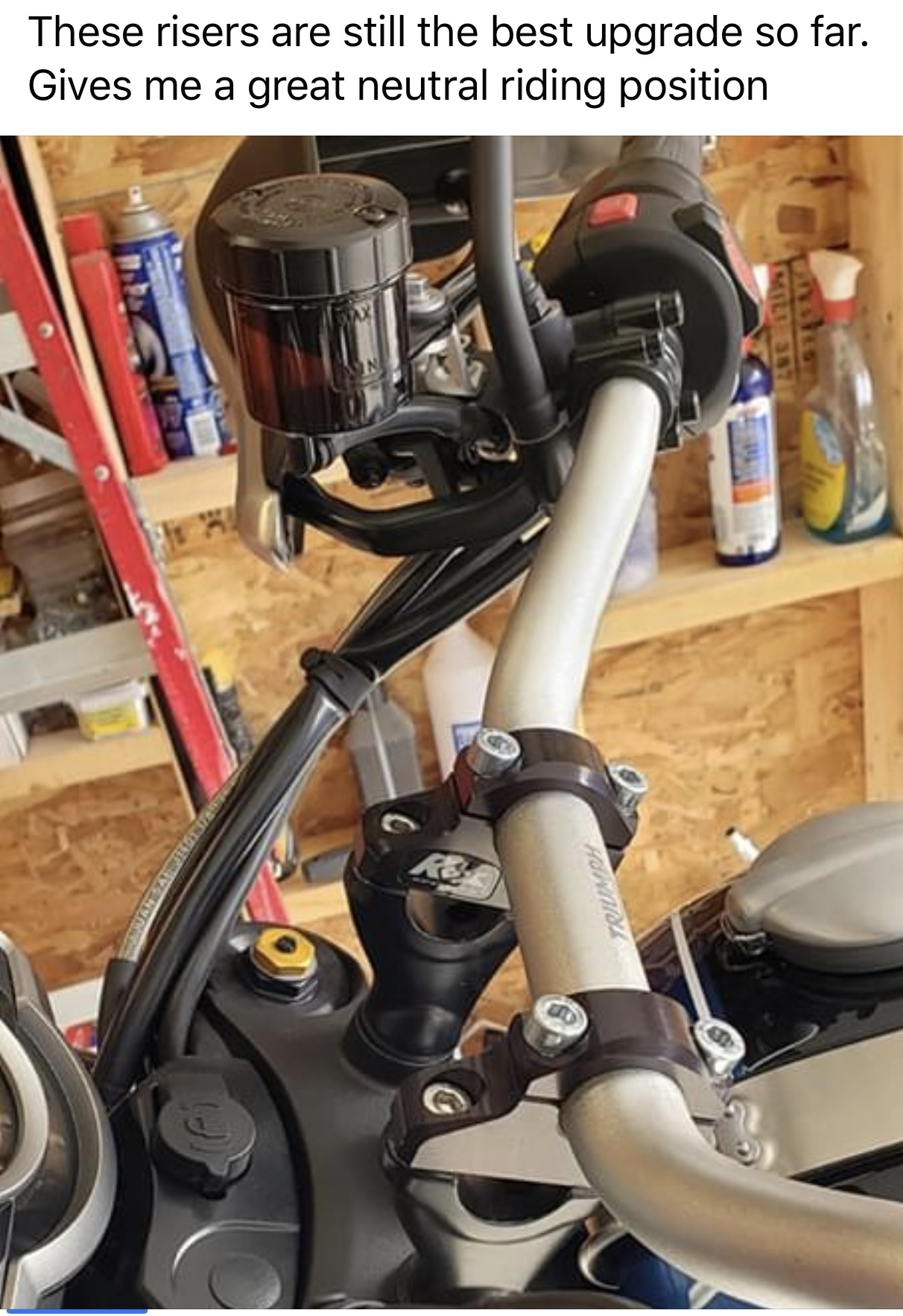

    Brett, saw this on a Facebook group
    #9
  10. Bret Morey
    Bret Morey Well-Known Member
    Apr 20, 2019
    65
    97
    83
    Alexandria, PA - USA
    Awesome Repooh. That is exactly what I'm looking for, and with a pick on a 1200 scram to show me how they look.
    Thank you!
    #10

    Some other dude on the thread commented
    I recommend the Rox rotating style. That way they are adjustable and you don't get that semicircle gap.
    #11

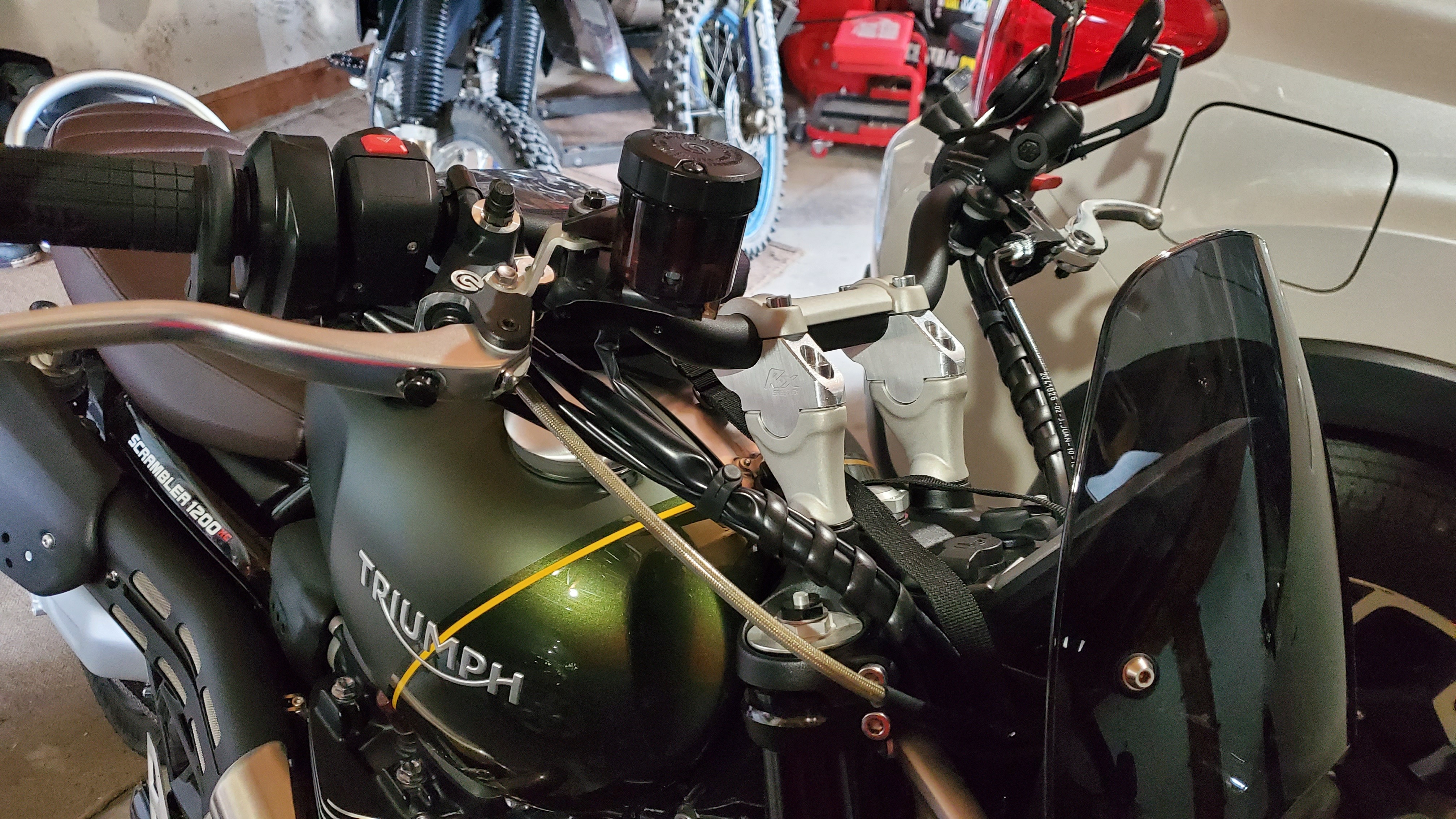

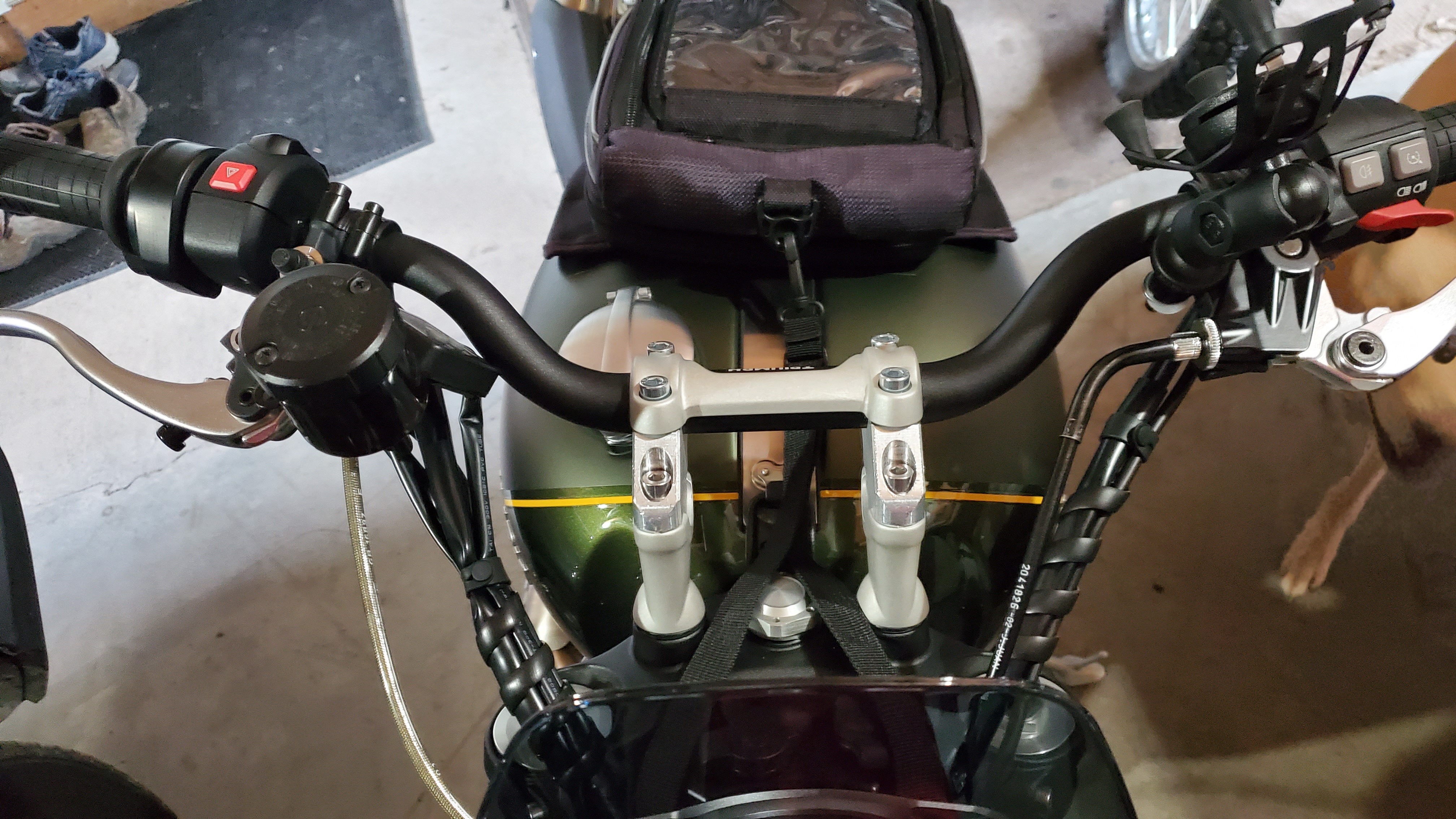

    risers received and installed. I was even able to use the stock triumph top-clamp, but had to cut some plastic crush shims to install between the clamp and riser. Gave me the rise and pullback I was after, and doesn't look too bad either.

    Sorry late to the party, but did you have to move any cable holder/clips/extension? Curious about this myself.
    #15
  16. Bret Morey
    Apr 20, 2019
    65
    97
    83
    I did not have to reroute any cables or remove any clips, but it was about as tight as it could have been and still succeeded. Your situation may be different depending on triumph's manufacturing tolerances.
    I actually tested by removing my bars and seeing how much I could pull them up and back before I placed the order.

    Correcting me if I’m wrong, but I notice the bars are titled slightly forward from looking at the brake reservoir. I’m just curious as I’m interested in getting these risers for my 1200xc and was wondering if you had any issues adjusting the handlebars to your liking. Did you have to use the crush sims so the stock clamp would tighten down all the way?

    My bars aren't tilted at all. They are aligned with the marks on the bars and mount, just as they were from dealership. I didn't have to make any adjustments other than installing the risers, and I did not need any special washers. The difference is pretty subtle, but it brought the bars back and up a little so I can ride a little more upright now.
