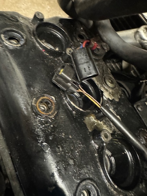

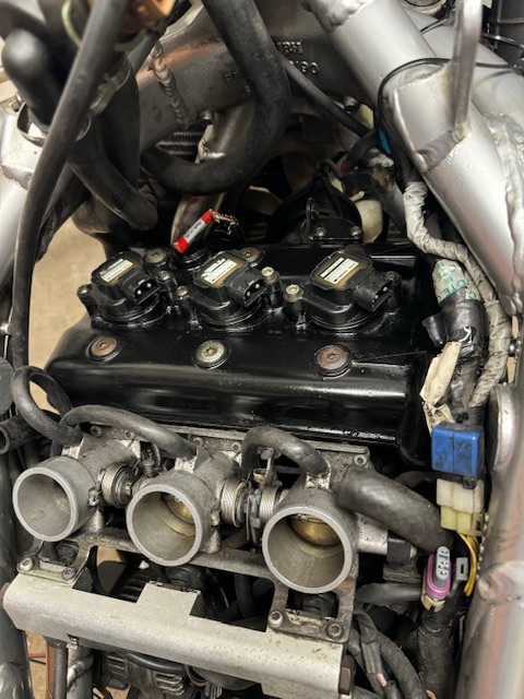

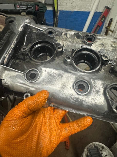

    Got the old girl out a few times and almost everytime I stopped there would be a plume of smoke from the right hand side fairing.

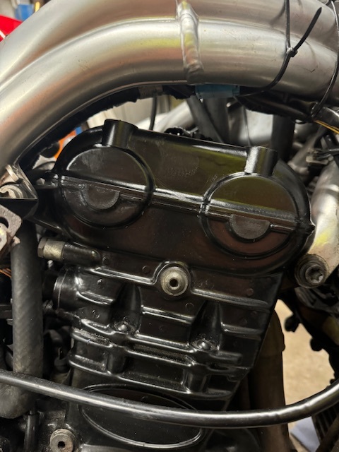

    Fairings, tank and airbox off, found a missing rubber washer around one of the cam cover bolts (how???). Oil was pooling then dripping on to the no3 downpipe. Took the opportunity to clean up the flaking cover and repaint it and order a new gasket and full set of rubber coated copper washers. Also stuck some foil coated insulation back to the belly pan which was missing.

    Got my new cam cover gasket and fitted the cover yesterday. I have to say this Plastikote satin is a perfect match for the engine paint/powder. I just wish I’d spent more time smoothing out the marks from the wire brush attachment, but it’s a 100% improvement!

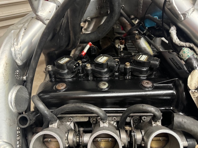

    Just to refit my new airbox and connect everything back up before I change the clutch pack as there is a bit of slip under hard acceleration. I bought a used clutch from National Triumph so I need to measure the difference between both clutches and use the best of both. It was only a tenner so no big deal. Should be done before the weekend is out.

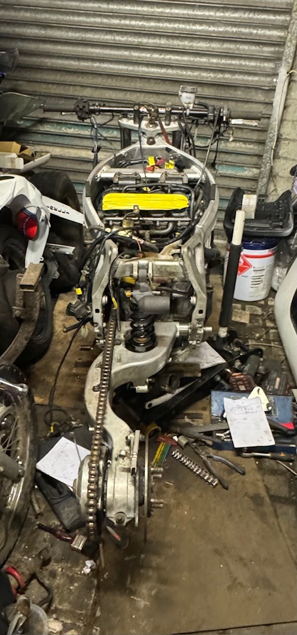

    My T595 maladies continue just now. I put the old girl back together and took her out, then found my clutch was indeed slipping at 6k plus. Took it out, replaced it with a new EBC HD clutch and springs after the used clutch from national Triumph being outside wear limits, then upon reassembly found an errant 6mm washer had fallen from somewhere in the area of the clutch, assuming it had been stuck to my glove as there are no m6x10mm washers in the clutch assembly it went back together. Took her out again and there was a mechanical bang before it fired up when it ran but on riding there was a rattle at around 1200-1500 revs when pulling off.
    Back apart I found another wash in and around the clutch pack under the pressure plate. This caused me to look a little harder this time and I found a PO had fitted 5 off 6x10 washers under the 6x20 spring retainers to maybe give them a lighter clutch which in turn was causing the clutch slip. This loose washer under the pressure plate caused the bang which was (I think) the cam chain tensioner pushing back. I replaced that with a spare and now it’s a damn sight quieter starting and running but it won’t start or idle without a whiff of throttle! I’m assuming the chain has jumped 1 tooth! Once I get home I’m gonna strip it down again and dial in the cam timing and cross my fingers that no permanent damage has been caused.

    I eventually retimed the cams and the inlet was indeed 2 teeth out. Timing now correct, cranks and runs without throttle but the rattle is still there. I decided to break the bike. I’m not going down the avenue of stripping a 35k lump and one with a cat marker at that. There’s just no financial sense to do that.

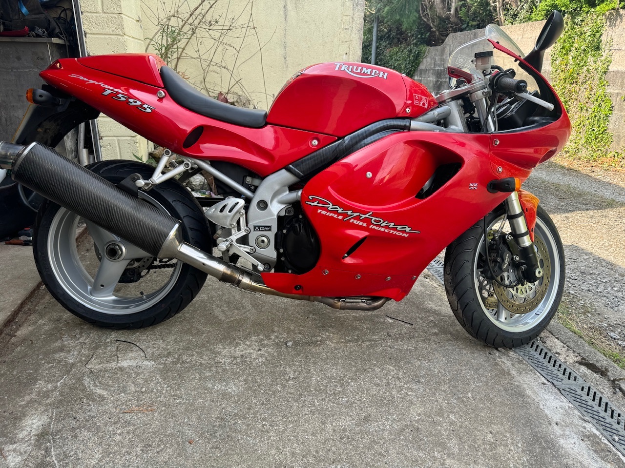

    I removed the complete front end and sold it for £600 which is reasonable money as it had all been refreshed and delivered it to Sheffield on my way to a course in Newcastle last week, the tank and pump is now fitted to my other T595, a 2819 mile 1 owner bike that I was recommissioning and the rest of the spares are available should anyone need anything.
    Here’s the finished low mileage 1 owner bike which is now awaiting its MOT.

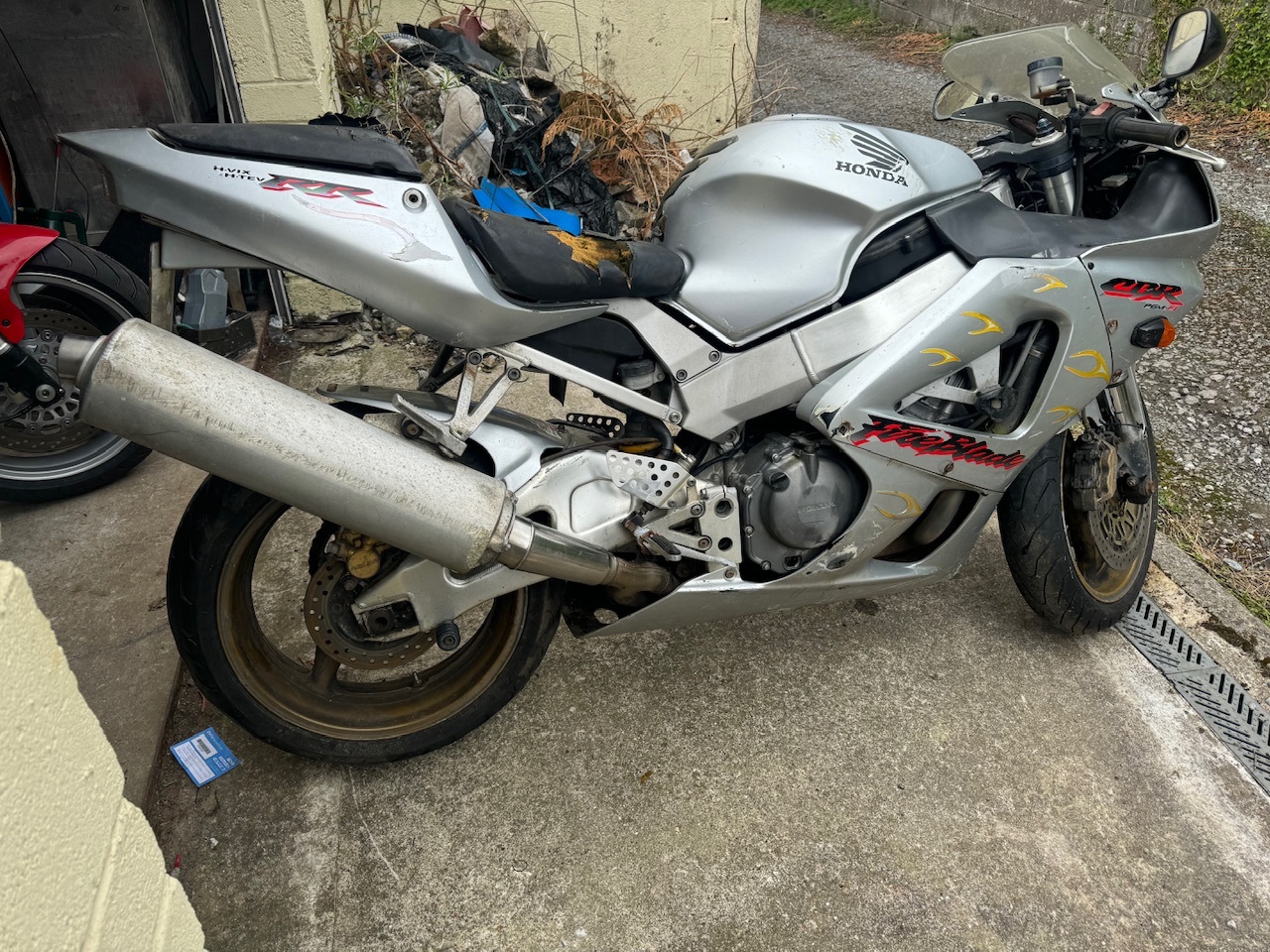

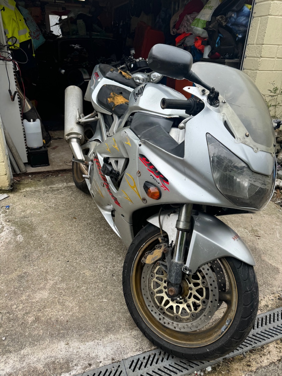

    Hey Joe, thanks for the kind words mate. For me I just enjoy bringing them back from the brink. With that in mind, I suppose I should also mention another project……a £400 2001 (seriously challenged) CBR929RRY Fireblade. The TL1000S is up next then the Blade! (Still got the 94 Streetfightered CBR900 to do too, all parts have been powder, bolts re-zinc plated and VFR750 single side swingarm and 929 CBR inverted forks trial fitted).:grinning:

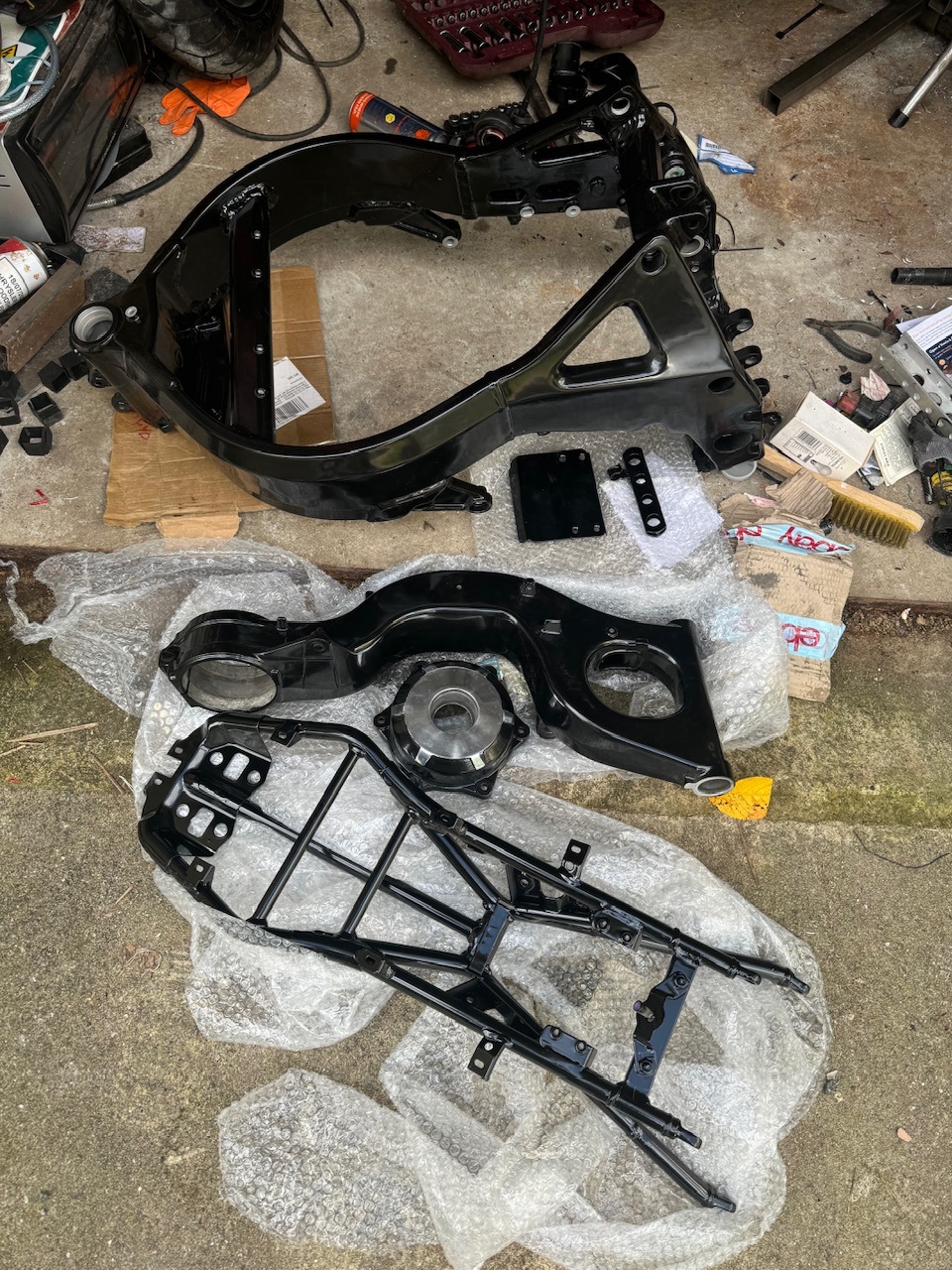

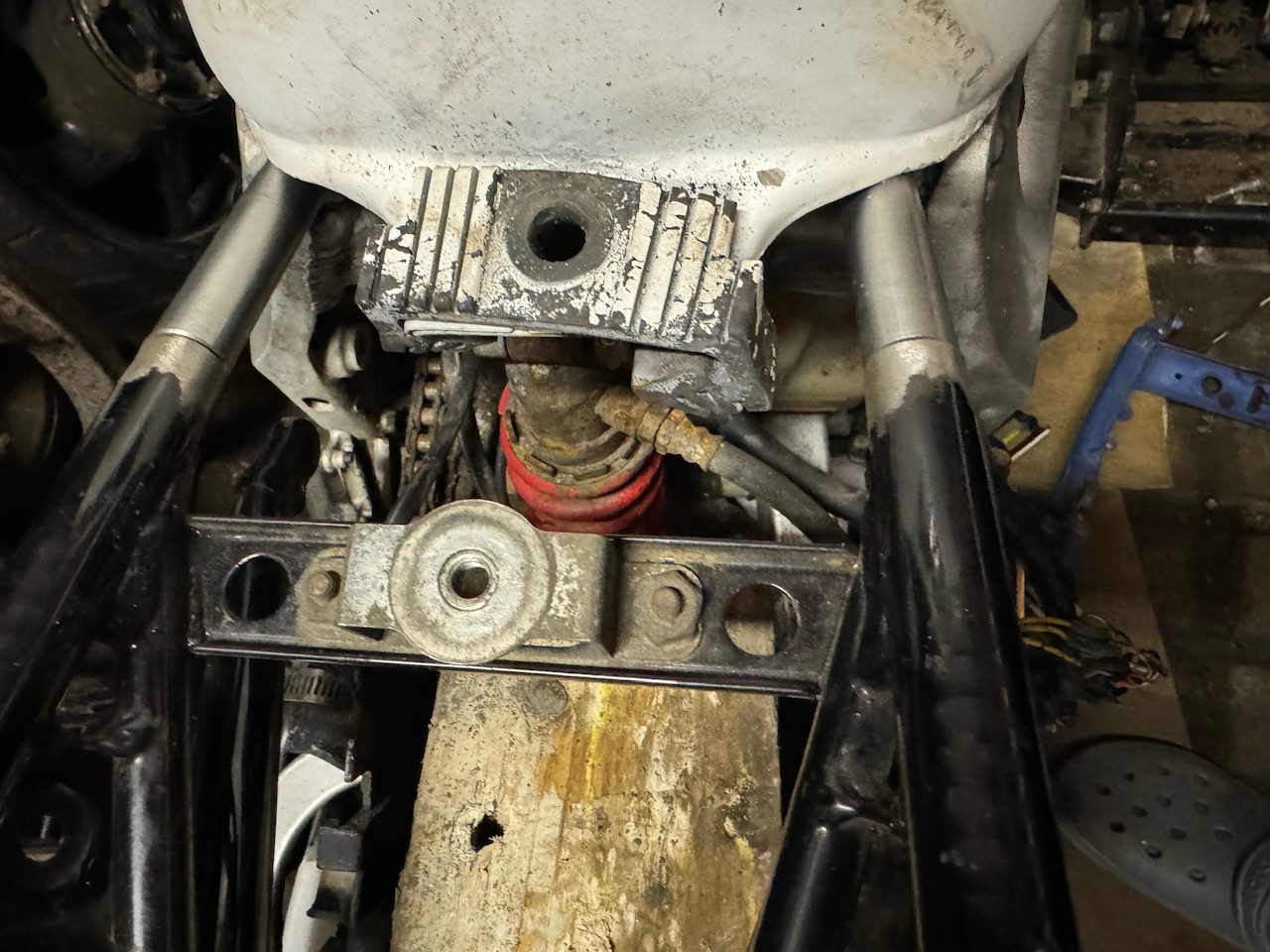

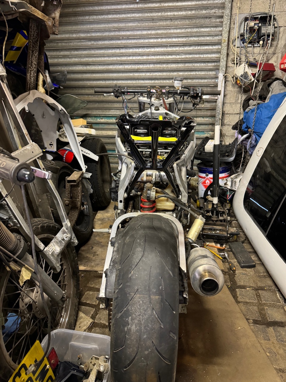

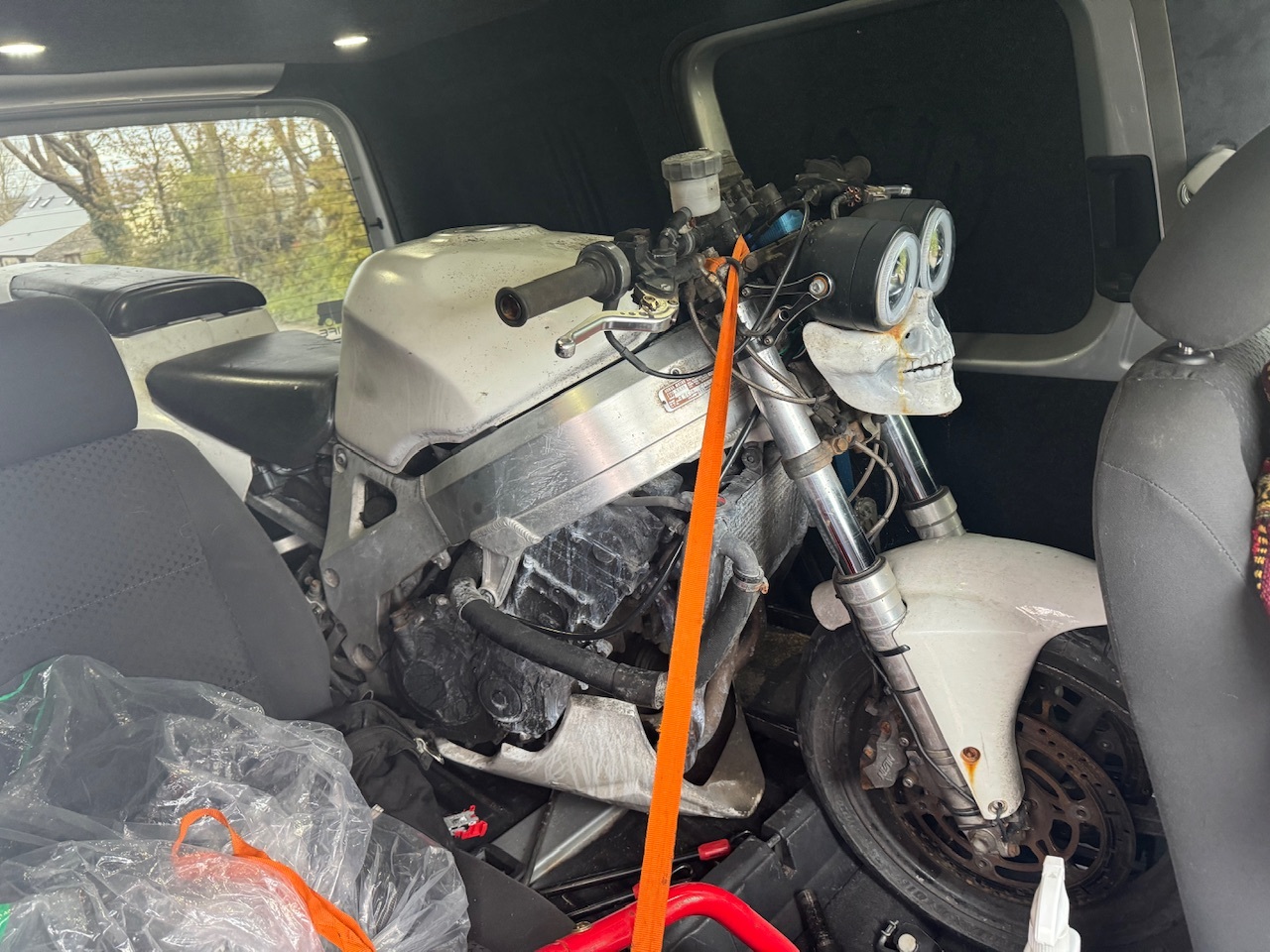

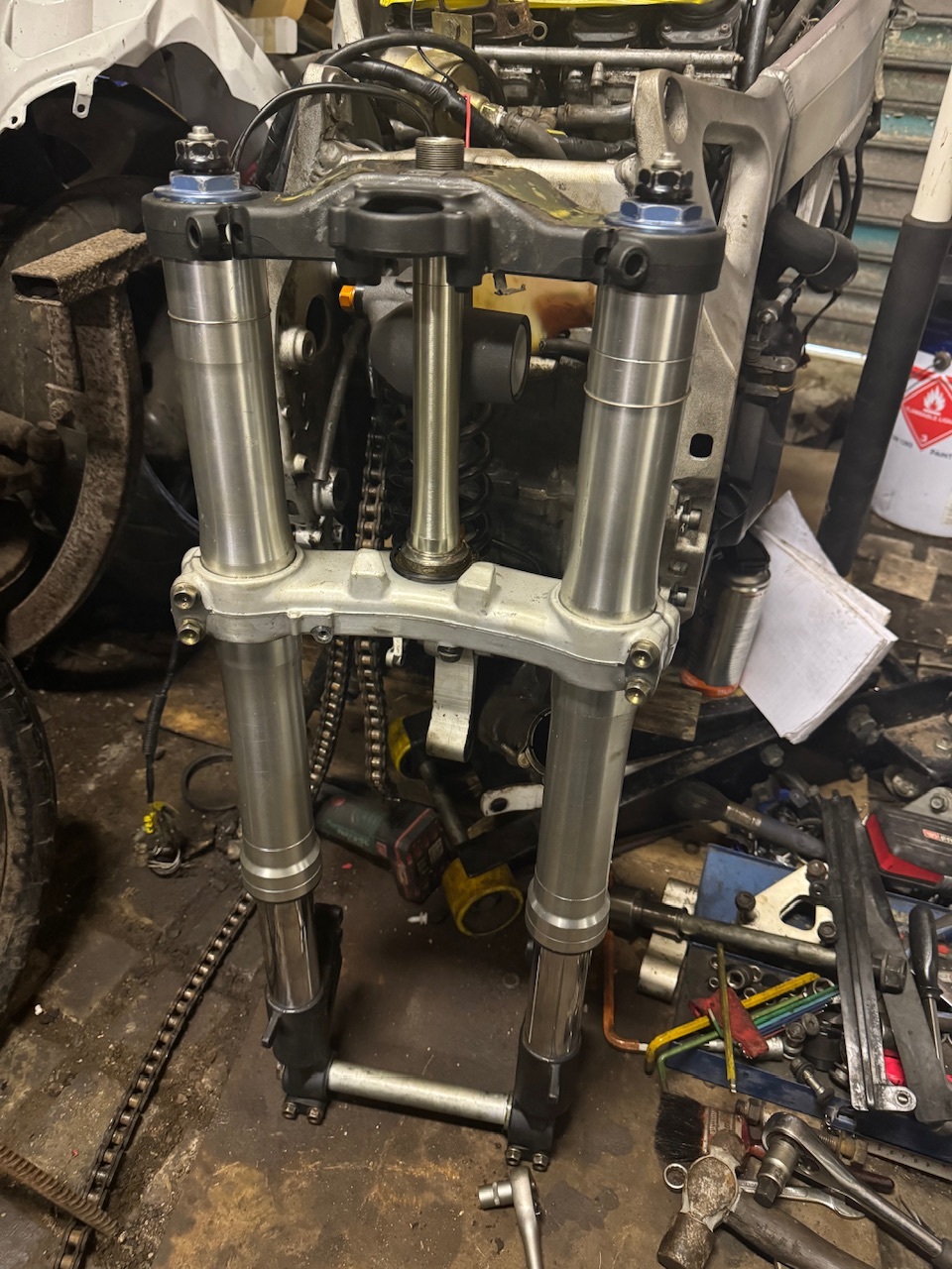

    How the 94 fighter arrived, someone needs their tools taking away:grinning:.
    Then modifying a Ducati 1098 subframe to fit the blade.

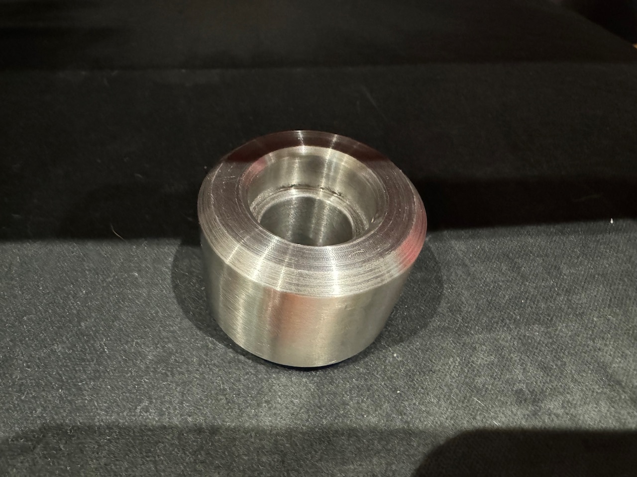

    Then removing the swingarm to fit a SSSA from a 93-97 VFR750 (easy swap) the knocking up a spacer to finish off the arm.
    followed by the usd front end from a 929 blade.
    then powder coating and re-zinc plating the cycle parts.

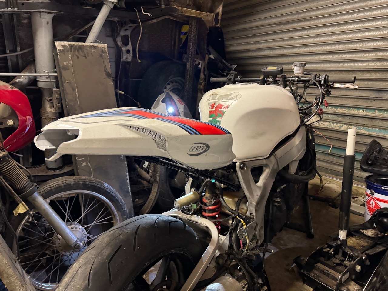

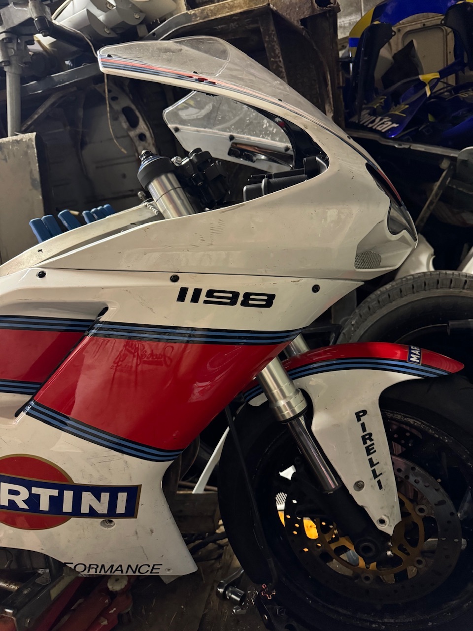

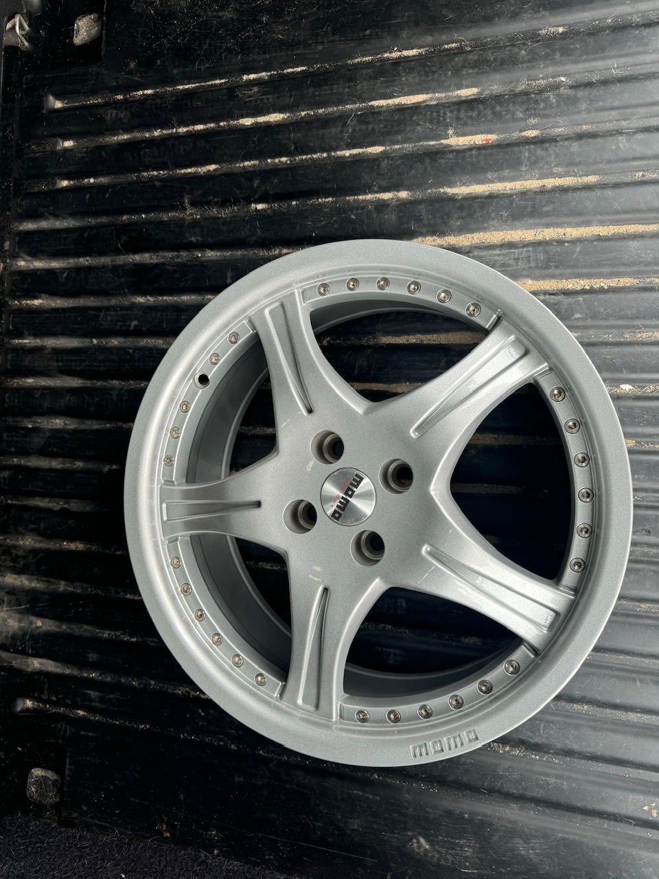

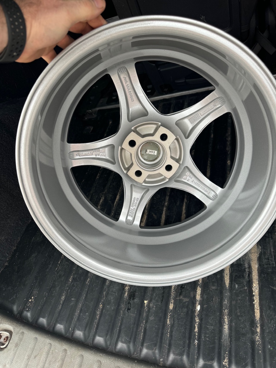

    …and how it’s currently going. There’s a 7” Momo rear wheel from a BMW Mini which I might use, and roughly fitted 1098 Bodywork (I’m not set on that yet, I might go Fireblade foxeye front with Duc tail, a sort of homage to the 90’s street fighters with a 916 tail.
    ….and the powder coated frame. All still to be pieced together but I need to sell my 93 Mini Cooper project to clear some really well needed build space. IMG_3503.jpeg

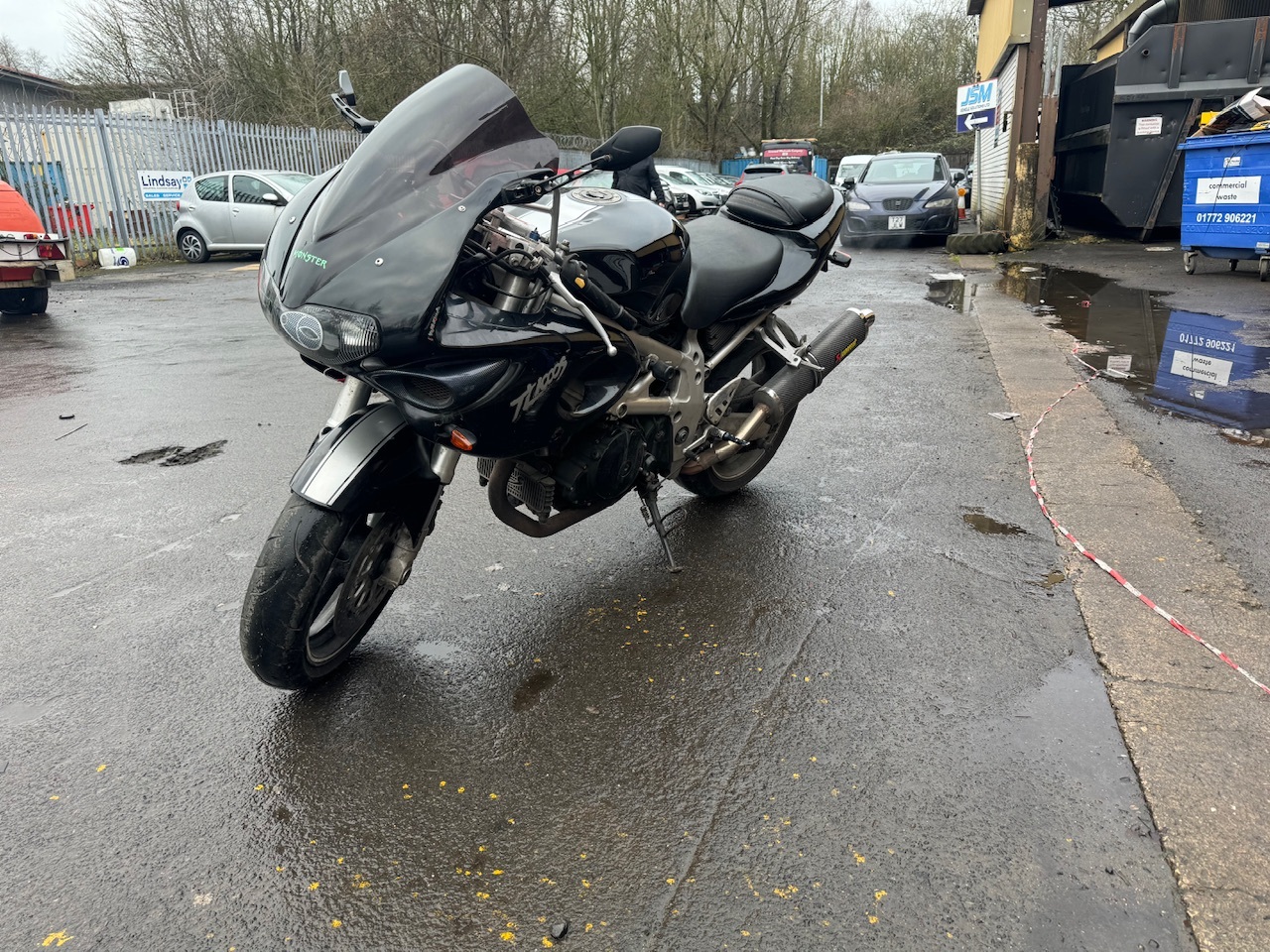

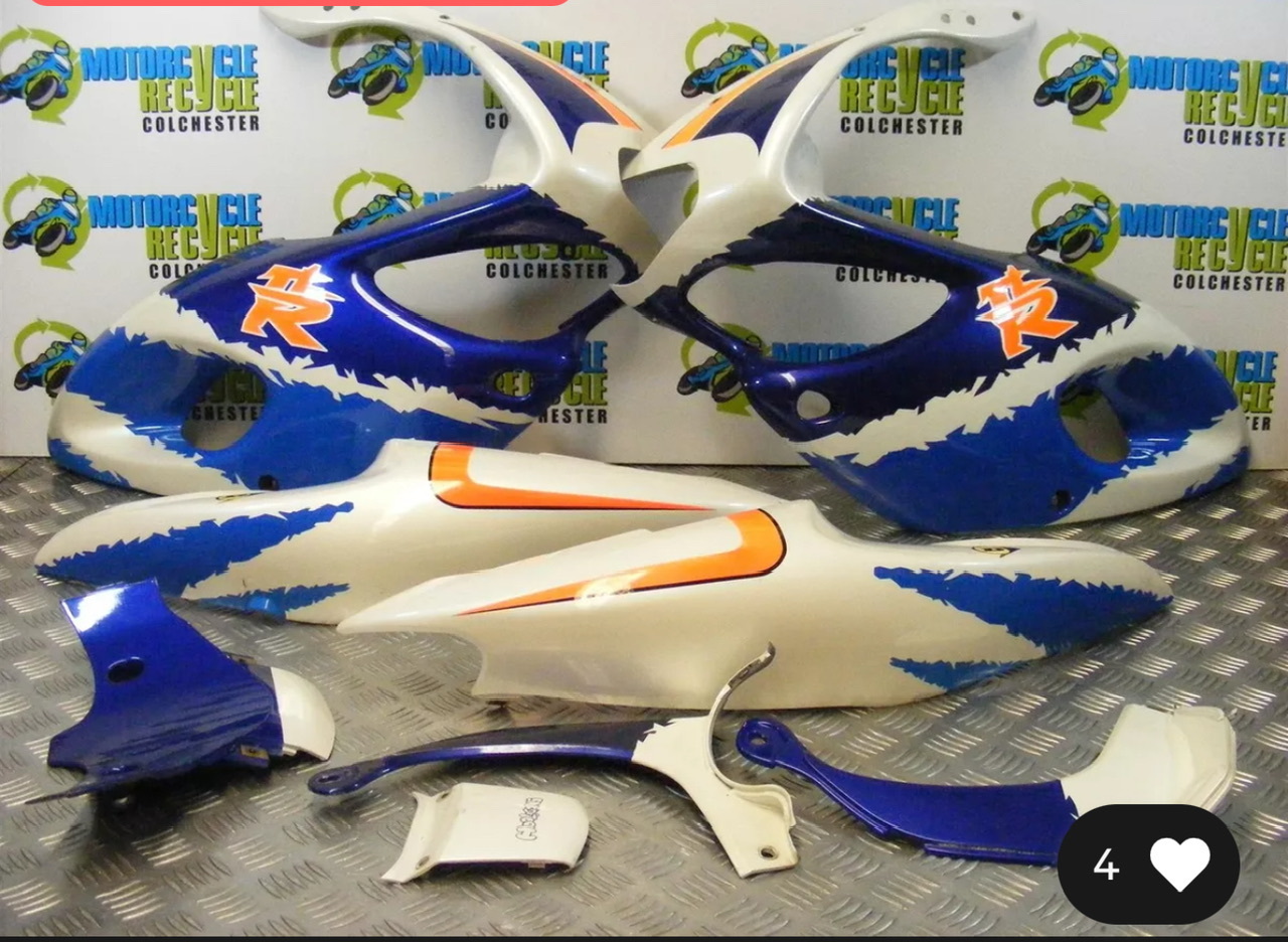

    Maesteg, South Wales

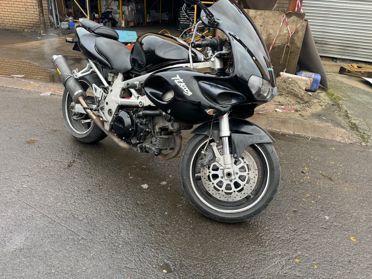

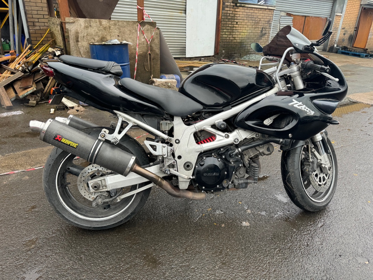

    So, that one on the back burner awaiting space to ‘do work’ and there’s this, which is an easy recommission, just fit a couple of exhaust gaskets, check brakes, oils and fluids then fit the eBlag bodywork to give her a visual lift and she’s mot’able…….
    My garages are turning into a 90’s teenagers bedroom wall!:grinning::joy:

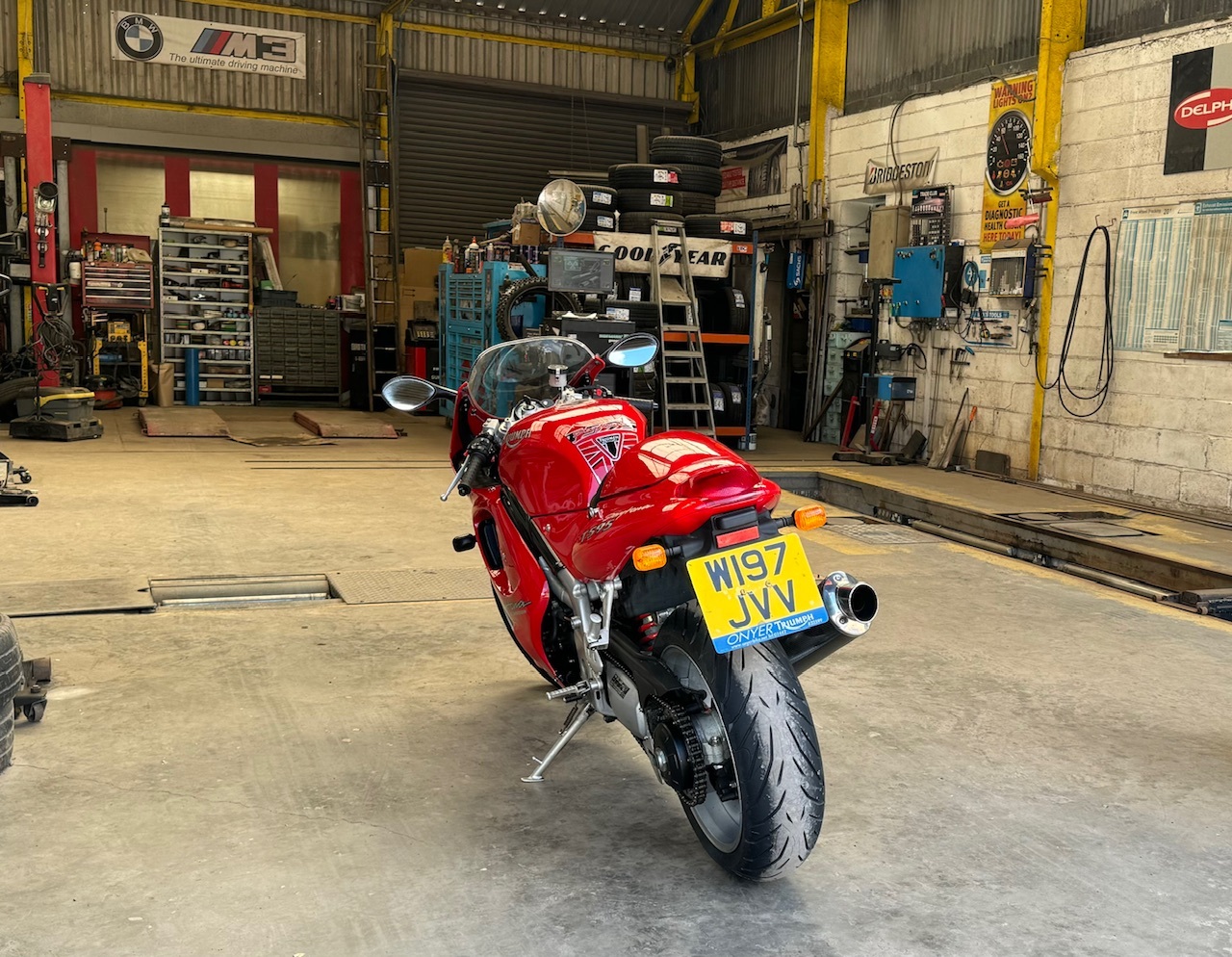

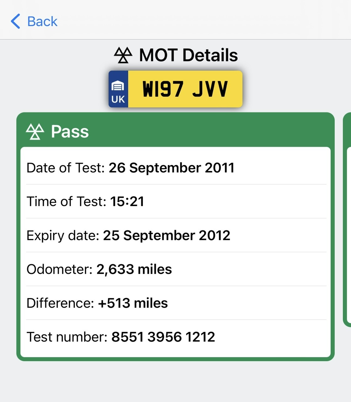

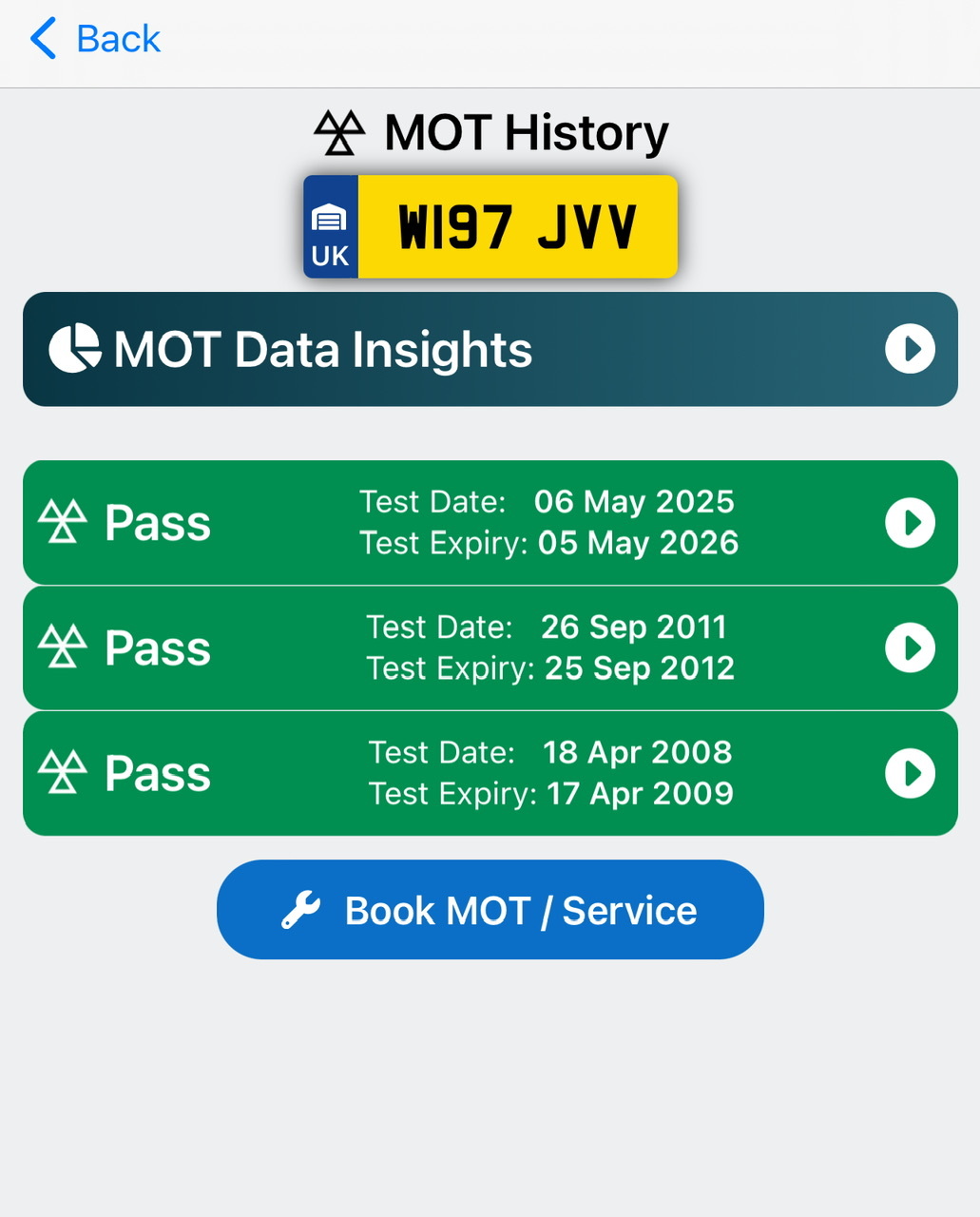

    Well the old girl got a clean sheet on her first mot since 2011. Rides superbly too.
