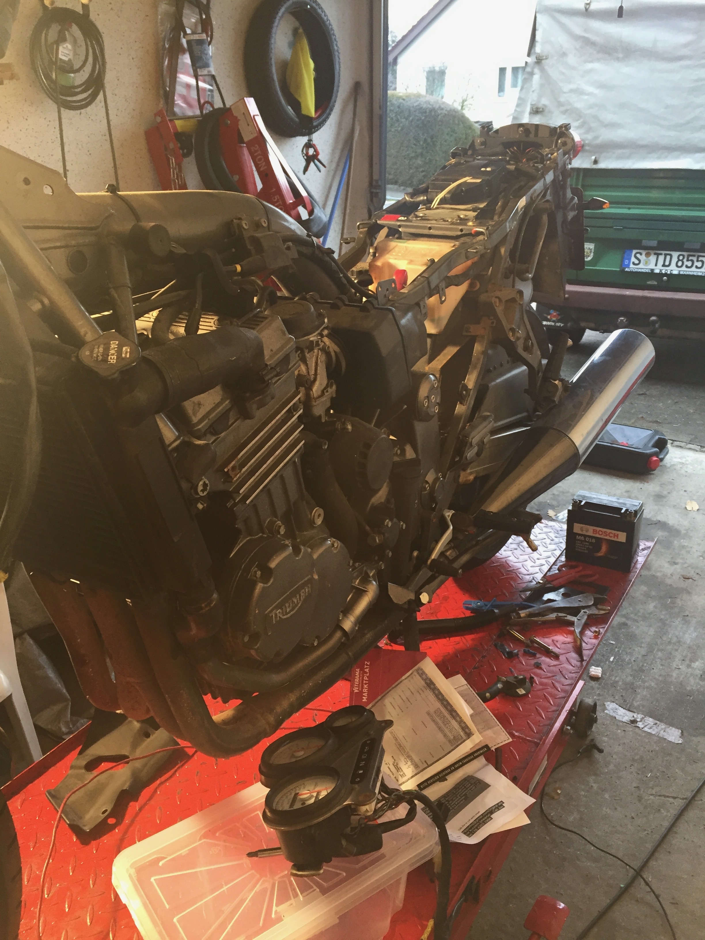

    I ordered my kit from Ian and the book arrived. I began the teardown. Here are some pics.

    After the tear down, I had a cup of coffee and just let her talk to me. I will discuss paint scheme ideas later. BTW Im working in a detached garage with a Halogen lamp, a small space heater and two kerosene lanterns (for the heat they put out) its not too bad. The PO said she was running really bad( see photo 2), I purchased on the fact she had compression and spark.
    EDIT: I see where the wires are correct, I thought I found a Duh moment. I suppose the terrible running will be the carbs

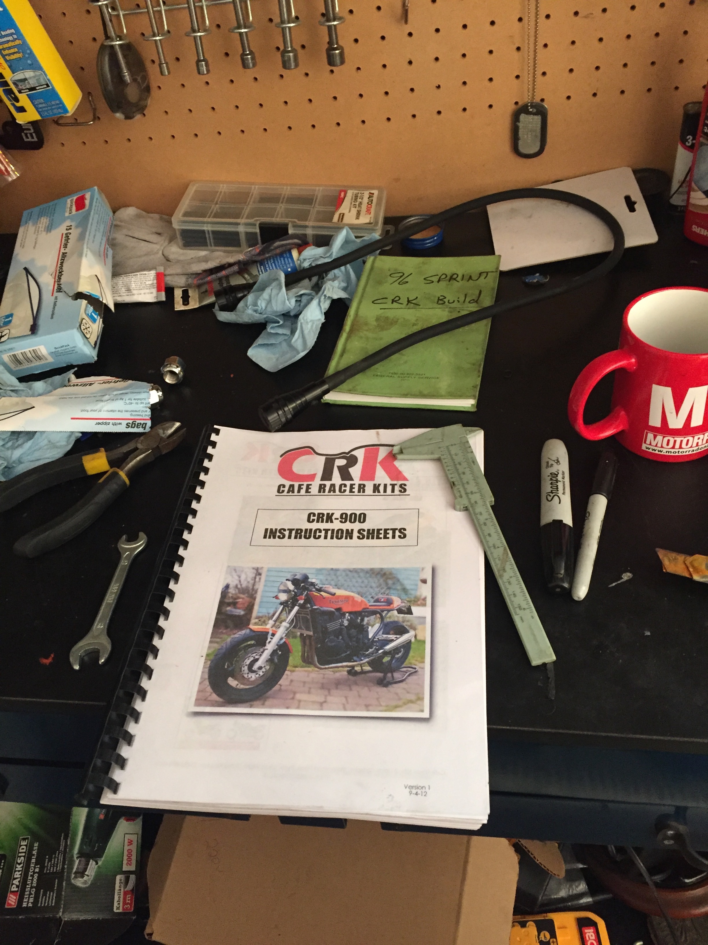

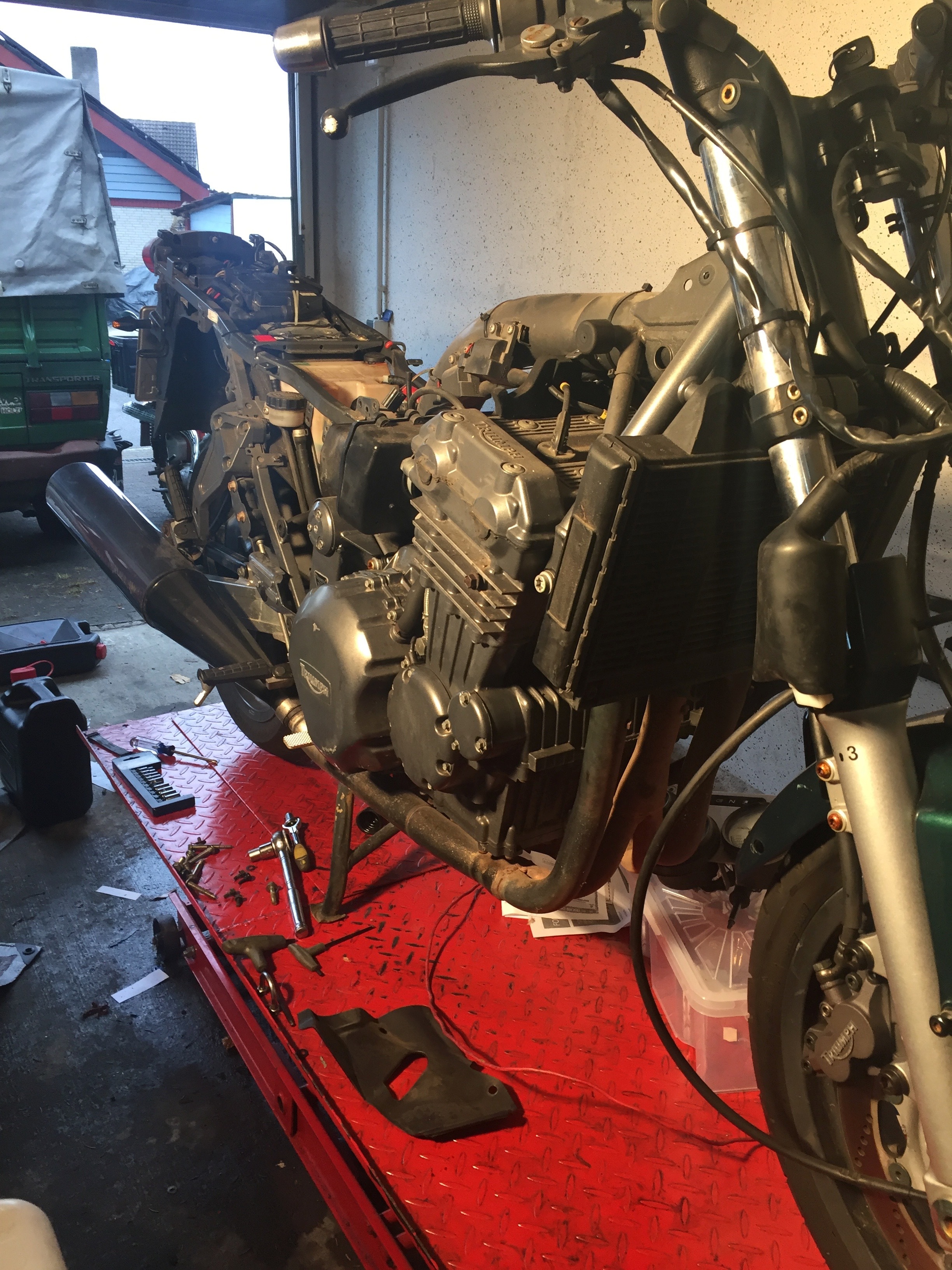

    Another few hours spent in a noble pursuit. Funny but I noticed all the fasteners are metric (as expected) except the hydraulic line fittings, they were 9/16 SAE See photo 1. It reminded me back in my teenage criminal days when after butchering my BSA A65 with standard/metric mixed bag and still having issues, the nice older gentleman down the street with an Austin Healy asked me if I had any "Whitworth" tools.
    What??/ there are only metric and standard right? Live and learn. Yes I was a BSA guy because we had a big BSA dealer right up to the end and the city was flooded with bikes in sheds that didn't run by the mid 1970s. I was broke so, free bikes or I'll paint your house for that old bike in the garage. One day I finagled a Norton and left BSA forever.
    I drained the coolant and was very happy with the condition at first, then it turned sickly rust brown. No worries I shall cleanse.

    After I dropped the exhaust and got a real close look at everything, I noticed a whole lot of silicone squished out of almost everywhere, since the factory didn't do that I wonder if it had a sprag problem and somebody had to open her up. I'll change almost all the gaskets anyway as Im doing an engine out restoration/modification. There will be a small amount of powder coated accents. Even the exhaust had silicone...yuck.
    Ive done almost all the easy stuff now.

    As I write the third and final entry today, I leave my shop knowing I have work to do and that makes me nuts. I have too much to do over the next 3 days before we go on holiday so I won't post for at least two weeks except maybe a pic of me being miserable at some stupid tourist attraction when Id rather be dirty and cold in my shed, like all of us. The second photo is the offending member.

    I would hope but photo 3, the one below the exhaust is the engine case
    Thats what happened when you got no history. No matter, she spins, she compresses, and she sparks. She will run.
