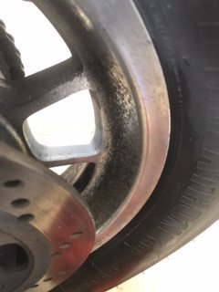

    My bro is looking at buying an America, it has to be blue, why?
    Anyway he saw one advertised at Wigan Yamaha, less than a year old and when sent photos these showed a lot of corrosion on the rear wheel! Is this an issue with americas or has it been totally neglected over the winter?

  6. MrOrange
    #6 MrOrange, Jun 21, 2017
    Put away wet ! Simple as that. But it's not the end of the world, when I bought mine, even tho' only 1200 miles on it, there was a fair bit of surface corrosion on the wheels and the chrome sissy bar. My guess was put away wet and left till he could be arsed to sell / swap it!!!
    Took a bit of elbow grease, autosol and swearing, but can be cleaned up fairly easily. A lot easier with the wheel out, and worth the effort rather than struggling to get at it.
    Had a look, it does look noticeable, get £500 knocked off or they get it sorted first! !!! Seems a fair chunk of money for it, so should be right. Or just factor in £50 to get it polished.

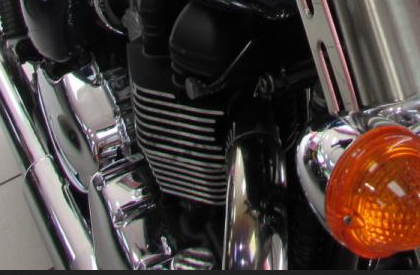

  7. MrOrange
    just seen engine fins, some tosser has not looked after that bike !!!!! It is all sortable, as the surface's are all bare alloy, wheels and fins, but not for top money from a dealer!!!!

    Thanks all, I've told him to steer clear of that one as it's not in the condition you'd want to buy without viewing . Found one a bit closer to home so hopefully it'll come up to spec!

    What's the best way to maintain the engine fins in good condition?
    The left hand side on my Speedmaster is getting a little corrosion on the fins
  11. MrOrange
    First cleaned it up using 800 wet and dry, a block of hardwood (to keep it flat) and WD40/GT85 as the 'wet'. Then sprayed in ACF50, corrosion has never come back.

    Another dealer, late 15 plate, 2k miles same with corrosion, definitely has to be kept clean and protected by the looks of it
  13. MrOrange
    That could just be muck! Mine looked worse after 600 miles up to Aberdeen and back! Muc-off, and a wheel brush had them shiny soon after.
    But the bare metal finish is not brilliant, if a big issue, factor in £100 to get them powder coated silver ? That was my intention, but to be honest. Once cleaned and coat of ACF50, they clean up OK at every wash.
    At least not lacquered, once water under, that does look a mess.
