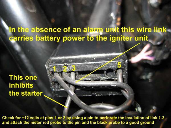

    Look for a block connector on the rear mudguard behind the ECU & battery area. It should have a visible short wire loop providing continuity if there is no immobiliser fitted.

    Here you go

    Without the continuity loop it won’t run! Otherwise no effect.

    Hi, with regards the picture with the links. Is this the same for all triumphs. I have a speed triple 995i and the immobiliser won’t disarm. Can’t find an in line fuse the manual talks about so next option is to remove the unit and link it out.
