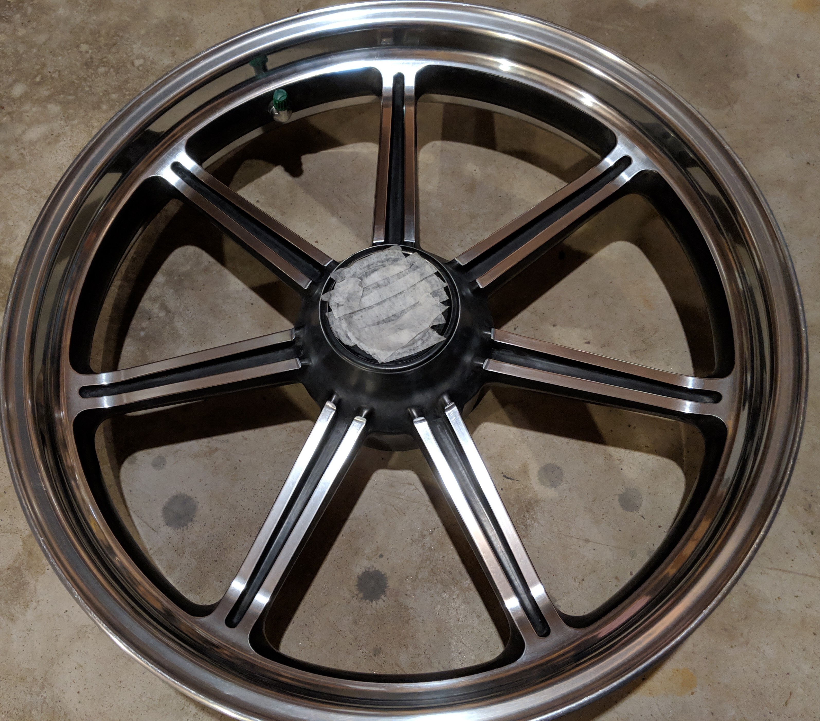

    Thanks for all the advice on restoring aluminum wheels. One out of two is complete, about 11 hours of work. Not perfect, some fine pitting but realistically it looks fantastic. Still have to get the black looking nice, maybe a nice clear coat I'm not sure.
    Grits:
    220
    400
    1000
    2000
    Mothers aluminum polish
    Before and after...
  20. freck
    freck Elite Member
    May 4, 2017
    1,721
    Preston, Lancs, UK
    Superb job mate, that looks fantastic.:grinning:
