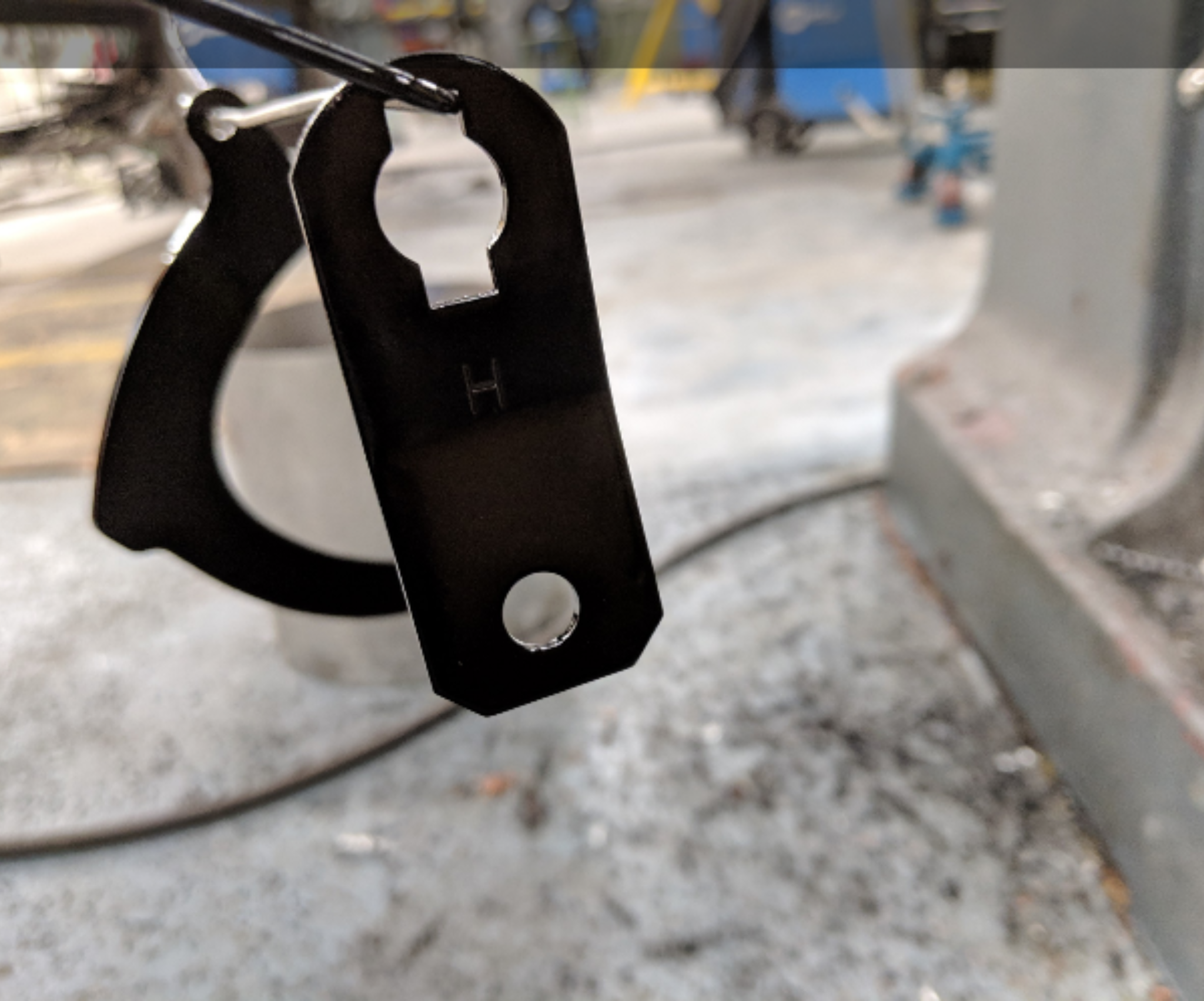

    So I have mentioned before I think that I'm blessed to have a mechanic buddy. Well he came over and we tore it down more. We are going to clean what can be cleaned and blast and paint what has rust. Turns out the frame proper is essentially rust free. Bits and pieces not so much.
    The frame will spot sand and paint in hidden bits. The cast iron bit at the bottom of the triple tree has some rust so trying to figure out fixing that without taking it all apart, same for the bit around the fork ears (headlight bracket) that actually has wires running through it.
    We may even be able to powder coat although the oven he was supposed to get in his shop is not there yet so it may all be painted. (Properly, prime, several layers clear coat etc).
    Tonight we are going to start cleaning up some and see what buffing can do for the largely unrusted chrome as well.
    Have decided the rear suspension is beyond saving and will be blasted and painted probably black. Thoughts on that?
    Attached are the many before photos. Thank to Callumity for encouraging me to do more tear down.
    Before pics below...

    Second set of update photos. Had to screenshot these as I didn't dumb down the camera resolution and it won't let me upload originals so hopefully they will show well. I will add some soon as well of the surface rust I want to sand/scrub somehow and paint by hand or as suggested here.

    Progress pics: blasting and start of painting part 1

    Blasting and painting part 2
    Shined up the horn as well. Results have me excited for the pipes and various chromy bits.

    Gents... Before I get too far into the painting I just thought of something .
    Obviously(?) I haven't gone out and bought a bunch of "Triumph PG Jet Black" OEM paint. This is just high quality paint from the shop with a good primer, several coats and then a few coats of clear coat .
    Question is... What should that paint look like? Is it a high gloss finish originally? Because so far we have been using high gloss... There are also matte versions available at the shop... I think matte, gloss and high gloss? Need advice on this asap before we do more painting .
