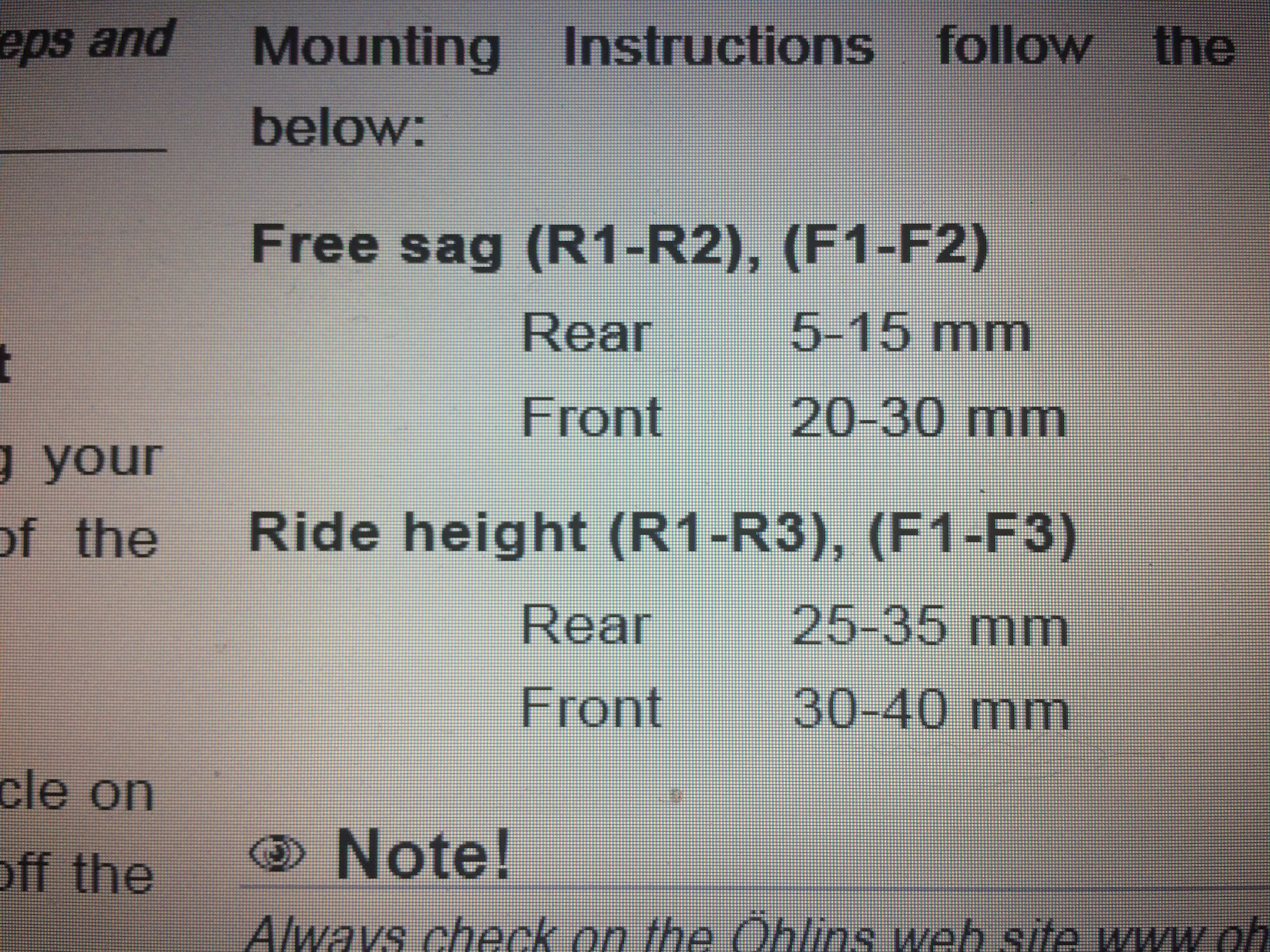

  10. SteveRS
    SteveRS First Class Member
    Jan 12, 2019
    862
    British Columbia

    seting preload is the first thing to get right before you start mucking on with comp/reb, 25mm unladen sag at front with no rider on and about 14mm at the rear, this is a good ball park starting figure , front sag is never the same as the rear, with the rider on you want about another 20mm more travel on the stroke, this will tell you if your in the spring range, then work on comp/reb adjustments, preload at the front is counted as fully off then turns in, simples

    Found out suspension travel on R model (should be same on non R), rider sag should take up about 1/3 of you travel.
    120mm on front
    130mm on rear

    So rider sag should be about just over 35mm front and 40mm rear, bang on where I ended up with mine.
