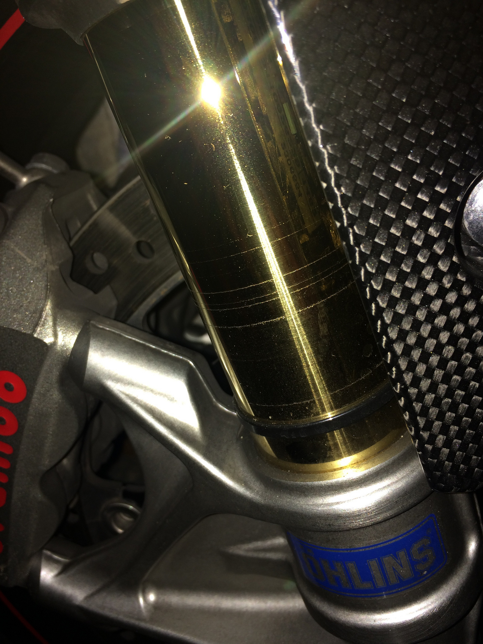

    Sounds like you may need less preload and compression damping. I whent to comfort settings on my R, and also broke the law and wound the rear preload adjuster all the way out!
    Aim for 10-15mm of static sag and 35-40 rider sag sat on bike in riding gear.
    Put a tie wrap round one of your lower fork legs and slide up to dust seal, this will show how much suspention you are using, then you will know what way to adjust your preload.
    You want to be getting full travel under braking without bottoming out. like mine below.
    [​IMG]Untitled by Bryan Haynes, on Flickr
    Check out Dave Moss Tuning and Two Clicks Out on Youtube.
    #7
