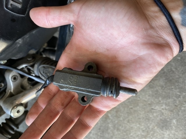

    Hey everyone.
    So I’m still working on this and getting it ready. Almost turning over but need a few things to get it done. Curious though, what the heck is this piece? I’ve read the manual and can find anything on it.

  6. capt
    capt Elite Member
    May 8, 2016
    3,052
    western Australia
    Side stand switch , prevents you riding off with stand down , engine cuts out as soon as you let clutch out when in gear with the side stand down.
  7. dilligaf
    Yep side stand switch :)
  8. Enis Tezcan
    Enis Tezcan Member
    Jul 15, 2020
    27
    Chicago
    #8 Enis Tezcan, Aug 17, 2020
    Oh geez. Thank you everyone.
    I must have been overlooking that constantly.

    Assuming that you sorted the side stand switch. Does the clutch lever need to be held on an Adventurer?

    Does the Adventurer have a side stand switch? I've combed through the manual numerous times and haven't come across that.

    Not sure, I thought you came across one in the picture earlier on this thread. Just trying to think of reasons why it won't start.

    Oh right. That went clear over my head. I did. Too many things I am trying to go over and think of. Sorry.
    That I haven't had the chance to go back to just yet. But, it's on a 2'-3' long wire/cable at this time. Is that supposed to be hooked up to anything? Sometimes reading that manual is like trying to decipher hieroglyphics.

    If that's a side stand switch, and I'm not saying it isn't, it doesn't look like any one I've seen. The ones I've seen have a spring-loaded in/out switch rather than a toggle.
