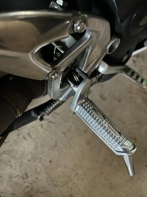

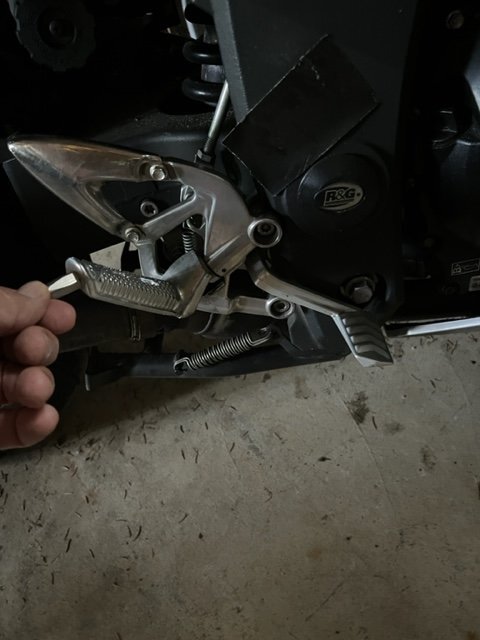

    For anyone interested, I received the Buell Drop Pegs. They required a fair amount of grinding to fit, as the mounting point was a bit wider than the OEM peg. I also had to modify the curve to allow the peg to retract with the spring.
    I carefully ground the drop peg to fit. The mounting was a bit thinner than the original, but there's plenty of material left, and the peg is solid.
    The 1" drop is a noticeable improvement, and there's enough adjustment in the brake and shift levers to accommodate. I don't know if I could say the same for the 40mm drop pegs that I've seen as part of my search (these are about 25mm).

    Nice job, I'm tempted to do the same. Do they still pivot up on a spring?

    Yup! The OEM spring fits fine, but I spent a lot of time grinding the mounting point to make it round instead of square. The drop pegs are aluminum, so they grind easily on a benchtop grinder. But I was very careful and constantly fitted them to the mounting point so I didn't have to take any more material off than I needed.

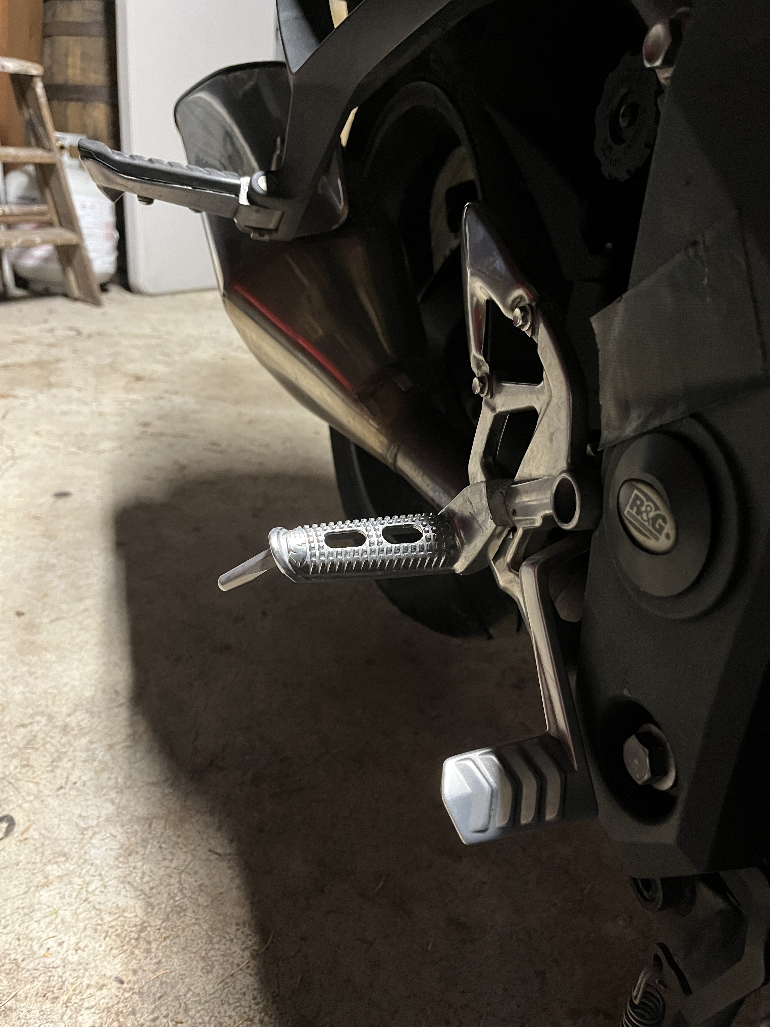

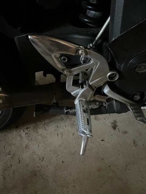

    A few extra photos to show the spring installation. Note that the drop pegs were ground a bit to fit into the mounting point of the bike, but there's plenty of material and strength.
