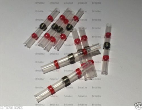

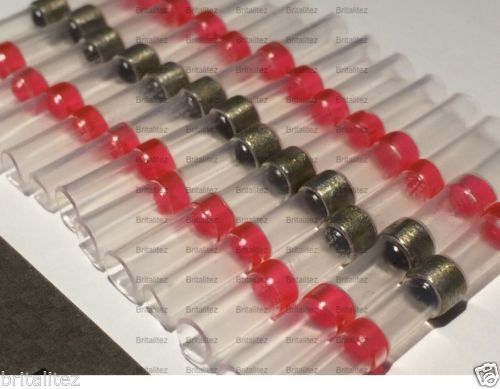

    you can buy connectors cheaply that have a clear plastic sheaf and solder built in,you just slide wires inside and heat with gun or soldering iron you seal both ends and melt solder in middle covering both wires neat and easy. s-l500 (2).jpg s-l500 (3).jpg

    I saw these used in a video tutroial and thought they looked pretty cool! I've has a look but can't find anywhere locally that has them and I need them today really, otherwise I'd of given them a go. I might still pick some up :)

    eBay is where i found them but no good if u need them asap handy to have though.

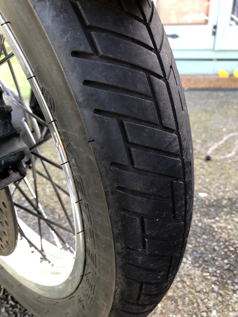

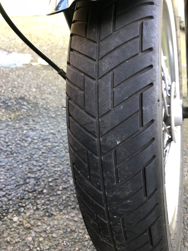

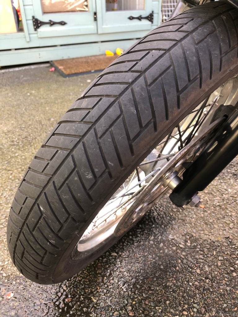

    Well done, I can guess what your next question is going to be......judging by the state of your front tyre!!!!

    That bad? Only went through the MOT a few months ago and nothing came up as an advisory, not ridden it much since either.
    Admittedly I know bugger all about these things but there's a good few mm of tread all the way around.
    If you think it looks awful though I'll look for a fresh one.

    It looks fine in those last photos, must have been a trick of the light in that first one.
