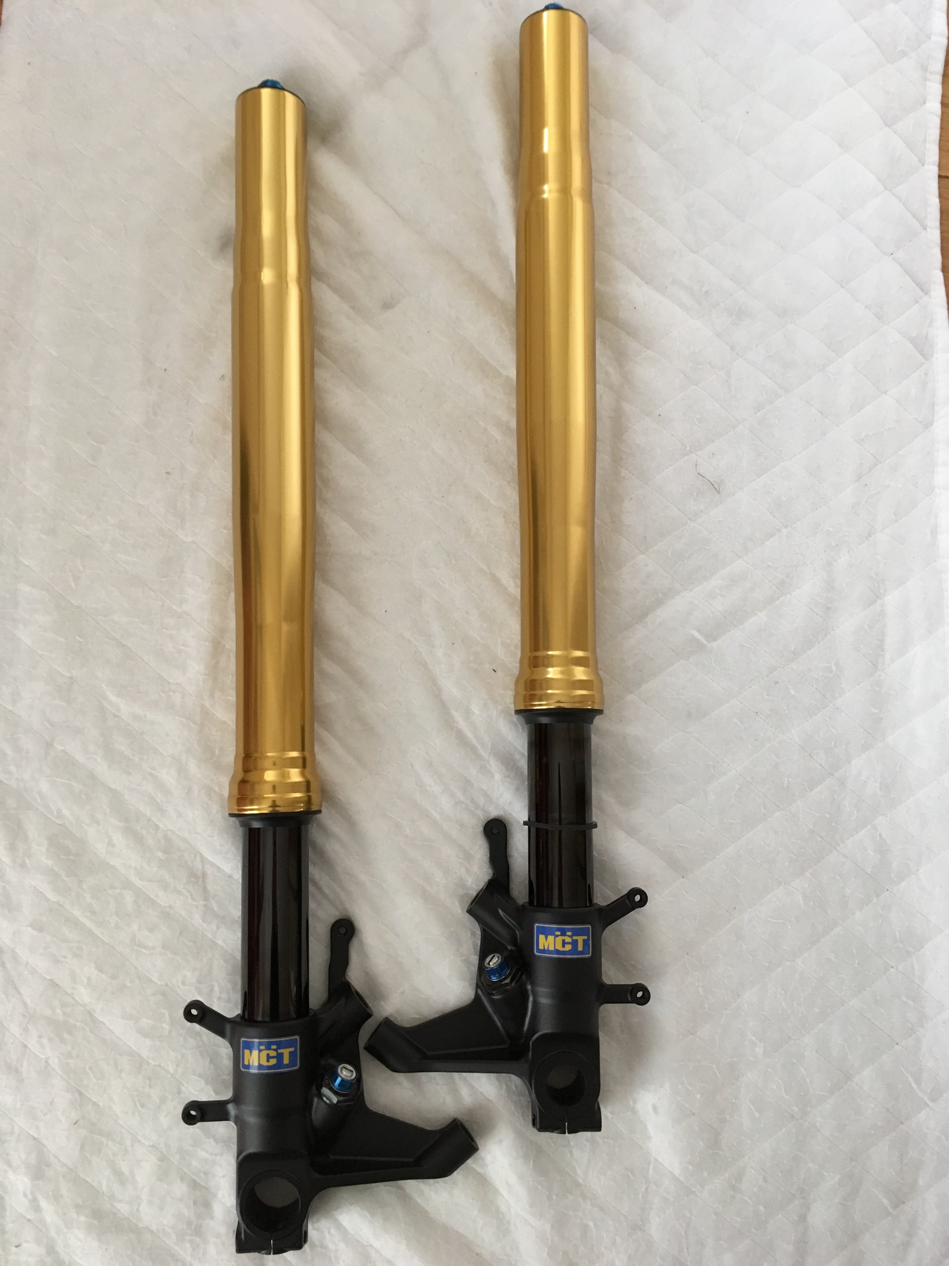

    I stripped the forks, had the tubes mirror polished and then anodised gold, I then had then fork bottoms vapour blasted and Cerakoted. The whole lot was then dropped at MCT who rebuilt them with new springs, seals and valving to suit the SRAD. This has a triple benefit; 1) They look cool 2) They should improve the handling 3) They allow a much better brake set-up.
    The GSX-R 1000 wheels are much lighter than the SRAD wheels and so aid acceleration, turning, braking and handling. They look a bit nicer too.

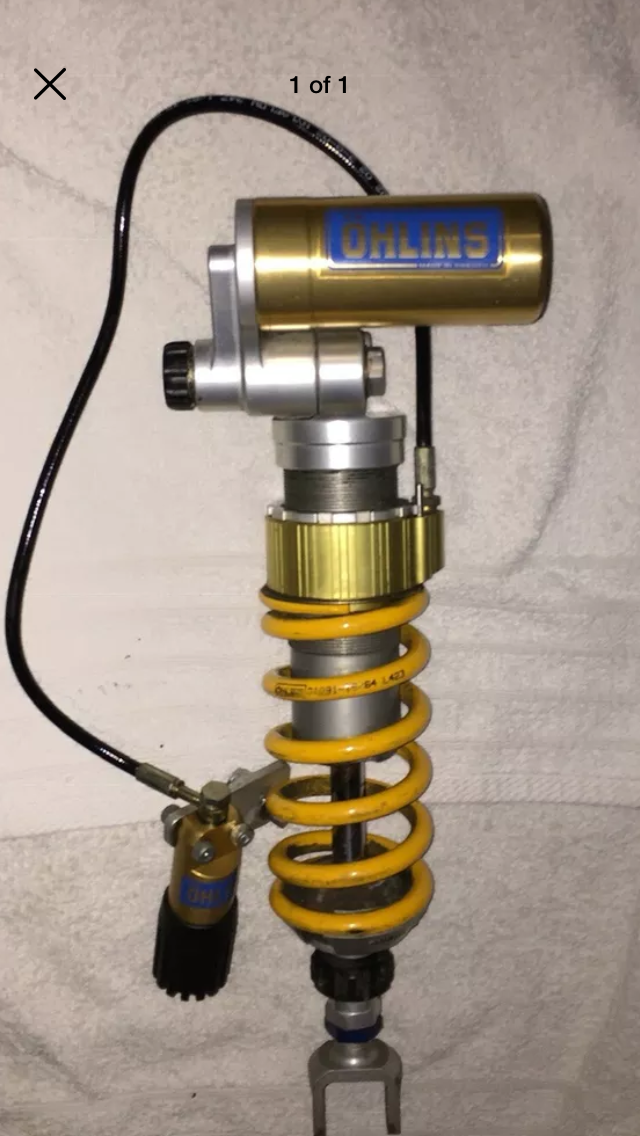

    I also found a cosmetically very good Ohlins rear shock. That will get a full rebuild.

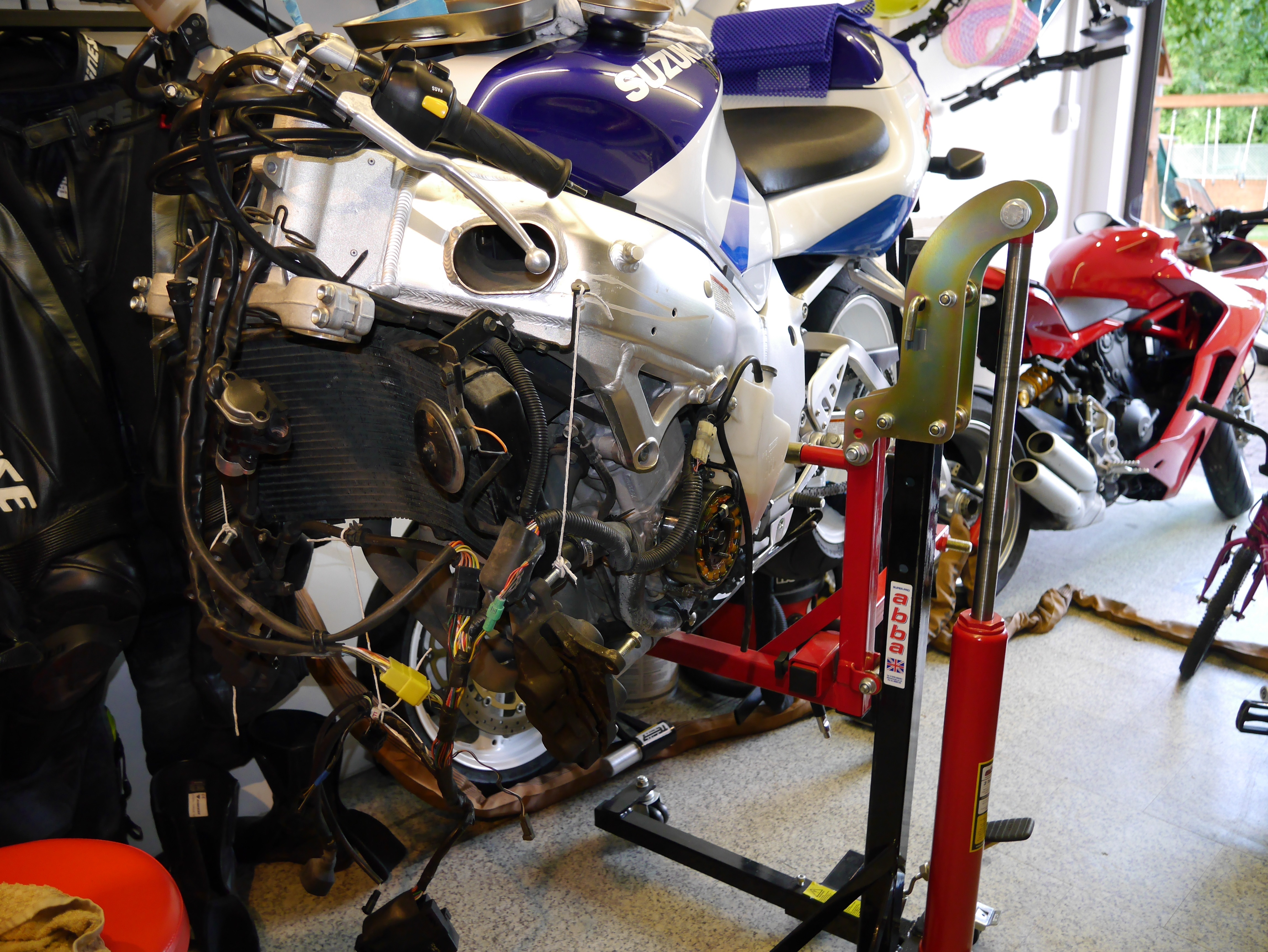

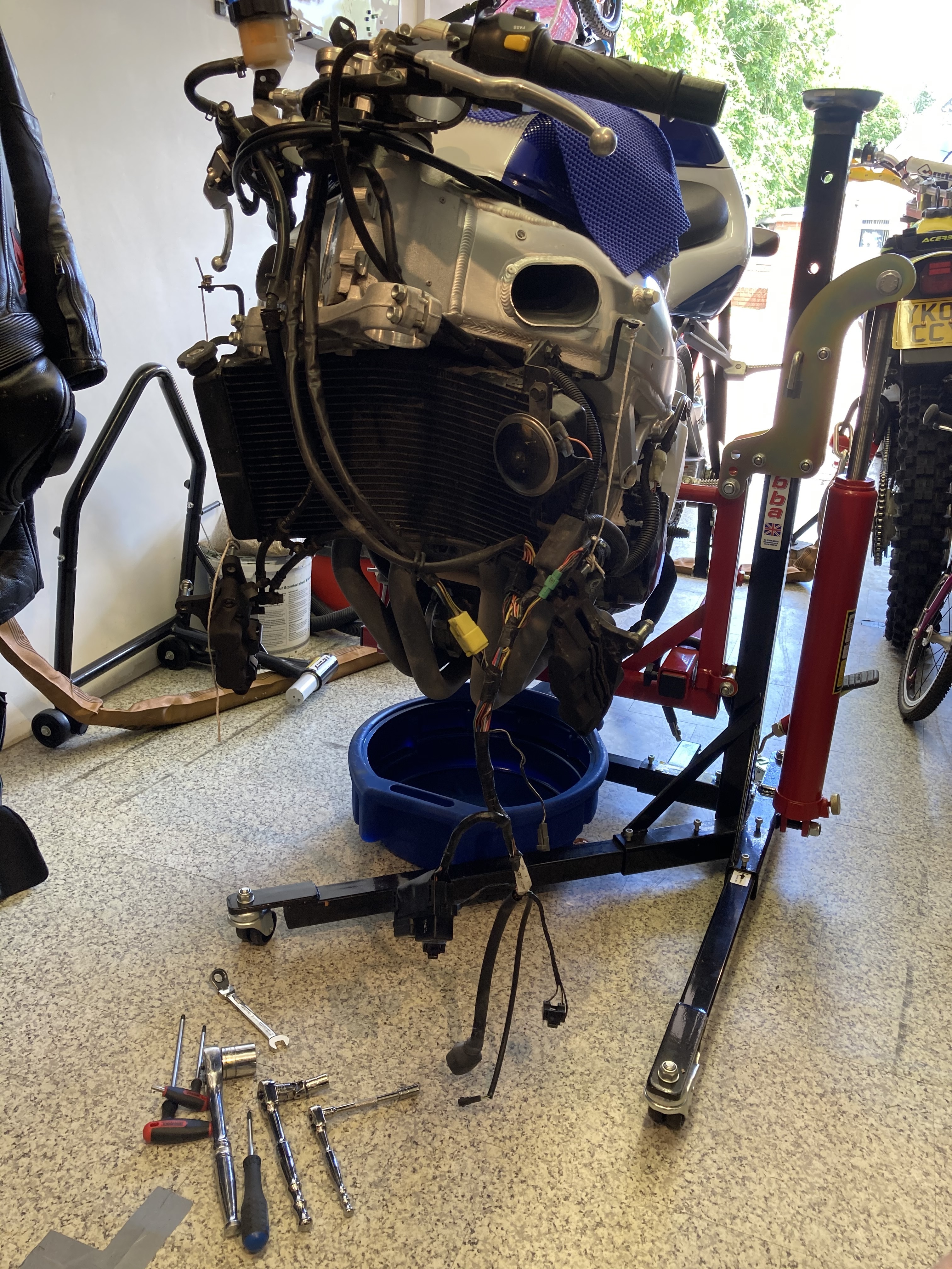

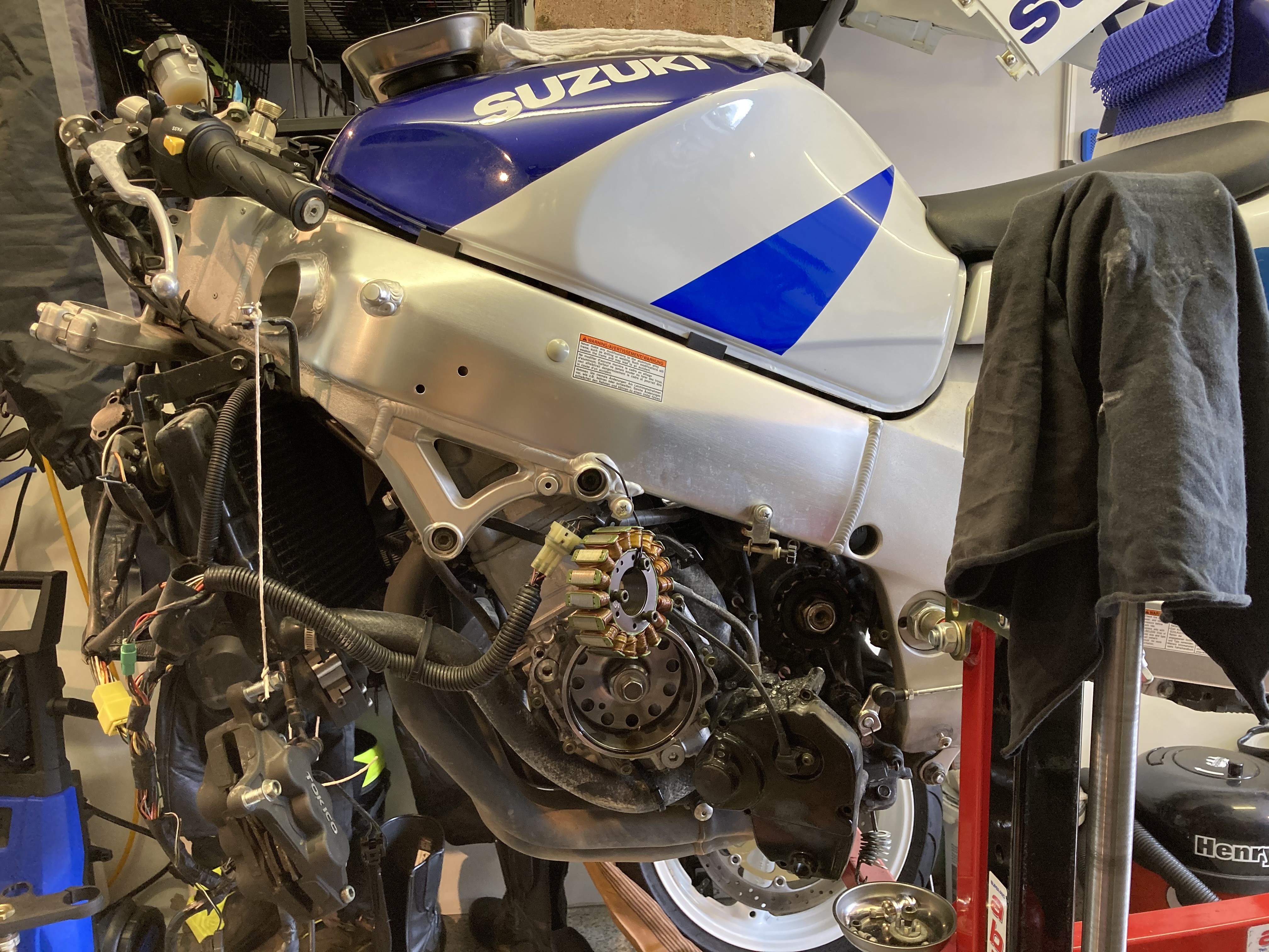

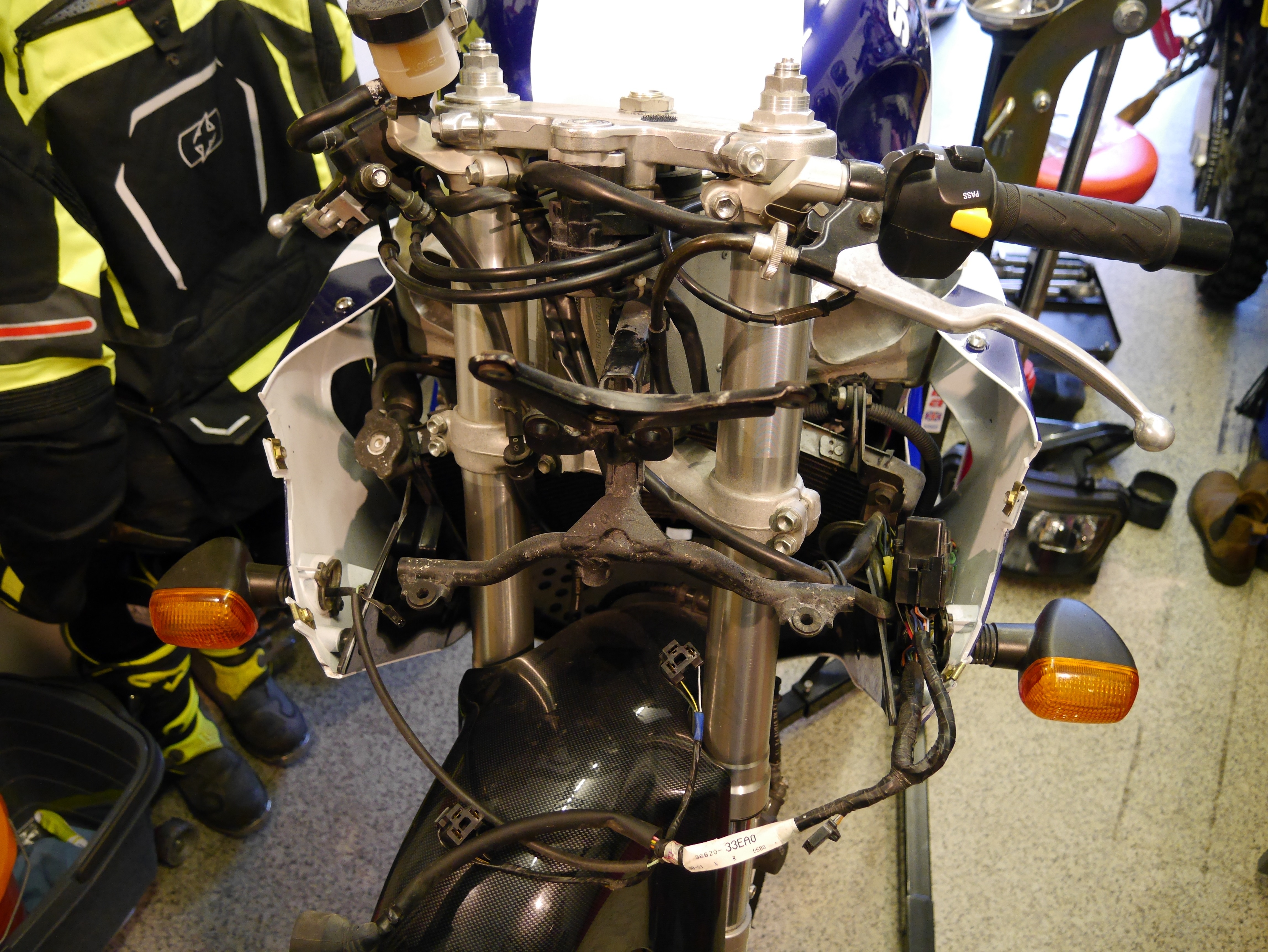

    After the soda blasting it was time to strip the bike of all the parts to be Cerakoted.
    Head fairing, headlight, clocks removed to get to the fairing support bracket which had started to flake.
    Side panels, forks, wheel and mudguard off, top yoke still in position. I ran it up to temperature like this to thin the oil prior to draining it, prior to removing the engine cases.
    Engine cases pulled as was the top yoke. I gathered all the parts to be Cerakoted together and stripped the fuel filler down to every last piece...and then lost the 2mm ball bearing that locates the little key flap... Thank goodness for eBay.

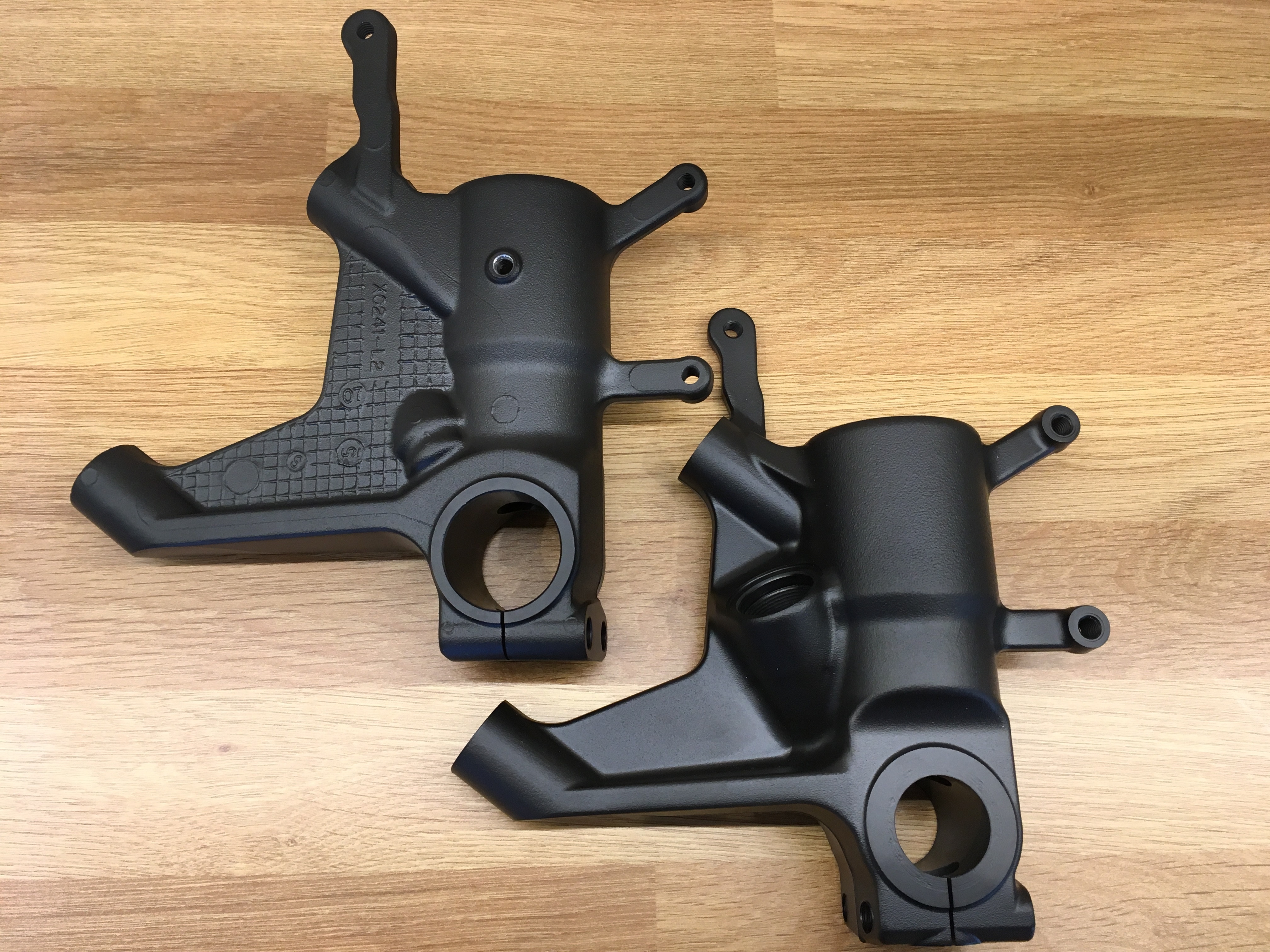

    I only really take pictures as a reminder to me, I have already re-fitted the yoke and engine cases but have taken some pictures of a couple of finished cerakoted parts before and after so you can see the detail of the finish. I love this stuff, it's as hard wearing as powder coat but doesn't have a podgy finish and doesn't blow. It will chip but it chips like paint and the edges of the chip will stay stuck firmly to the base metal. I like it because you can use it on parts with very fine tolerances and it won't muck up the fitment because it adds just microns to the surface thickness. It's also a thermal heat barrier and is oil and chemical resistant. What you need to bear in mind is that because it's such a thin finish, it won't hide ANY surface imperfections. If you notice less weld spatter on the side stand, that's only because I ground it off prior to coating. NB; The fork bottoms above have also been Cerakoted. Anyway, pics;
    **IGNORE THESE LAST TWO PICTURES, THEY ARE REPEATED FROM ABOVE BUT I CANNOT DELETE THEM**

    If you look carefully you can see some very faint pock marks on the black piece. Both inner and outer parts have been coated. I should have corrected the pock marks with wet and dry, but it is very minor. I mention it purely to reiterate, this stuff is superb but it hides NOTHING!!

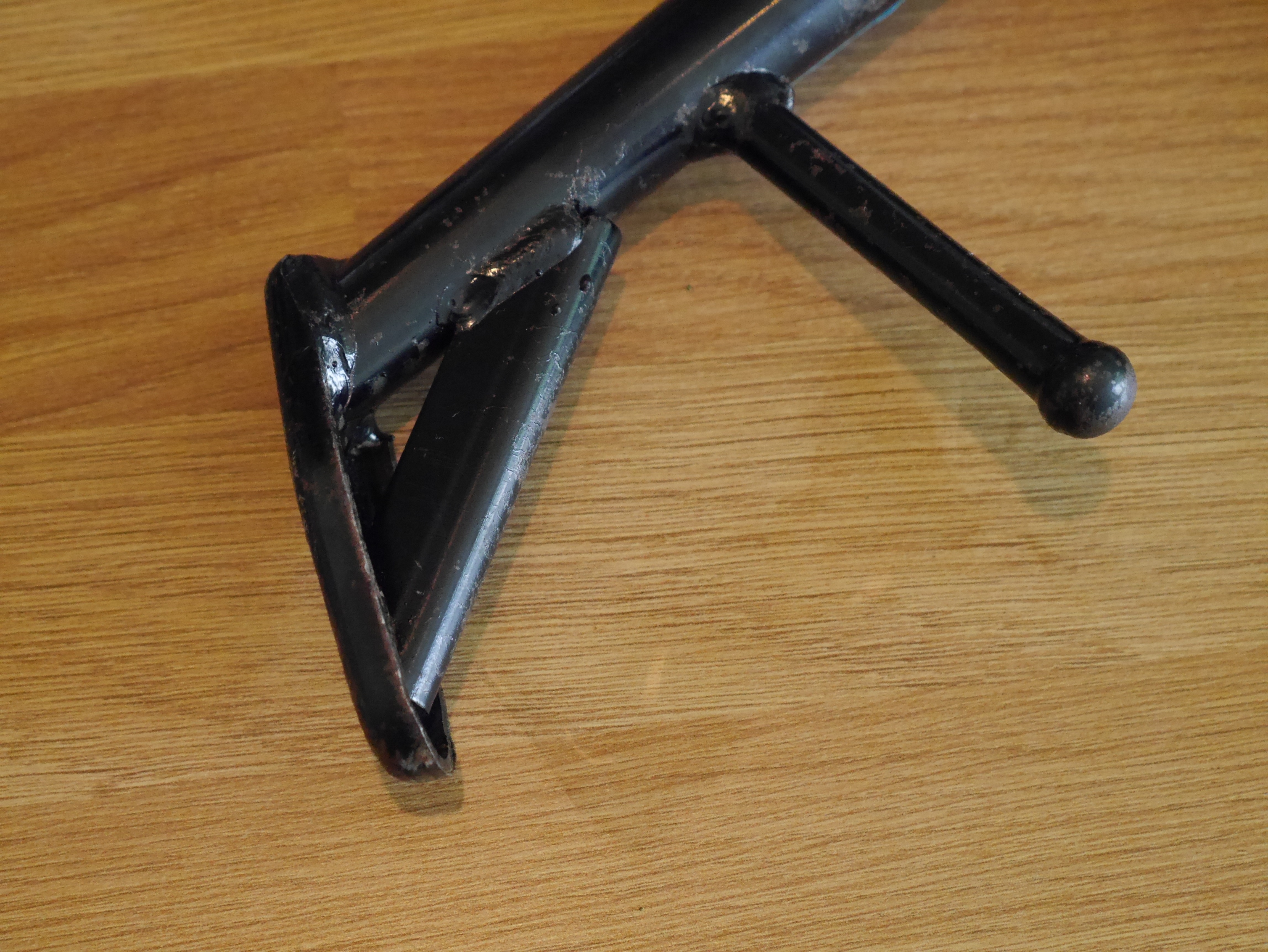

    Some side stand before and afters;
    I went for matt finishes instead of gloss, mainly as I forgot to ask for satin...which is what the fork bottoms are further up in this thread. Regardless, they look fine but it's no big deal to have them done again in the future if I decide to when I give the bike the full plan A.

    I couldn't really do much with the bike while waiting for the return of the Cerakoted parts. This was mainly because the engine was not sealed and the bike was still caked in soda from the blasting process. What I did do though was cleaned up all the gasket faces and thoroughly degreased them ready for new gaskets and a sniff of ultra grey sealant.
    Once I had the Cerakoted parts back I refitted the engine cases, top yoke and forks to seal the engine and get it back on it's wheels so I could deal with the soda blasting. The more I took off the bike the more I realised that soda gets everywhere and the more the it looked like El Chapo had used it for his Deliveroo service;
    Henry hoover did his best;

    With the old tank off and the pump stripped off it I eBayed it and sent it to Holland for £60 plus postage. I was happy with that as it was very honestly described and had been poorly lined prior to being sold to me. I had already brought a brand new tank for it when I first bought the bike. That cost me £480 which is much better than the £900 they are now. o_O
    Now on it's wheels and with the engine sealed I was able to give it a wash to rid it of the last of the soda and make it a bit nicer to work on. Then there was a couple of hours cleaning 22 years of chain lube based cack from the primary drive area;
