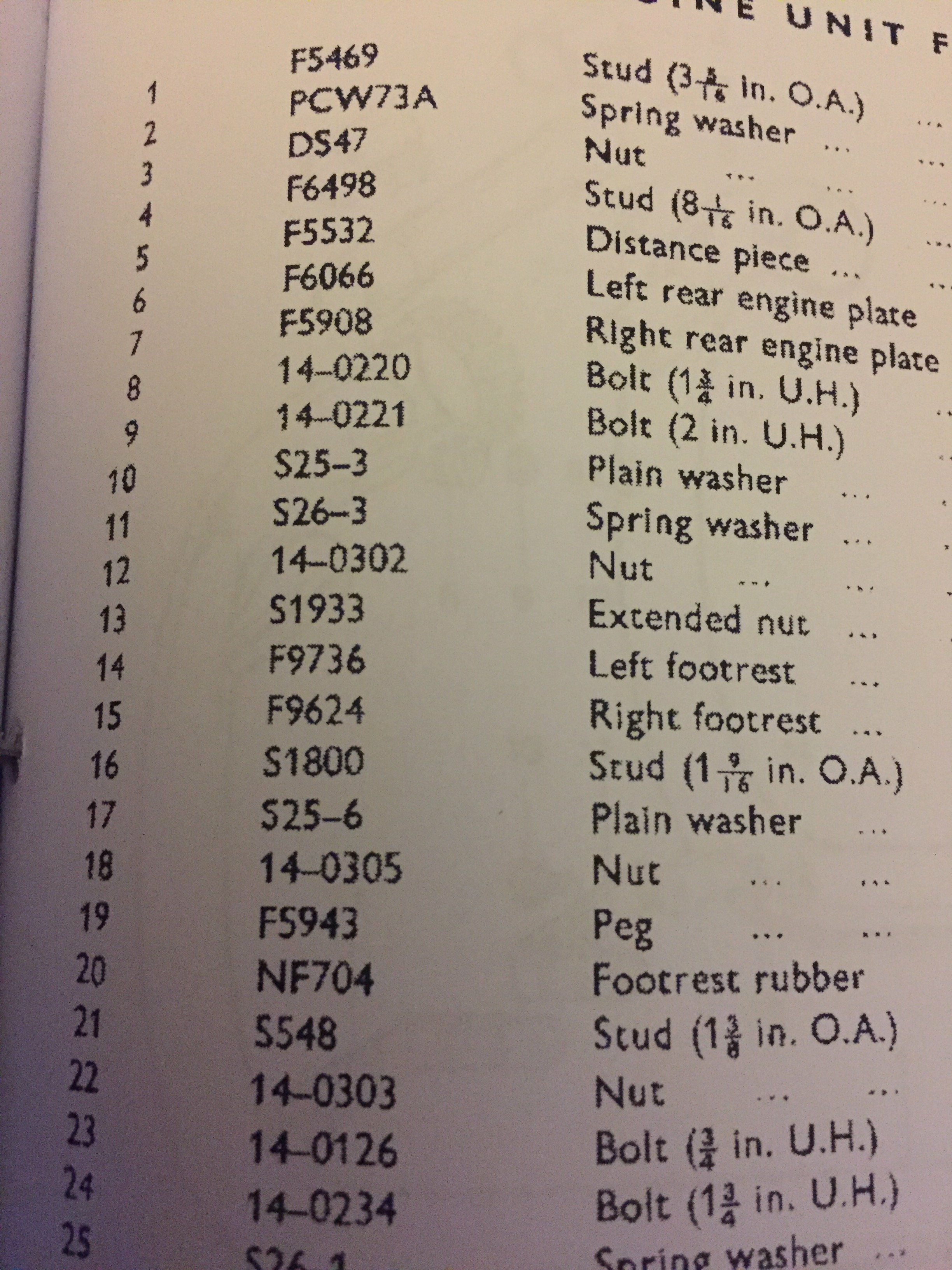

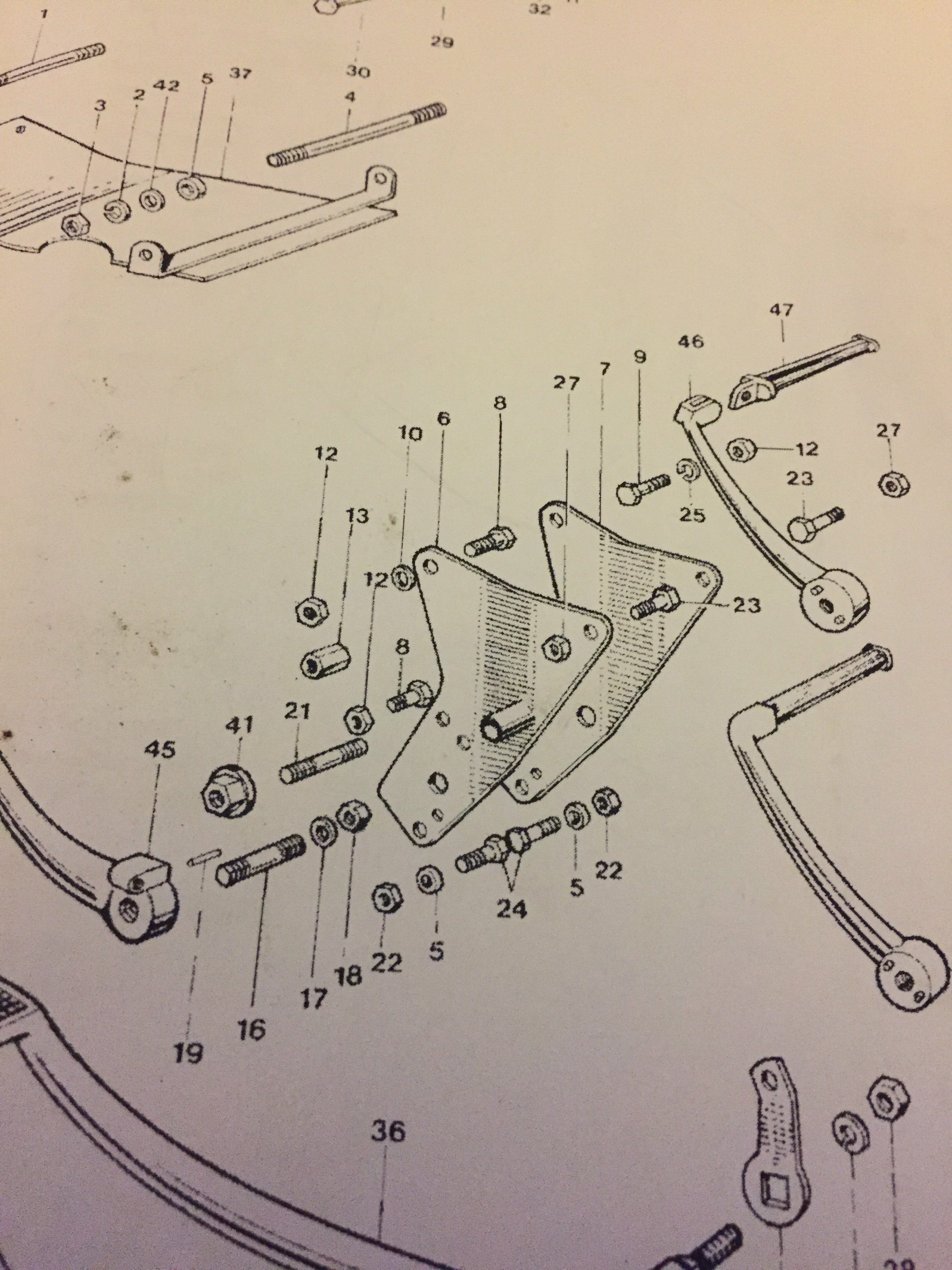

    Had a chat with some mates and it's probably a case of 68 on could still be using some in stock standard flat nuts as i still have flat nuts on my 69 engine mounts and cases that i had forgotten about until our chat but my 70 has the Cleveloc so even i am a bit confused now, conclusion is that a mixture of nuts and bolts got used up in what should have been a change from Whitworth to UNF/UNC in 68 dragged on into 69 and 70.

    Ahh ok , Thats probably it , so In my case I could probably use either without it being too much of a crime . I think I may switch some around to clevelocs and plain washers , nothings been fully tightened as yet . My parts book is the 69 american version .

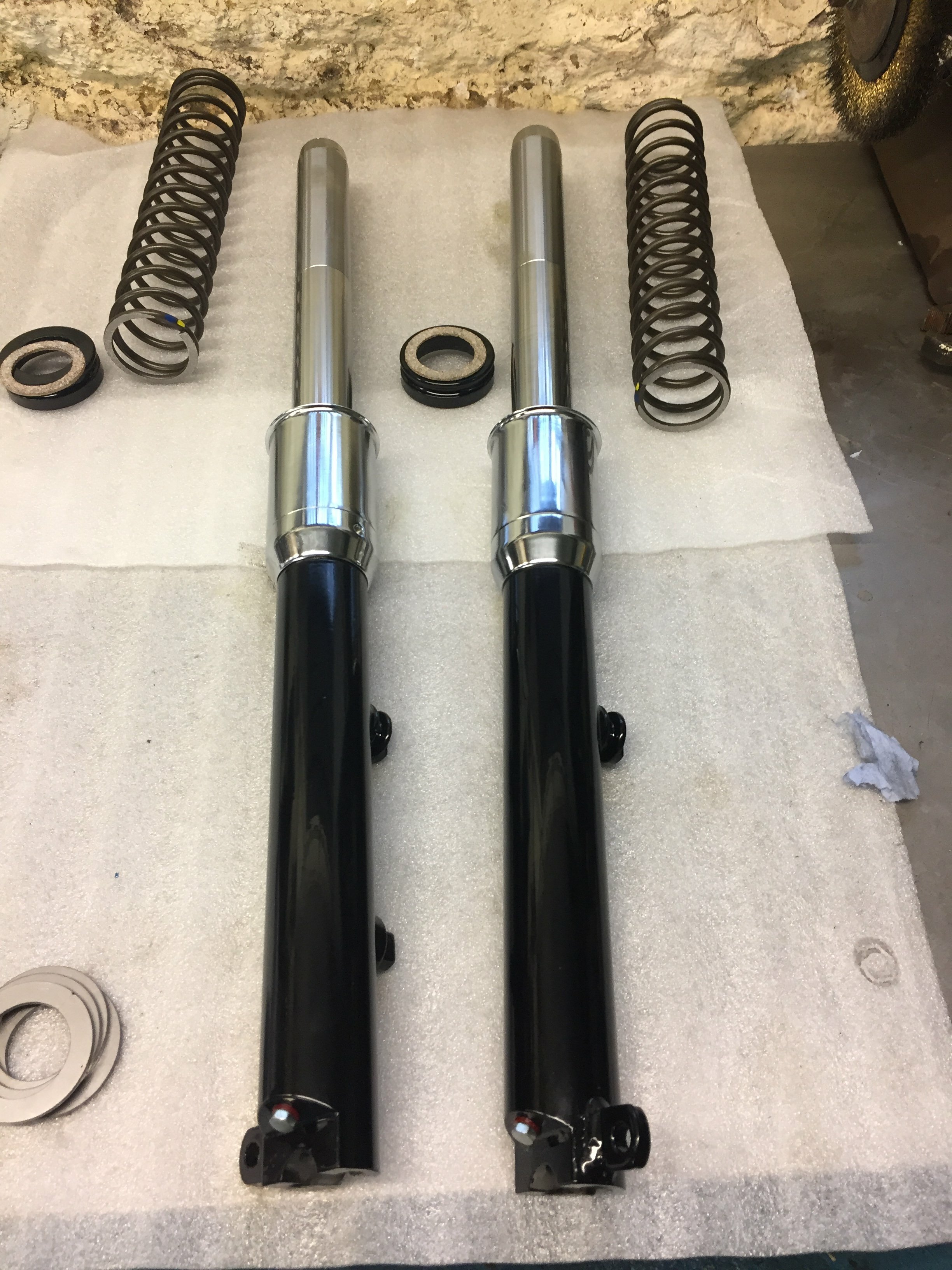

    Fitted the sliders to the stanrions yesterday just need to draw them into the yokes . I ended up taking a mm off the top bronze bush sholder and using 1mm washer as at first when I screwed the dustcovers on it left unsightly threads showing , but now its all good . Also the plastic damper sleeves were too tight so wet and dried them to give a good fit otherwise they would have to have been forced in . Thats repro parts all over jn my experience .
    Is the practis to pull the forks into the yokes so the stantion is mear the top of the yoke , then tighten the pinch bolt remove puller and fit nut , loosenpinch bolt then fully tighten top nut then re tighten pinch bolt ? Should there ne a washer o ring under this chrome top nut as i dont have any ? Thanks in advance .
  5. darkman
    7,661
    Good idea to tighten top nut/bolt then pinch bolt :) No washer but you can use PTFE tape on threads or a sealer.

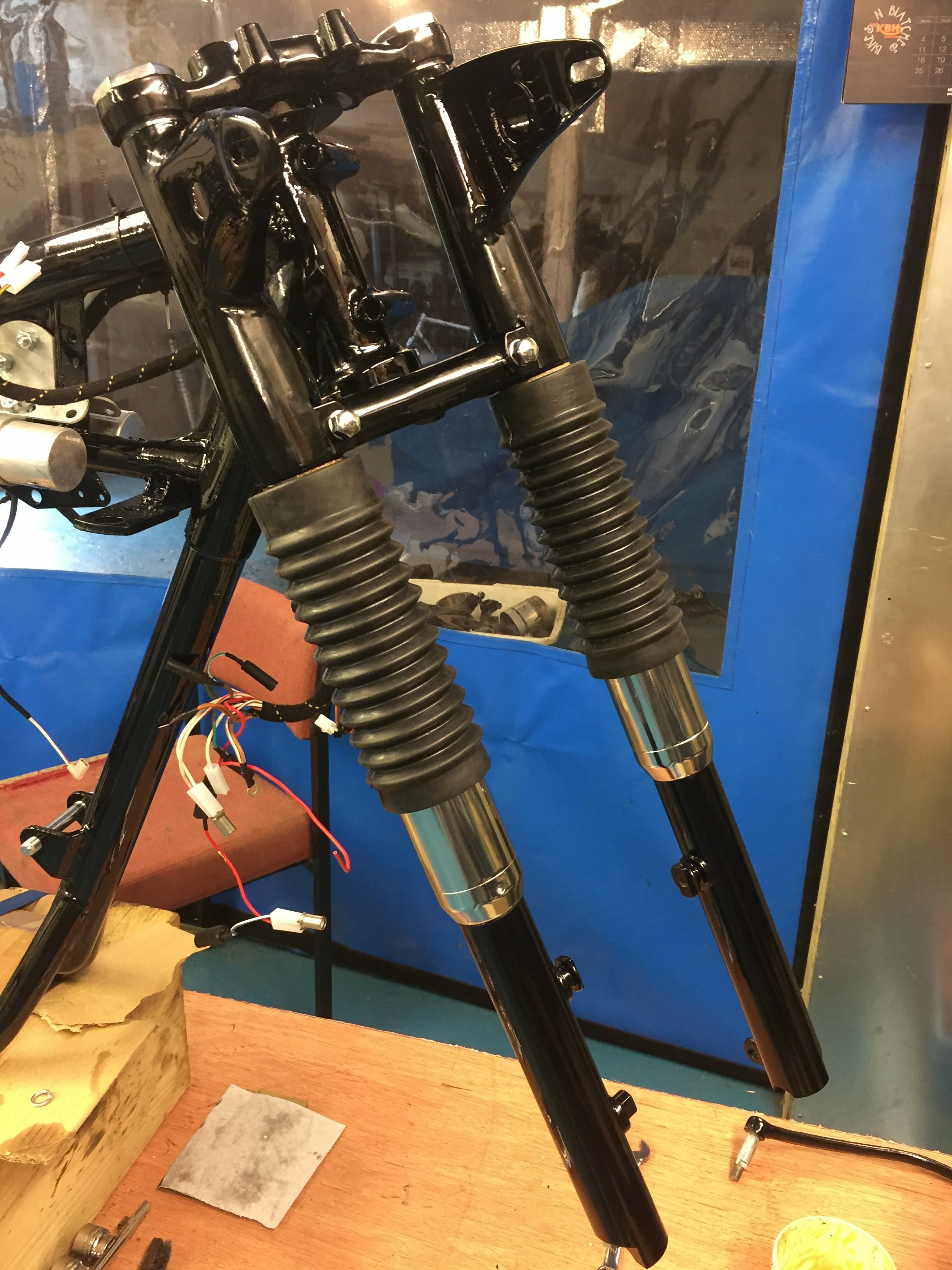

    After building up the forks I fitted them , was expecting more tension on the springs but not so much which was good as was worried my puller would mark the top yoke .

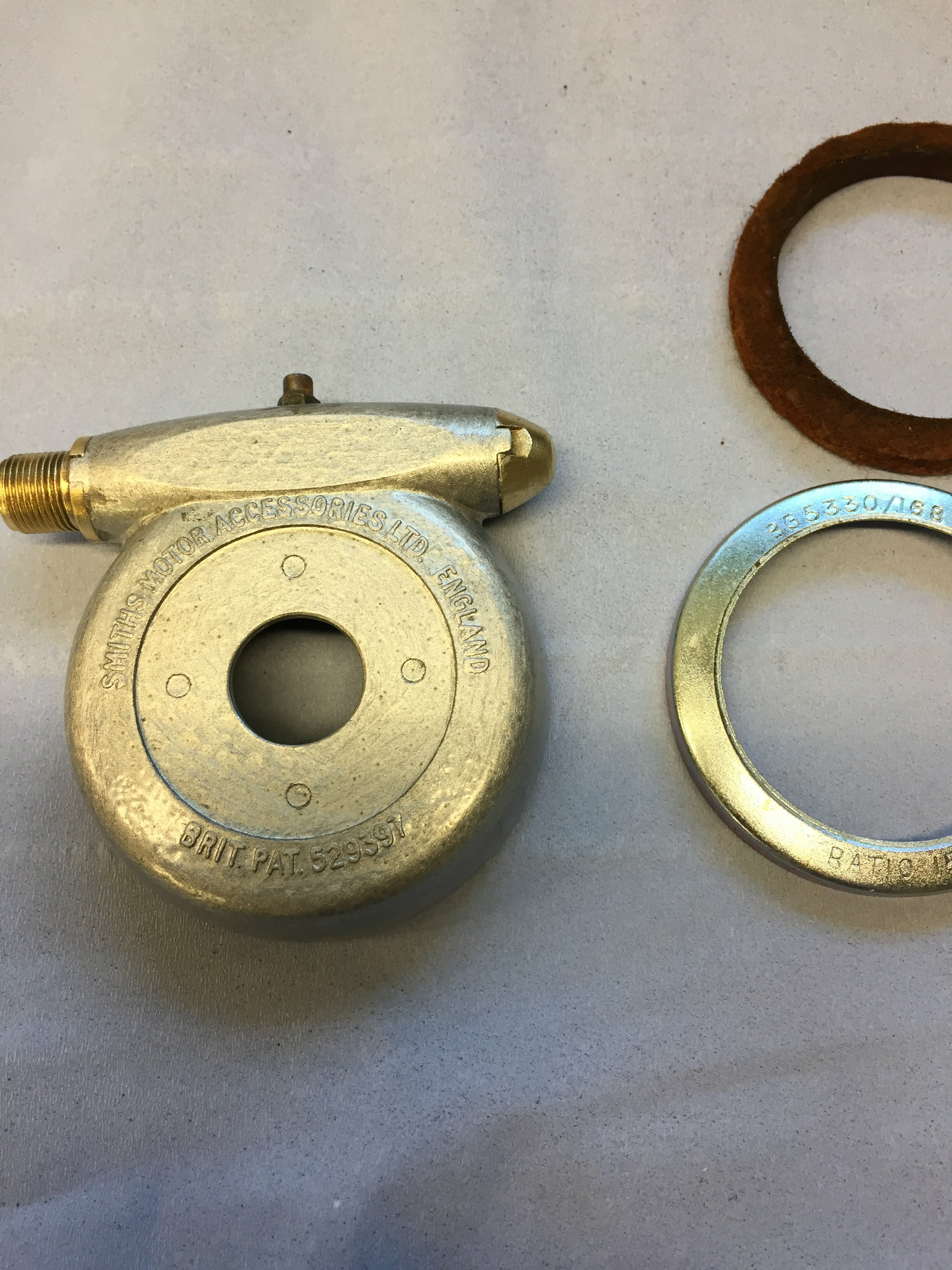

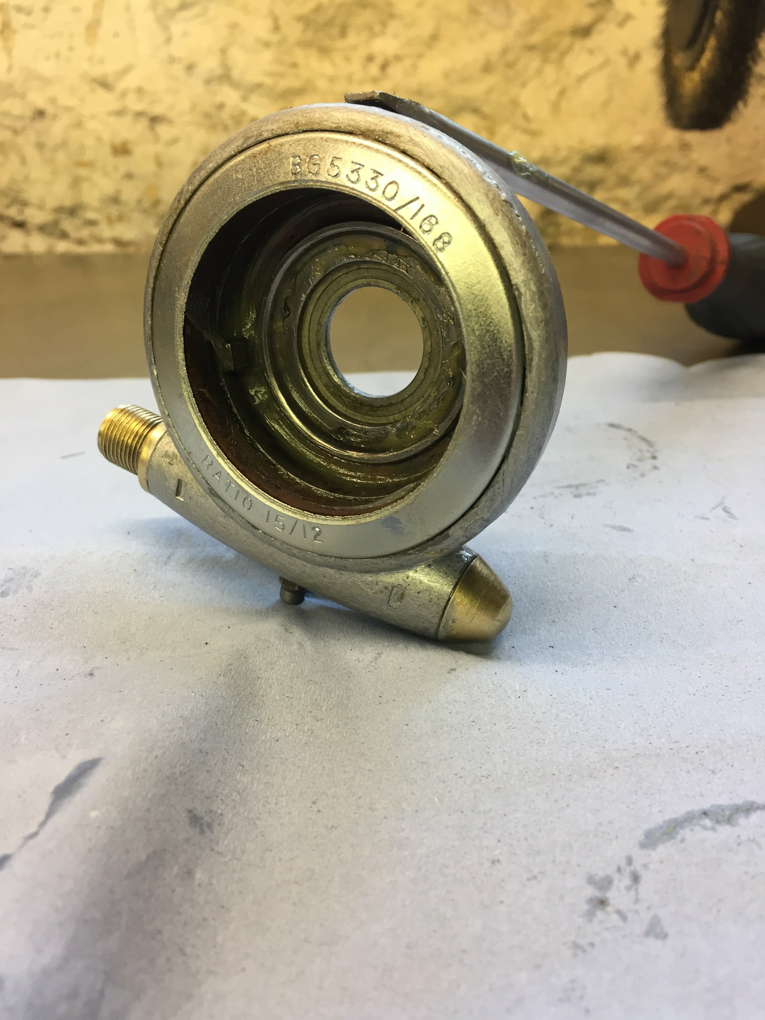

    The only thing on the bike today was refreshing the speedo drive , giving it a thorough degreasing and spruce up new paint and new grease.

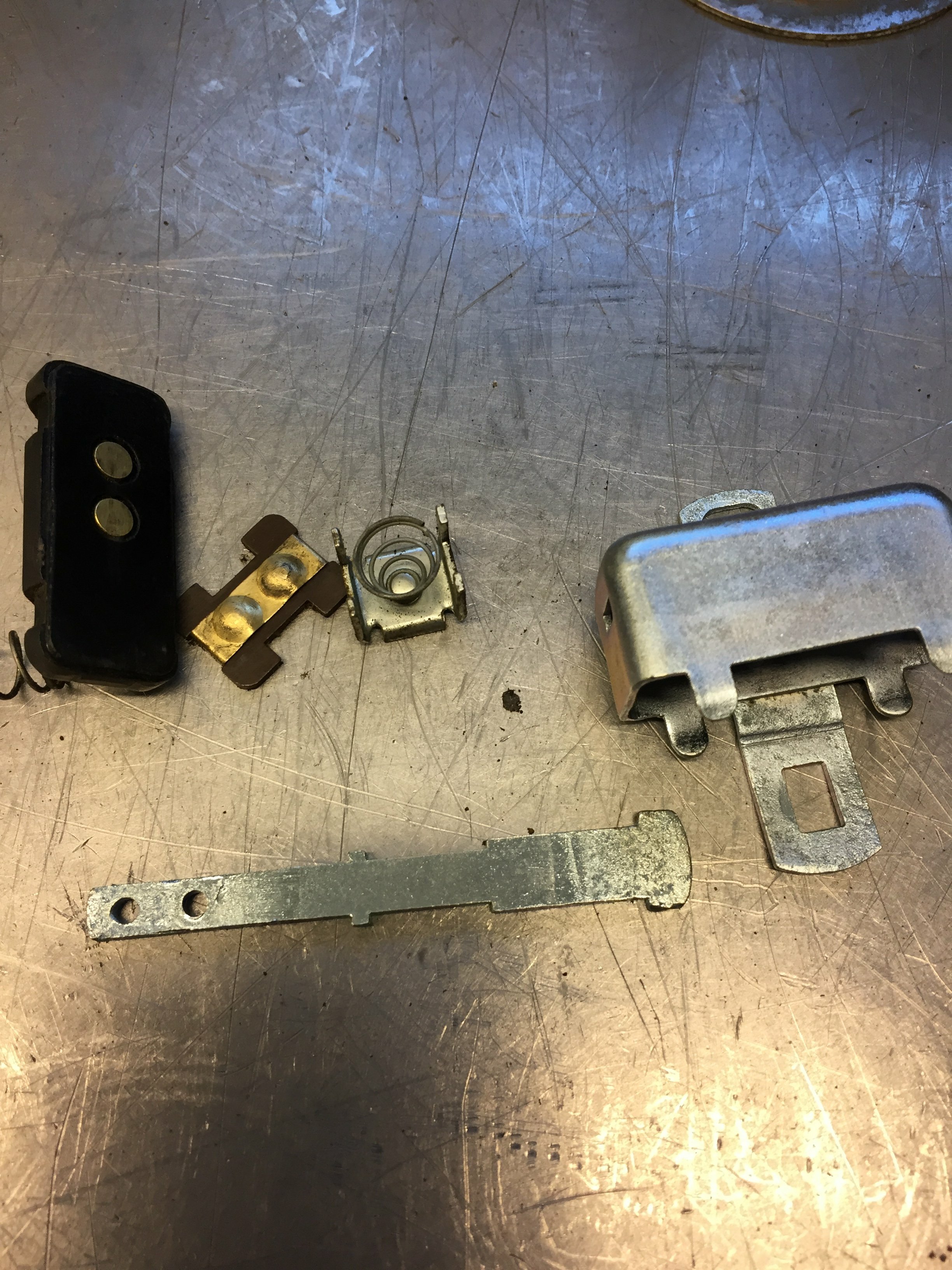

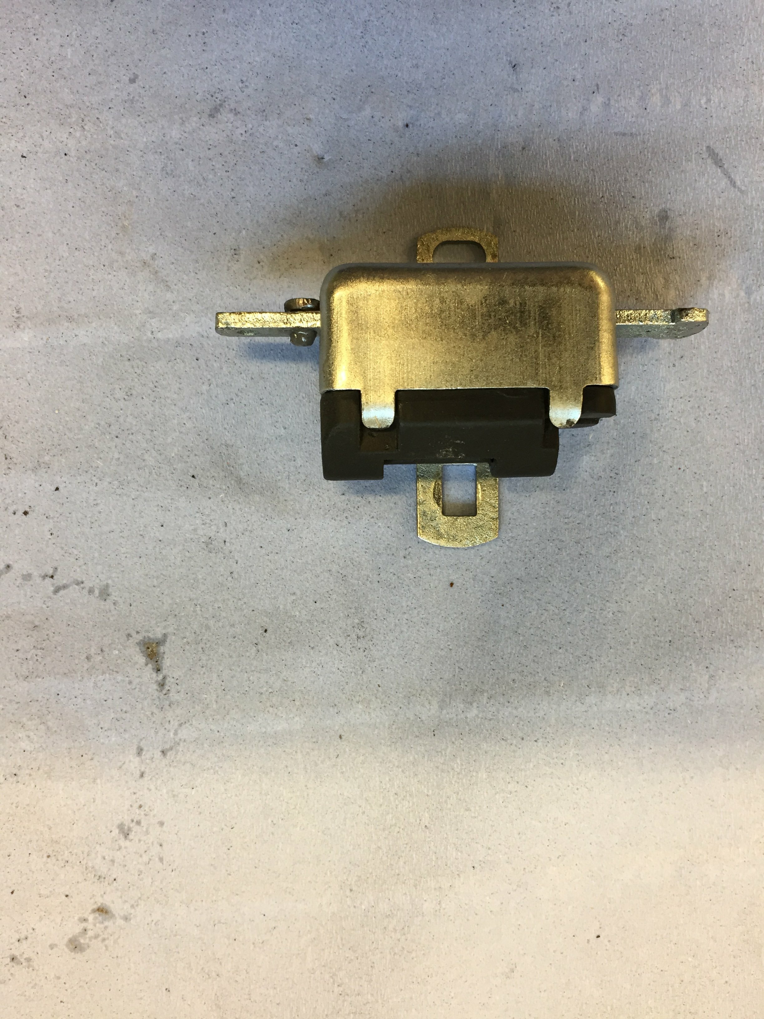

    Reassembled the brake light switch , just needs a coat of something black to finish .
  17. darkman
    7,661
    Don't forget one of these for the speedo drive :), i say dingdong do them. 2000x1500.JPG
  18. Tibster
    Tibster Well-Known Member
    Feb 10, 2019
    270
    Witney
    Thanks Darkman , I new you wouldnt miss that ;) yes need one of those stickers , the only one the Austrian shop didnt have !
