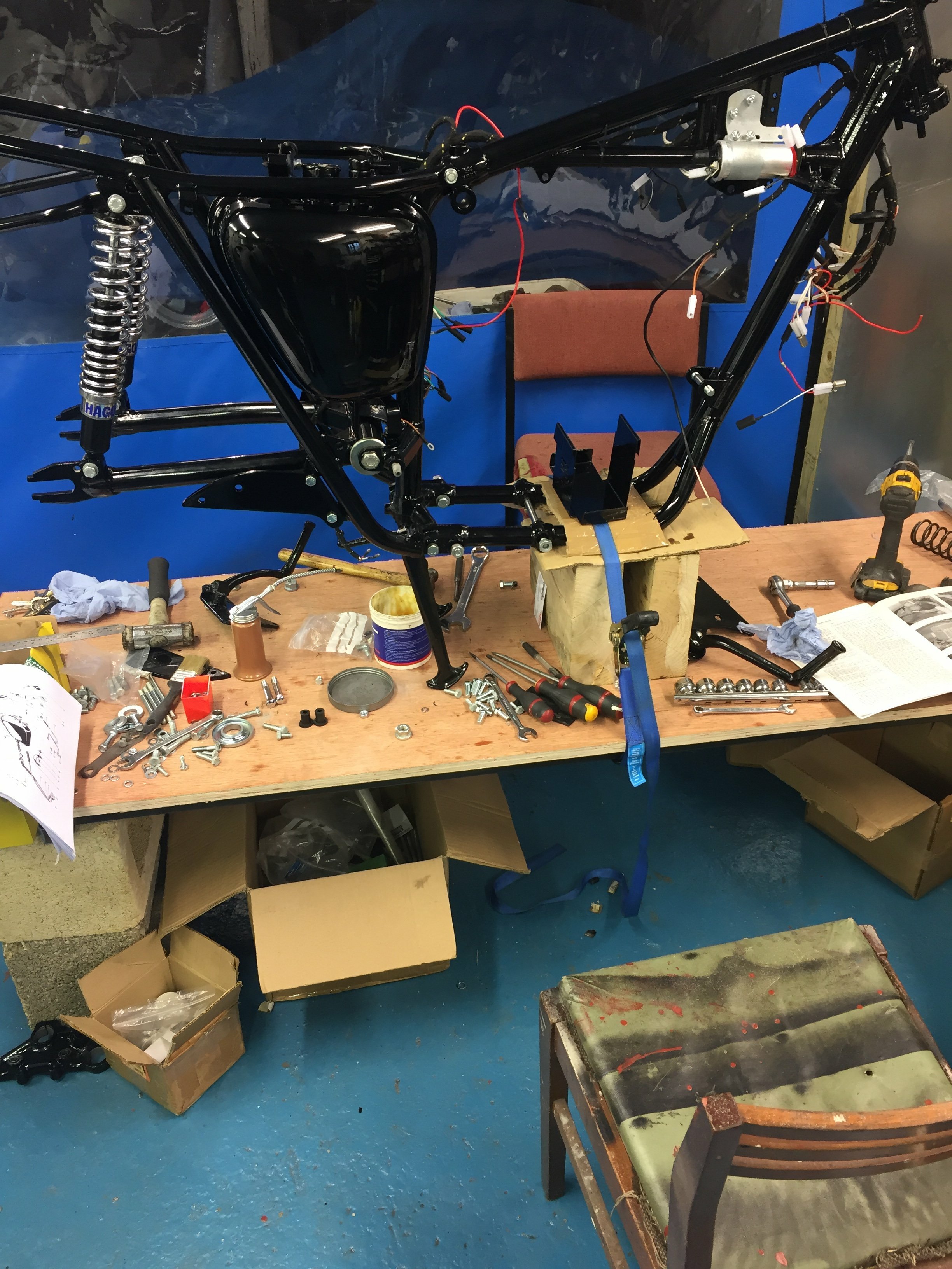

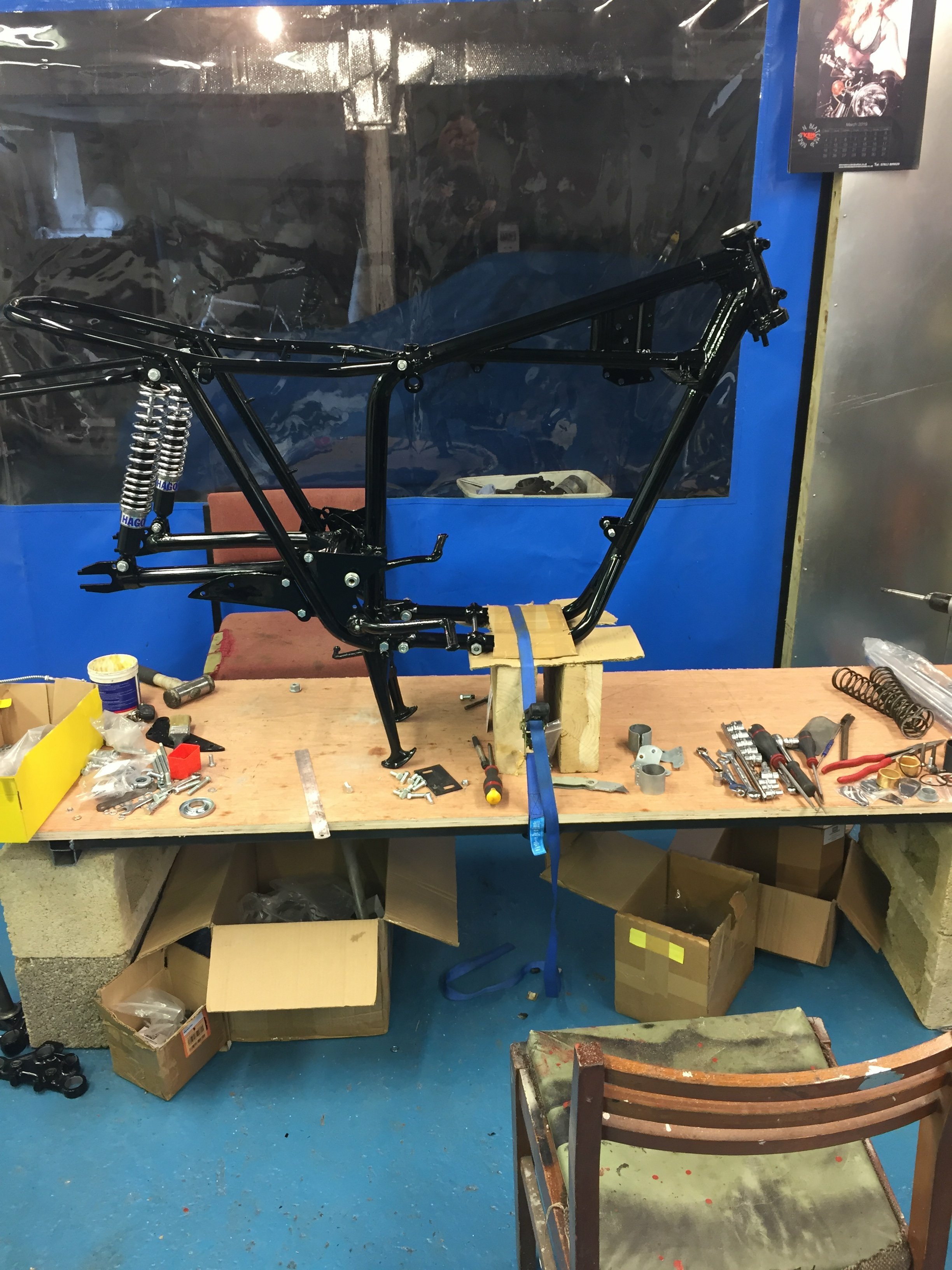

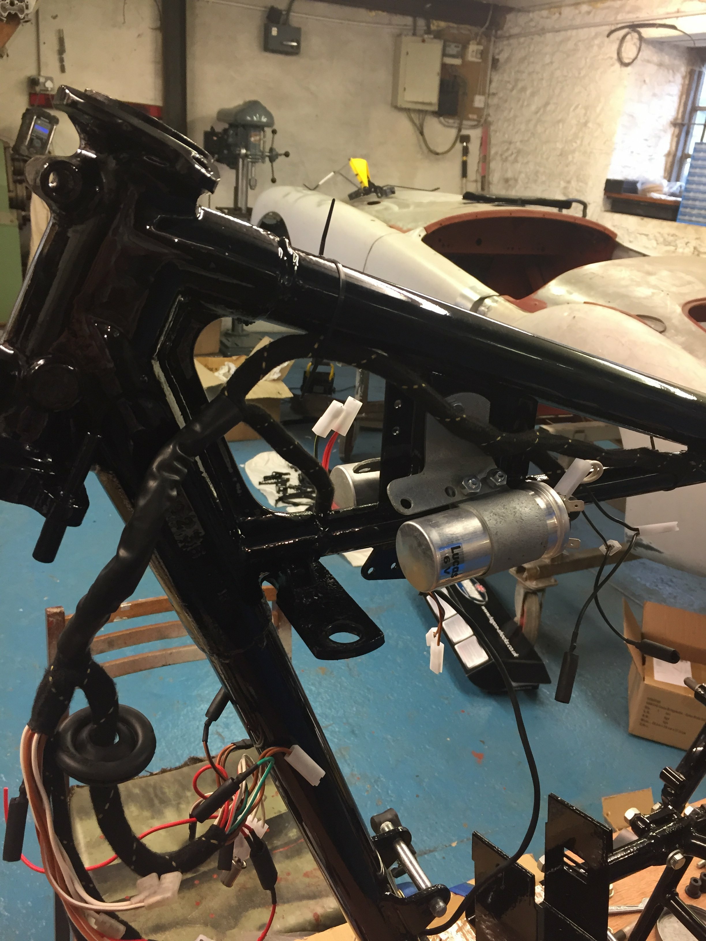

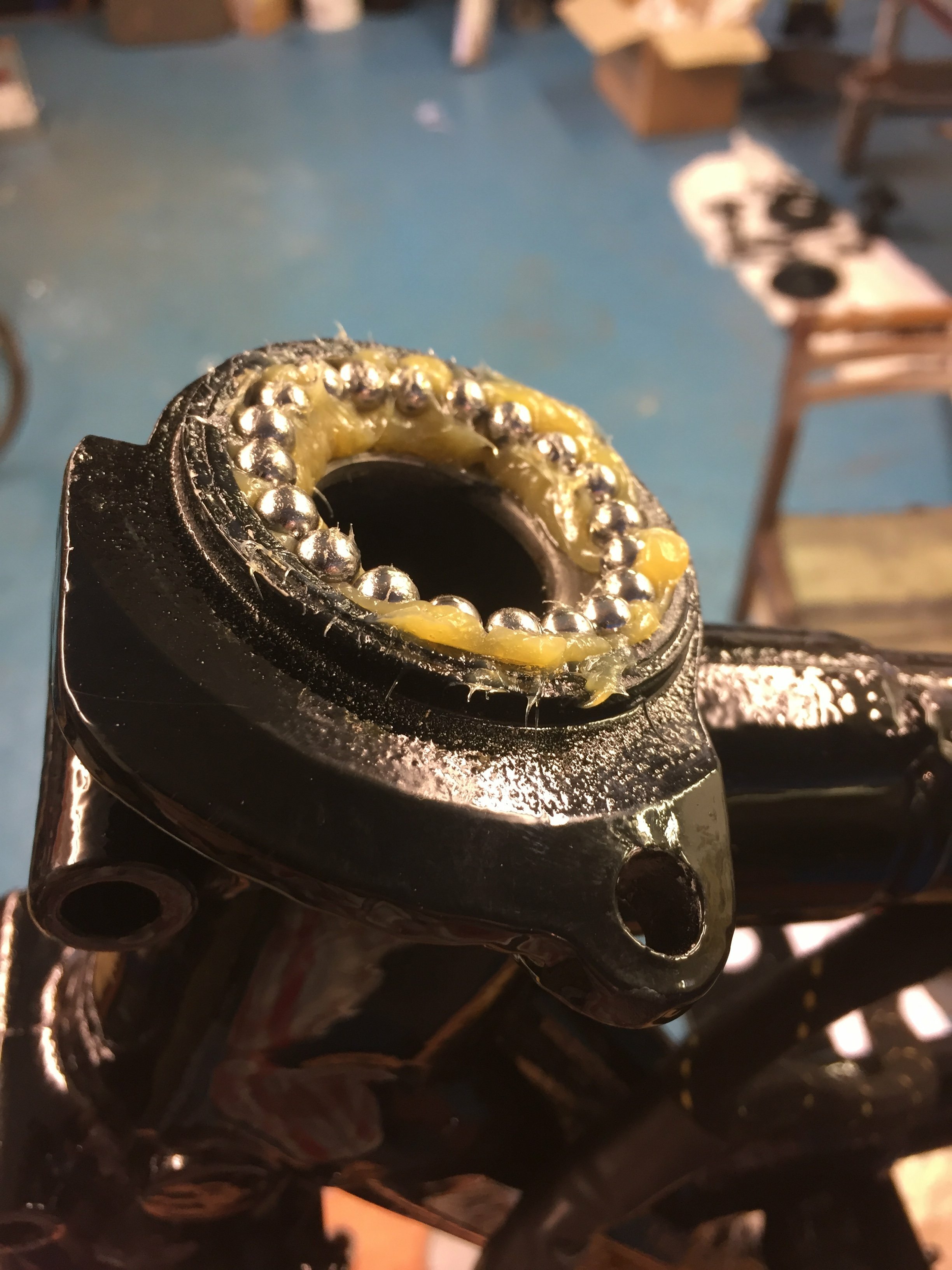

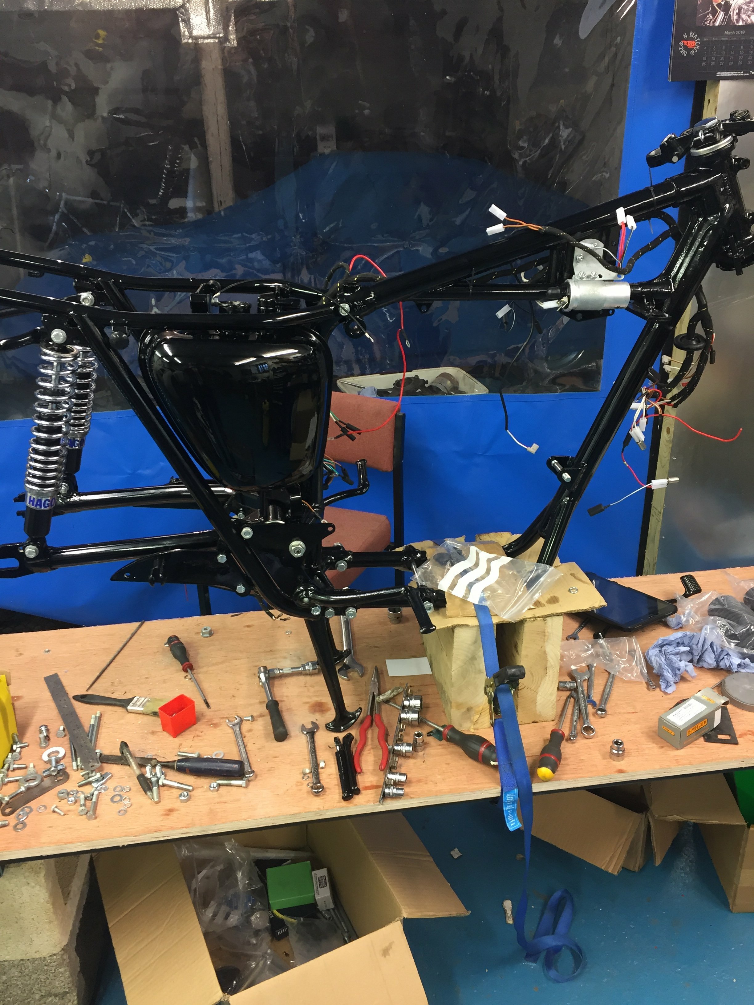

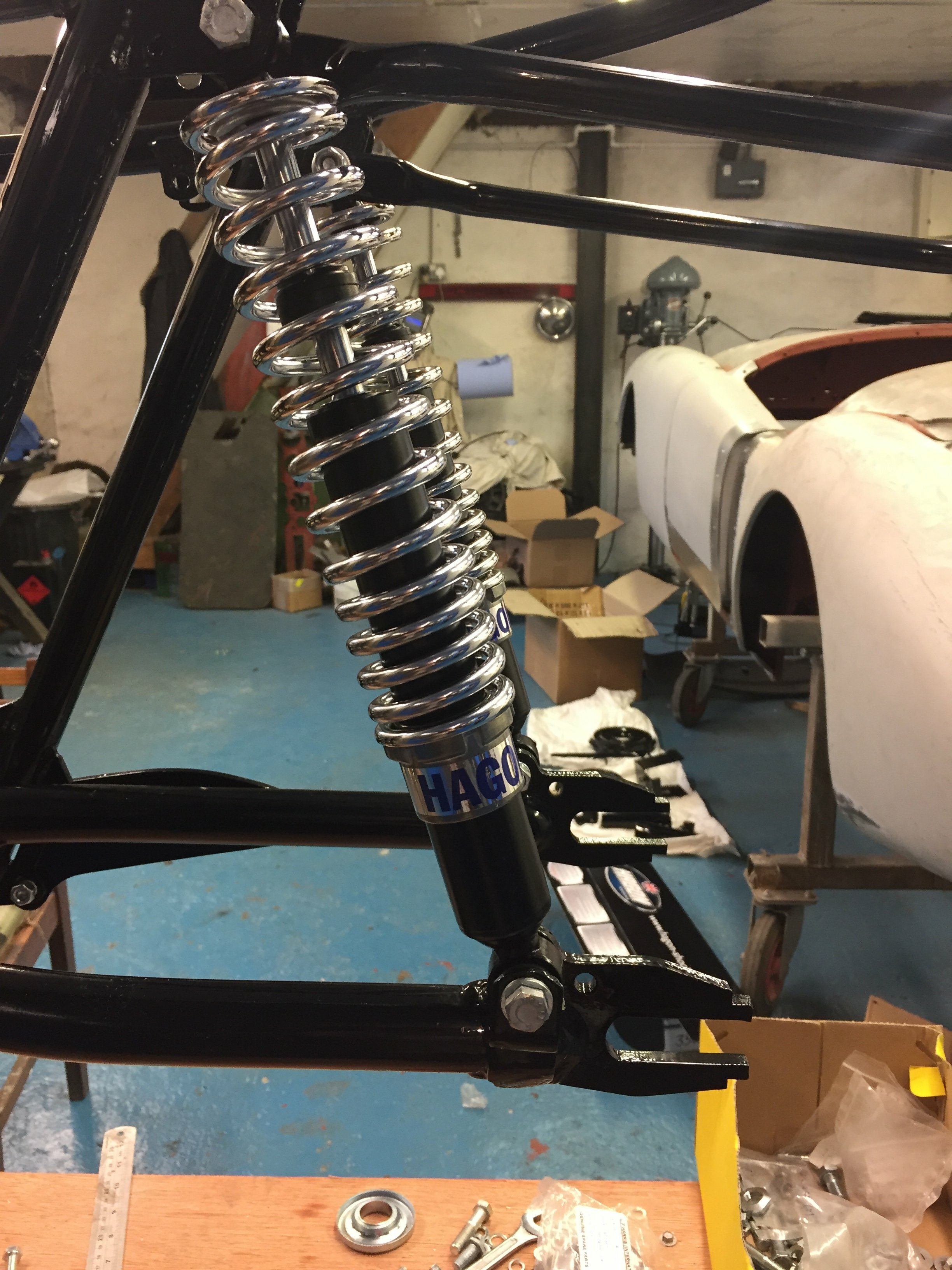

    Some progress
    Couldn't wait to get my new shocks on :)

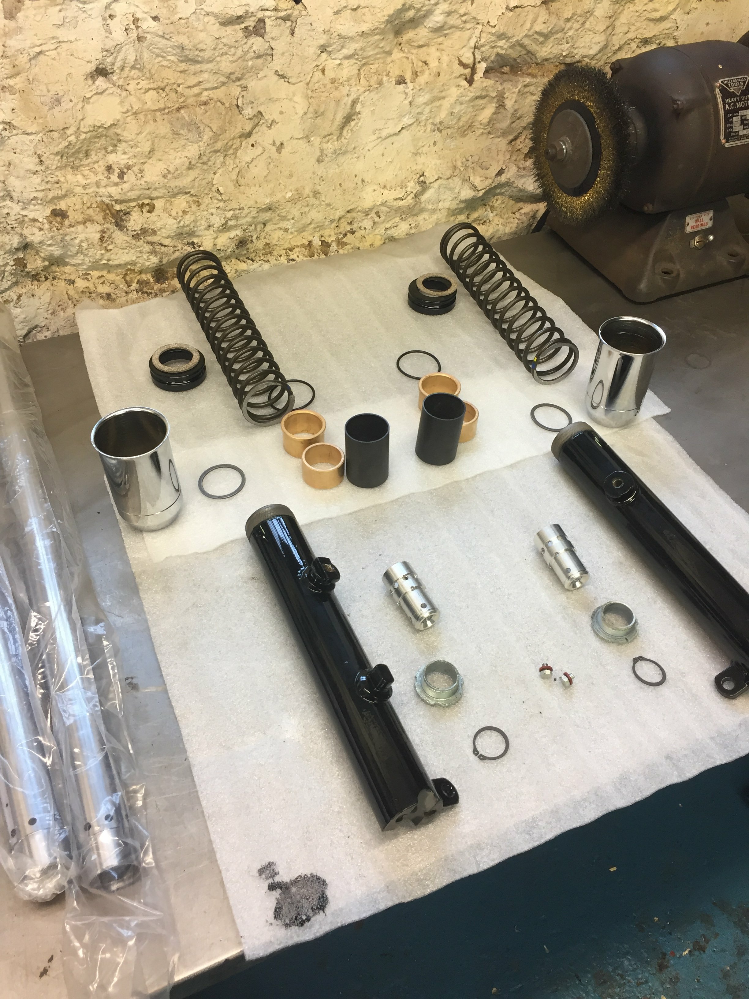

    Some new bearings
    Despite buying dearer Harris stantions , one needed deburring on the inside of the drillings as it was skagging on a shutle valve causing it to stick !
    The plastic damper sleeves seem quite tight and difficult to get in the slider is this normal ? do you just place over the top and push into slider and they find their own position ? This is now a job for tomorrow to sort .

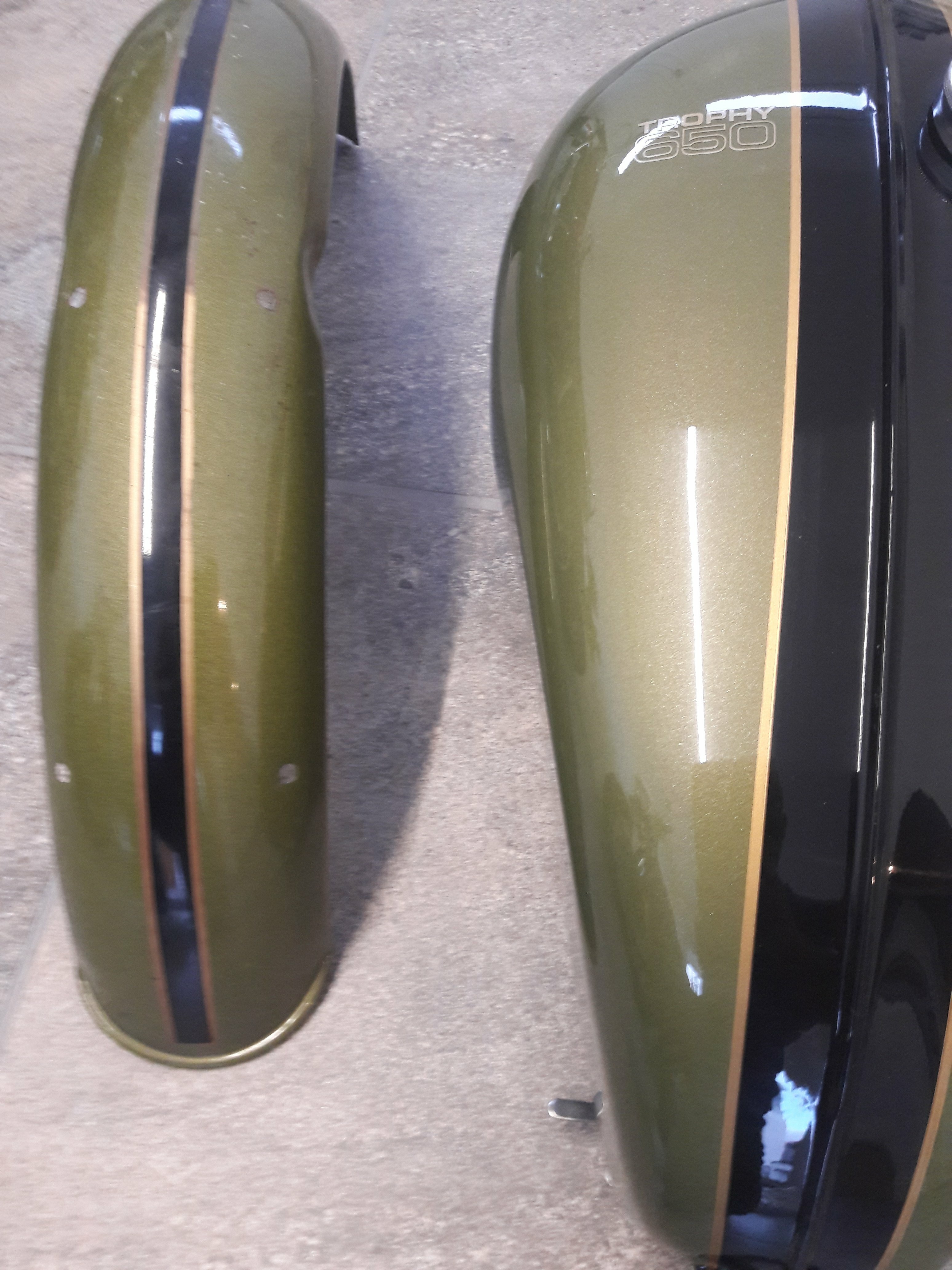

    Evening Tibster, black dampers just presses on to legs with the thick end at the bottom, mudguards are of the rolled edge type on 69 and have the recess for fork gaiters as in pic. 1970 4.jpg

    I do like the gold pin strping on those mudguards darkman , was gold ever used to on the bonneville maybe I could go gold instead of white :yum

    On shocks, all eng apart from the case halves and plate mount f/r, rear f/rest plates, fork clamp nuts in fact nearly every bolt will have a Cleveloc nut. Not top yoke nut n bolt as the nut is a convex nut. Gold, bronze, white, blue and black cover the unit line colours, white for 69 :) Have taken this op to post a pic of my bikes to try n keep you on the right IMG_1643.JPG path :joy::sob:
