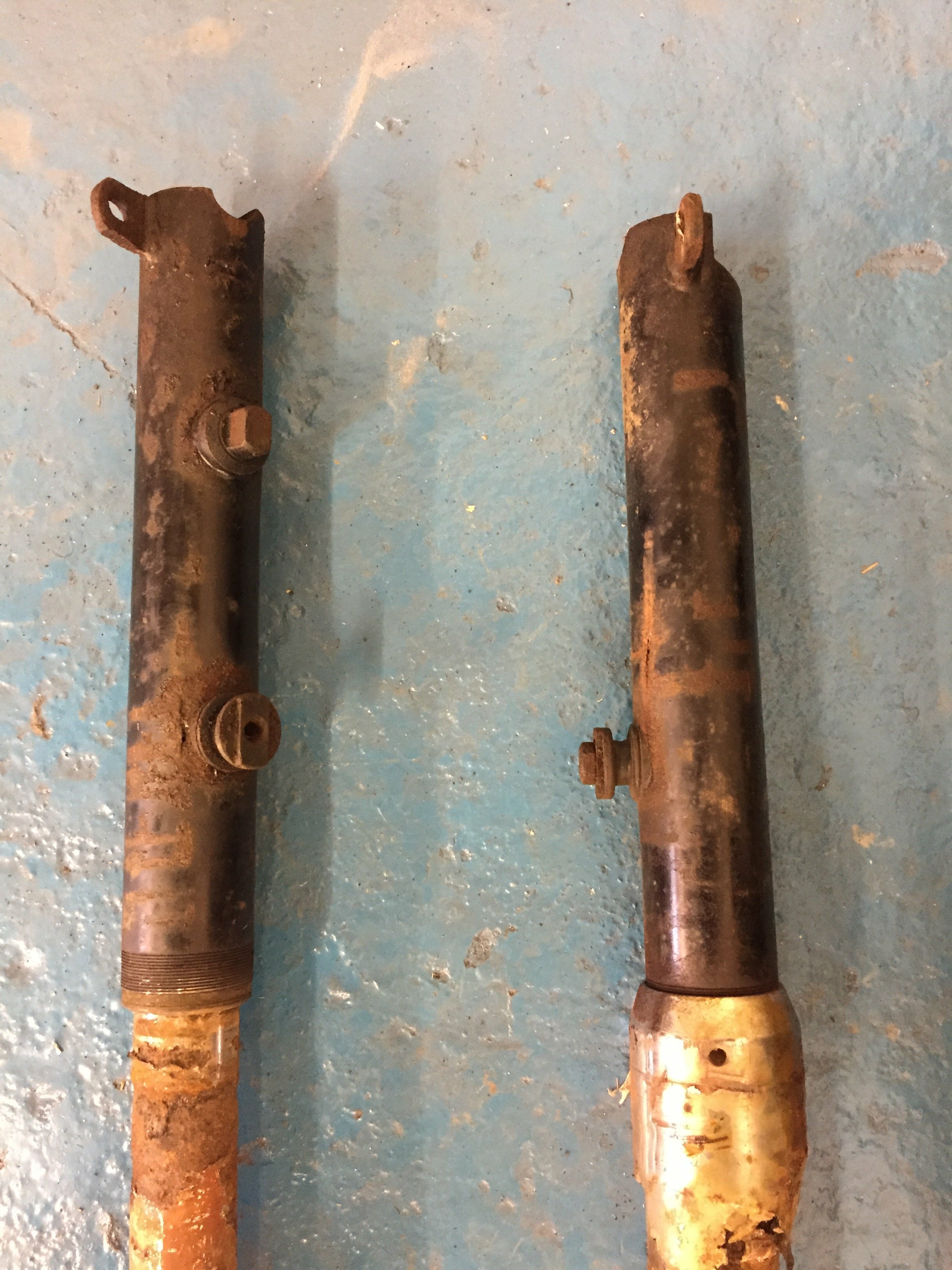

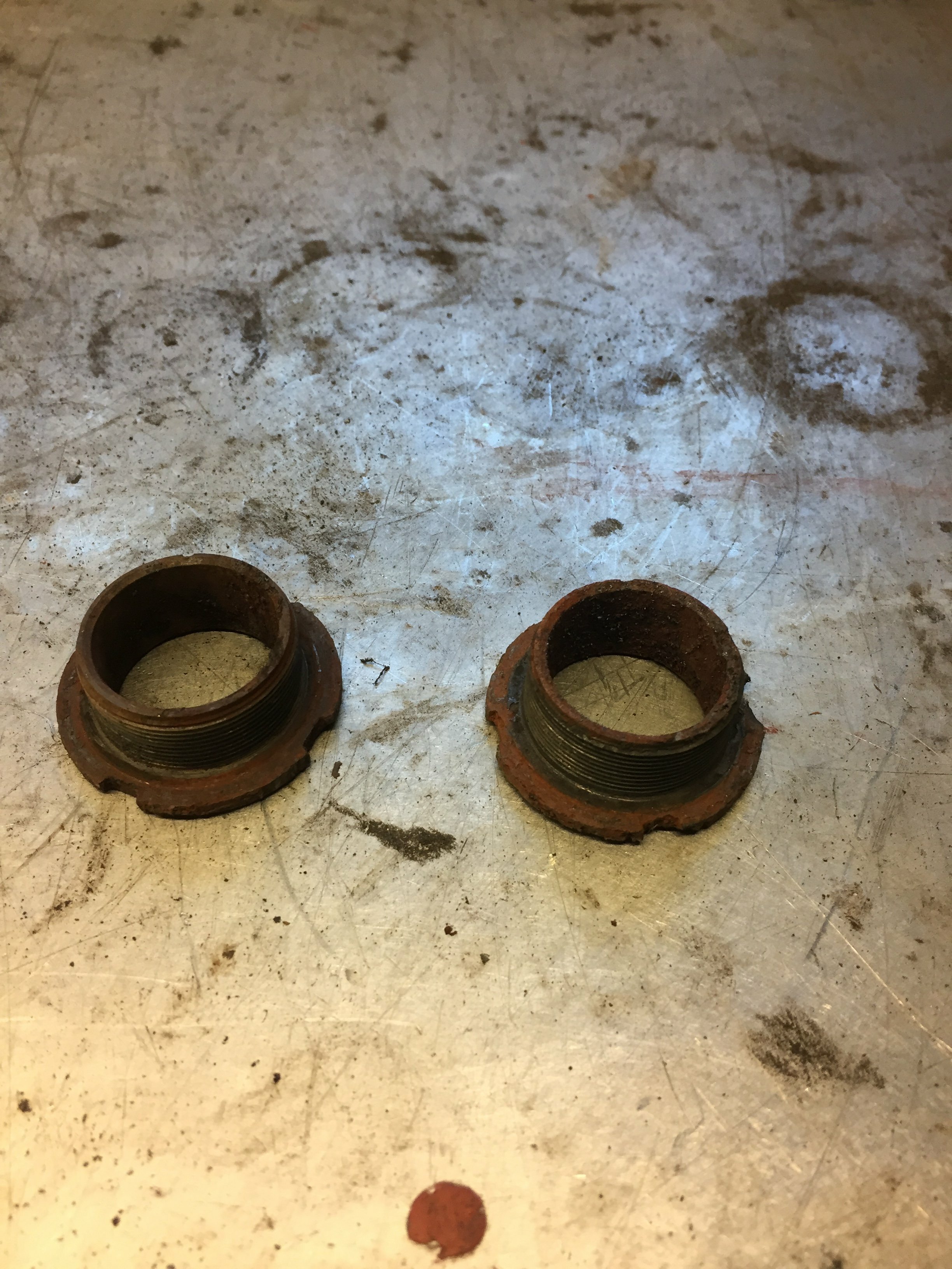

    These are my my old sliders , you can see the splits . I havent taken the stantions out yet as seized solid . Thinking is I could do with the nuts off the bottom stations and shuttle valves or are the valves aluminium and likely to be shot so better skipping them and just buying new rather than spend an age trying to get the blighters out.
  3. darkman
    7,659
    I would imaging as water has frozen and split the leg everything else is shot.

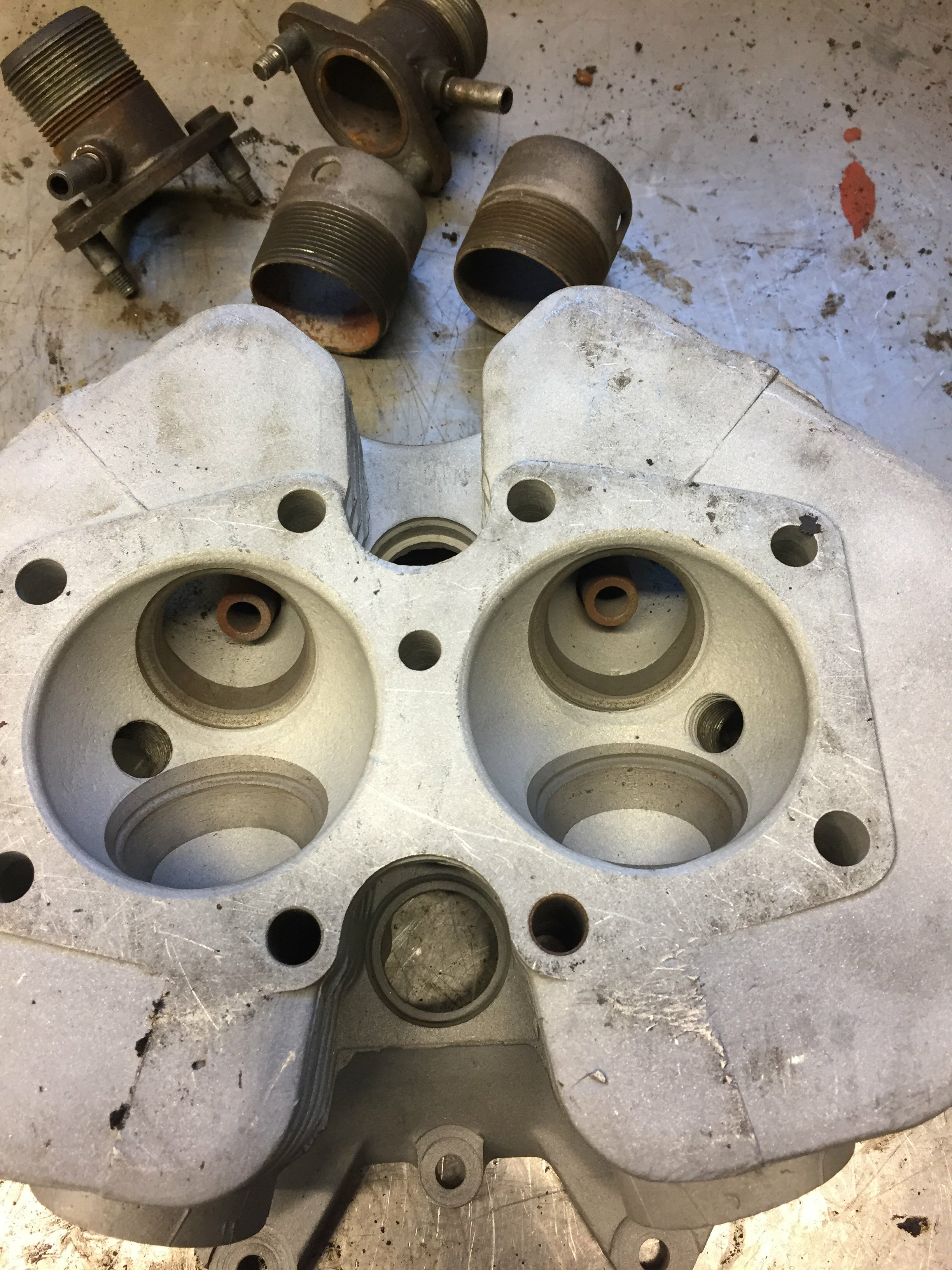

    At the Bristol classic yesterday I was quoted £160 a rim plus vat so quite pricey when I could just get some new rims from £65 but on the other hand it would be nice in the long run to have originals , oh the dilemma .

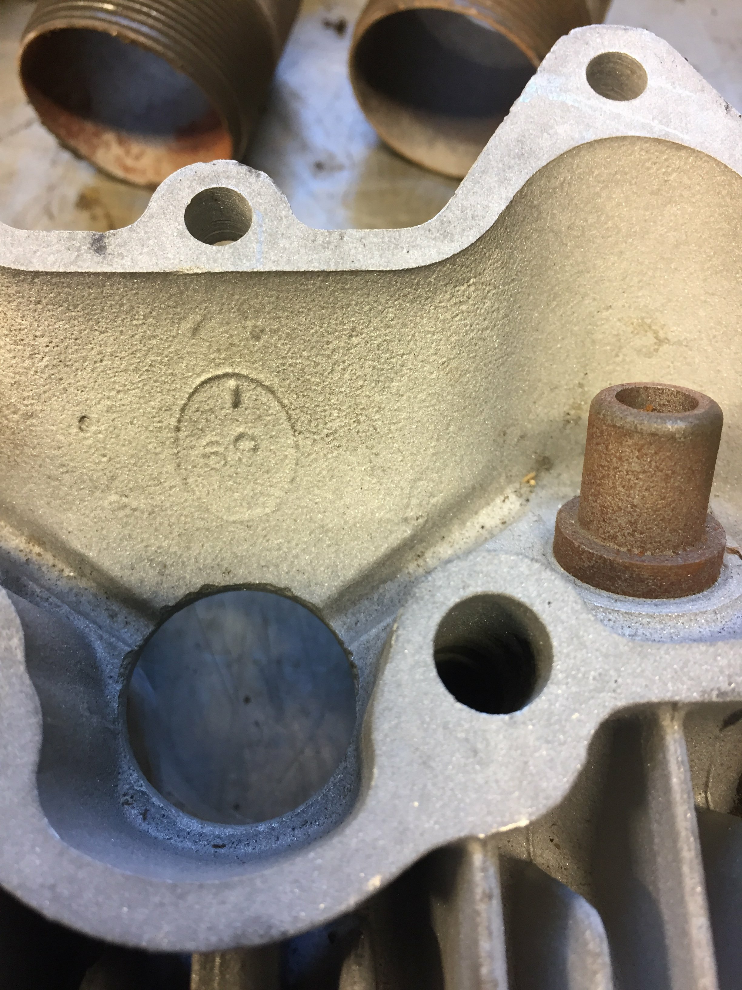

    I did however score a better prospect of a cylinder head , the one that came with the bike had been clearly swapped probably just prior to import :( . Clues being the loose bolts , one valve head missing and looking at the piston crowns it hadn’t mashed these crowns . I did that ! Also it had a 68 stamp . My new one is a 69 ! Ideal . £150 was paid but it does need new seats which is ok .

    My new 69 head

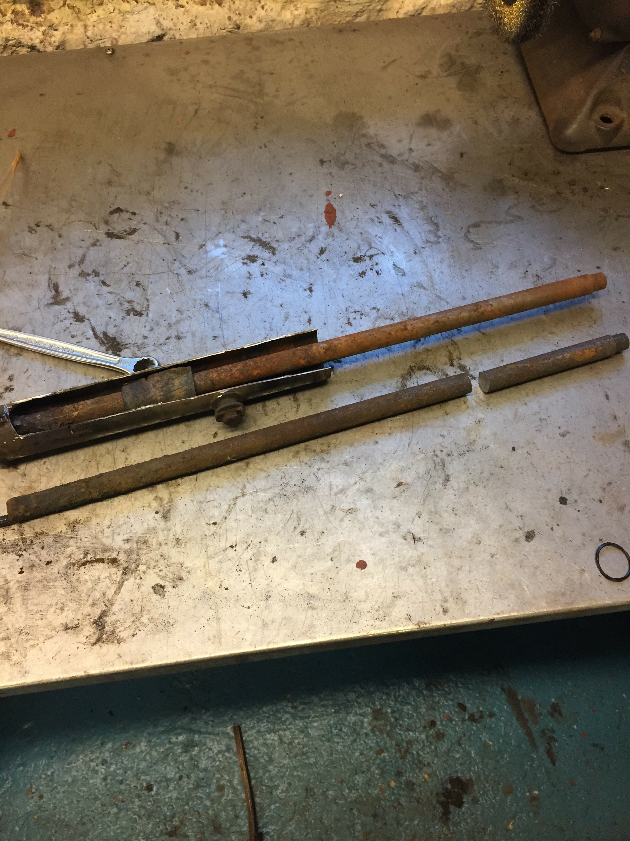

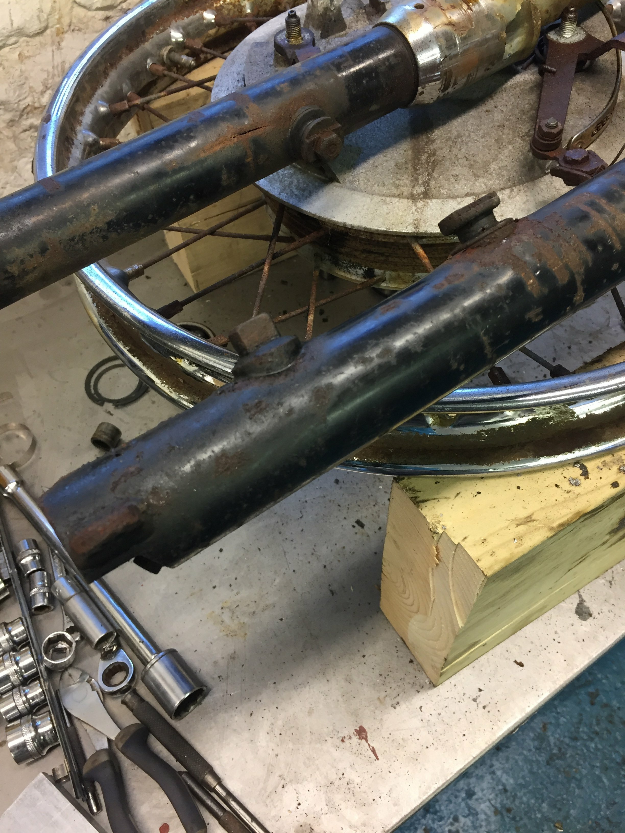

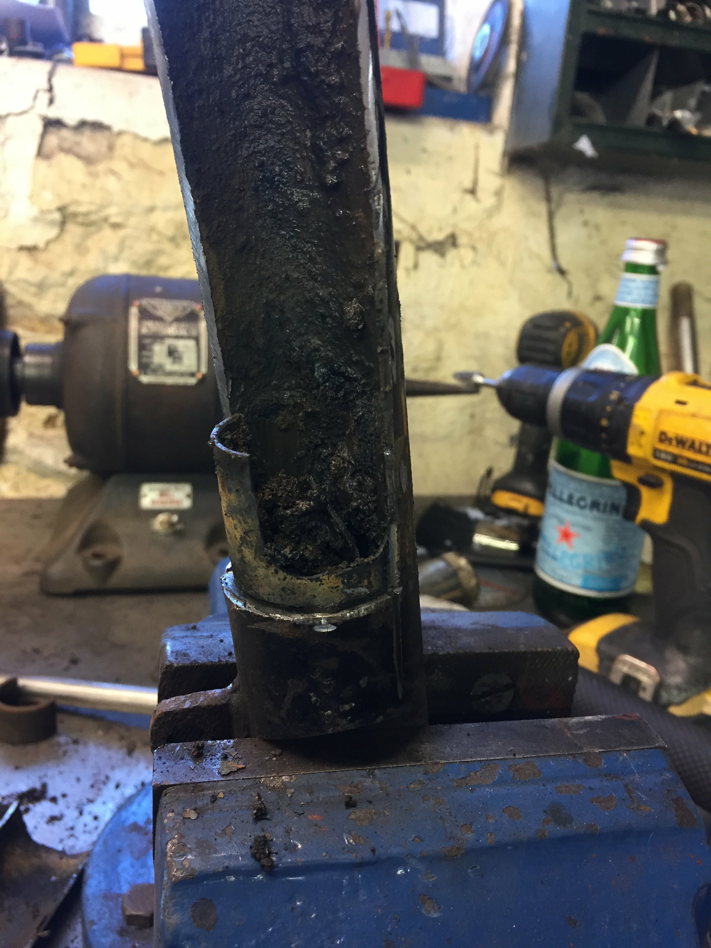

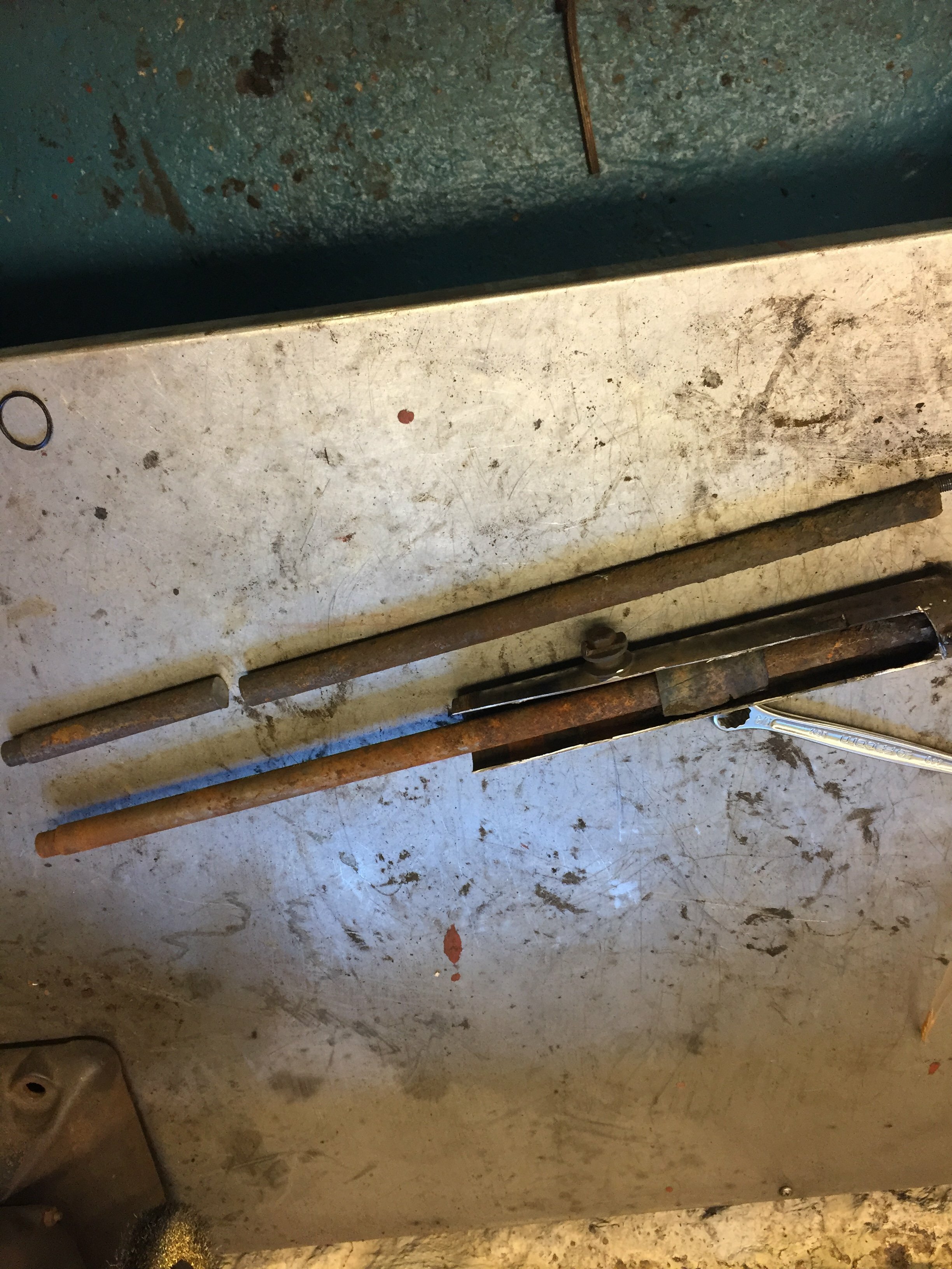

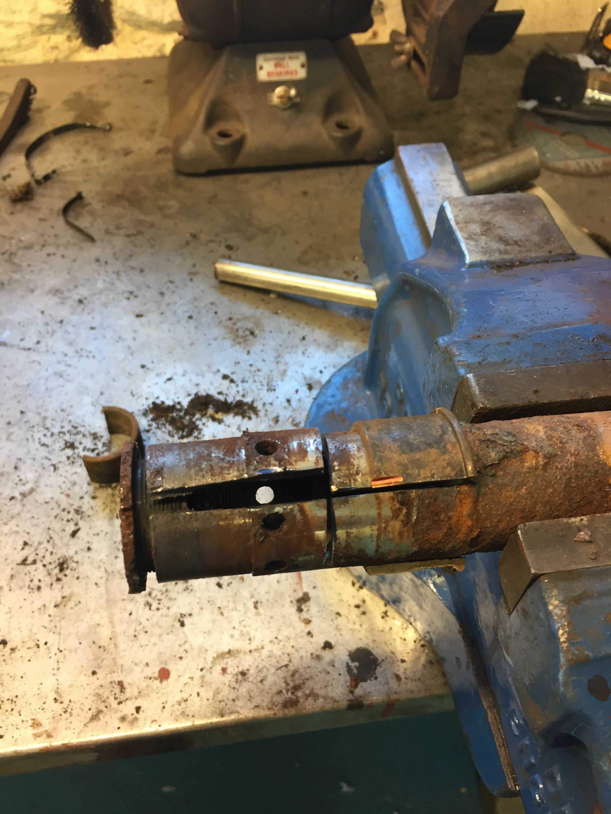

    I spent way more than five mins cutting up my sliders this morning after realizing there was the possibility of saving some internals , I did save the Stanton nuts so saved £20 but may have made a balls up! last night I looked on my parts diagram and it looked like essentially the stantions are the only things in the sliders , I was expecting to see some shuttle valves and the plastic damper bits but I seem to on one leg cut through a steel bar inside the Stanton which is held in place by an Allen bolt in the base of slider . I got the Allen bolt undone on the one I cut the end off but the other is pretty fecked with rust and need replacing .
    A thing to note is my stantions were extra long chopper style , there were no shuttle valves to be seen but I did see some plastic damper tube things

    #34 Tibster, Feb 24, 2019
    This is the metal rod I cut through

  16. darkman
    7,659
    Another load of parts to find :)

    I am starting to wonder if I have the right parts diagram or they were a fork set up from something else ! I cant seem to find that metal rod on any diagram .

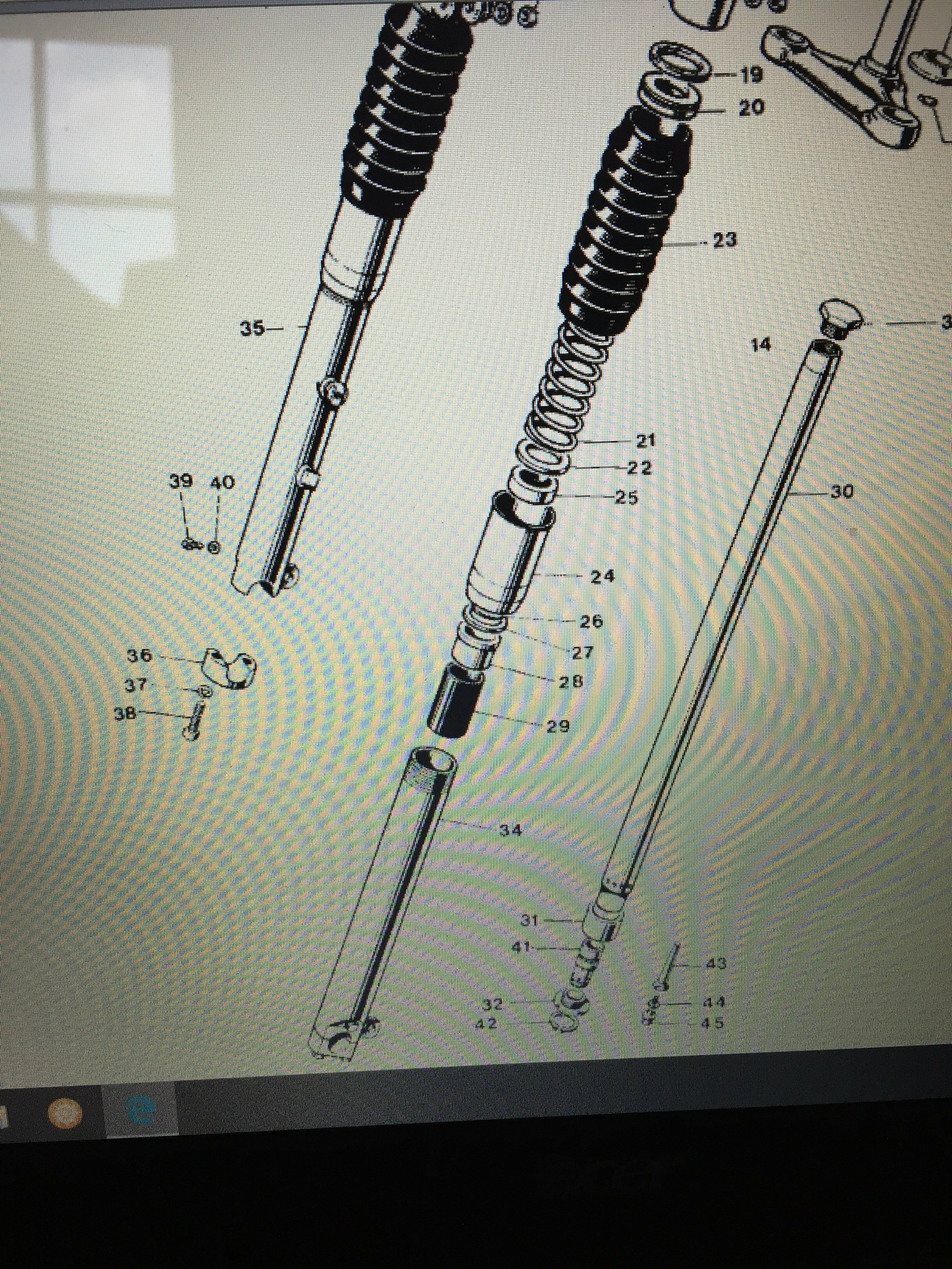

    Below is the part diagram I have , it shows no metal rod/damper also no long spring that goes in stantions that mine had just large diameter that goes under gaiter . Is this the set up on your 69 Darkman ?
  19. darkman
    7,659
    Yes the diagram is correct for 69, if your old forks had springs inside this was a common mod back in the day for a clean look fork leg :)

    Ah ok , thanks , not familiar with triumph forks or any other for that matter . So with a bit more reading tonight and great help here the earlier T120's had internal stantion springs with a more complicated /heavier dampers . The later had external springs as per my diagram .
