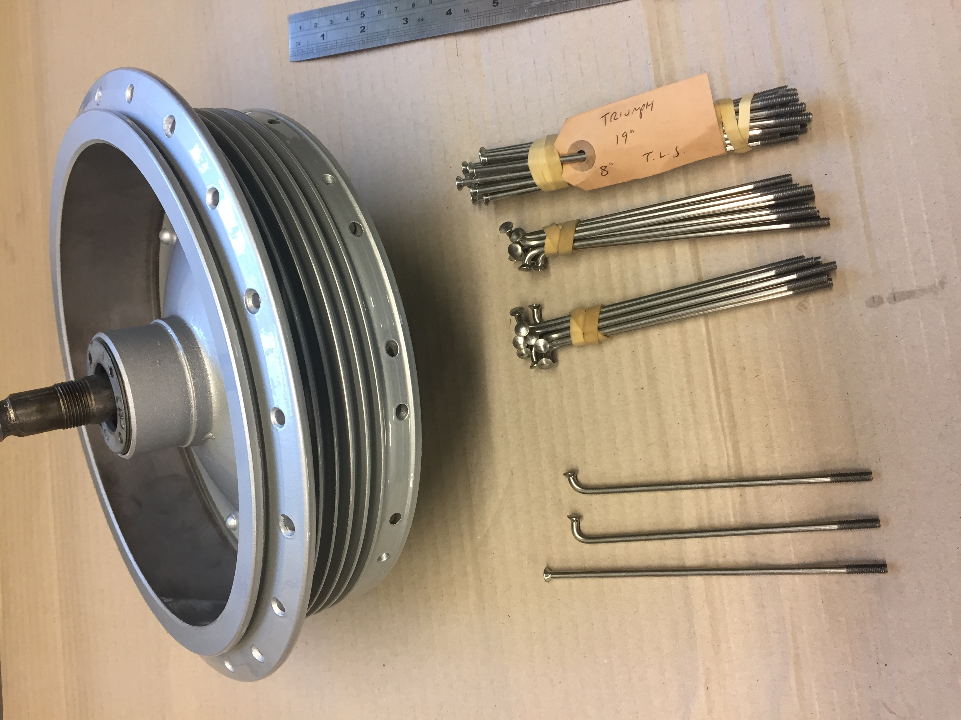

    Thanks darkman , on other matters I still havent built up my front wheel which is a right pain Cwc sending me wrong spokes twice so I am having to chase them again monday sorry tuesday to send correct ones .

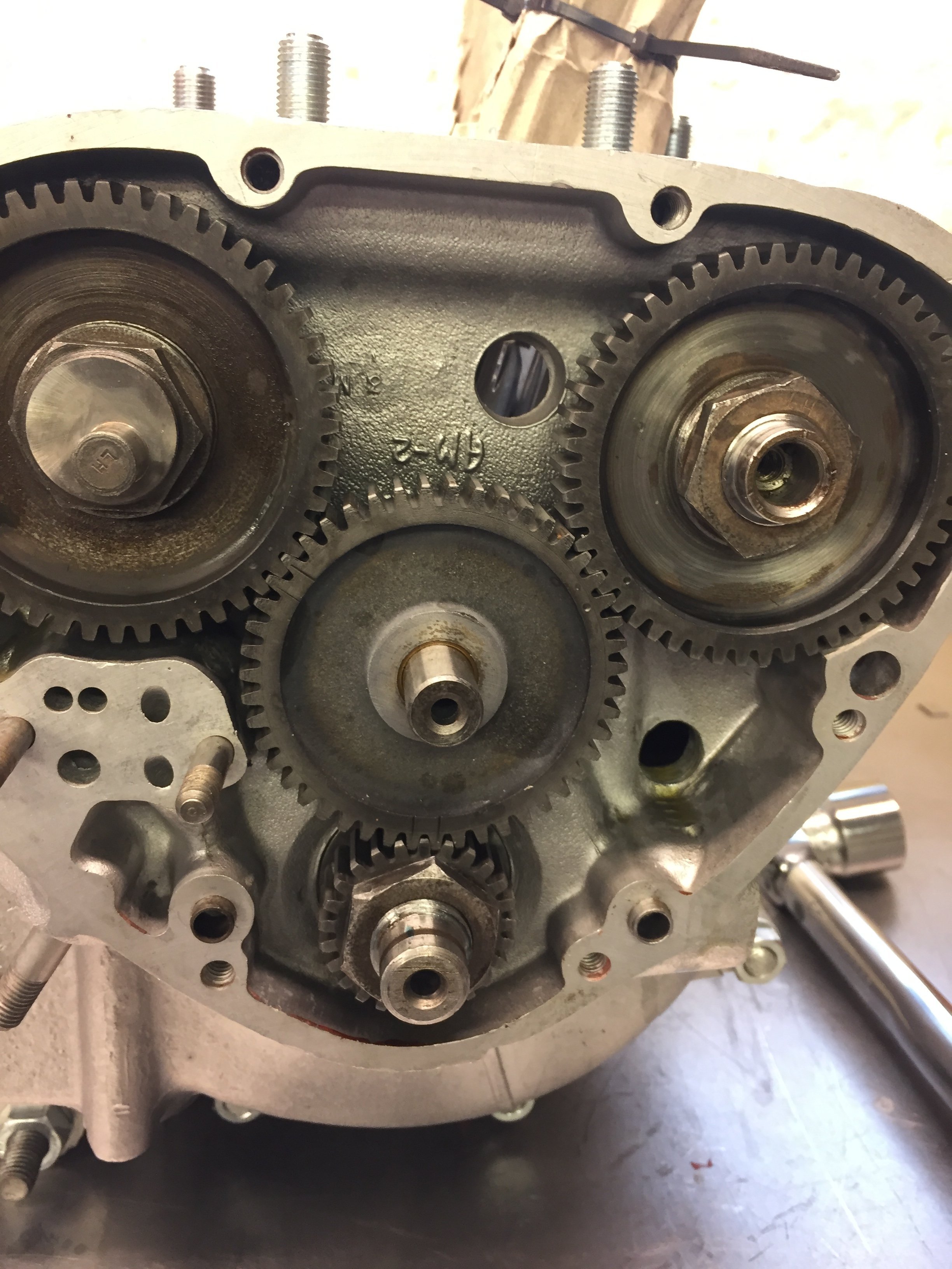

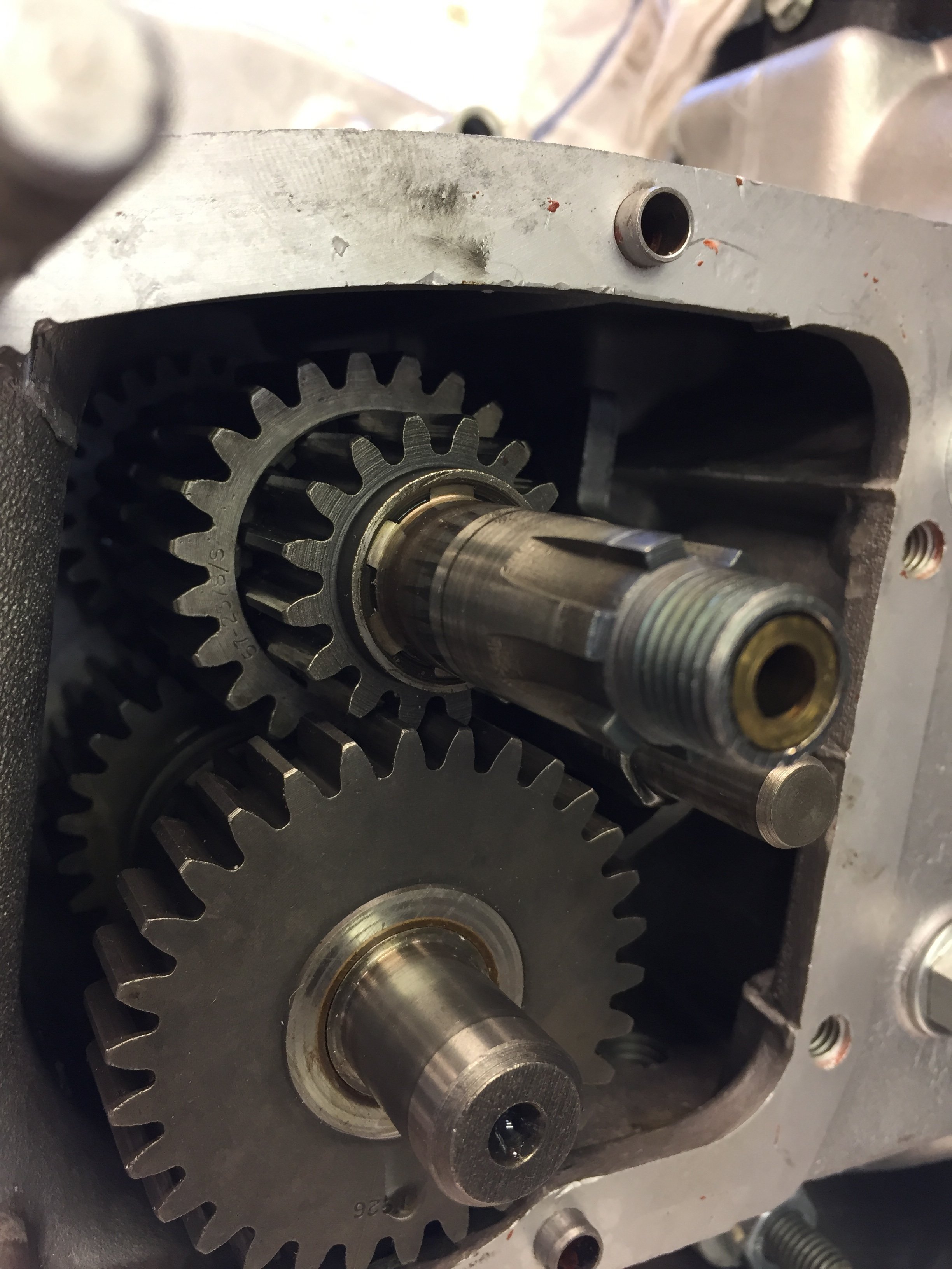

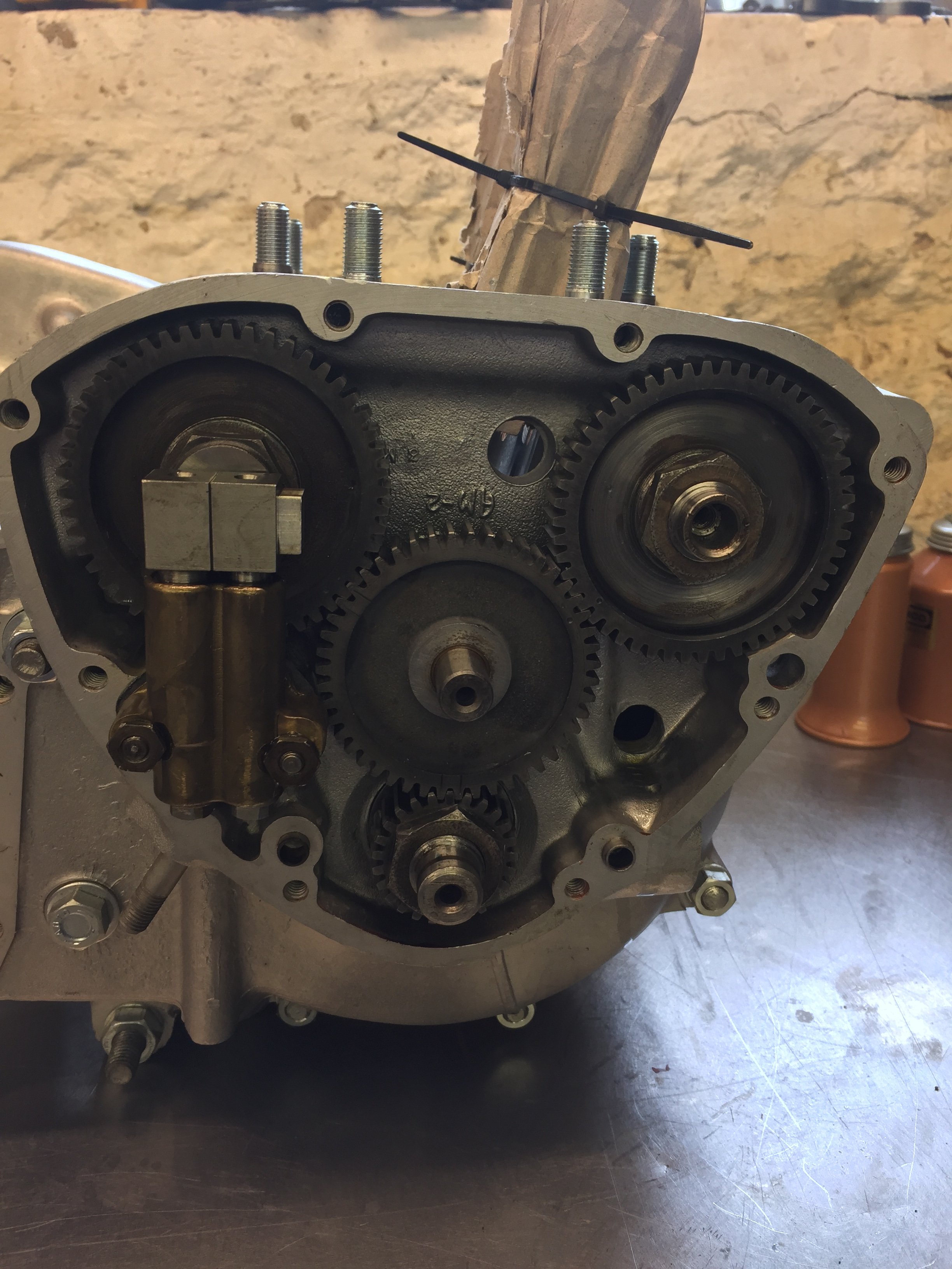

    Cases closed and timing gears timed :)
    Fitted a new Harris pump too . Went to refit tappet blocks but none of the o rings in the Harris gasket set seemed the right size, too loose and I couldn't get them to slide in which was annoying so will try and track some down tomorrow .

  5. darkman
    5,158
    7,660
    Just a precautionary, did you strip n clean pump as i do them all and have found edges that need deburring and swarf in them :-(

    I must admit I didnt strip it completely I did take out the pistons and degreased as they were gummy with a waxy oil , oiled and put back , they looked ok to be fair . I did note they had slot outlet opening compared to the old one , I openned the gasket slightly as it was restricting opening very slightly .
    Side cover not on yet as bit undecided about its state of polish . Thanks for the advice ,think I will just undo the bottom two nuts on the pump to dbl check for any nasties tomorow .

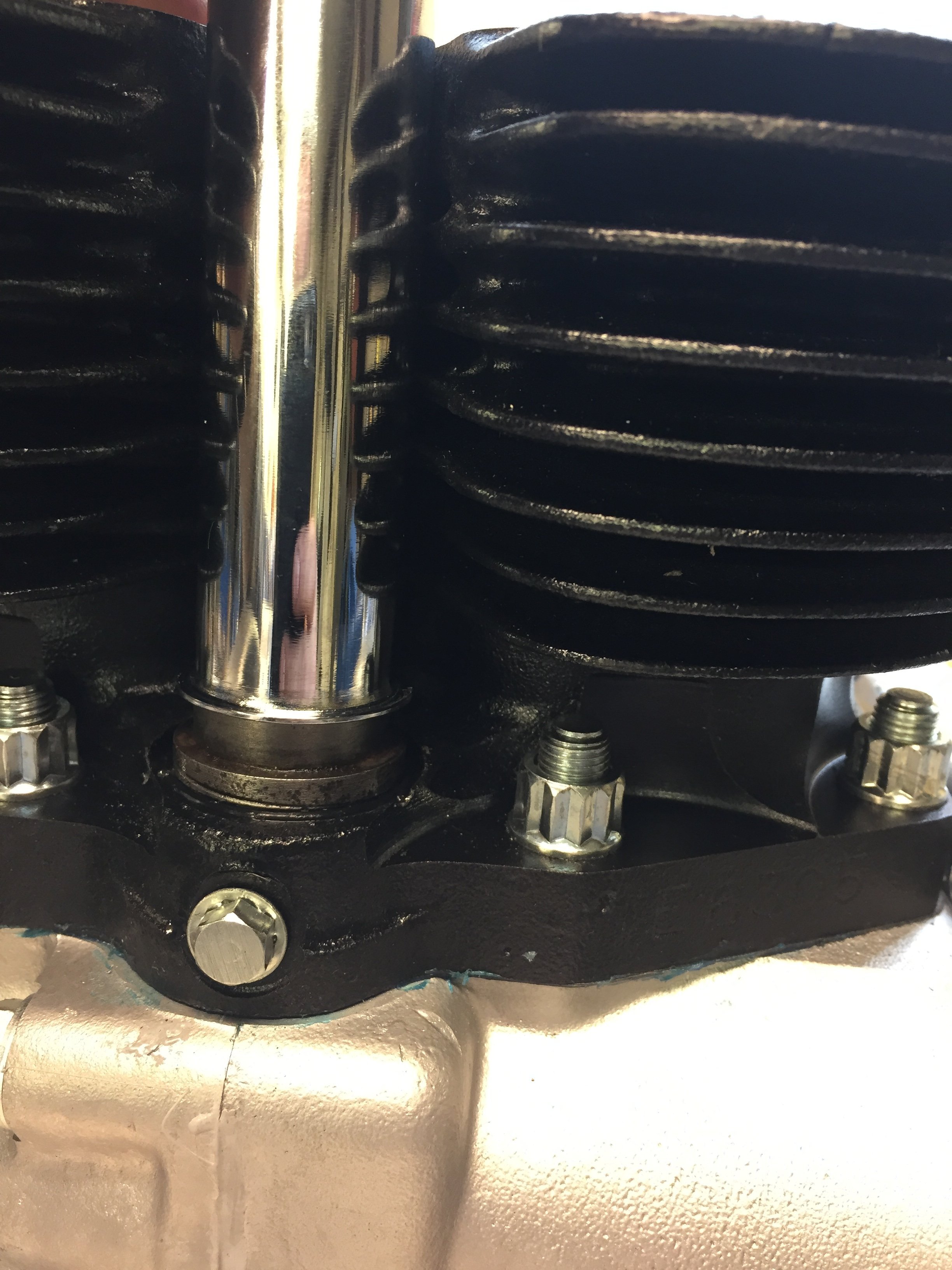

    I seem to be supplied with the wrong push rod tubes :confused: These are Harris chrome but I do wonder how long the chrome finish will last so thinking alley ones may have been a better option ?
    Think they should be like this

    Yep, early tubes. You need the one's in KBH pic's and you also need the wedding bands and 3rd seal that makes the crush up.

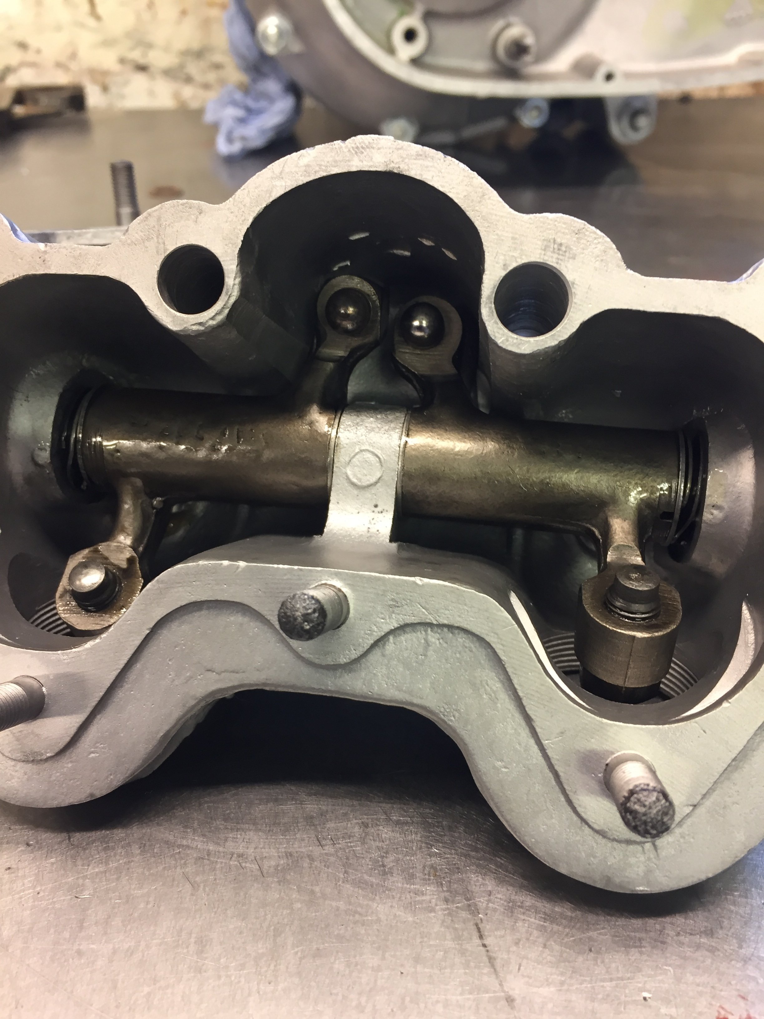

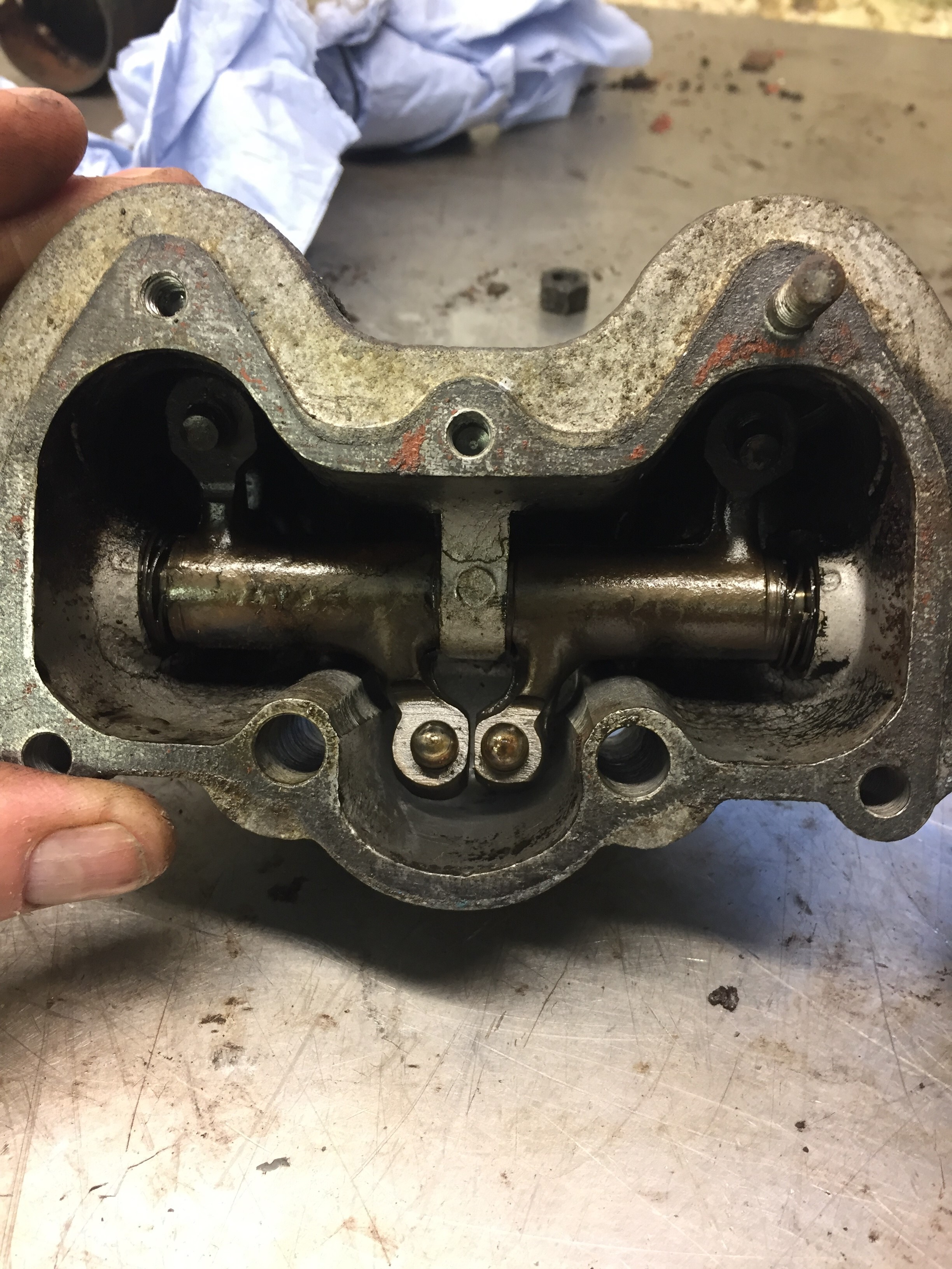

    Cool will get them ordered up , rockers reassembled mines a 69 with notched rocker ends for oil , after a bit of research it seems mine were incorrectly fitted when I disassembled seems the thrust washers should face the rockers and the thackeries up against the aluminium casting if I have got it right that is .

    Common thing to see them fitted wrongly, yes washers go against the rocker to force oil out of the notches cut into rockers but you have to get 4 of the smaller washers like the rest.

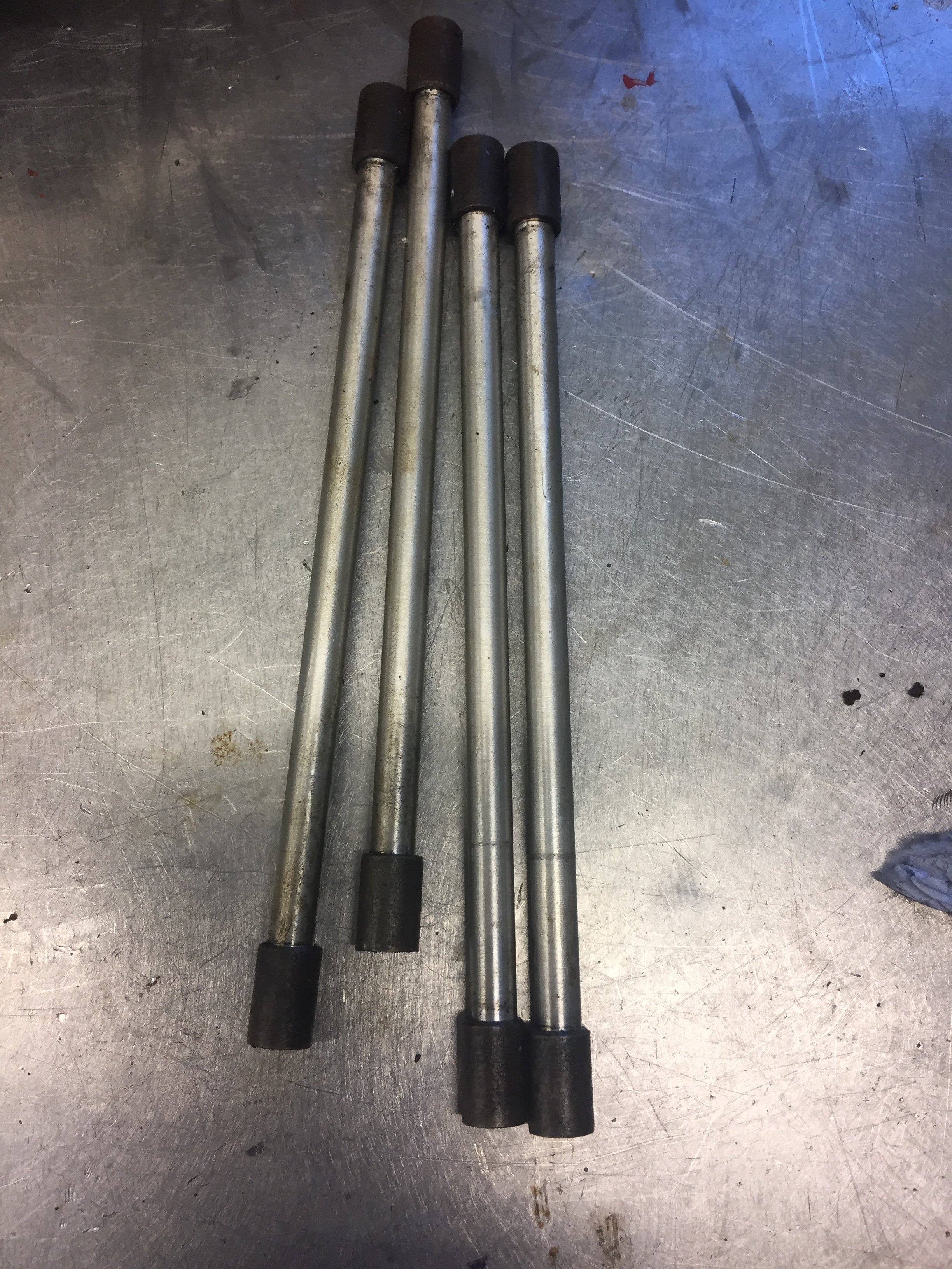

    I need to put a smallish parts order in tomorrow as well as the washers for the rockers I had a look at the pushrods today , visually I think they dont look too bad , look to be straight and true ,ends uniform in wear .
    Are these generally replaced as a matter of course through fears of fatigue or should I be ok reusing ?

    Gearbox went back in ok , cant fit the kicker cover finally as missing a couple of casing dowls , its always the little thing that seem to hold things up , although CWC look to have finally come good with sending me the correct spokes for the front wheel . So thats another job to be got on with .

    If they are straight and not marked then original pushrods are a better bet than most of the rubbish out there.

    I would check that you can't pull the ends off the pushrods (by hand only) before fitting them.

    Thanks for that Phil , I gave them a spruce and clean today , glad to say they survived a pull test ! think they will be good to go .

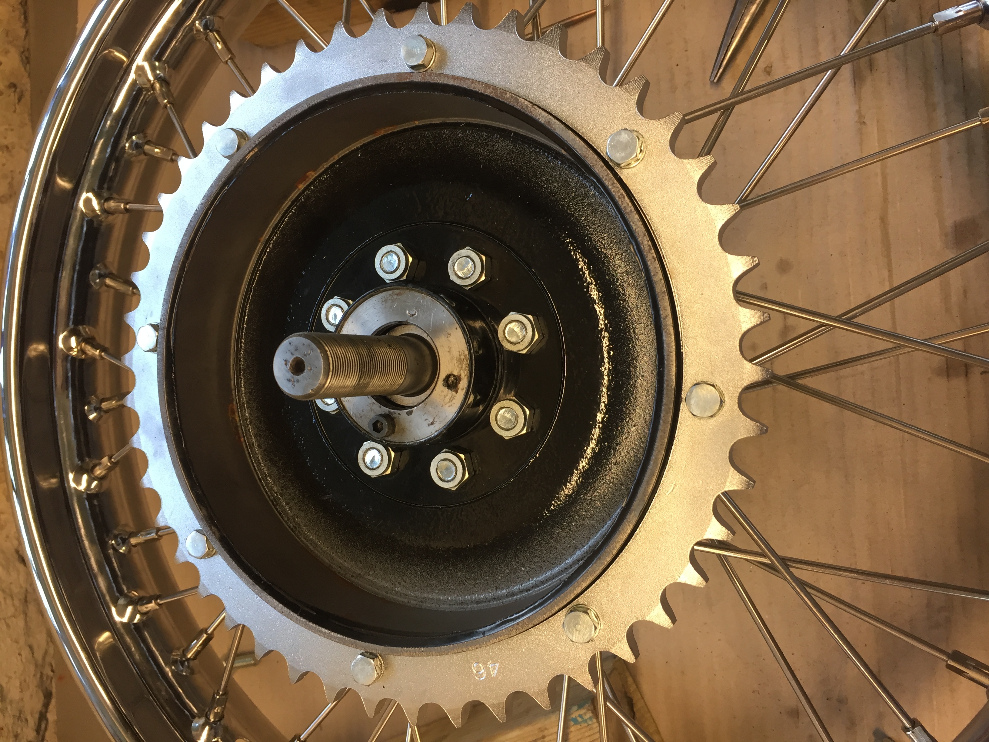

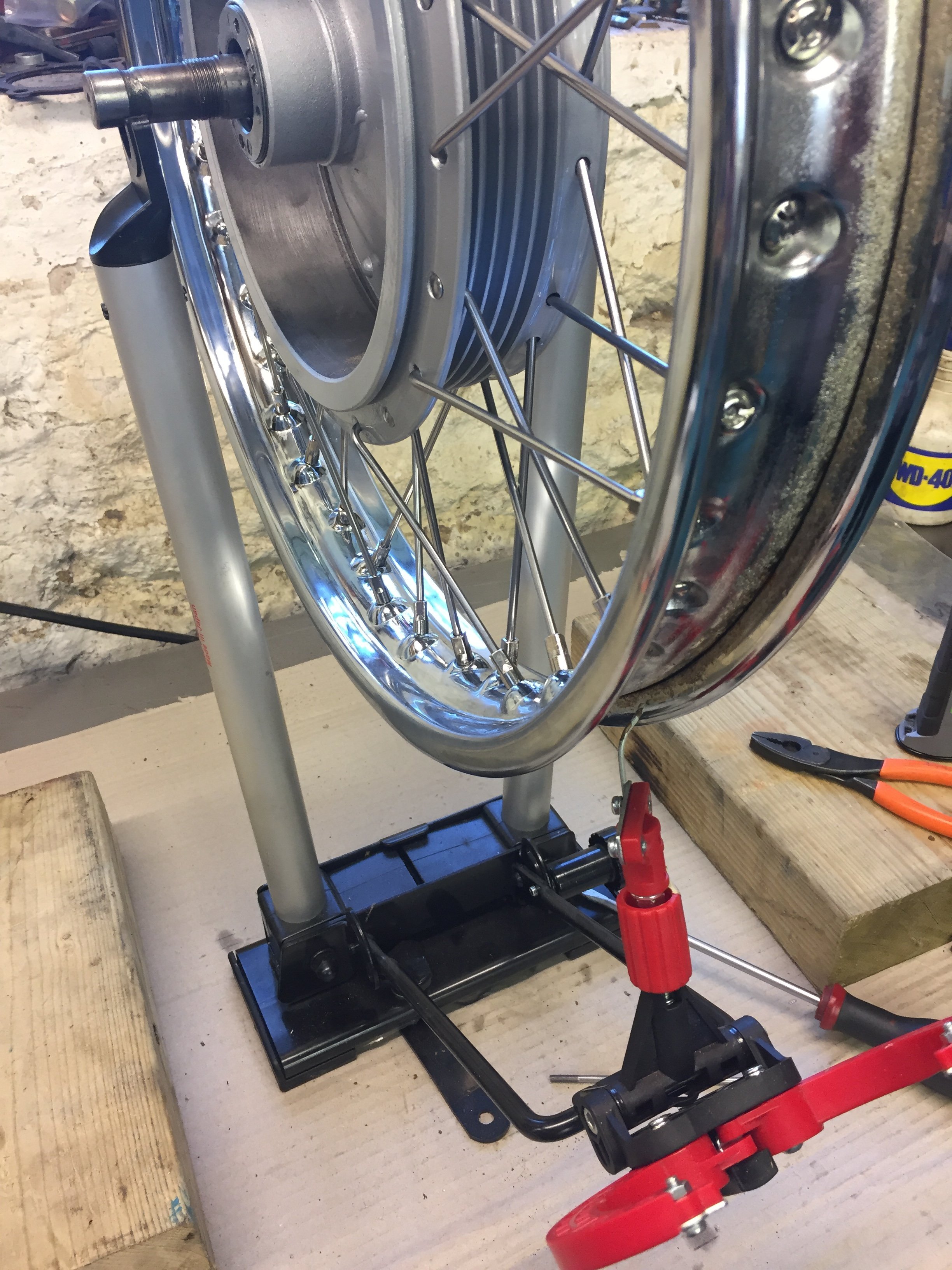

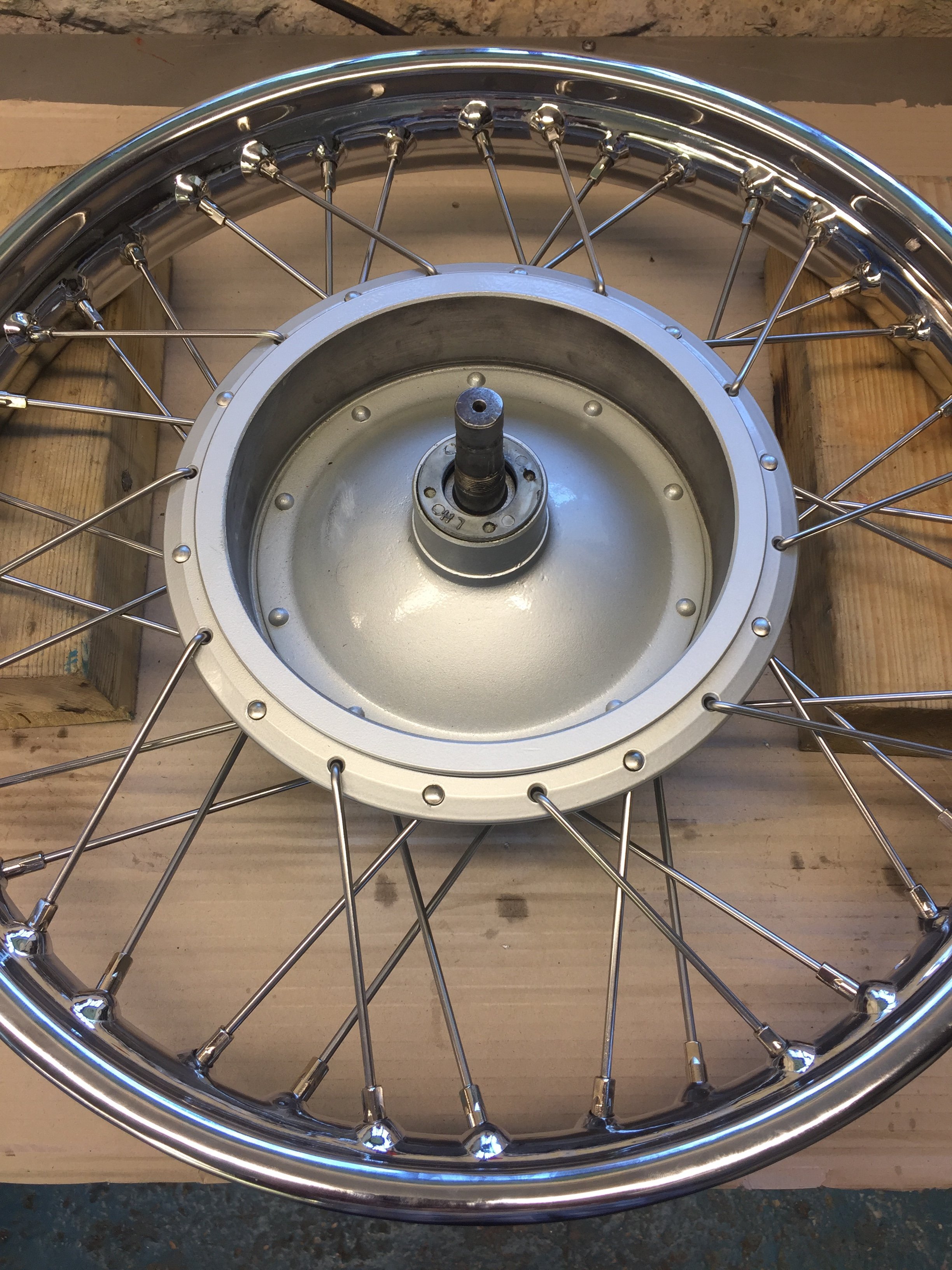

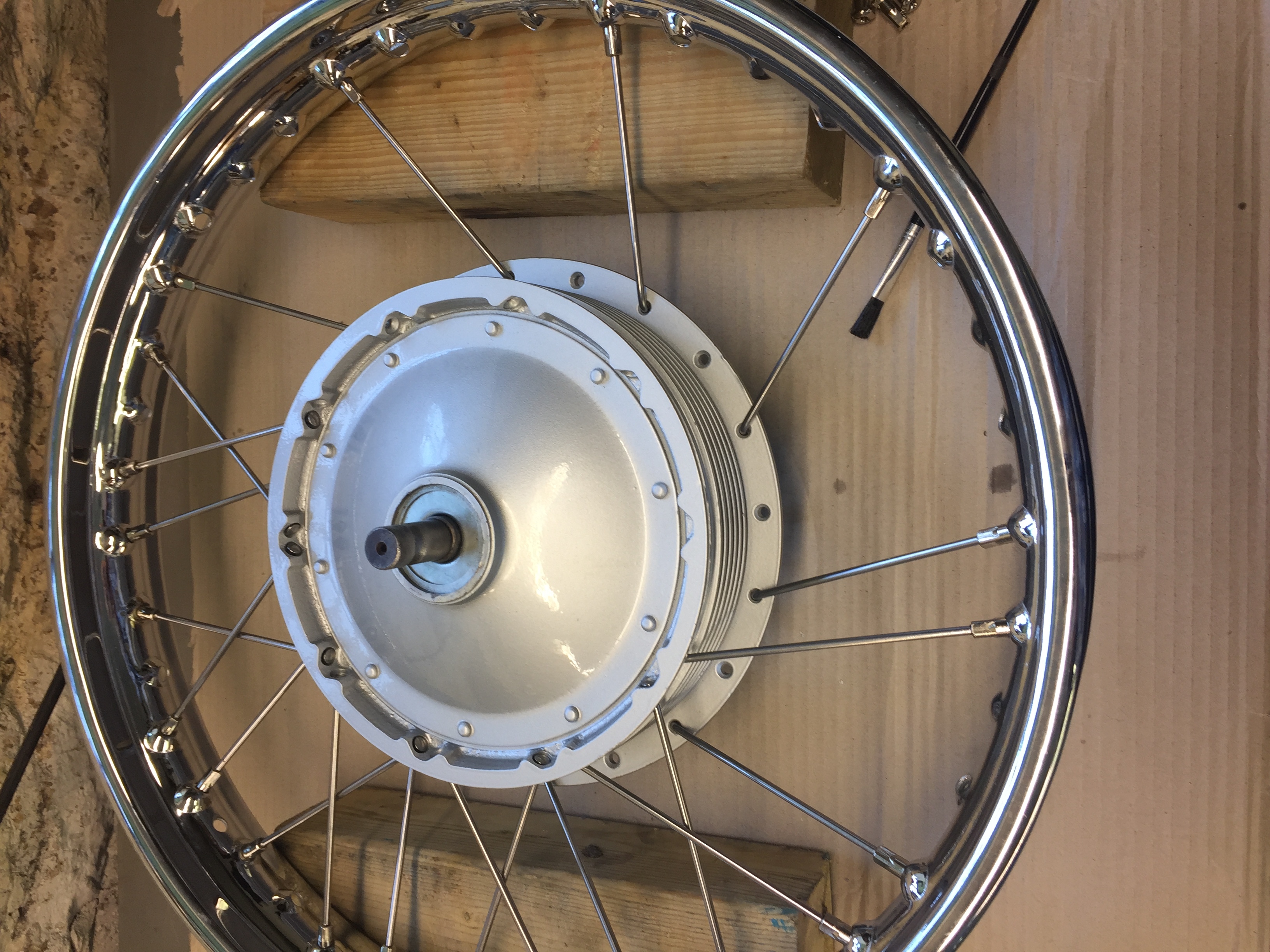

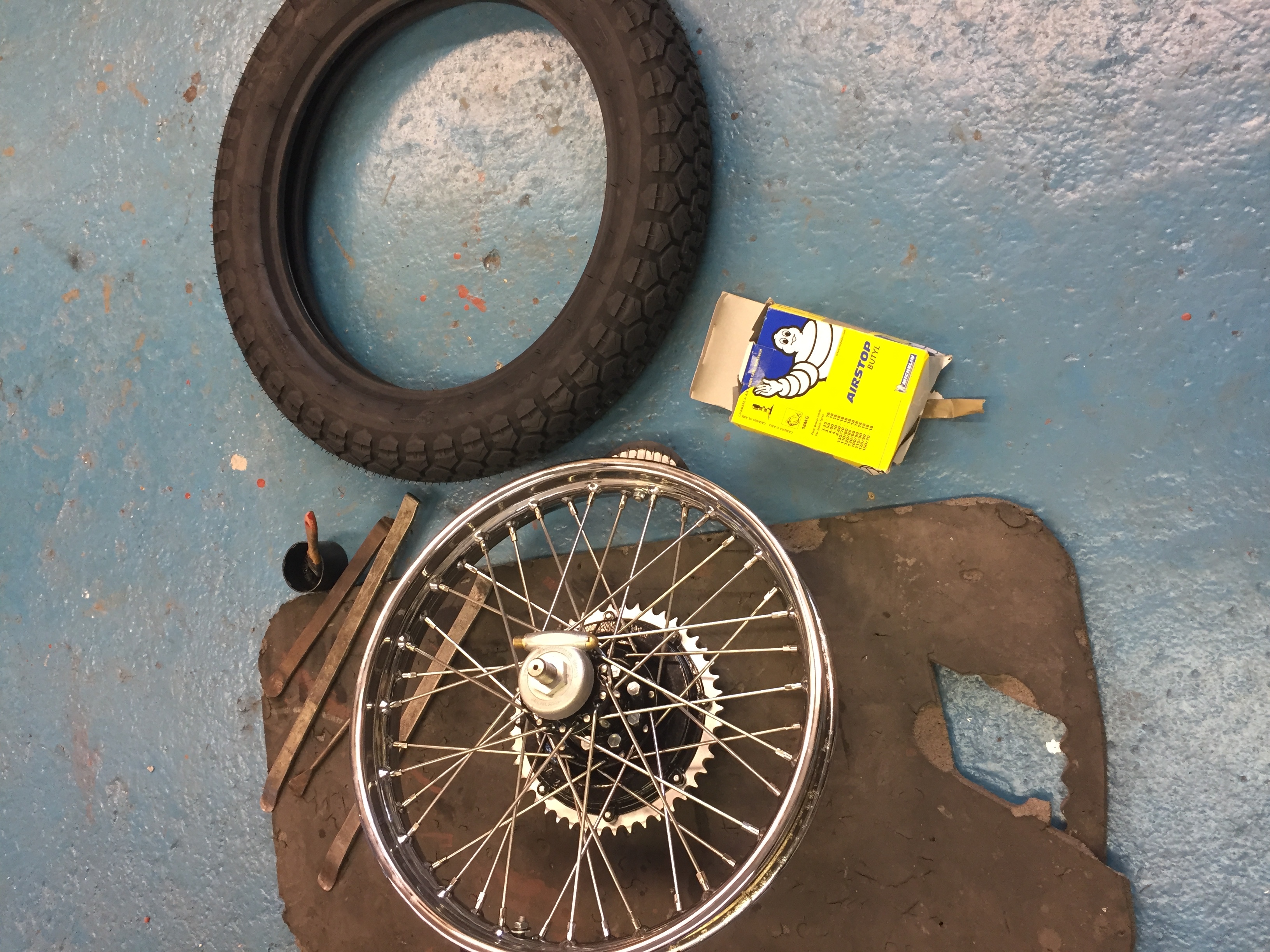

    Front wheel now built up , easier than the rear to lace somehow .
    With both wheels built I fitted new the new K70's

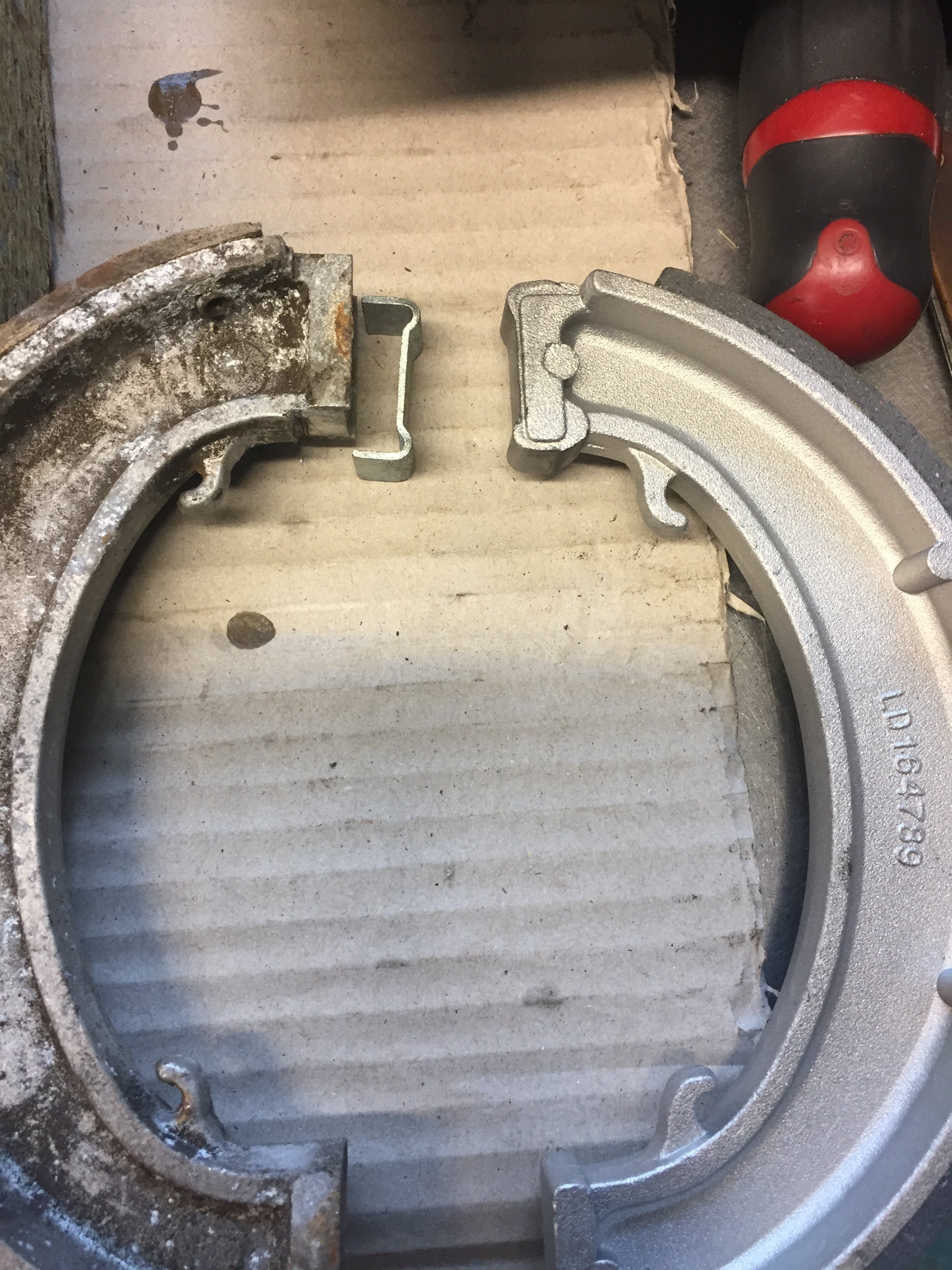

    Fitted some new brake shoes , seems the new ones come with a hardened cast in contact shim , the old shoes had a separate piece which was plated for no reason it turns out , not sure why they have done this tbh . The old end shim wont fit over the new so I assuming it must be redundant ?

    Nice looking wheels :)
    #218
  19. Tibster
    Tibster Well-Known Member
    Feb 10, 2019
    200
    270
    Witney
    Excellent , they must be good ! I must admit I am pleased with them .Getting the tyres on wasn't as bad as I thought , not saying I never swore at all but plenty of washing liquid and the fact that a mate lent me some decent levers helped . Fitting the tyre locks was quite tricky but they are in . I understand now that after I had bought them they may not be necessary but it did have them before.
