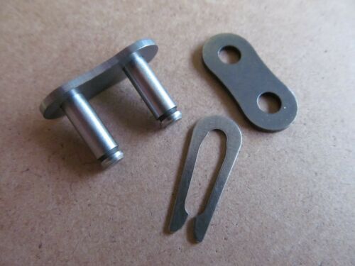

  6. speedrattle
    speedrattle Senior Member
    Feb 19, 2021
    1,204
    appalachia usa
    theres a master link in the chain.
    https://www.googleadservices.com/pa...wjz862c4qD0AhWYp3IEHVvTCDkQwg96BAgBEDI&adurl=
    get a pair of good sharp pliers and squeeze between the open tips of the spring clip and the pins on the master link. the clip will be forced backwards until the wide parts of its hole line up and you can lift it off.
    take off the sideplate and push the link out to separate the chain ends.
    that is how you get them off without damaging the spring clip.
    then throw yours away and get a new one.
    ah but you got that. good

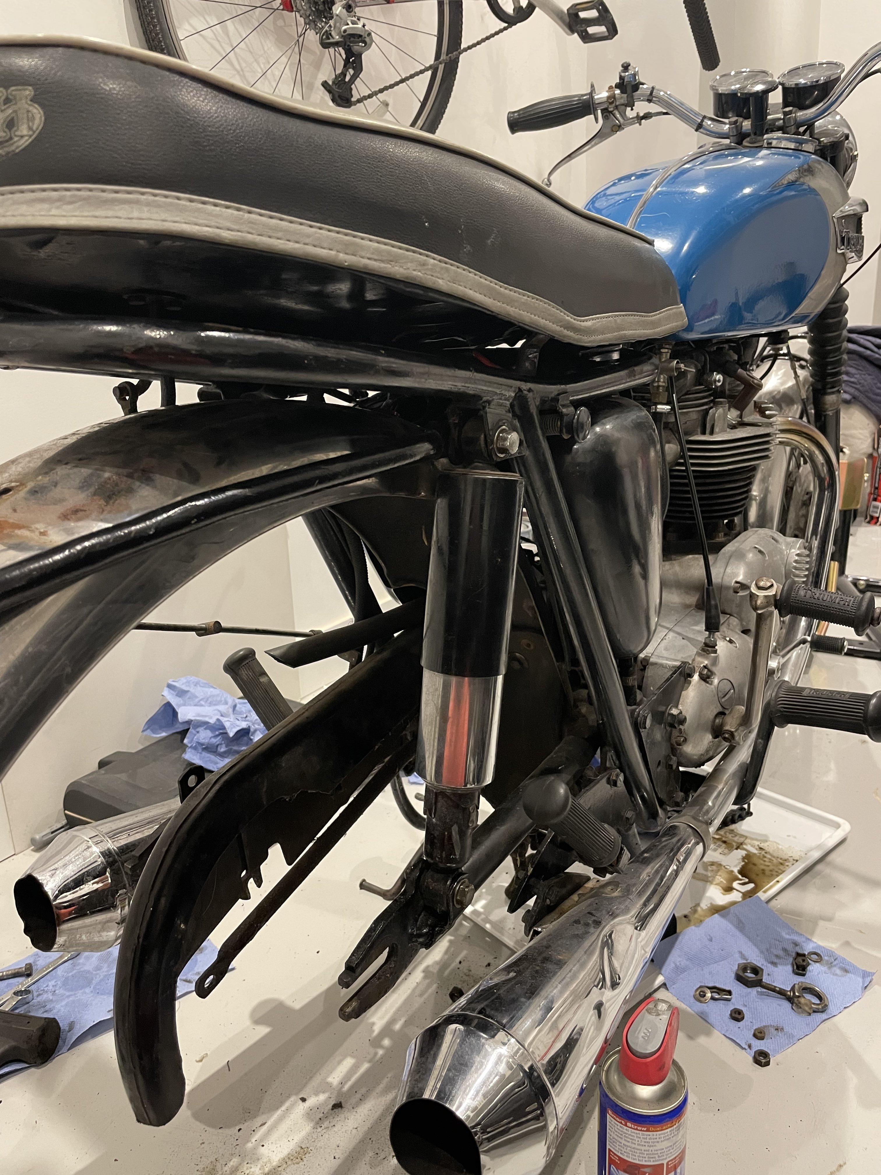

    State of play as of tonight.

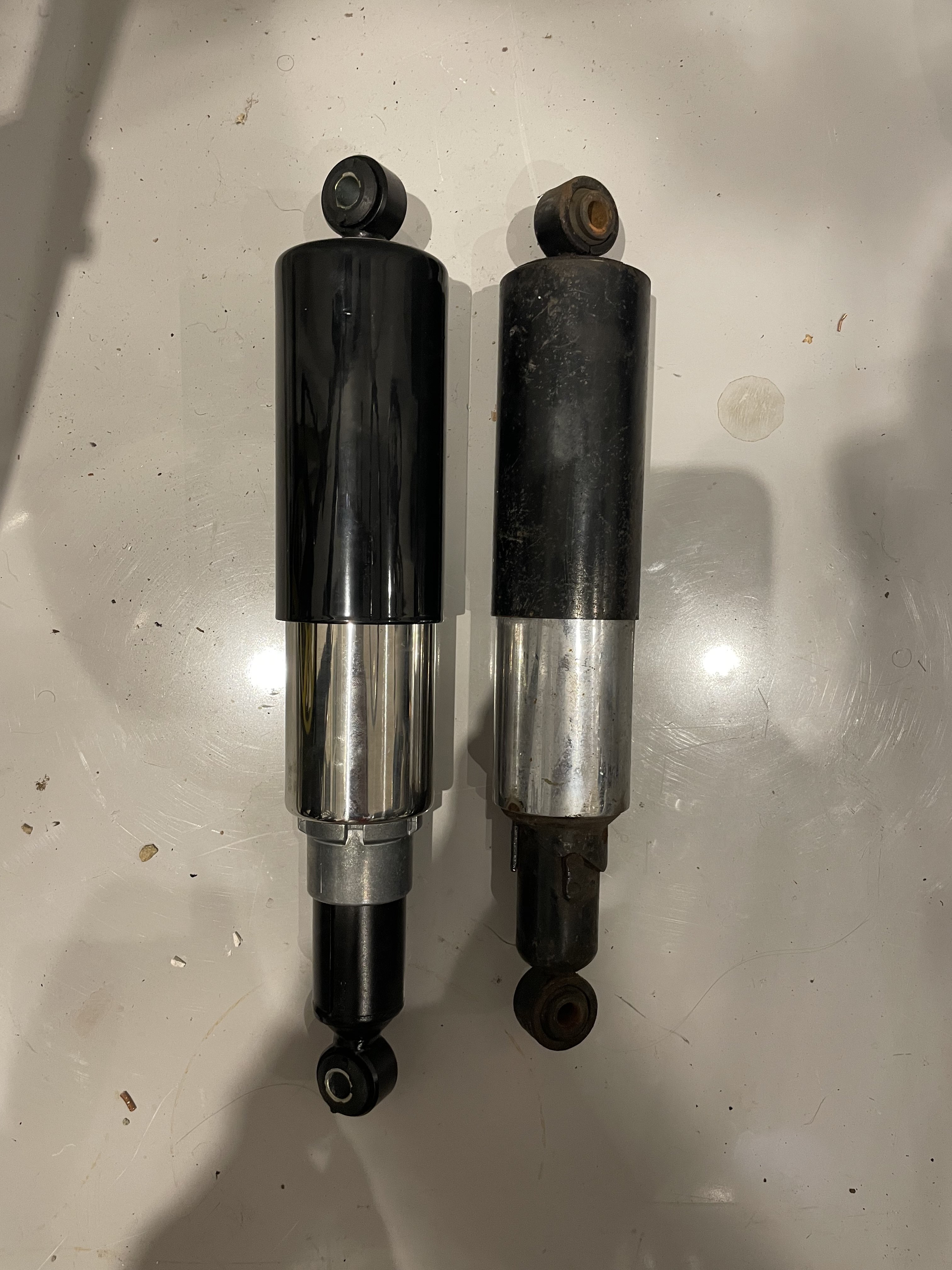

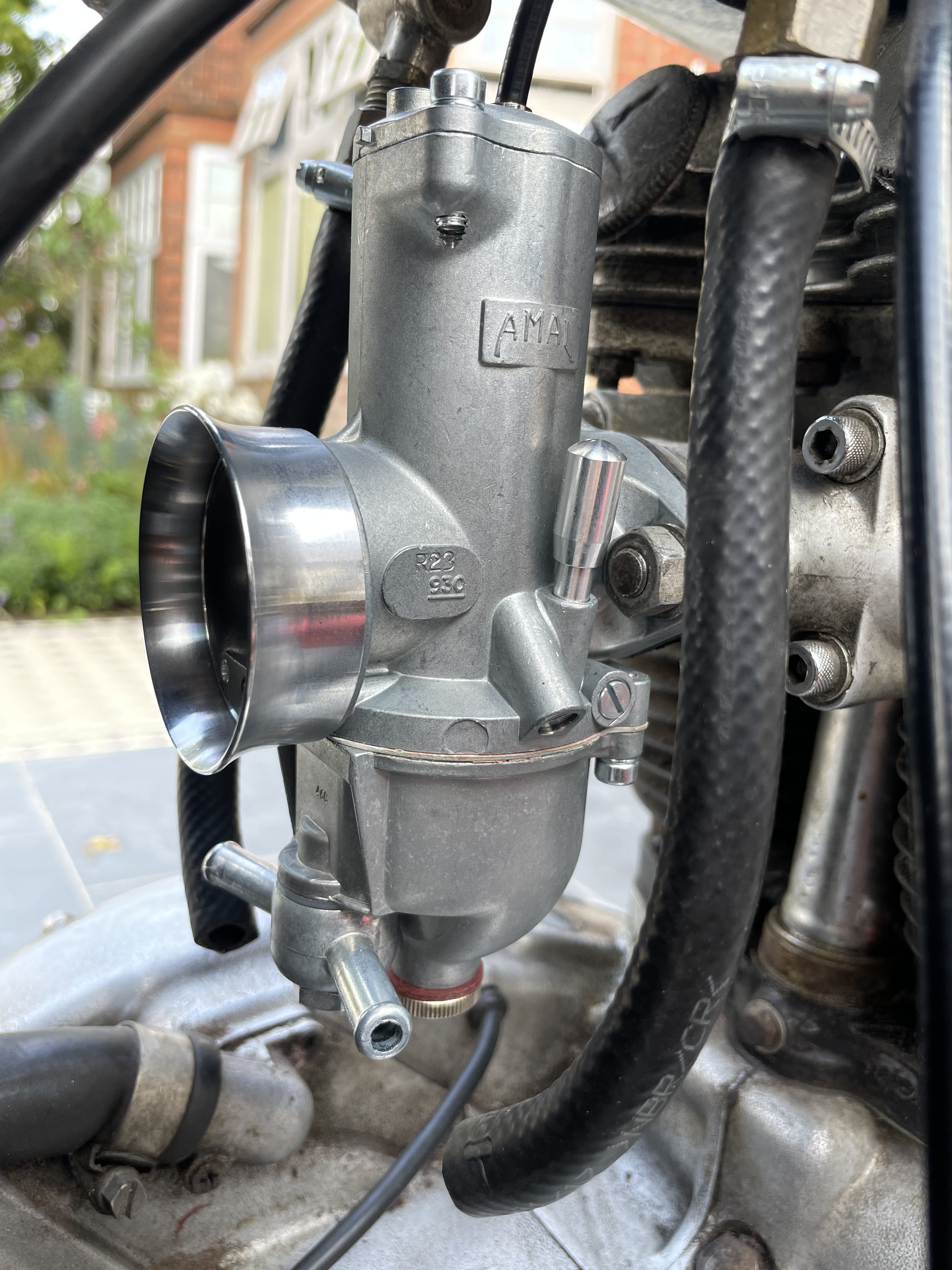

    What started as a little trouble shooting has resulted in new Amal carb fitted, new battery box and wiring, new Hagon shocks and new throttle. Had to take the rear wheel off to get the shocks off as their bushes were seized in. The shocks themselves do not move at all. New Hagons on the left.
    Fresh engine and gear oil once it’s all back together and a new battery and off we go.

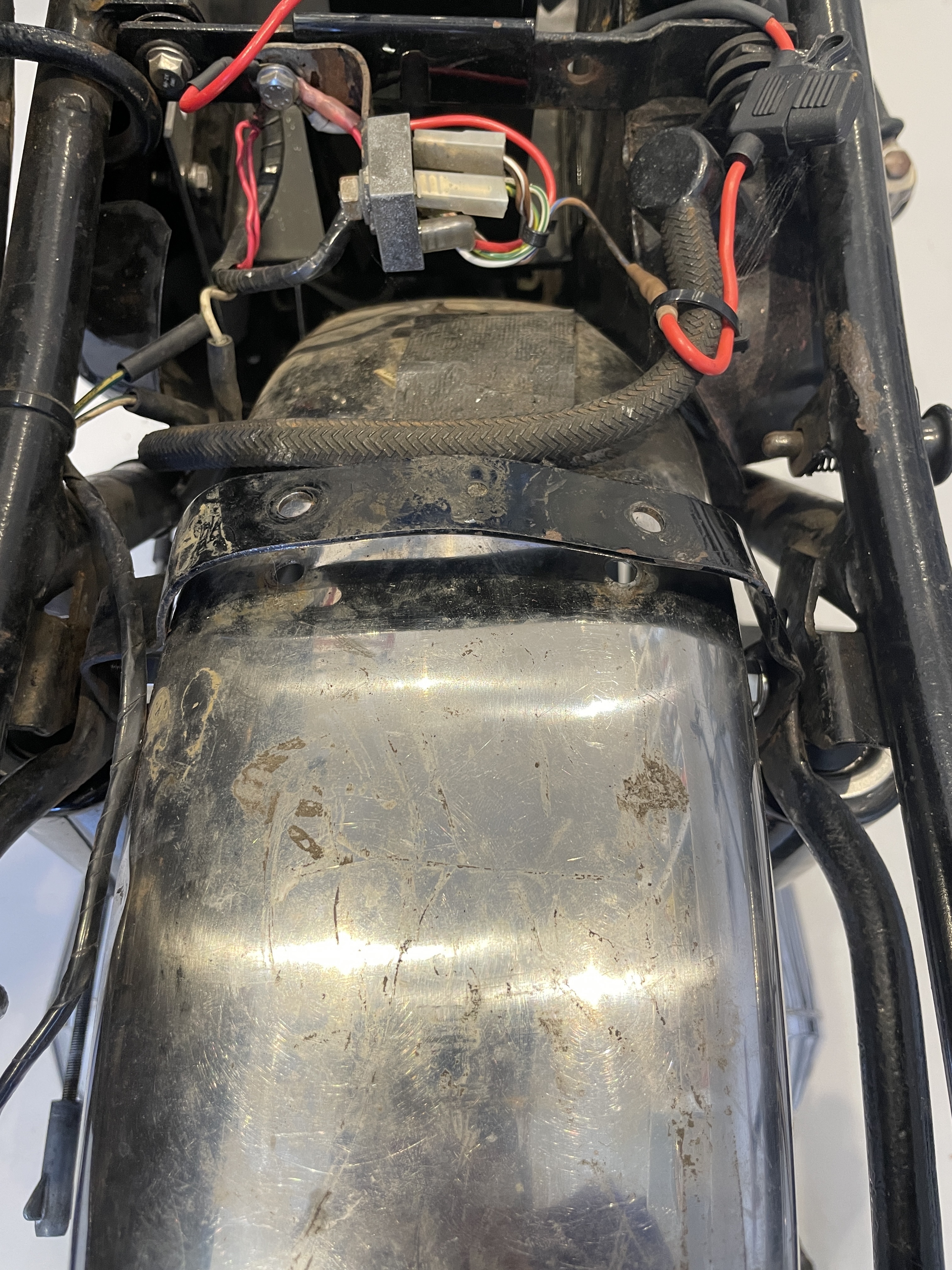

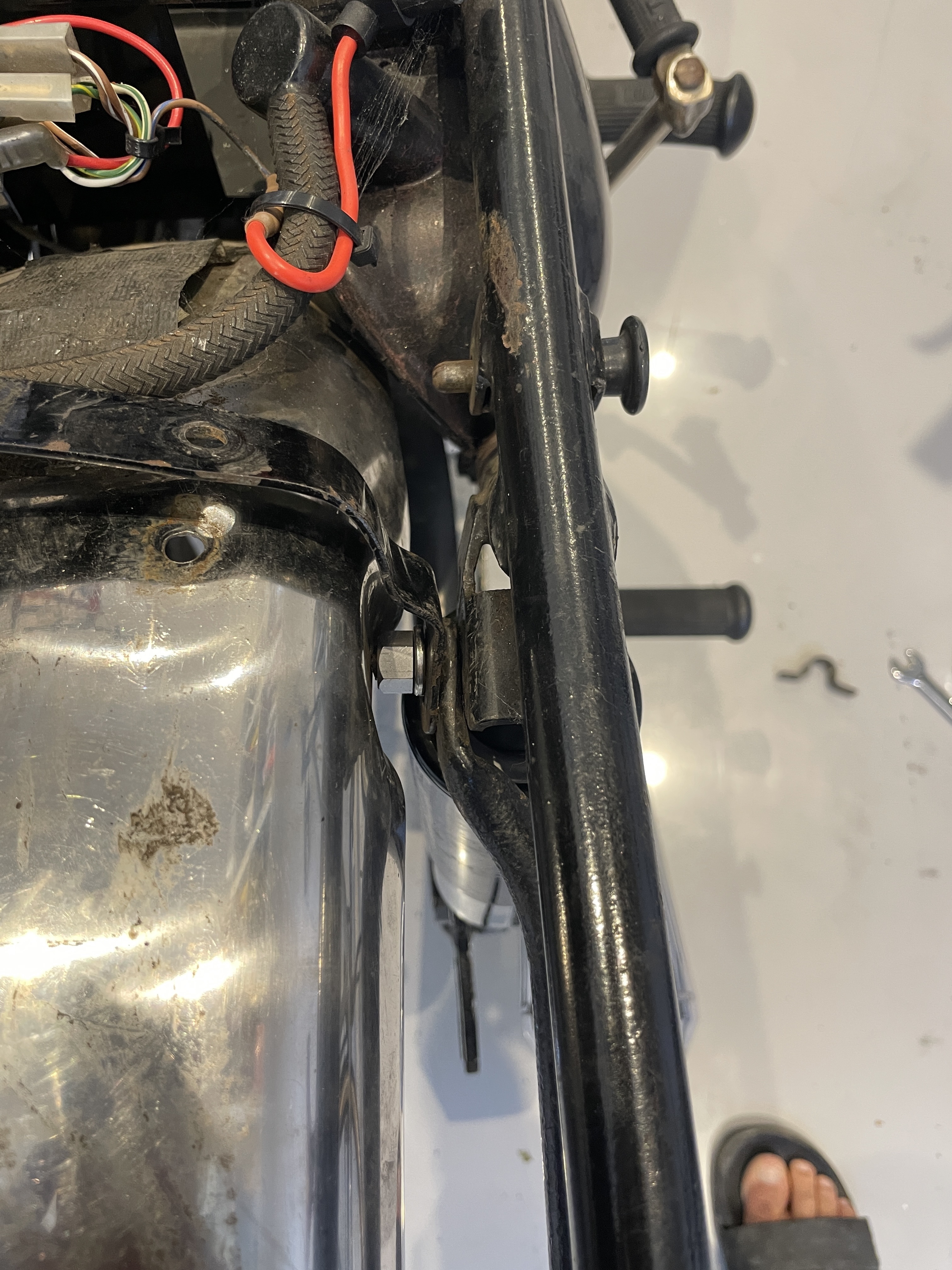

    Need to call on your knowledge again. Having a bit of aggro getting the rear fender to sit correctly, after removing it to release seized in rear shocks. My main issue is the bracket that runs along the top for some reason now sits way too high and cannot be fastened to the fender. Yet the fender is placed as high as it will go.
    My other question is, are that bracket and the rear license plate support in the correct order here? Should the bracket be closest to the fender or closest to the frame?
    Thoughts?
  18. darkman
    7,661
    Mudguard mount/strap goes next to frame each side and the holes should be oval for up and down movement on the top shock bolts :)
  19. Tratch
    Tratch Active Member
    Jul 11, 2013
    94
    Thanks pal. It’s helped a bit but it’s still sitting too far from the fender. The rear of the fender is the issue it hits the rear frame loop and so can’t rise further to meet the strap.
    Bizarre, as obviously it was fine when I took out apart.
  20. darkman
    7,661
    Check to see if the front bottom mount has slipped down then as its easy for the mount to move on the frame and that would cause your problem.
