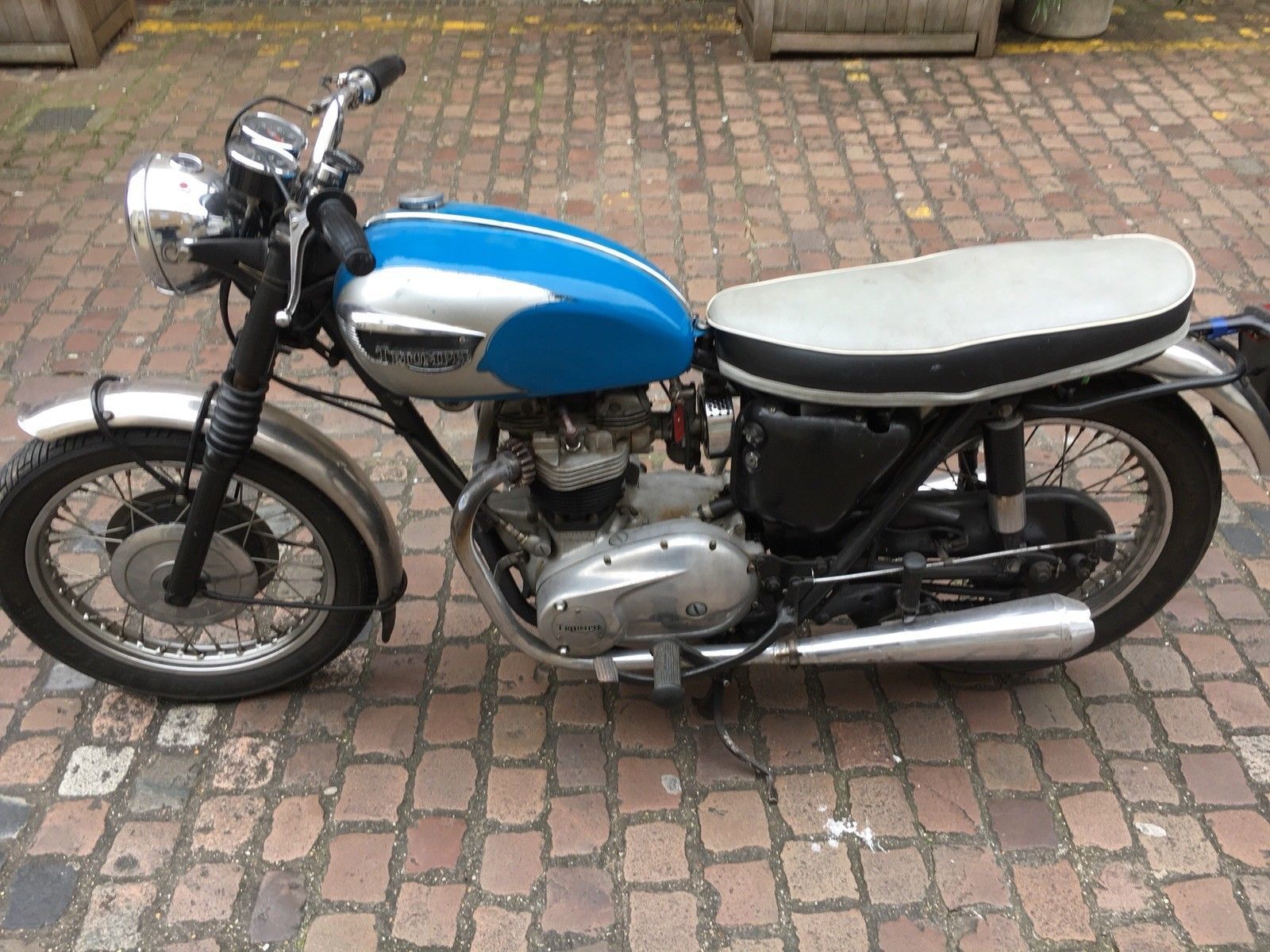

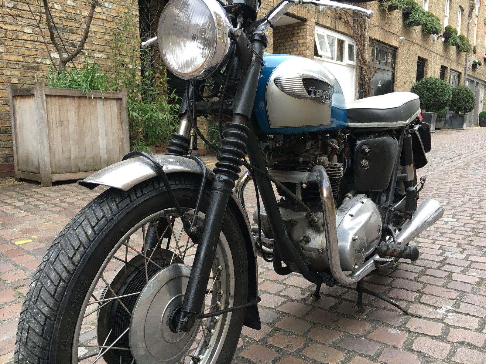

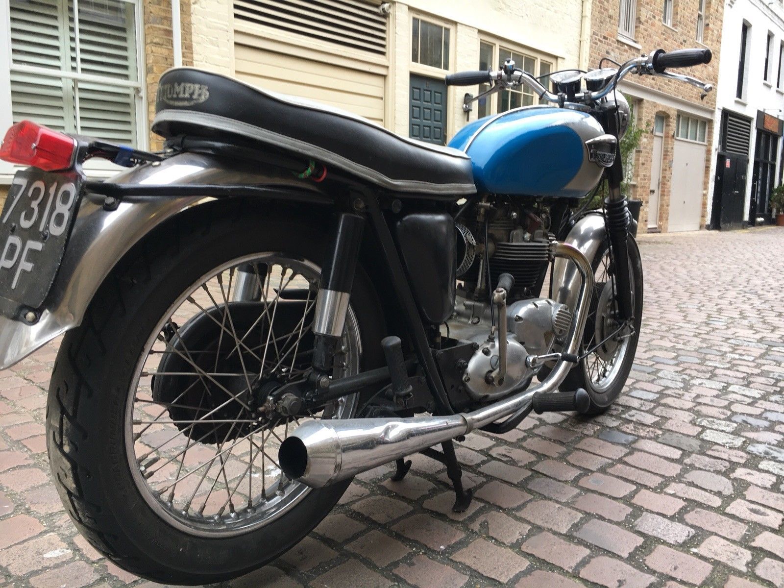

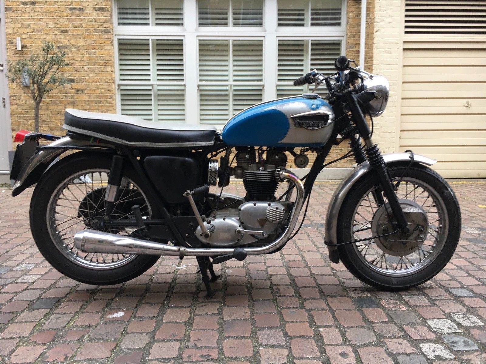

    I think @darkman has already helped out on some other things. The bike is a ‘63 but apparently with ‘70 Police engine and a late 60s front end?
    Bit of a mutt.
    Sounds like I’m in for a headache sourcing tools to do all these and future jobs.
    Pics attached.

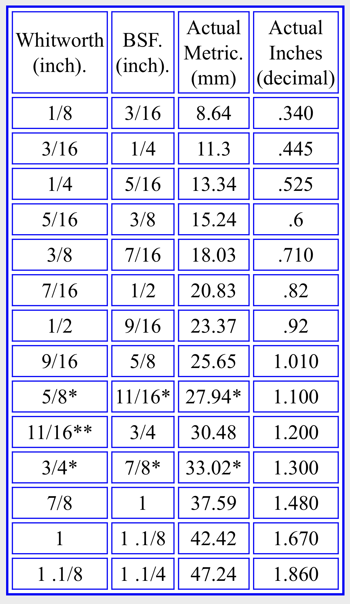

    Basically 63-68 used 3/8th CEI bolts and nuts that are Whitworth spanner sizes of 1/4th W and 5/16th W with wasted head bolts stamped Bradleys and 68 on had 3/8th UNF bolts and nuts using 9/16th spanner size :).

  7. darkman
    7,658
    Your best option is a set of Whitworth spanners and sockets, also as you have a later engine most of the fittings will be UNF but not all so you would req a set of AF as well.

    do you have any baffles in those reverse cone megaphones? just curious

    As for the silencers, not sure - I do know they’re crazy loud

    if you can wiggle a stick around in the big open hole i the end of the megaphones, then there are no baffles. that means two things
    1) they will be crazy loud, as you have observed
    2) they will likely have a flat spot somewhere around 3500 to 4000,. where the carburation doesn't work well on the street and the motor blubbers.
    if you put a muffler on your header pipes, the flat spot will go away, and
    1) your motorcycle will carburet better in the 3500 to 4000 range
    2) it will be slower at the top (assuming the carbs were corrected for the megaphones)
    megaphones are good for high speed applications. my 1972 T120 picks up 3 mph using open reverse cone megaphones, but you have to be going over 114 mph to see it.
