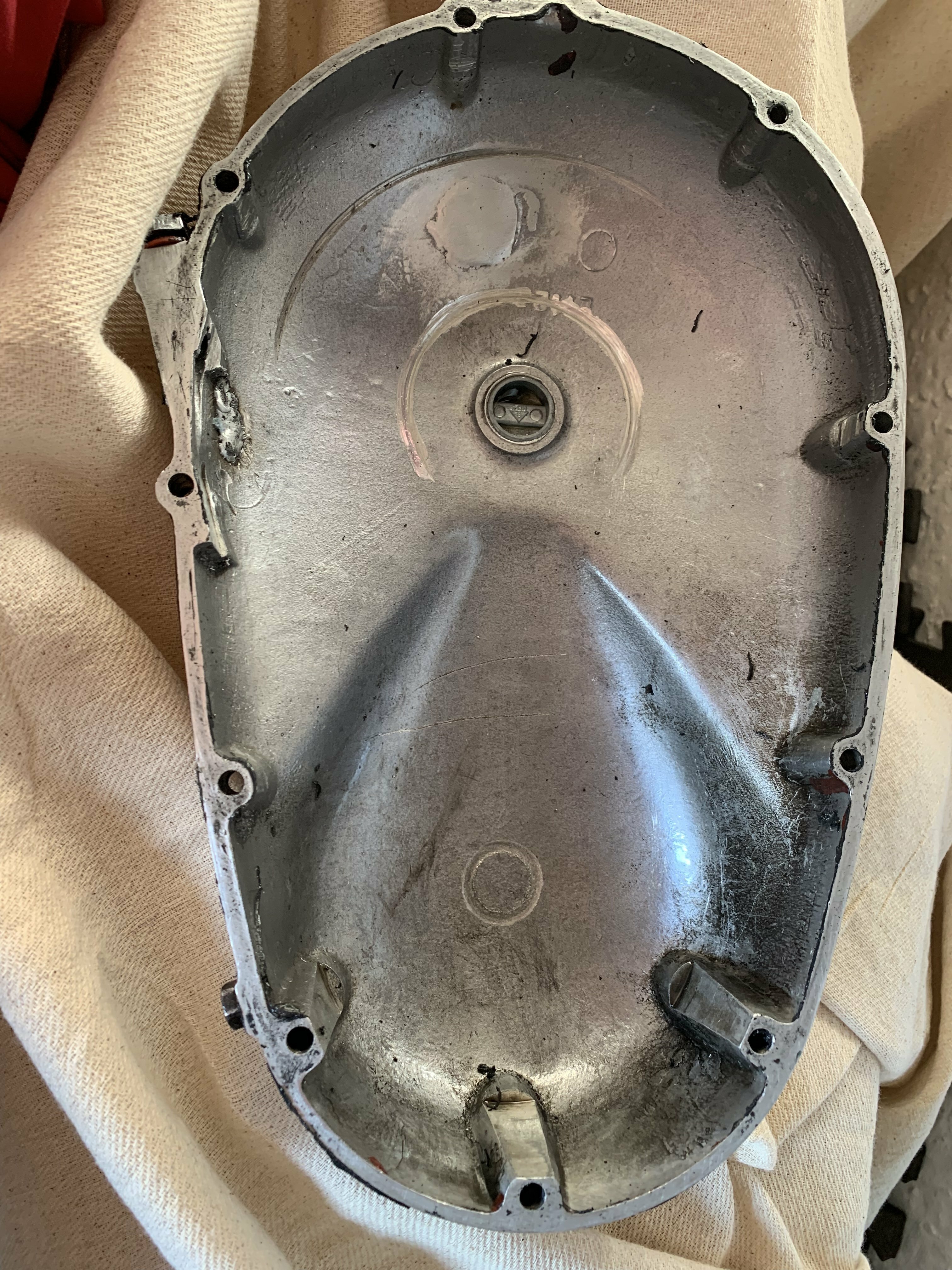

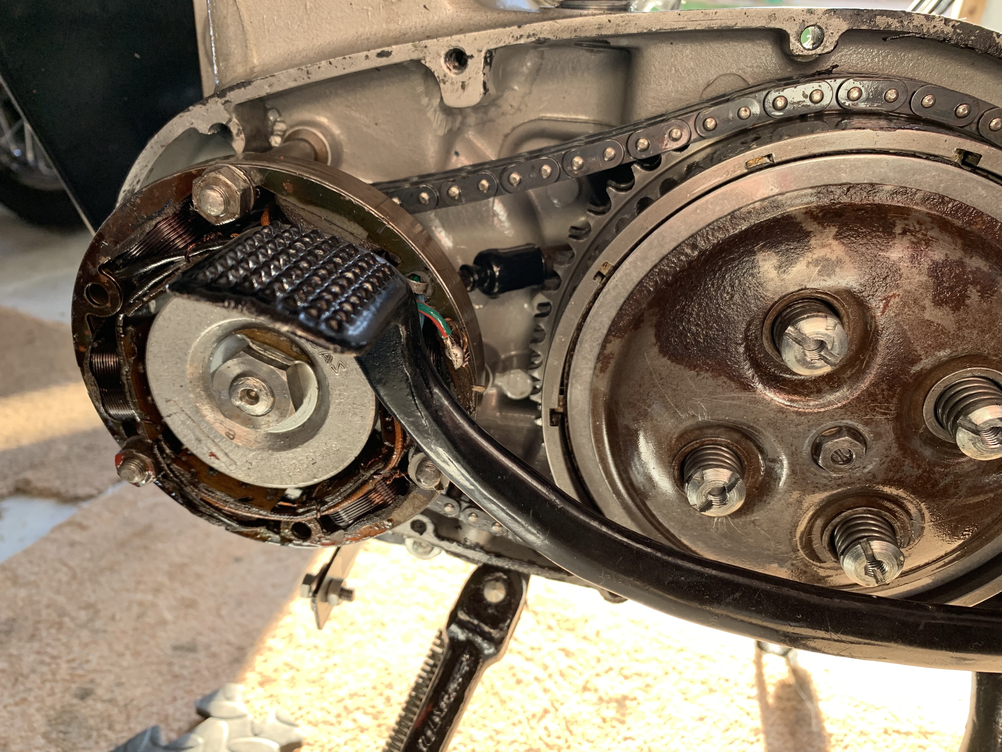

    1961 5TA got her runnig a treat with the new dizzy, plugs, battery etc. She seemed a bit noisy on the primary chain, tried adjusting as per the manual bit with no success so I whipped the case off and to my surprise there is no chain tensioner?!! As far as I have research there should be one, its easy to buy on line but has anyone fitted one ?? I have the angles drain plug in the case not upright like early models so assume it missing

    I have never come across a unit 500 without one, do you have a pic from the side view.

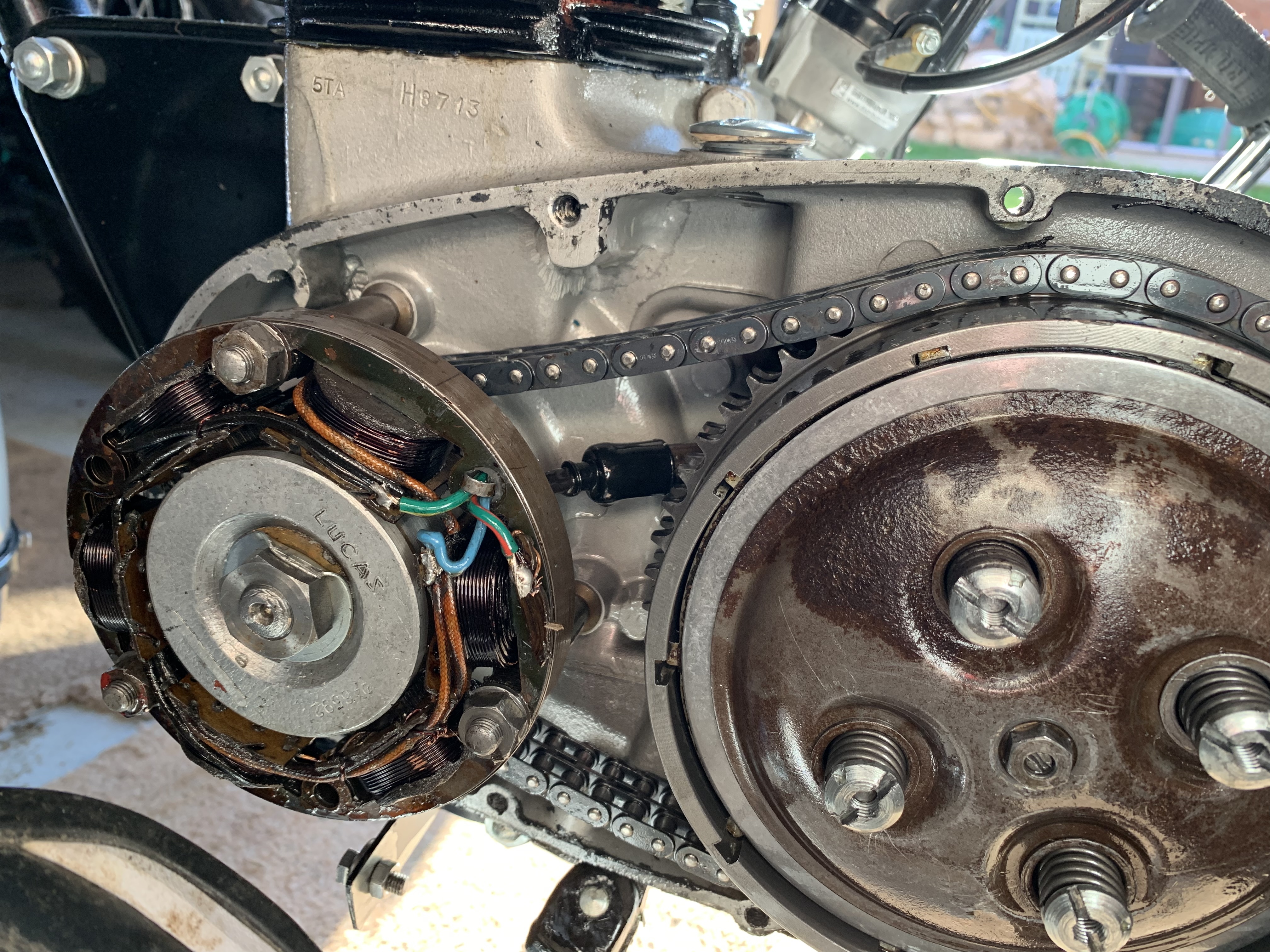

  4. Phil mills
    Phil mills Well-Known Member
    Dec 29, 2018
    105

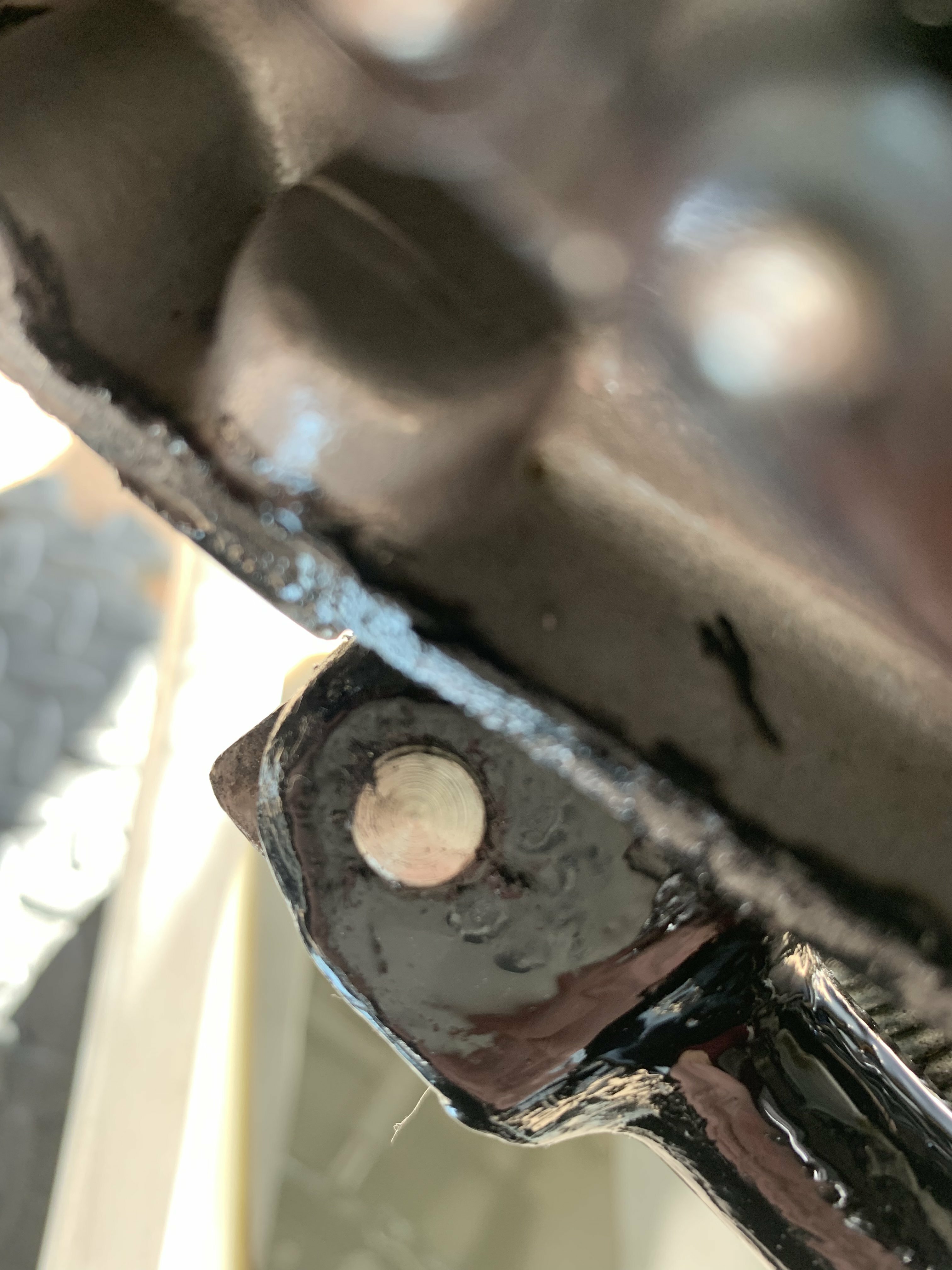

    Morning and thanks for the reply here’s a couple of pics
  5. darkman
    7,568
    Morning Phil, if you look between the 2 lower mounting bolts of the alt there should be a threaded hole for the front pivot to screw into or it might even be there that's the front mount for the blade.
  6. Tricky-Dicky
    Dec 12, 2016
    2,445
    Norfolk UK
    Looks like someone has welded up the mount/adjuster hole to me.

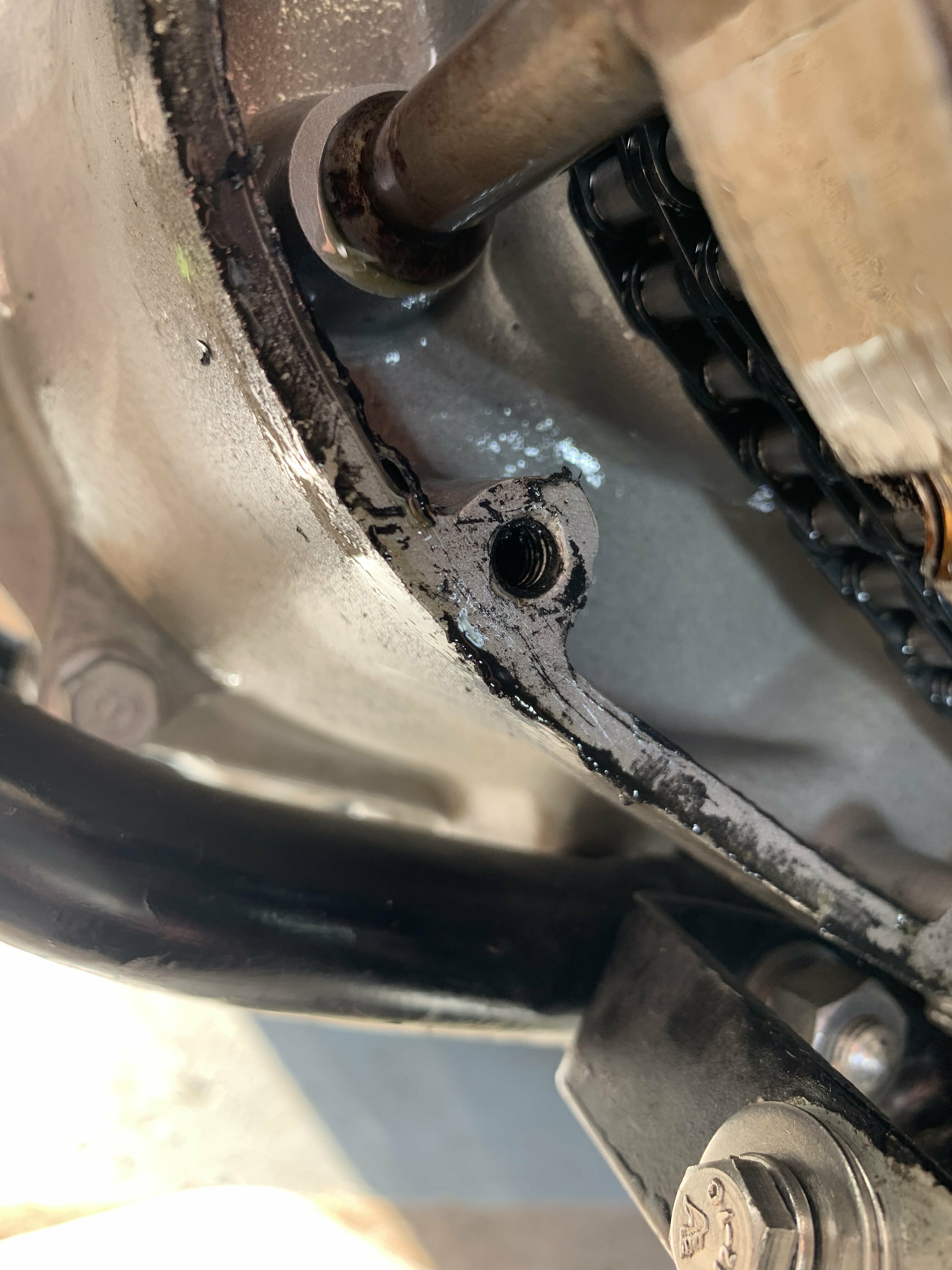

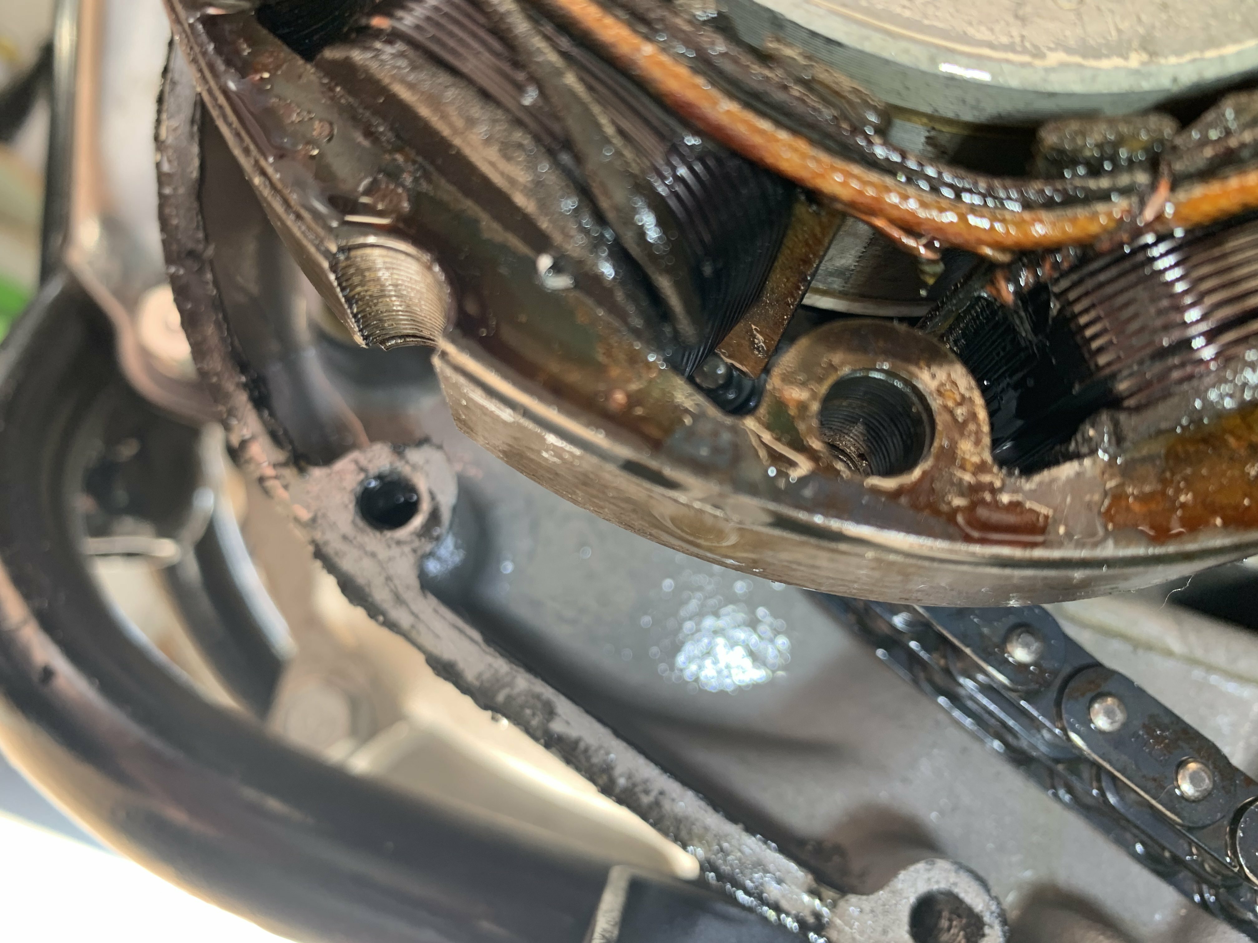

    That’s not good news if something has been welded up! I will take another look now. It seems that the previous owner was a proper badger which is a pain.
  8. Phil mills
    Dec 29, 2018
    105

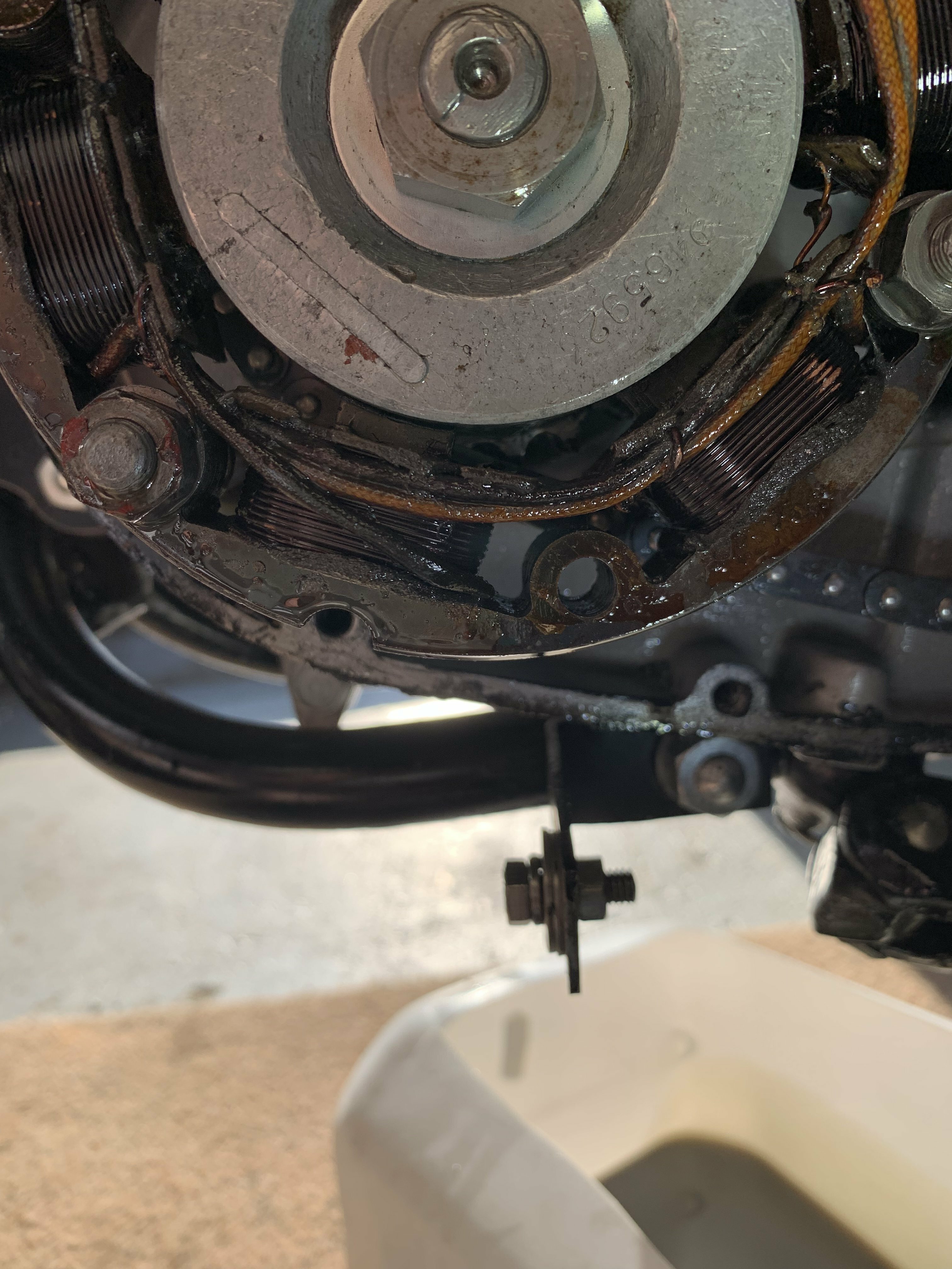

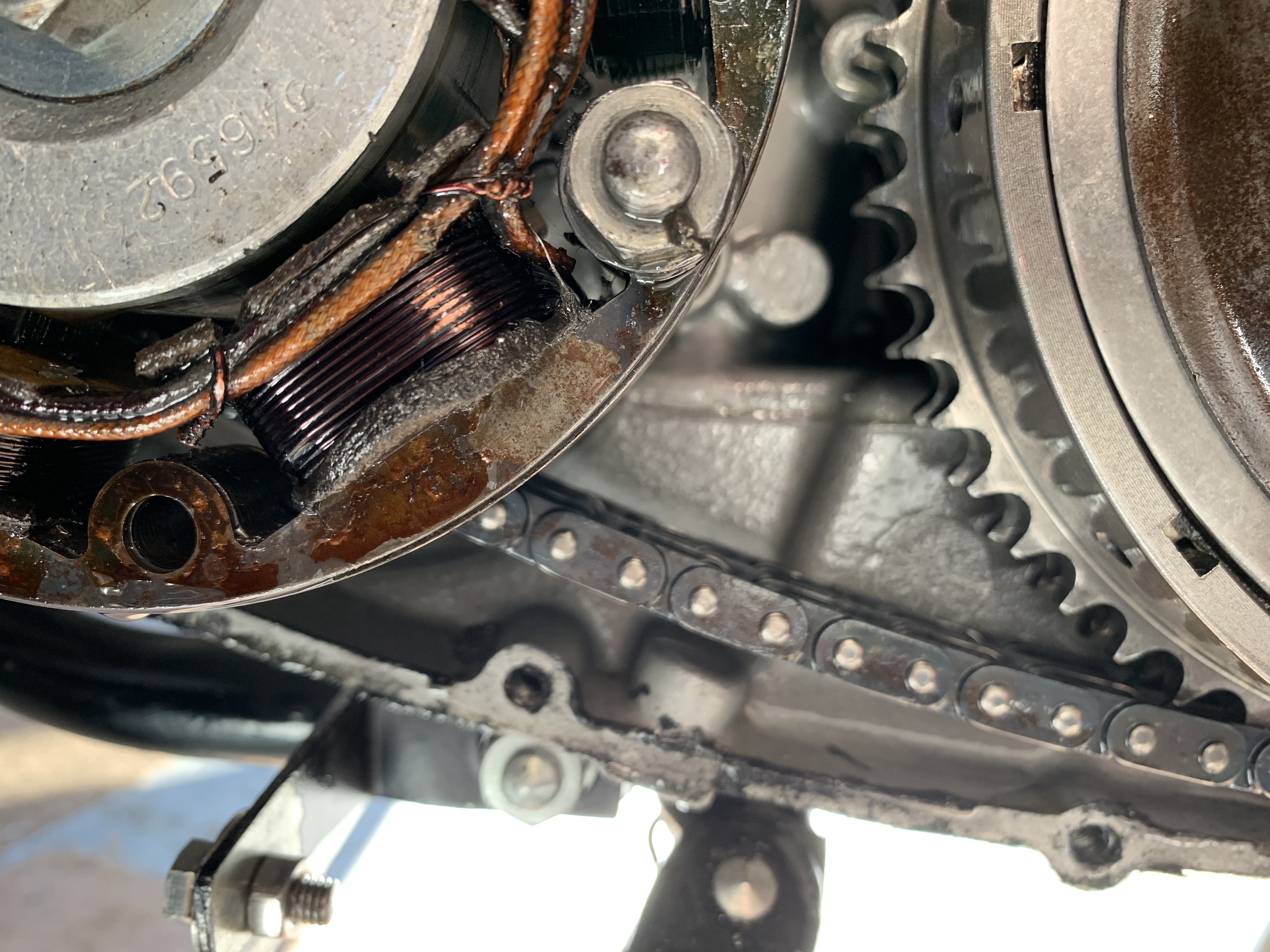

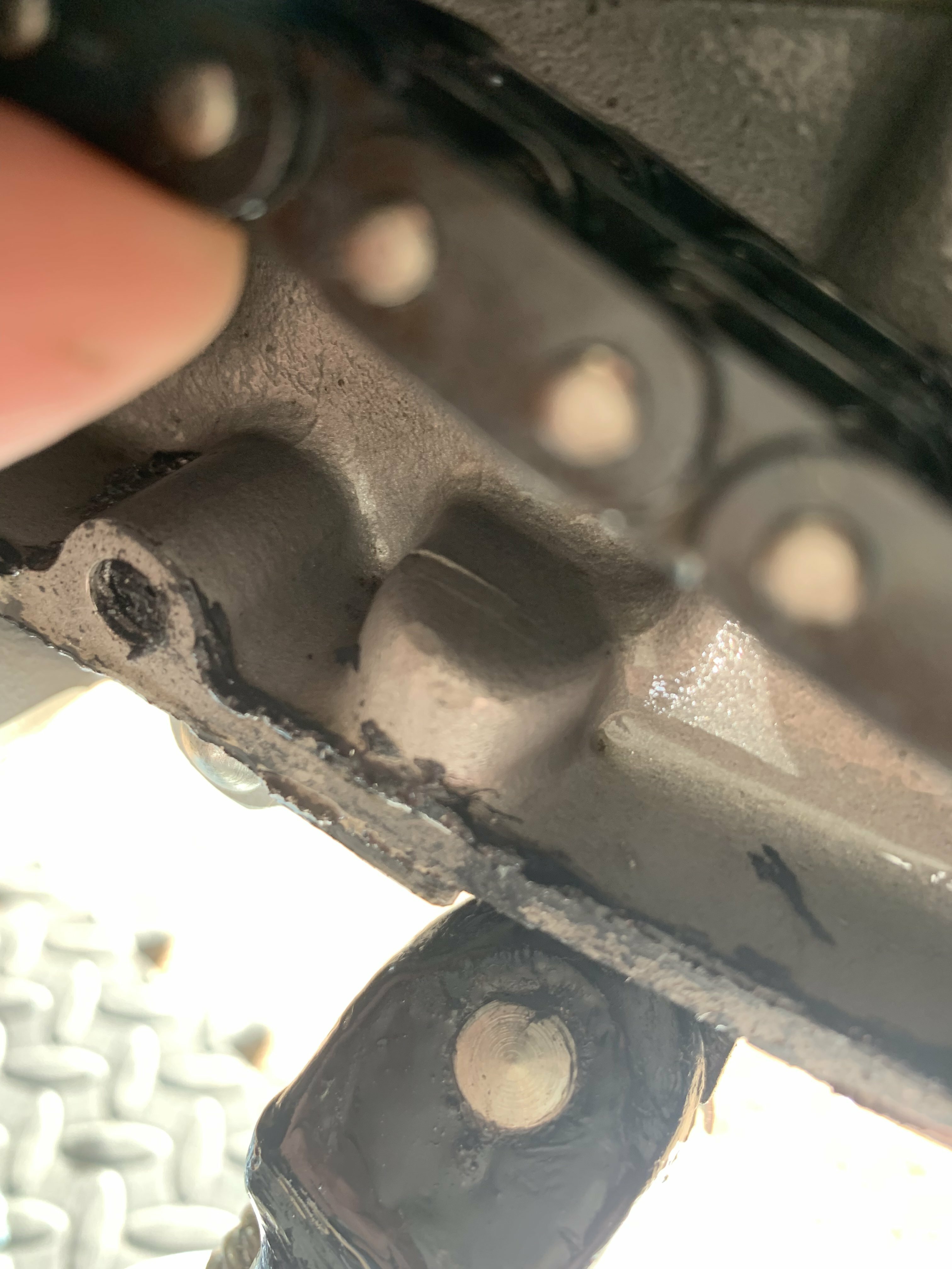

    Heees a few pics closer, it does not look welded more original if that’s possible?
  9. darkman
    7,568

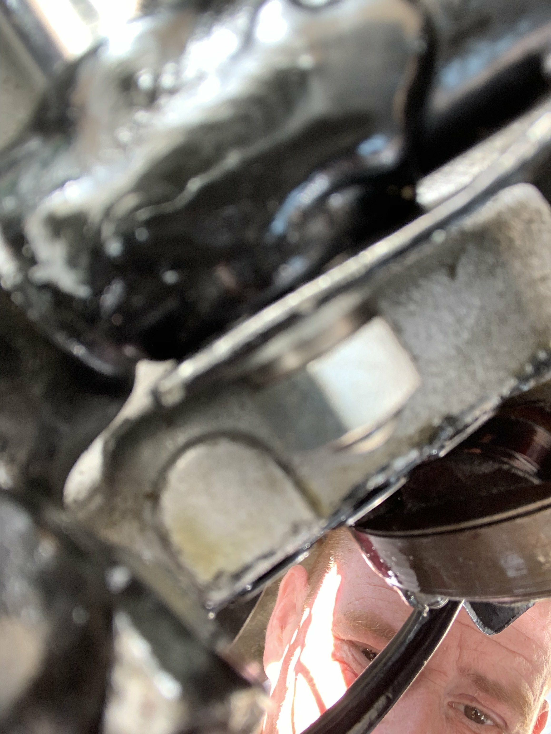

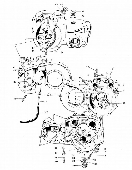

    Ignore the lug at the bottom, up behind the alt between the 2 lower of the 3 alt bolt there is either a hole for the pivot or the the pivot might even be there, that is the front pivot for the blade. Have sent a PM
  10. darkman
    7,568

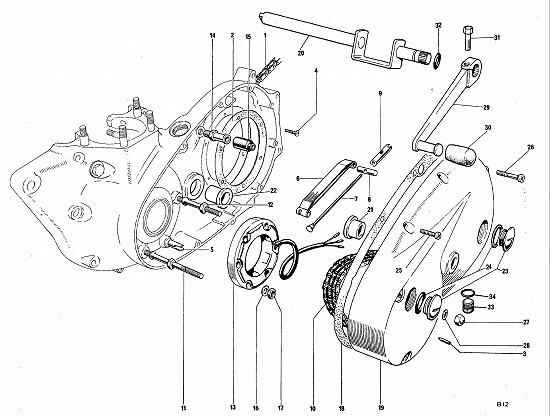

    Pic shows num 16 front blade pivot, screws into the lower middle hole. 8c6c06313e8957414b1175db59943c38.jpg

  12. darkman
    7,568
    Not a 500 but shows how all parts work. Only difference is on 500's you put the long adjuster nut in after fitting the outer case. 732798aa8fcafd66ba2ebbf24f003cbc.jpg

    Thanks for the PM I will take advantage later as I have to pop out soon. I can’t see and hole in the casing or where I would expecting to see it my engine No is H8743 stamped 6ta
  14. darkman
    7,568
    In the second pic you can see the threaded hole in the crankcase for the pivot to fit in if you look right through the alt :)

  16. Phil mills
    Dec 29, 2018
    105
    Glad to report new tensioner fitted, took her for a spin and it’s flipping marvellous, great weather and a great bike now.
