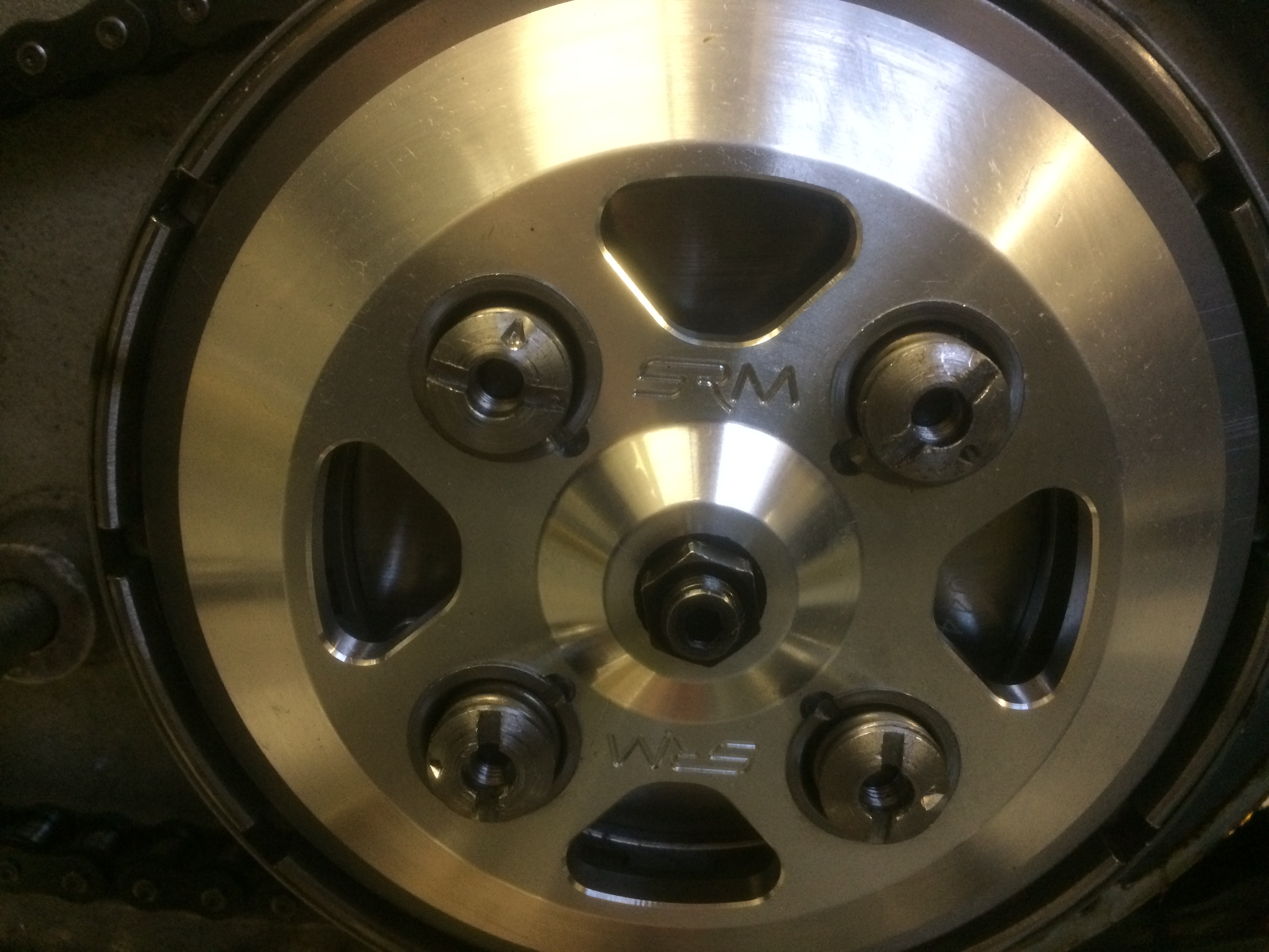

    I know you say you have checked the springs for adjustment, however what needs to be done is the following, with the primary cover off, remove the spark plugs and whilst kicking the engine over you can see if the clutch is running true, if not then just adjust the springs one at a time until it runs true, even measuring the clutch springs with a micrometre in situ will not show you if the clutch is running true. I would also recommend using ATF fluid in the chain case, remember it is only there to lubricate the primary chain and not the clutch. If you do want to replace the clutch plates then consider using an SRM clutch, this offers 1 finger operation on the clutch lever, with super smooth gearchanges. Hope this helps and ride safe all from an ageing Rocker.

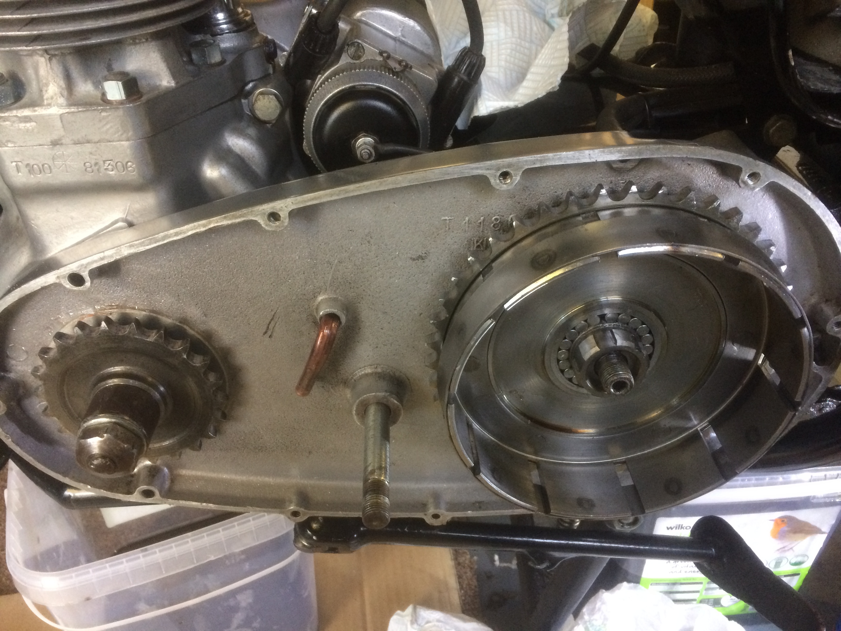

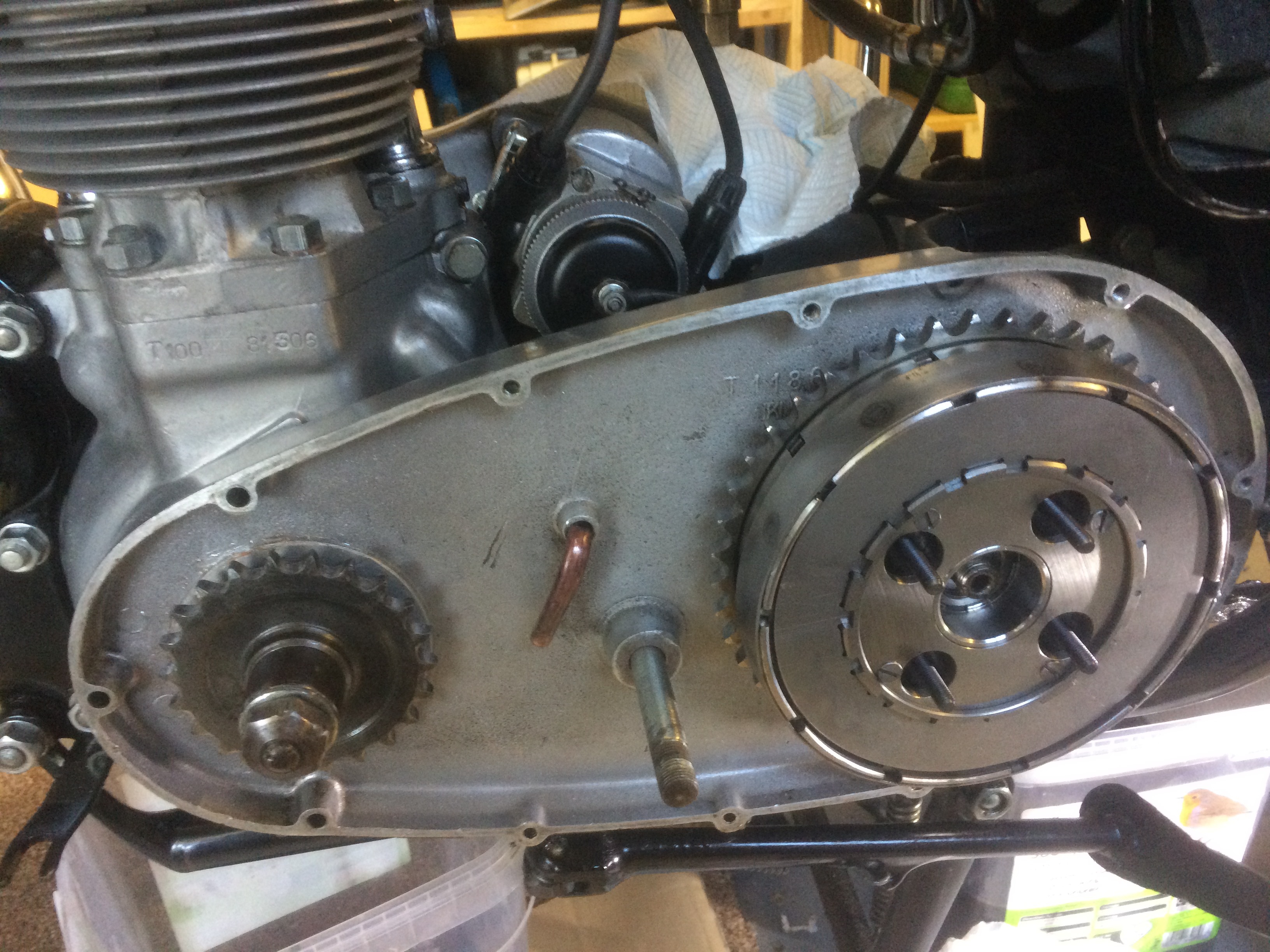

  9. Iceman
    Iceman Crème de la Crème
    Apr 19, 2020
    2,799
    Lancashire
    Hi Typeo, here are a few photos of the SRM clutch, I fitted this to a 1956 I restored, I wanted to keep the original clutch, however to make the machine fit for modern traffic, I opted for the SRM unit.
